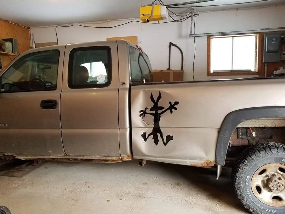

Friend of mine had a big dent like that on rear of pickup (British Columbia), put a large sticker like this covering the dent. Thats what you need, dont fix it.
