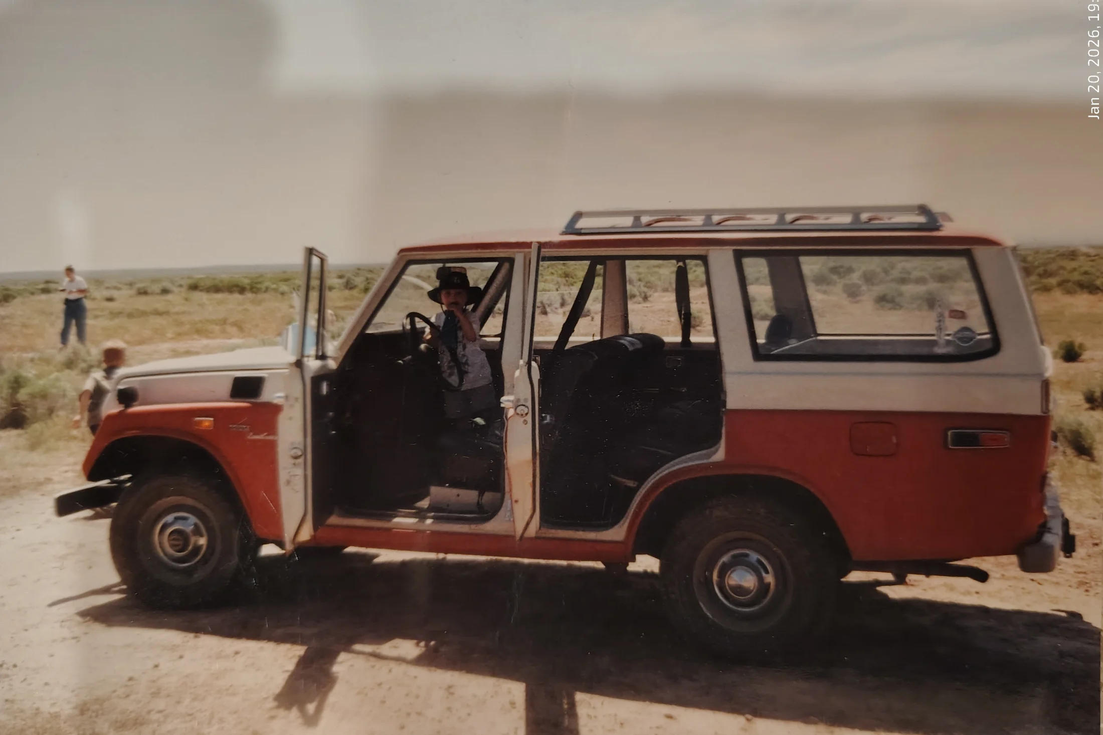

Cleaning out the basement, came across these old photos. I'm guessing 2001-ish, that's my 28 year-old son in the front seat.

One of the Northwest Cruisers of Idaho runs, @ginericLC 's 60 next to me. Kevin L on the other side, Curtis in Mr. Yuk next to Eric, not sure about the red 40s, or the pick-up, the Emmett crew Eric?

Scotty Knapp in the first red one and Mike Taylor in the second red one. I think that pickup might be the little diesel Creig owned and sold to Jay.
