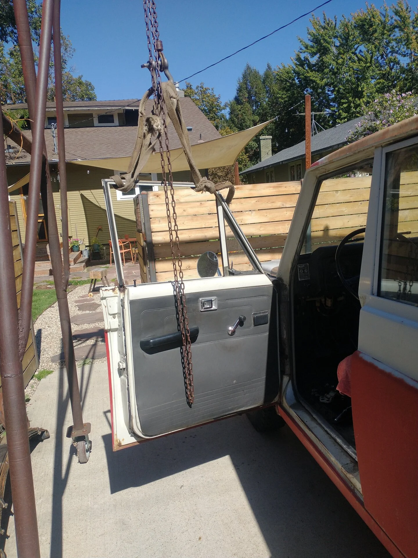

Took my upper driver's side door hinge off to change out the pin. Bought a universal kit from NAPA, with the intention of 'making it fit', then realized that the bushing are similar, if not the same, as some other bushings I had in my parts stash. So I just put the old brittle stashed bushings in and will order up some new ones next time I make a parts order.
Supporting the door with the crane.

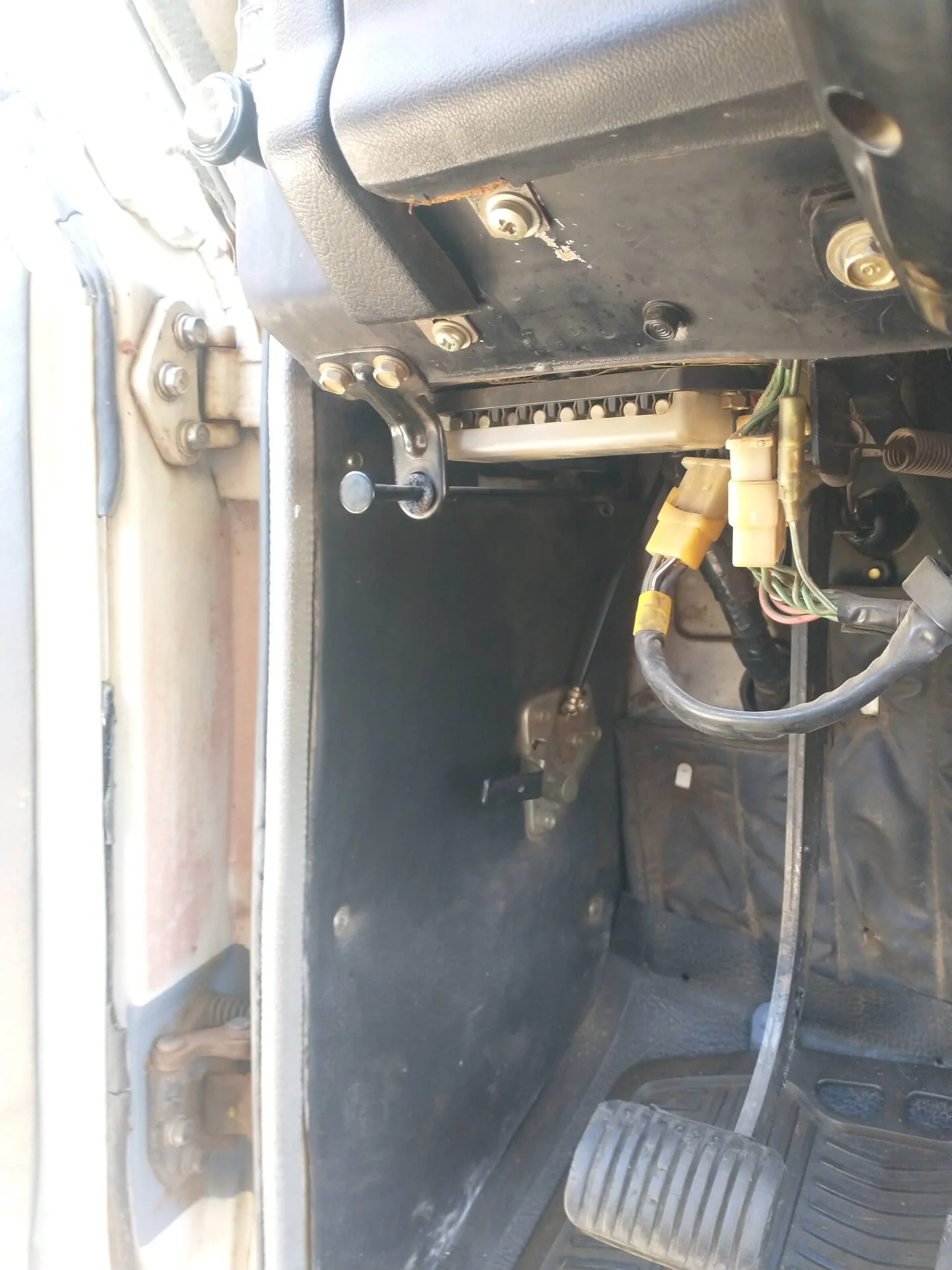

Had to remove this panel to access the hinge.

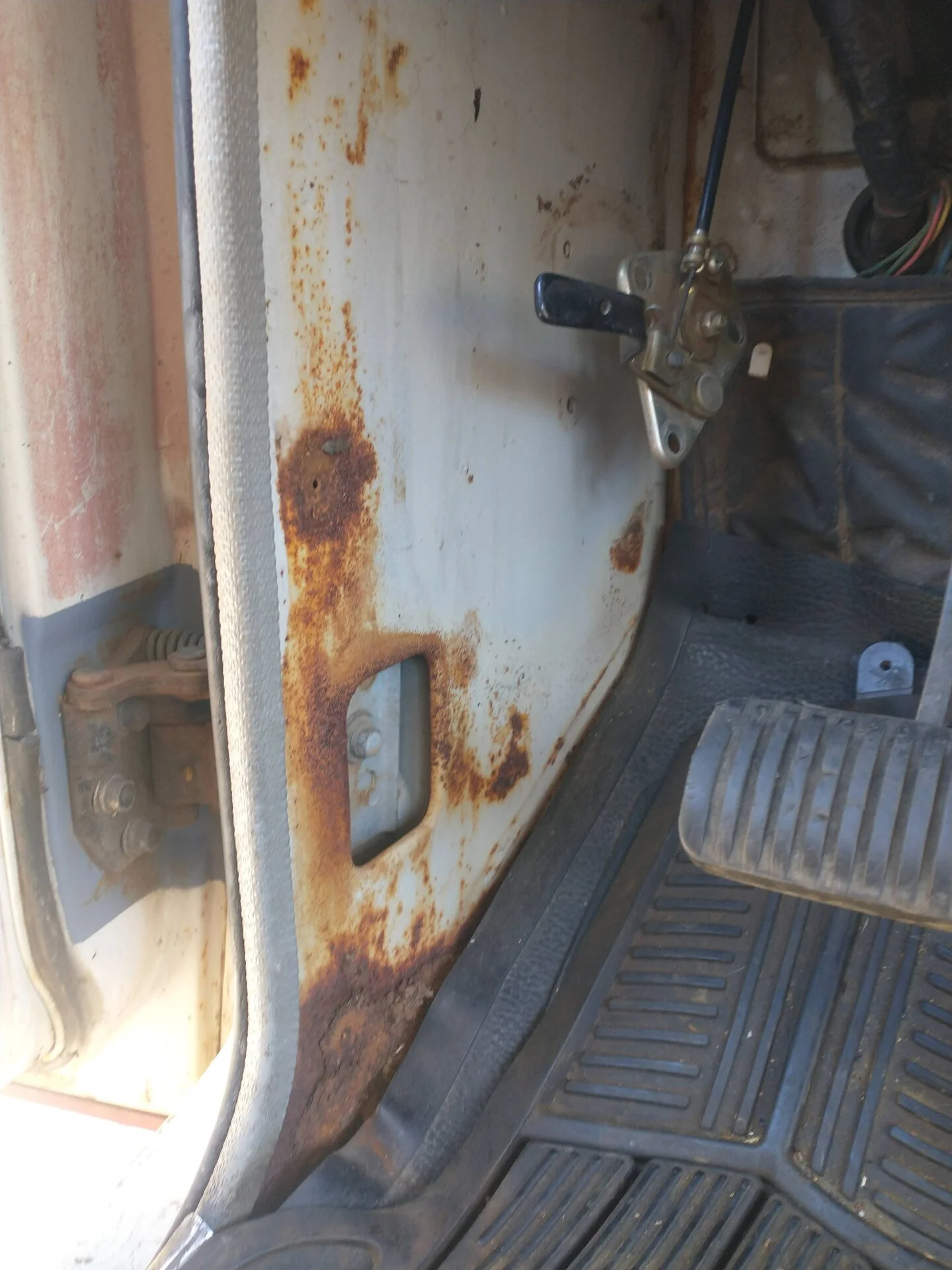

Got some rust to deal with...surprise, surprise (not really)

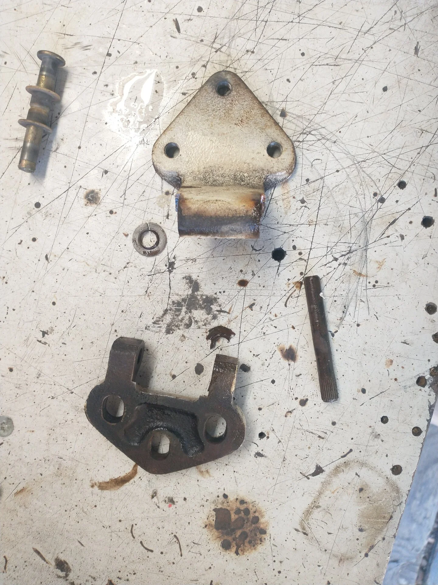

Beat the pin out with a BFH, need to buy one of these before I do the rest of the hinges.
And in pieces with 'donor' bushings shown in the upper left of the pic. Not sure what part that is from, 100% sure its a cruiser part of some kind though.
