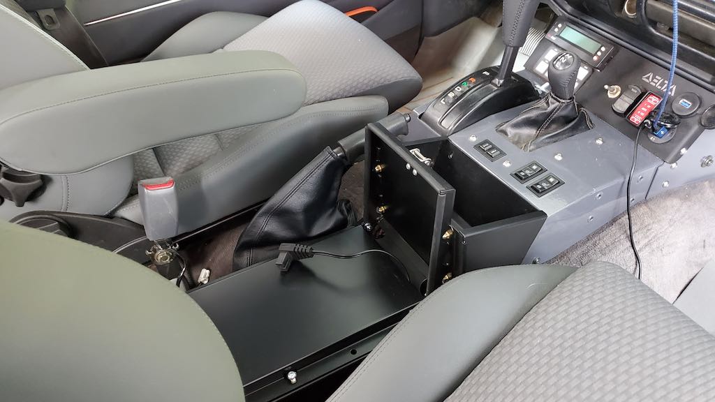

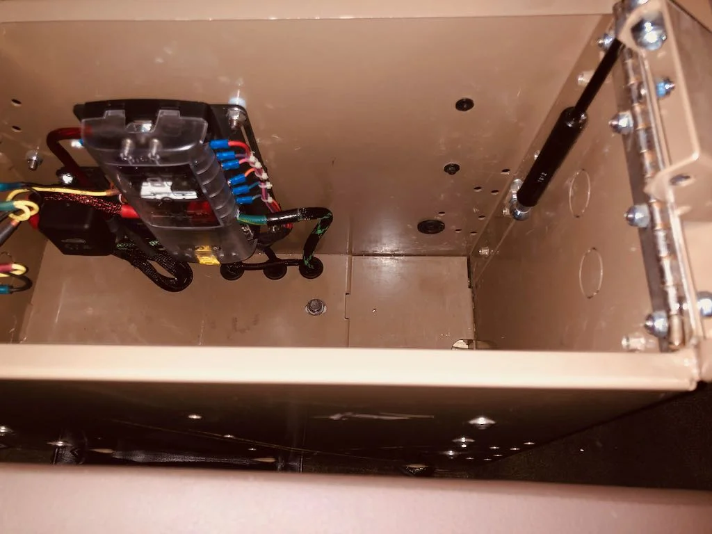

You never know what you'll add later. Setting up a dual zone fuse panel inside so you can have "always on" direct to battery circuits and "ignition on" circuits is super helpful. Building it like the attached pics makes it so you can easily disconnect it in the future (need to change carpet or add sound deadening, no problems), both the main powers in and out, ground, and all the circuit wires.
Finished product, installed and all 12 circuits wired up, but only a few in use. Power comes into the center console to the fuse panel, then continues back out the console to the rear QPM.

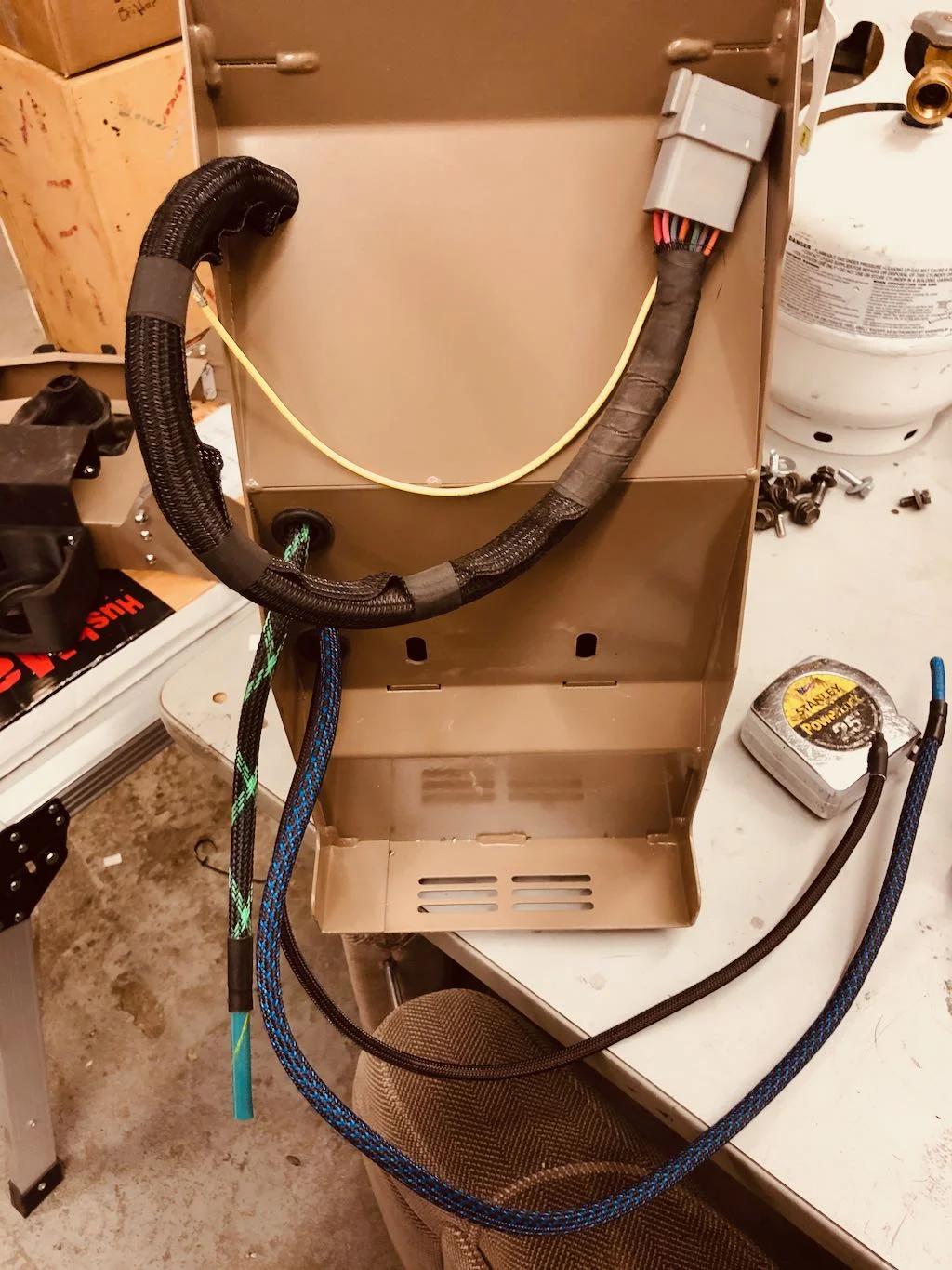

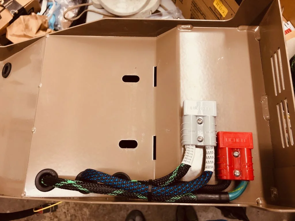

These are the connectors for power and ground in and out of the console. Having to fish wires through when removing the console for doing things like carpet or whatever is a HUGE pain. A little extra work up front makes it a pleasure to remove it (and keeps the annoyance of removing it from putting a needed job off for another day).
This is where all 12 circuit wires come out of the console to a single connector, same as the power and ground. Just need to unplug this and the red and grey connectors and you can lift console out. Very handy.

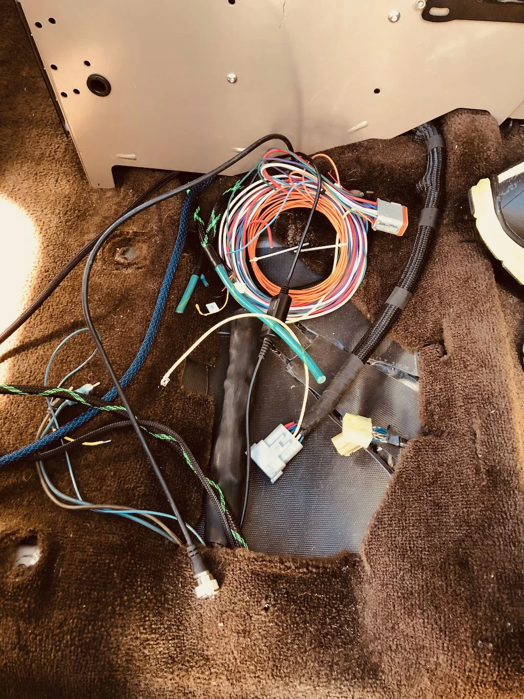

Excuse the mid-job-mess, but you can see what plugs into the connector in previous pic here. This is just a bundle of long wires that will go anywhere in the vehicle and are ready to add any accessory. Since each wire is a different color (and there are 3 different wire gages for different needs), you just pull appropriate wire to new accessory, then add a fuse to that circuit on the fuse panel and you're done.

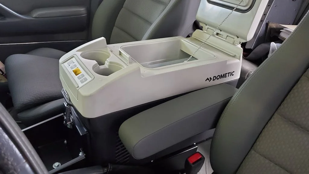

B. a quick-attach mount for the Dometic CDF11
The CDF attaches to the mount via toggle clamps, super easy to pull out to put on pic-a-nic table or something.

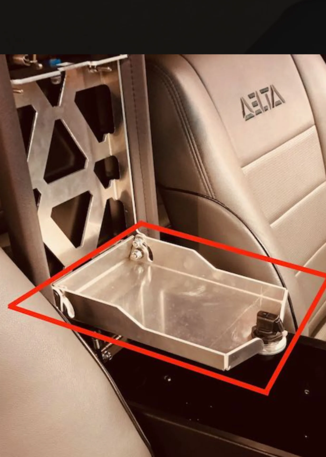

The BASE provides a two level surface (two levels to keep the main surface as low as possible) for mounting whatever you want. The BASE will work with either OEM shifter console or our shifter console.
It has:
-6 rivnuts placed on a 6x6 pattern for easy designing of accessories to bolt to it.
-Space under to route cables.
-A removable rear plate to with knock-outs to mount cig lighter style power accessories.

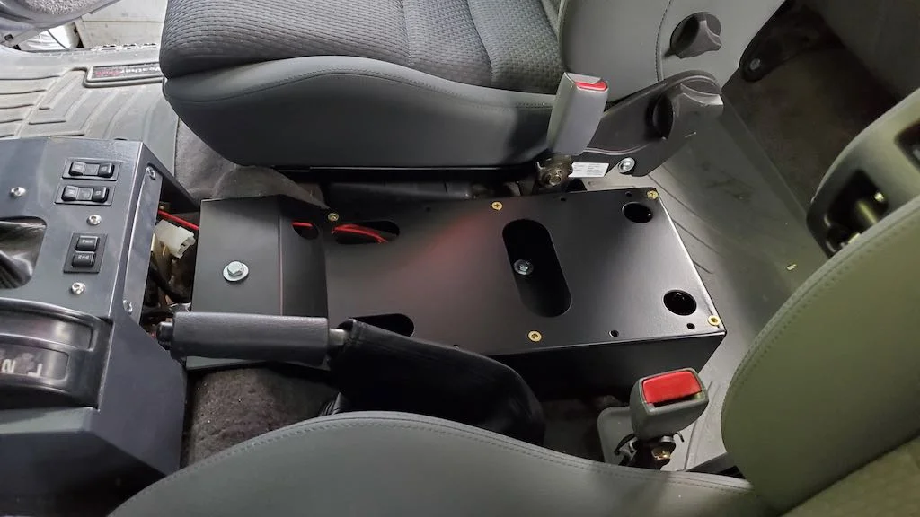

Shot of the base here

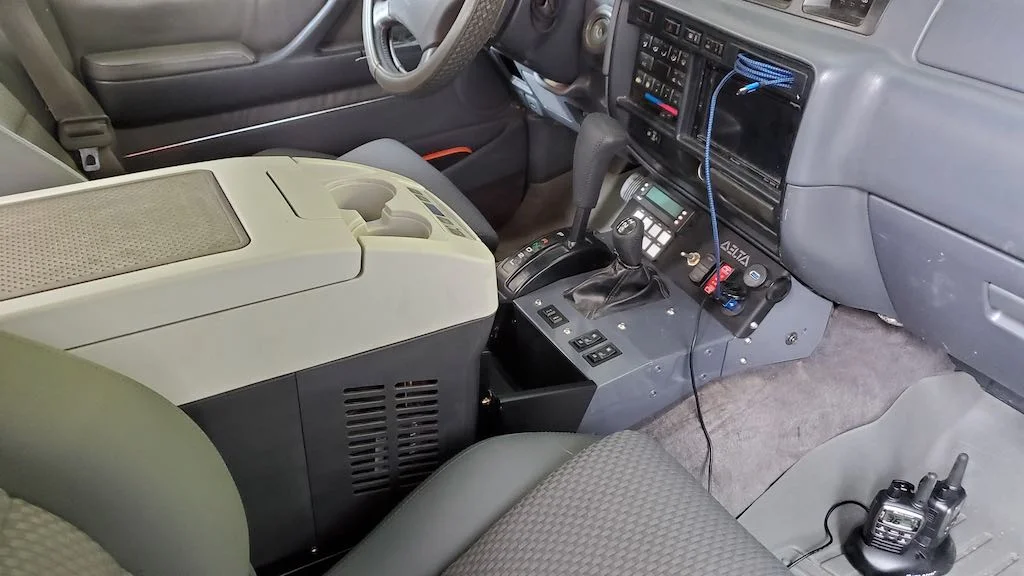

CDF11 on mount with front add-on cubby so it meets up with the shifter console nicely.

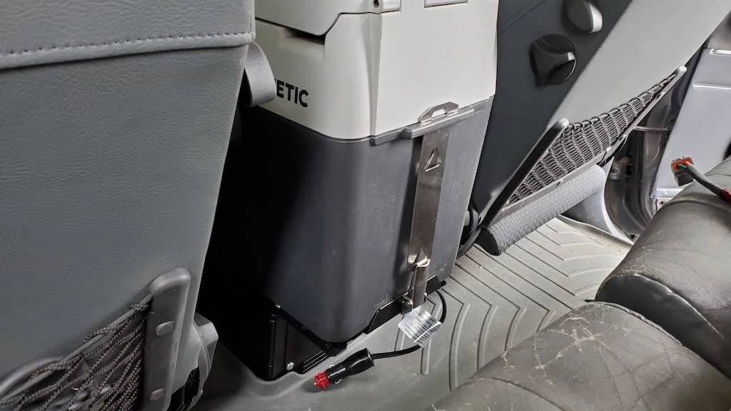

Here you can see the toggle clamp on the back for ease of removal
This shows what would be left in the vehicle if you pull the CDF out for portable cold beverage pleasure.
