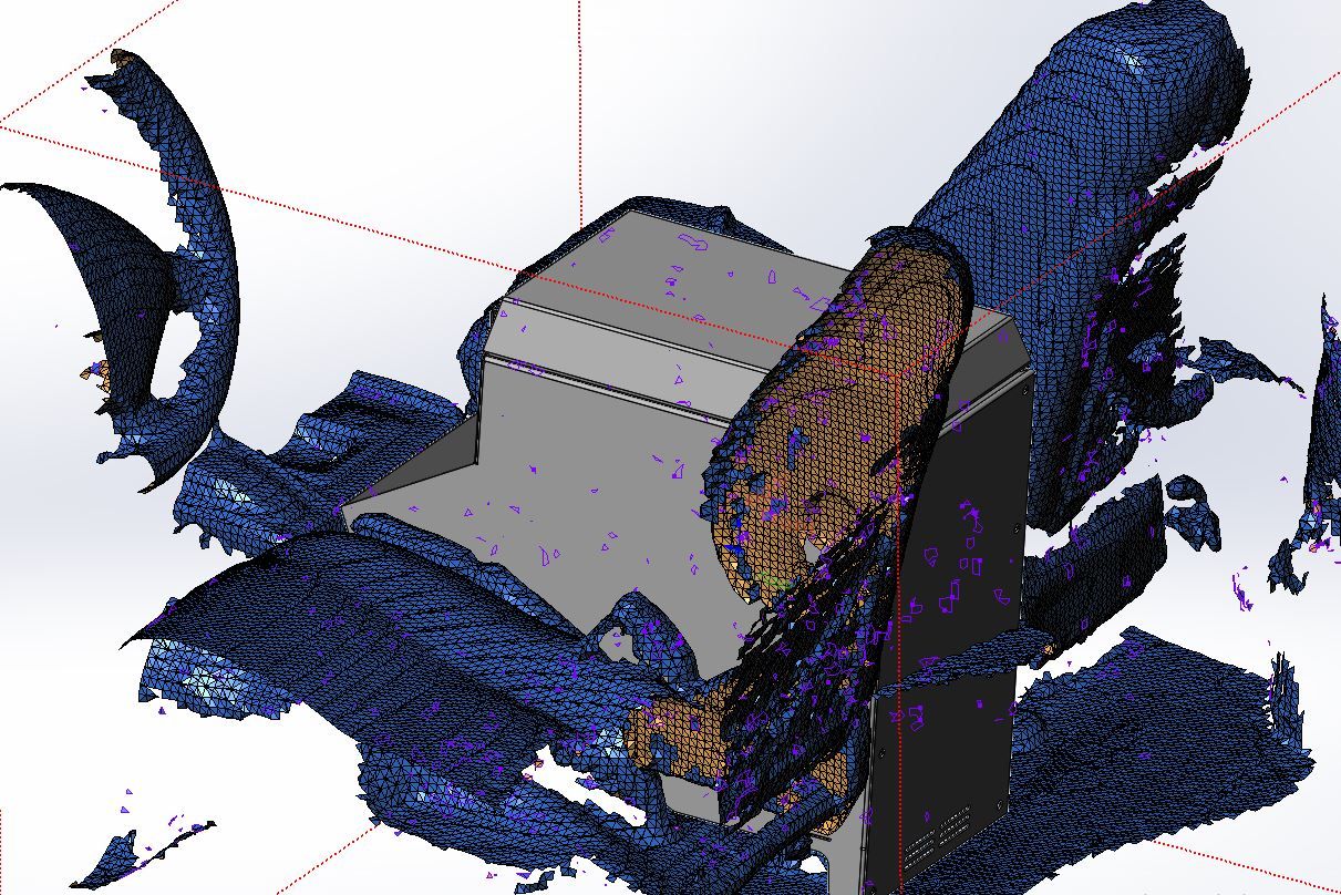

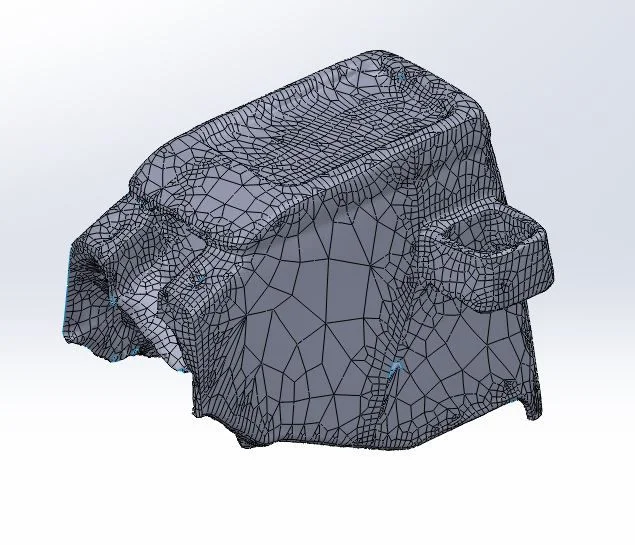

Most of our designs start in the virtual environment. We recently purchased a 3D scanner to help speed that process up.
Once we get all the essential geometry into the computer, we can use it to come up with the first approximations. Contrary to popular belief, 3D scanning is not quite a "blow and go" operation yet. There is either a lot time spent post processing, or a lot of money spent on software (and by a lot, think $20,000). Since we like to keep both of those categories as light as possible, we still use tape measure and calipers to verify basic scan info.
Once we consolidate this info, we start modeling what a product will actually look like and how it will function. We also verify fitment in the vehicle with basic scan data.

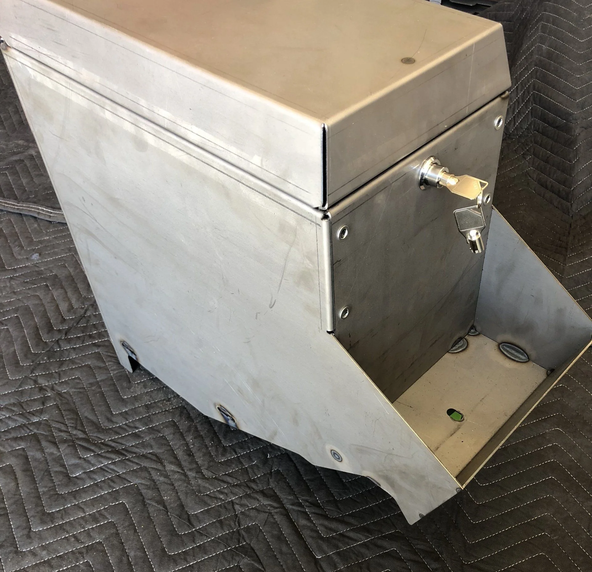

A lot of our prototyping work happens in house, but for finer detailed things that involved a lot of precise sheetmetal, we do contract outside laser cutting and CNC press brake work.

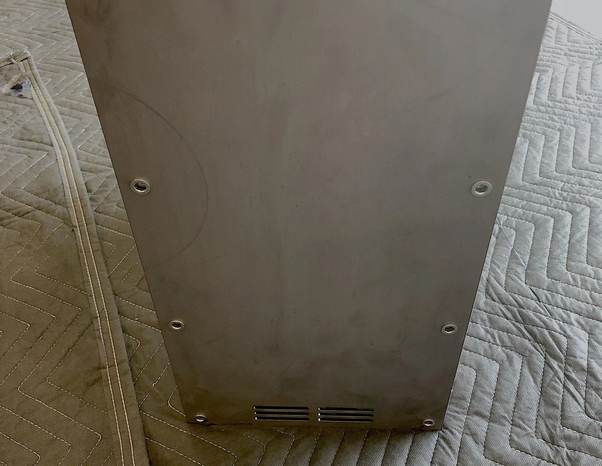

This particular design utilizes both mechanical fastening (through multiple pieces of sheetmetal) and welding in key areas for strength. The threaded mechanical fasteners double as mount points for future accessories, the layout of which will be published so folks can even make their own accessories (so you can have a two-bottle holder OR a single Thirsty-two ouncer holder). A mount plate inside will also be used so things like holsters can be attached. This is one of the big areas where feedback is actively sought.
As you can see, the back side of the console has an easily adapted layout of threaded inserts as well. Each unit will come with a printed out sheet of both the front layout and rear layout, and we will have a pdf on our website when the time comes for that.

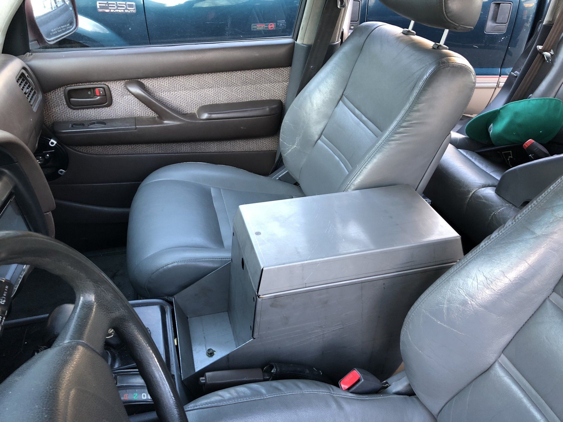

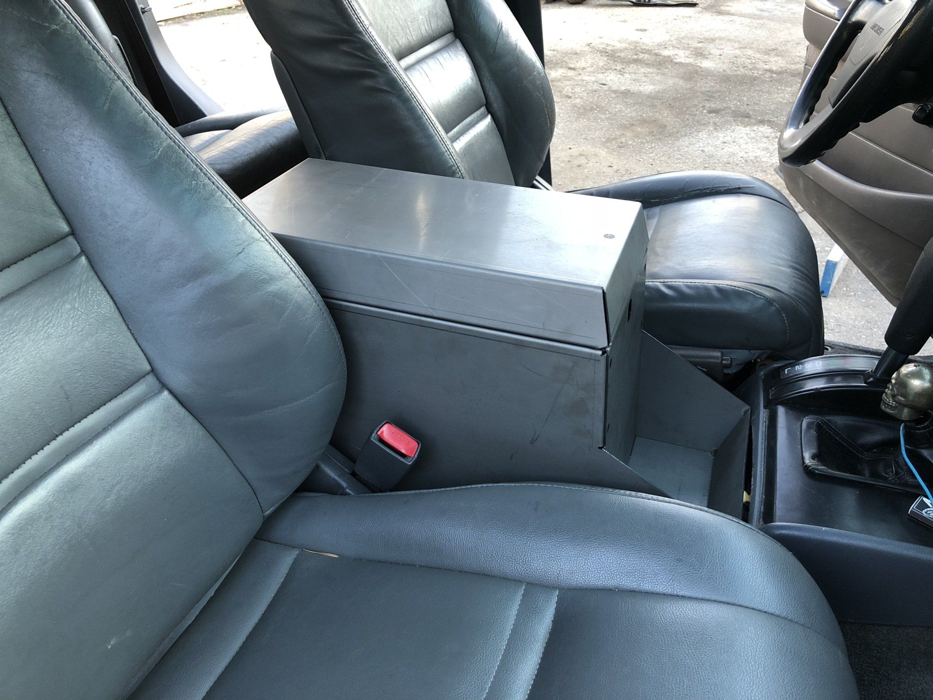

The prototype unit in these pictures has been installed in @swankstar's rig for fitment and drive testings. While he may be a short little troll type, the height has been verified by multiple drivers as being nice when on the road. It is quite cavernous inside, with lots of space to add shelves and cubbies.
If you've got any questions, ask away!

@Mandrake here’s a couple pics of prototype installed in vehicle so you can see size difference and how it fits. The idea with this thing is that it is MUCH more comfortable to drive with.
It does crowd the e-brake handle a little, that is getting address in final version (the next one).
A pic of it in place would help.
Looks huge.
Not a fan of the square corners on the lid.
Plan is to cover the lid with some nice leather to ease the corners.

It's made from 14ga cold rolled steel, should be good with Andre the Giant standing on it.
I like it too, mostly. I really like the nutserts for mounting ram mount balls, etc, but not much of a fan of the overall square build. In my mind it simply does not follow the aesthetic of the interior. A rounded leather padded cover on the lid would help for sure, but how would the main body of the console look then? It also needs to cover the hole at the back of the shifter cover that is left when removing the OEM console. Fantastic start, jut not sure it is near enough for me to pull the trigger. Picky, picky.....:)
