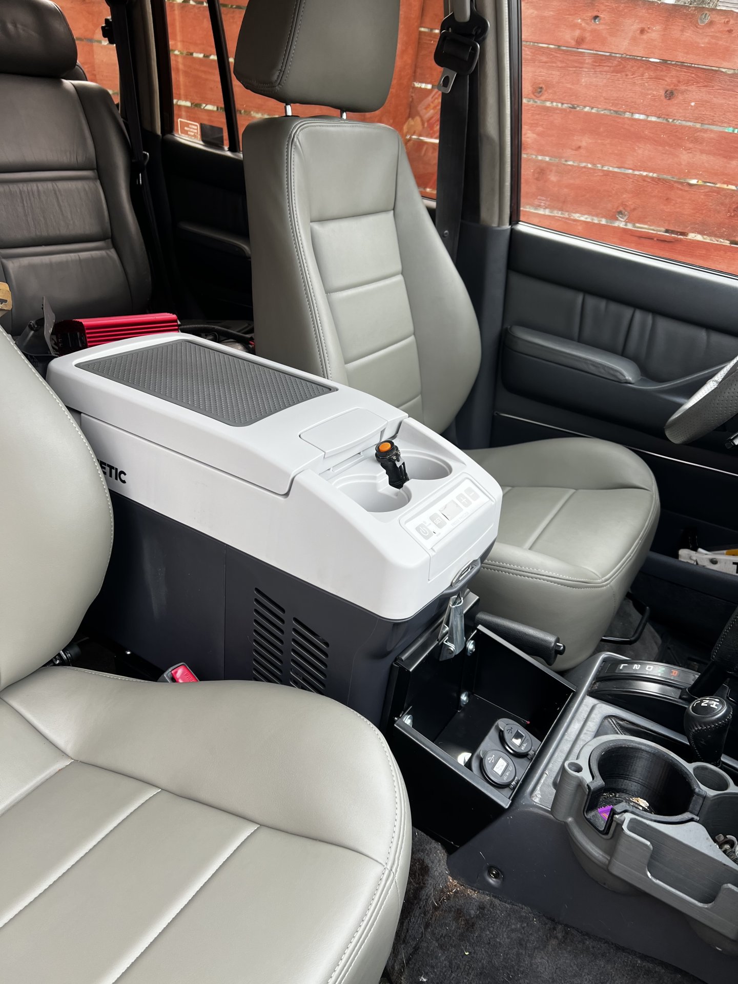

Here is mine installed, I may be the first adopter from the looks of it. All my wiring goes through the shifter console in to the base and then is distributed to the various USB ports and the refrigerator. So swapping it out would just take time clipping the fridge, then six bolts. One piece of feedback is I think the latches could use a little bit of reworking in their strength, the “arm” to the latch should probably be one piece. It would also be cool to have USB punch outs at the front of the cubby because there is space for it and that makes it more interchangeable with the center consul while retaining USB ports. Other than that nitpicky stuff I am super happy
This may be the only photo out there of the Dometic installed without the DVS console. Answers my question about how the cup holder matches up to the OEM center console. Anyone have more pics of the setup like this?
