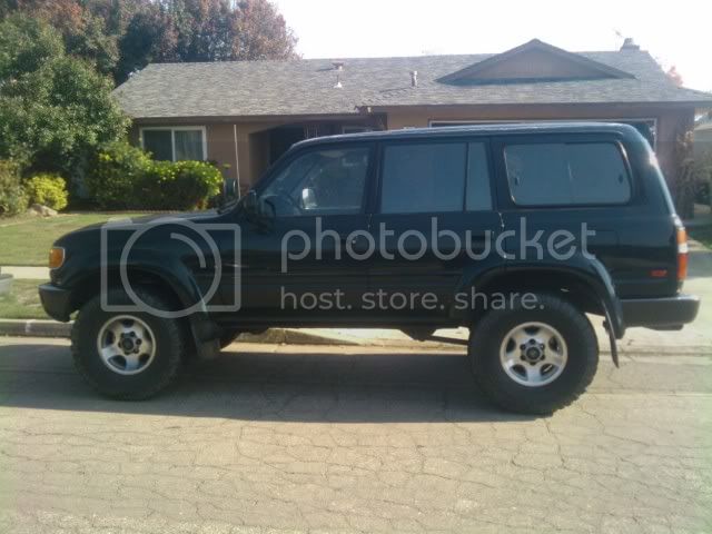

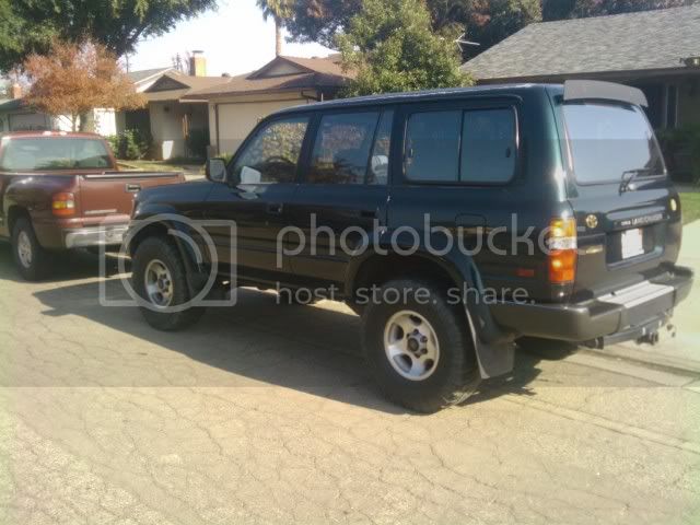

Just some pictures and specs, to help other choose.
Specs Stock unless noted...
315/75R16 Xterrains 50% Tread
Front Springs TOYO24C
Rear Springs TOYO25B
Still on factory shocks, brake lines will be here in 4-5 days. No caster correction, going to do washer mod most likely. Currently no vibration, drives ok but I can tell the caster is off.
Fender to Center Hub
Front
Driver 22 Passenger 22.5
Rear
Driver 23 Passenger 23.5
Update-after wheeling specs
Front
Driver 21.5 Passenger 22.5
Rear
Driver 22.5 Passenger 23

The side shot definitely shows some stinkbug. Planning any heavy mods like bumpers & sliders?

He said he still has the stock shocks.;) Looks good but I'd add spacers to the front to lessen the stinkbug look.:)

Stock shocks and it rides great, plan to add a rear bumper and swingout next. First wheeling trip should be Sunday, hope to break the springs in a little and see were the suspension levels out.

Busted out the tape measure updated the first post, going to have to order a 20cm front spacer for the drivers front to level things out.
