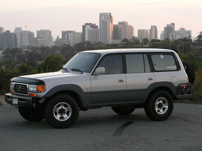

As promised here are my before and after shots, gained 2.5" front and 3" rear.
This was stock suspension after 3 years of ownership
And after 4 years 7 months of wheeling the stock suspension.
The LIFT is FINALLY on! :bounce::bounce2::bounce:

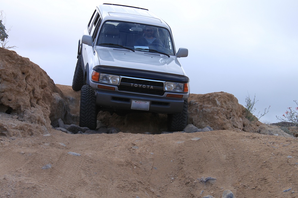

And in action
