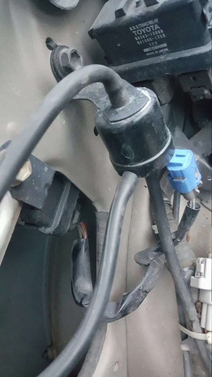

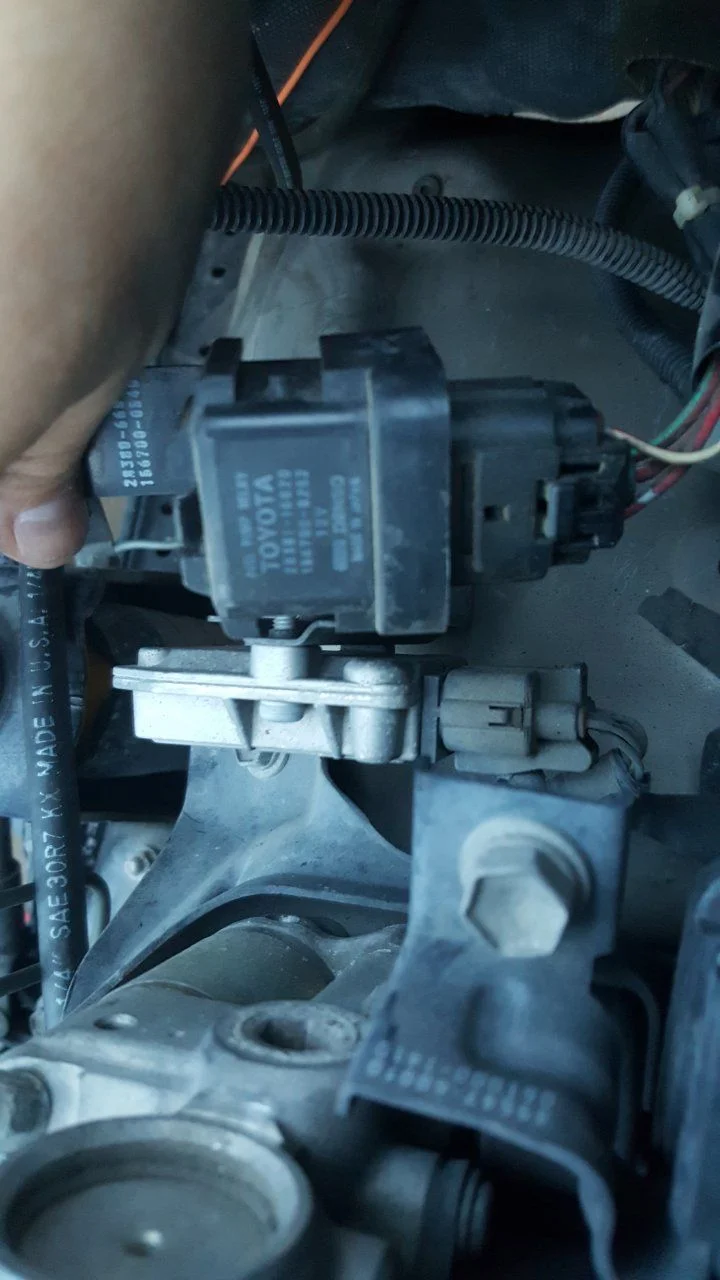

Found the fuel pump relay. It's driver side, Below the hinge for hood.
Wire colors are correct. And it says what it is, so not a biggie.

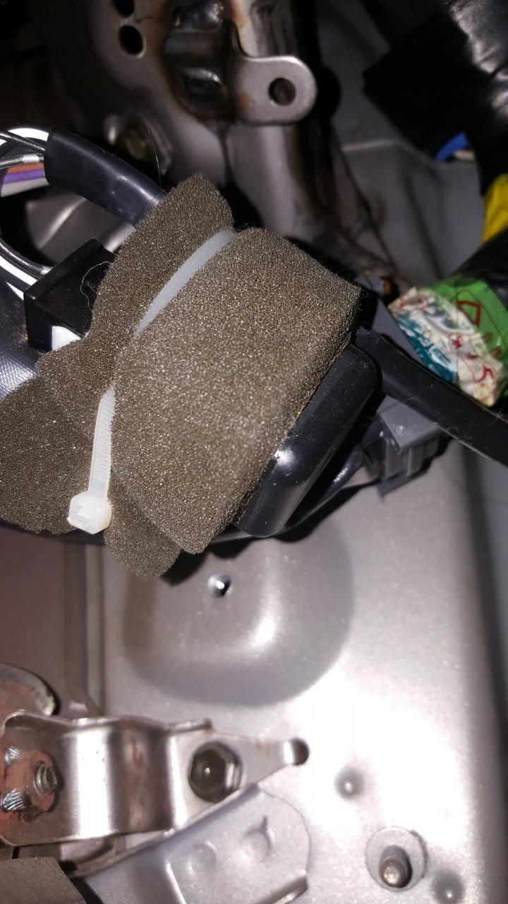

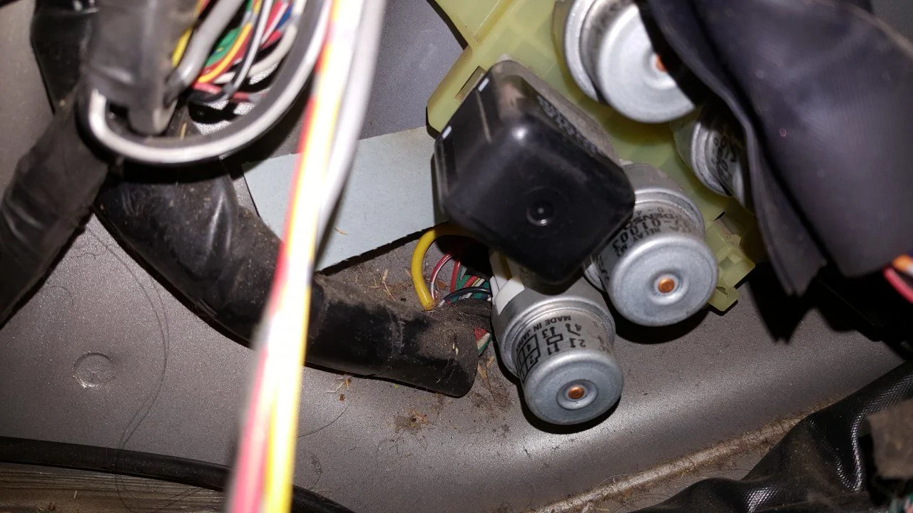

Can't seem to find the orc in the left kick panel. This is my best guess, but wire colors are off. I'll have to test for continuity tomorrow from the e7 connector.

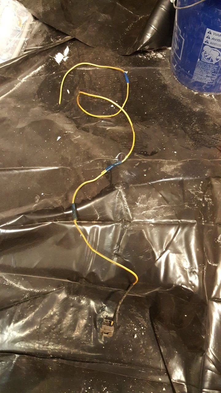

And the only wire I cut that wasn't a ground...

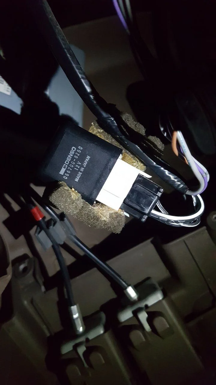

That denso relay is for the starter interrupt on an alarm. Black/white is the primary starter signal wire. If you just remove it the truck won't crank.. though ditching that and the harness adapter is pretty easy while you are in there (if the alarm doesn't function anymore).

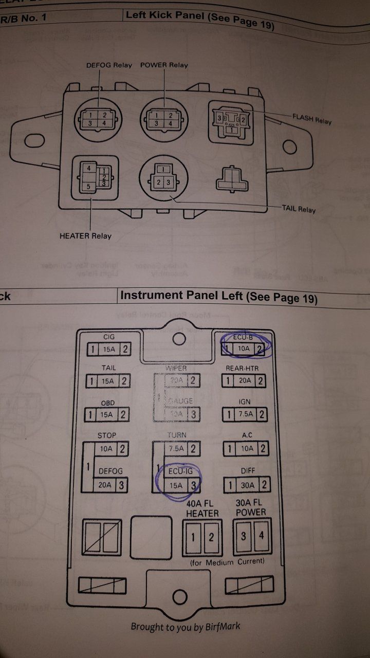

the COR should be one of the relays in the relay panel mounted in the lower a-pillar. I don't know which one it is on the panel though.. and wires will be going into the back of the panel so you'll have to loosen its mounting bolts to get a good look.
Edit: had a look at the 96 LX EWD.. appears the COR is a relay clipped to the bottom of that relay panel.
And now you've got me confused on the fuel pump relay. I distinctly remember finding what you did.. but also having to relocate that aluminum box next to it to get my rig to run. Now I need to figure out what that part is too.. yay OCD.
Edit 2: I knew it was related. That aluminum box with fins is the resistor that steps down voltage for the fuel pump when the FPR isn't activated. So technically you could leave the FPR control alone and just splice those two wires together and the fuel pump control circuit would default to full battery voltage even without power to the fuel pump relay.
For some reason that thing is moved on the later vehicles. Earlier it's on the other fenderwell.

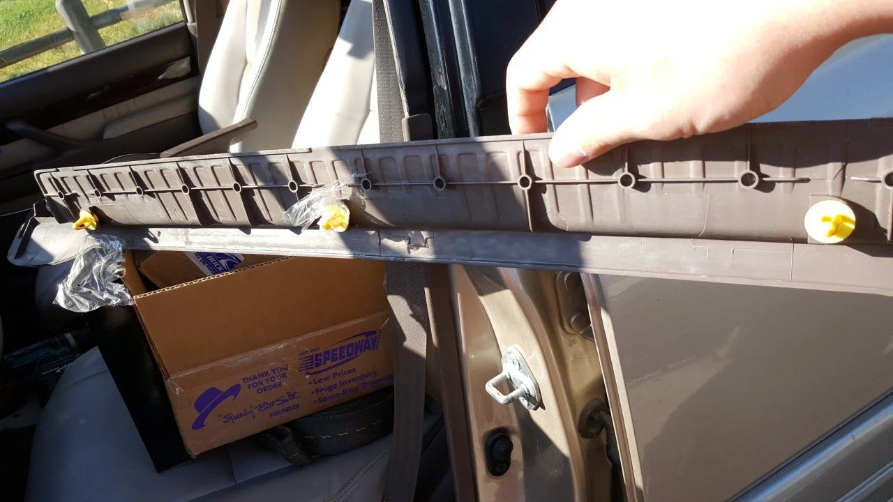

Found the circuit opening relay. You need to remove the foot rest and pop off the 3 clips holding on the kick panel.
Pretty sure it's the lowest one hanging off the relay panel.

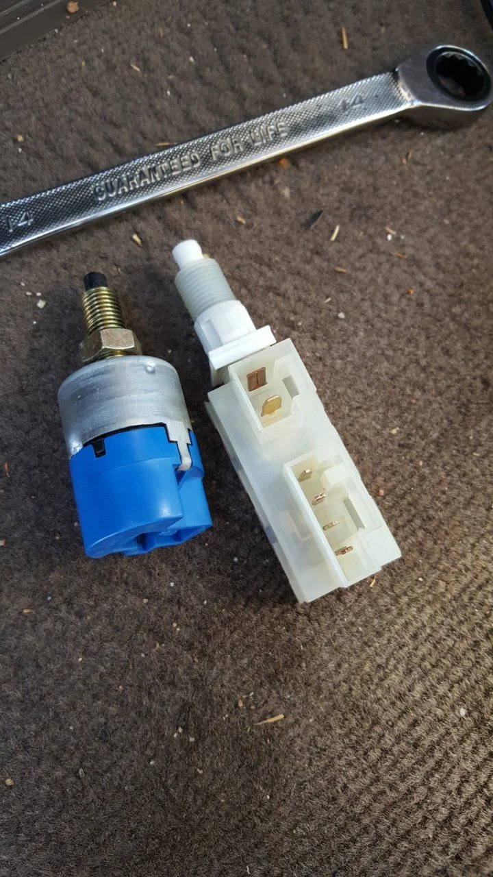

Trying to make this brake switch work. Lights need switch to complete circuit, gm pm needs it to interrupt circuit. This switch does both. No fussing with relays and hood rat (the kind of wiring I do) wiring.
A little bigger than the gm switch, but I think I can make it work. $9.99 @ vatozone.
New switch is on the right....
