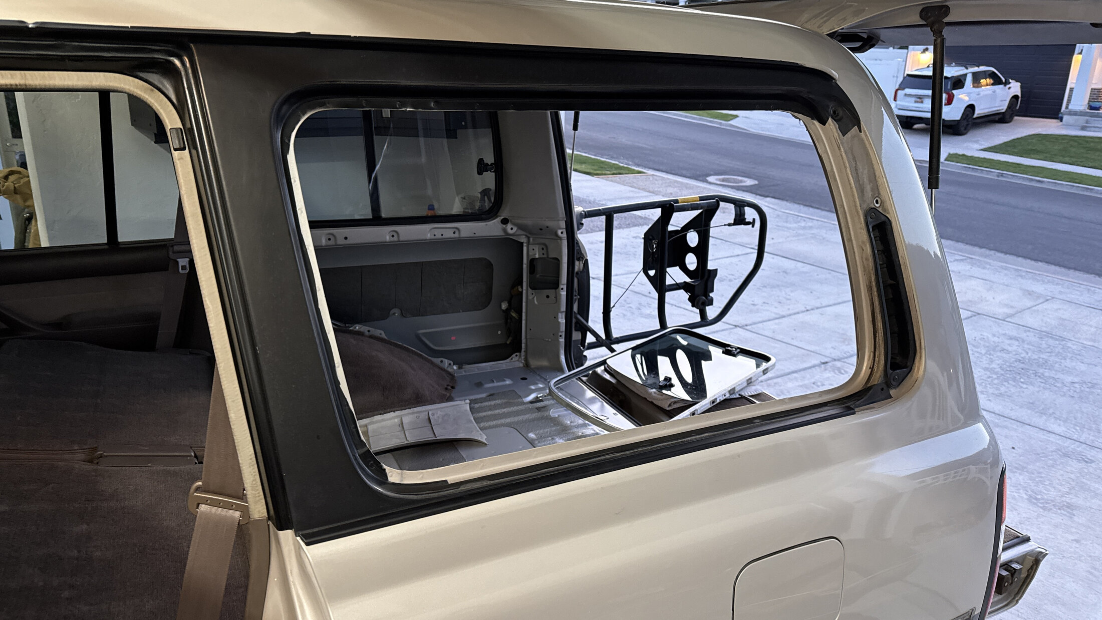

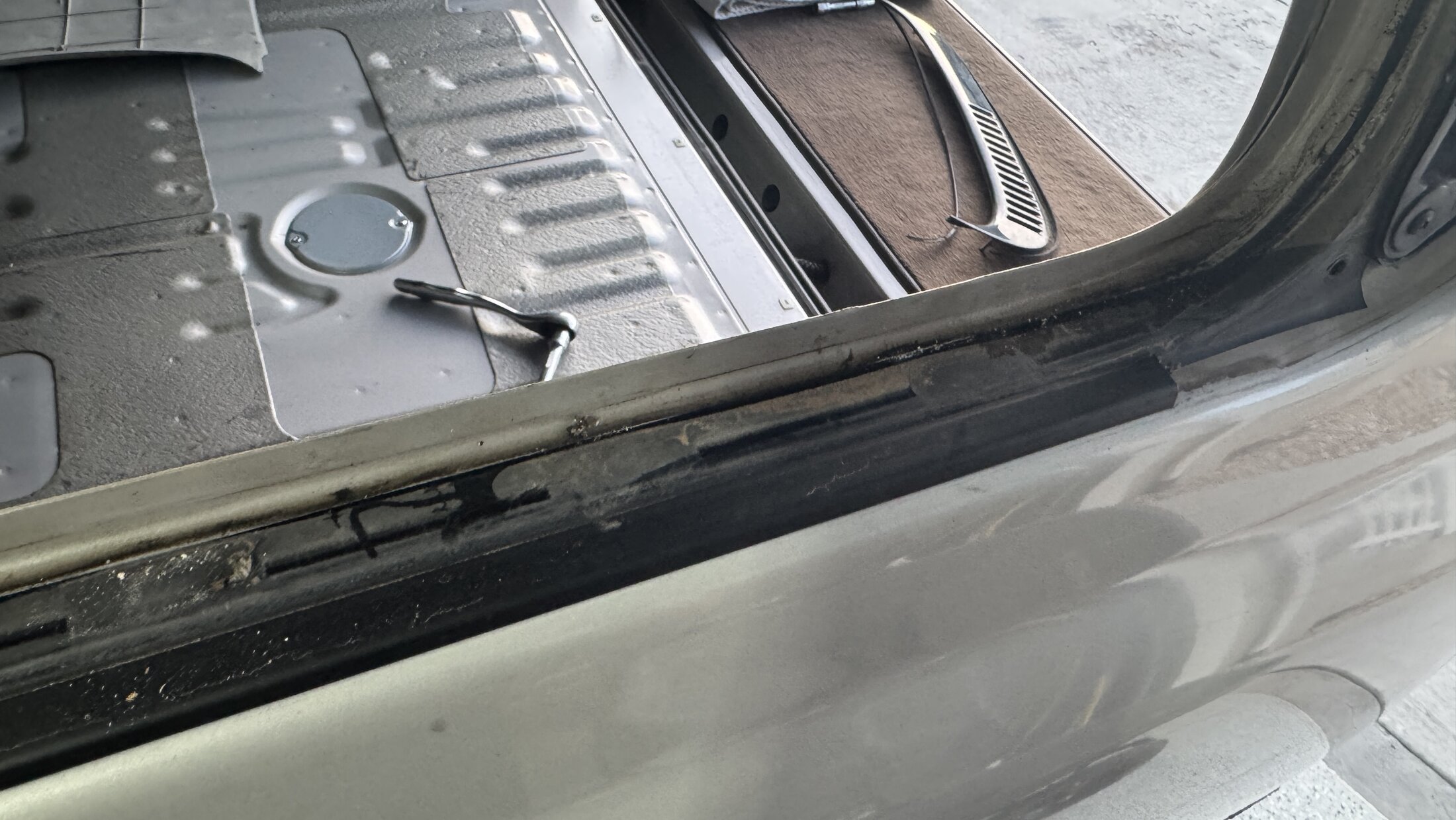

I was relieved to see no rust under the rear sliding windows but there was a decent amount of water lurking under there from the car wash a week ago.

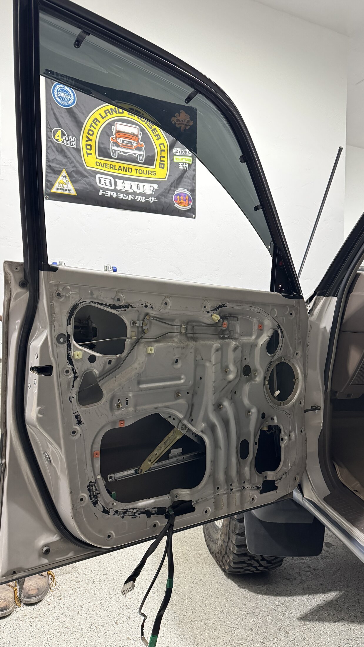

Doors are coming apart nicely. Glass is out, mirror is off. Butyl is nasty

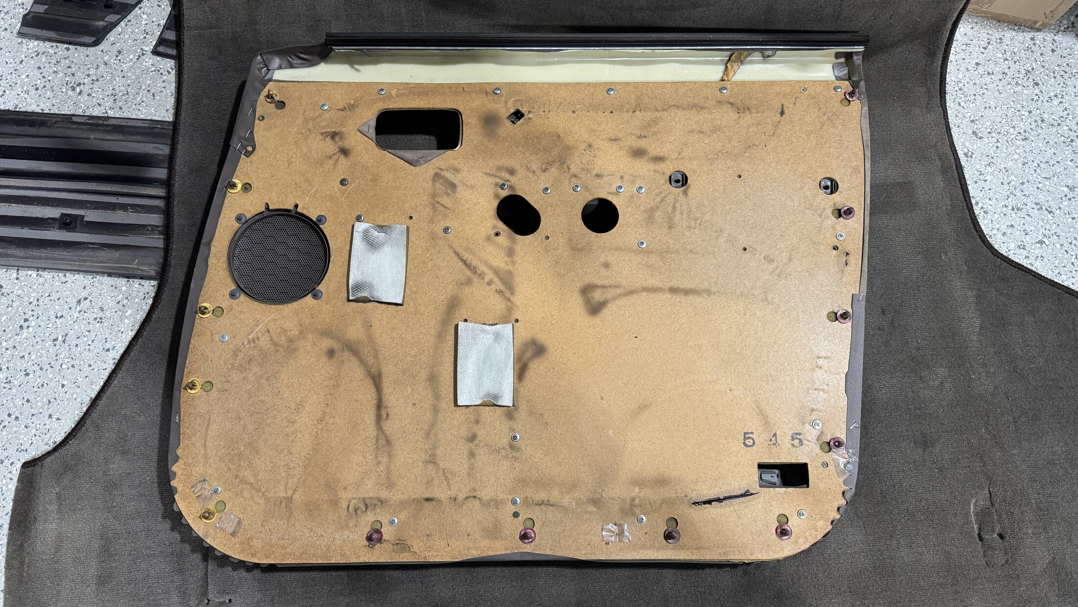

The door cards need a little TLC. They're in nice shape overall but there's some water damage and cracked MDF or whatever the backing is made out of. And that's got me thinking about Orikawa door cards... and bigger speakers... $$$

I wonder if your water leak is the mounting holes for the belt rail trim (the trim below the rear quarter window) rather than the body vent. In my experience, these are more likely to allow water in than a faulty vent.

Agreed, I'm not sure where the water was coming in now that I think about it. My belt moulding was only 6 months old so I assumed it wasn't leaking, but maybe I need to add a little sealant.

As much as I would love some gull wings I'm not ready to spend the money on that. Southeast Toyota dealers were having a 25% off sale and free shipping so I was able to get everything for a solid window conversion for $350.

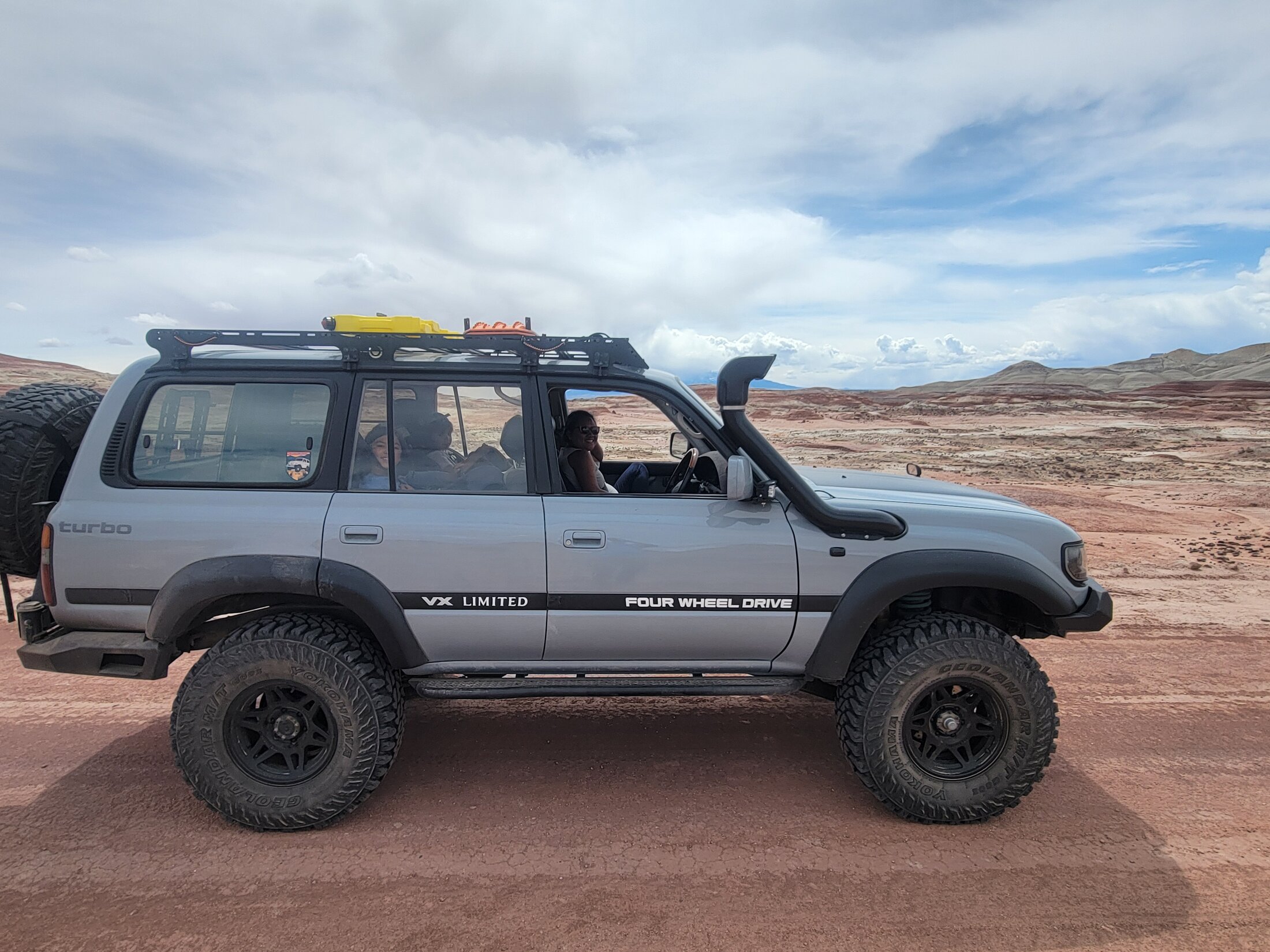

I have this bad habit of putting off projects that require disassembling the cruiser, and this week it all came to a head. My windows are slow, my speakers are blown, two power door locks aren't working, my rear sliding windows are leaking, as mentioned previously my louvers are leaking, my AC isn't working very well, I have an ATF leak I can't seem to track down, and my aftermarket fender flare trim keeps falling out of place... so it's time to park the 80 for the summer and turn what should be a few minor repairs into a snowball of a project and do it all at once.
First step was to leave it out in the sun and pull off the VX Limited trim. I don't mind the trim itself but mine is showing its age.
It's held on with three rows of double sided adhesive. Peeled right off after 30 min in the sun.
Didn't know there were holes underneath. The VX trim has small pegs on the back that fit in the hole to line it up but the new "4wd" trim I have doesn't seem to have those. I'll probably fill the holes.
I realized I should have washed the cruiser first, oops.
Covered up each hole with duct tape, took out the rear carpet/interior and washed it. Parked it where it will sit for the foreseeable future.

Cleaning up the doors and all that butyl stuff that was holding on the vapor barrier takes some elbow grease, but it's cleaning up nice. Lots of goo-gone and simple green.
