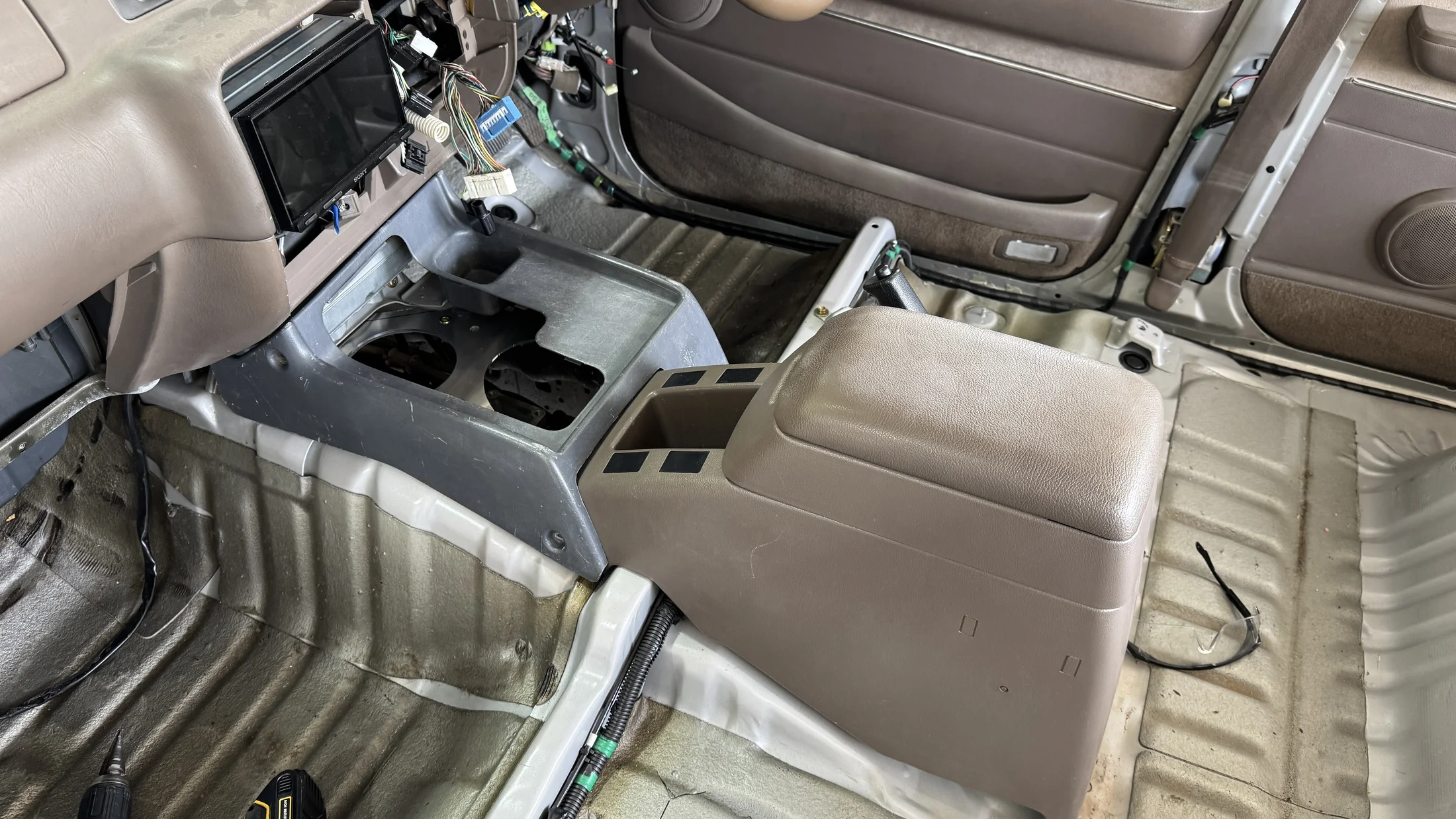

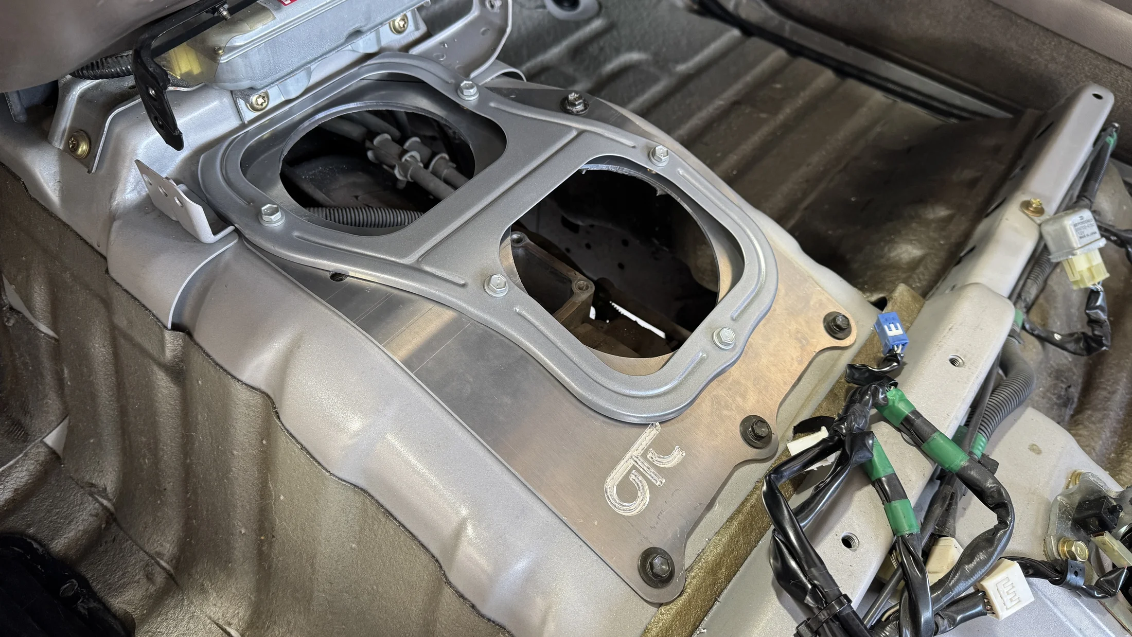

Mocked up the center console and shift console. I found the shift console on eBay Australia.
Looks like everything fits fine. The forward mounts line up, but the rear mounts in an auto are on the auto shift plate so I'll need to design a bracket for that.

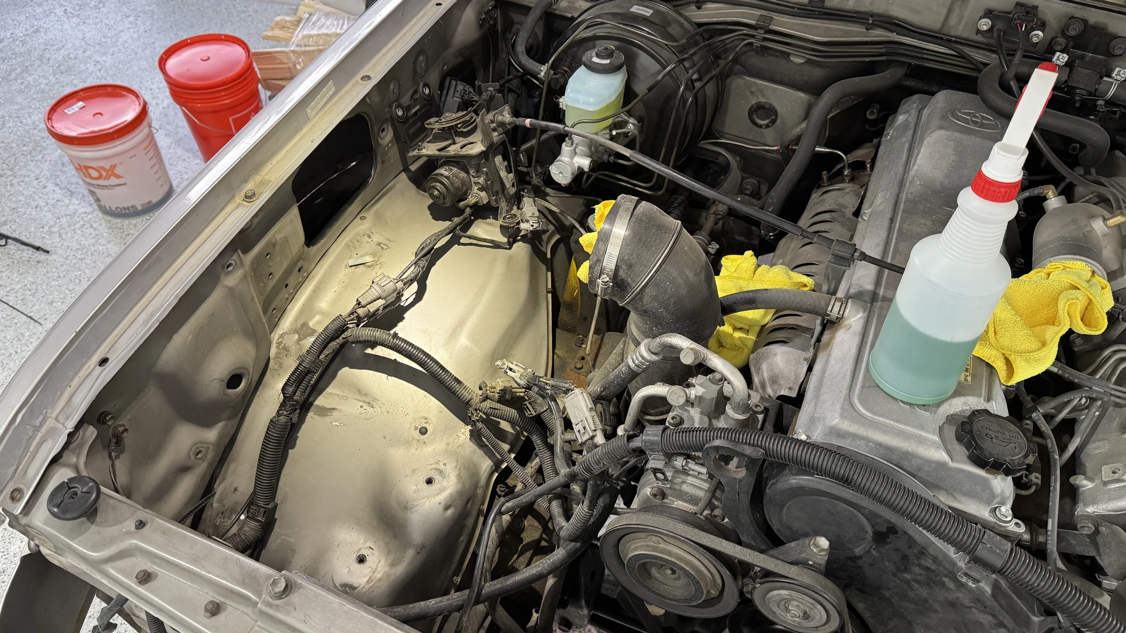

Worked on widening the airbox inlet. Not the prettiest but it'll work.

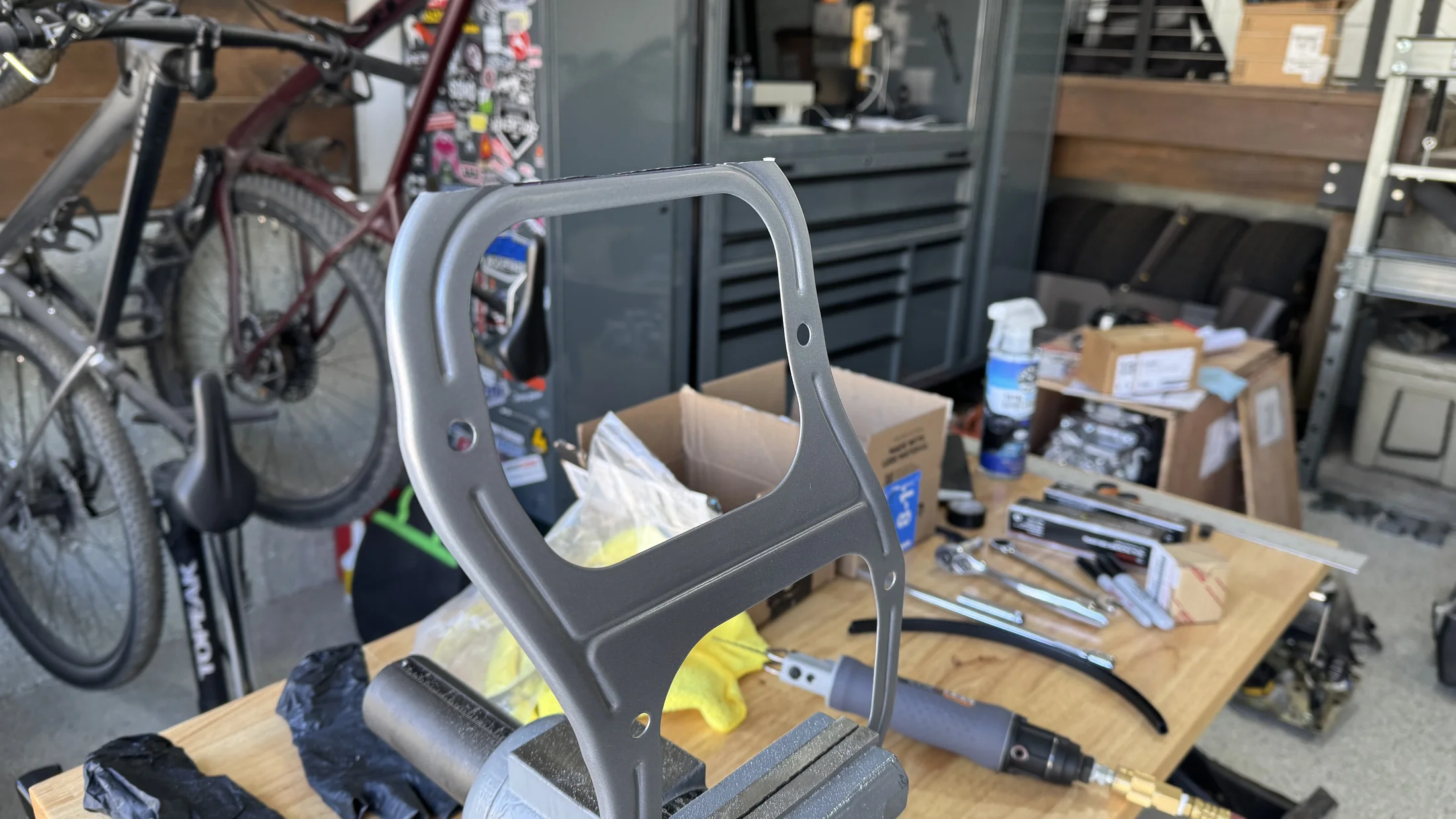

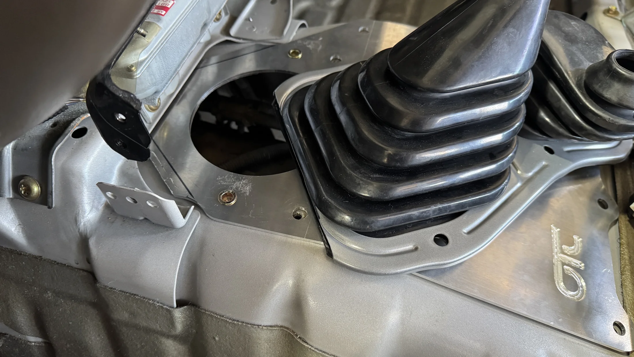

Hate to cut up NLA parts but I took a 1/2" off the front of the shift boot metal surround and the rubber boot.

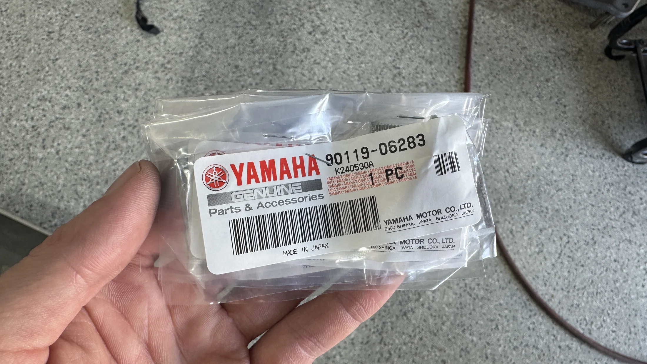

Part no. for the shift boot bolts. The Toyota bolts are NLA but Yamaha shares some part numbers and Impex pulls up all manufacturers at the same time, like Hino, Toyota, Yamaha etc. Thanks for the tip on that one @logicbyondreaso

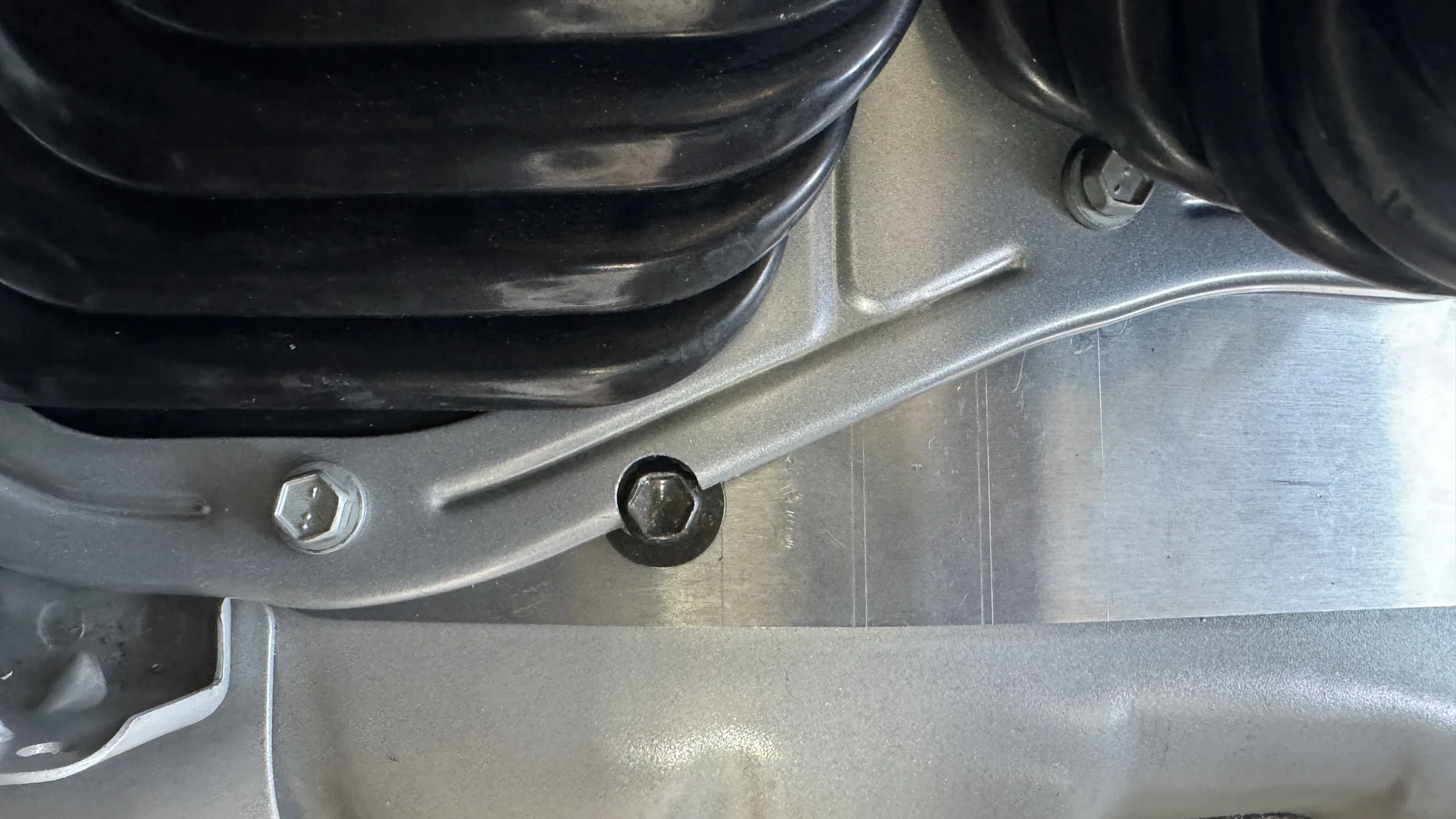

Looking good, last thing to address is the final bolt on the left holding the OTC plate - it interferes with the shift boot surround. This was my solution, a little time with a die grinder:
🤯 I had no idea this was a thing. THANK YOU

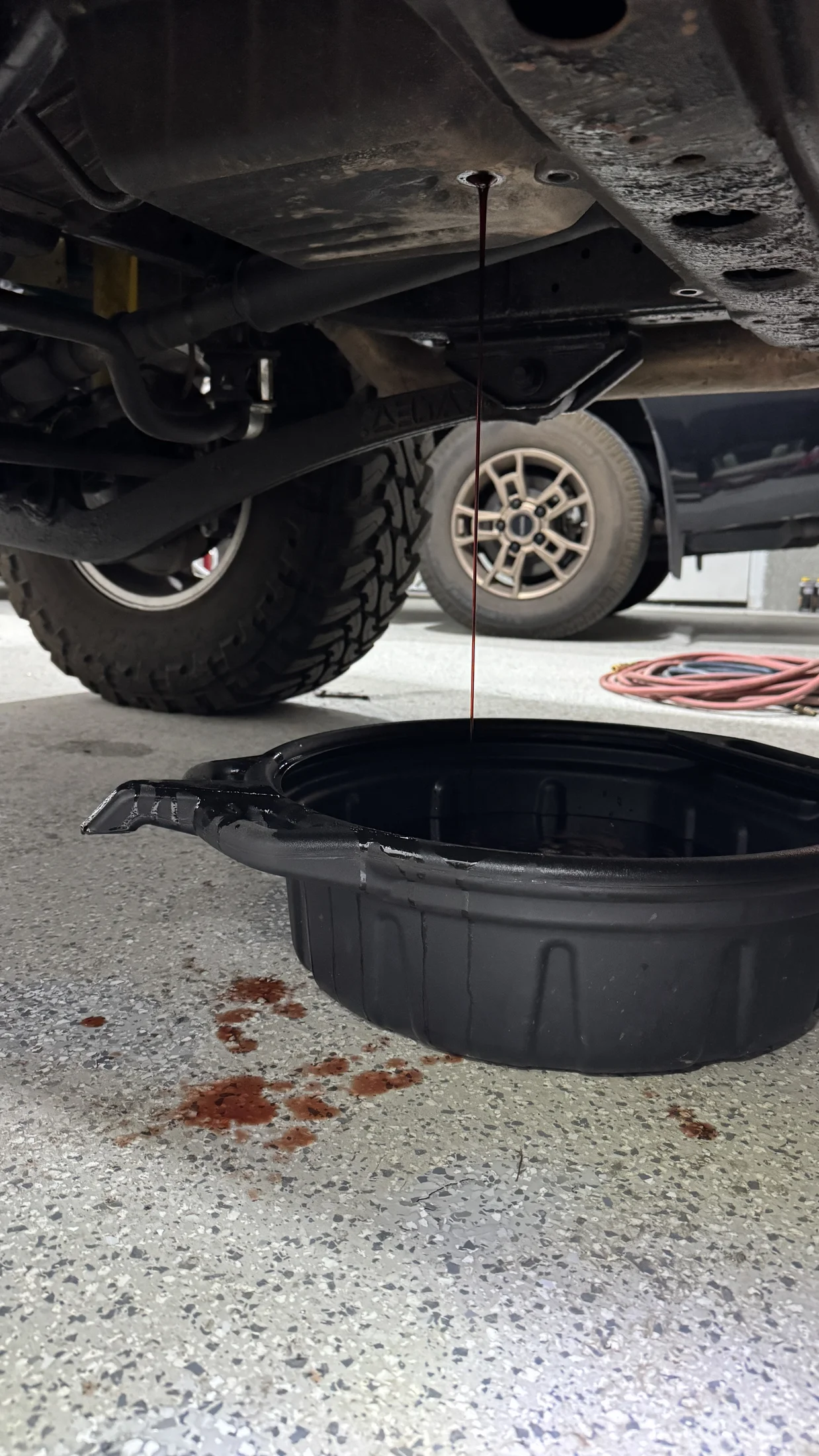

Changed my oil today and it was red, you guys ever seen that before?

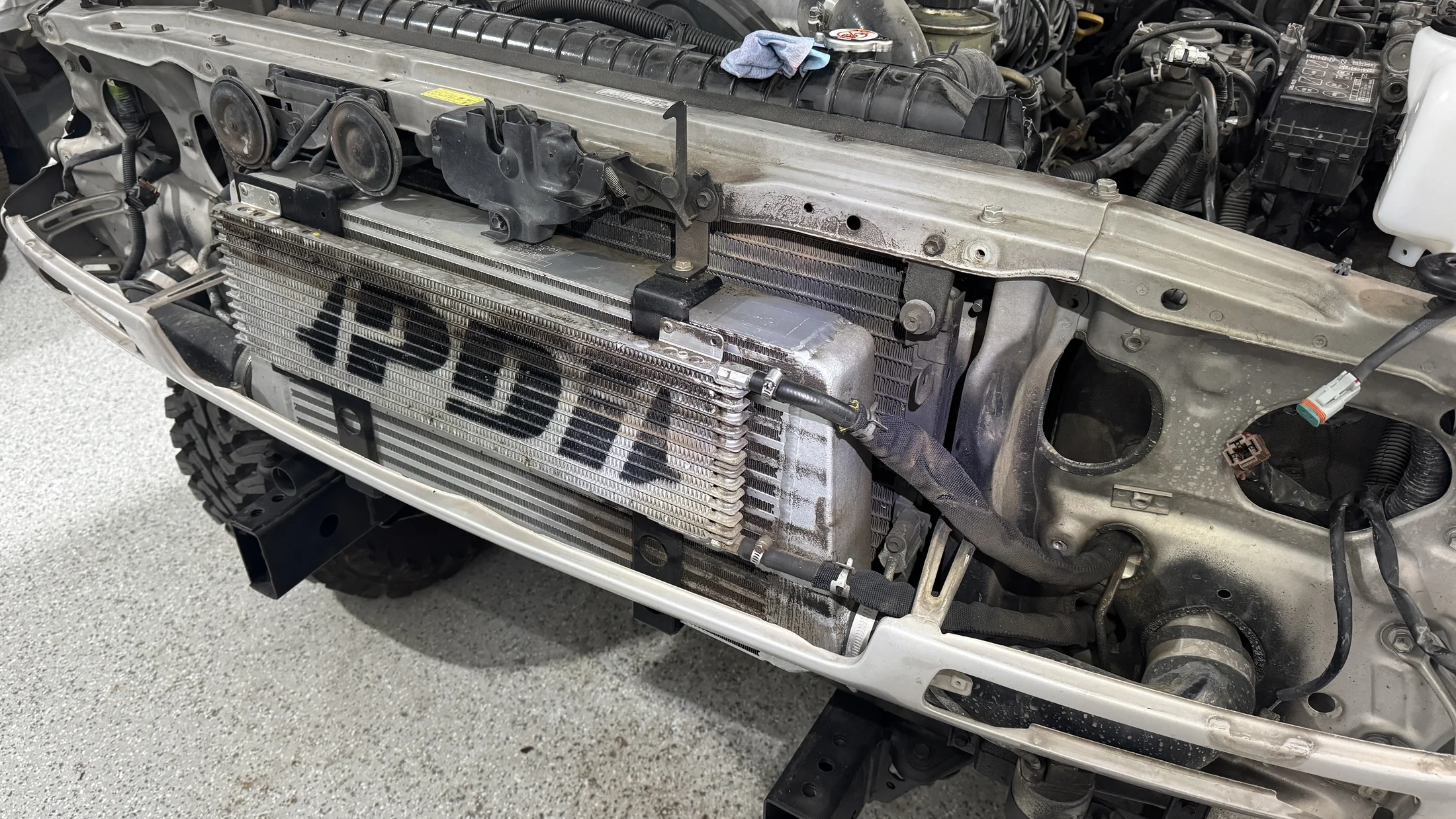

jk jk it's time to get this transmission out of here. Took off the PDI trans cooler and removed the lines. The cooler is riveted onto a bracket and bolted onto the intercooler so very easy to remove, now it's a manual spec intercooler.

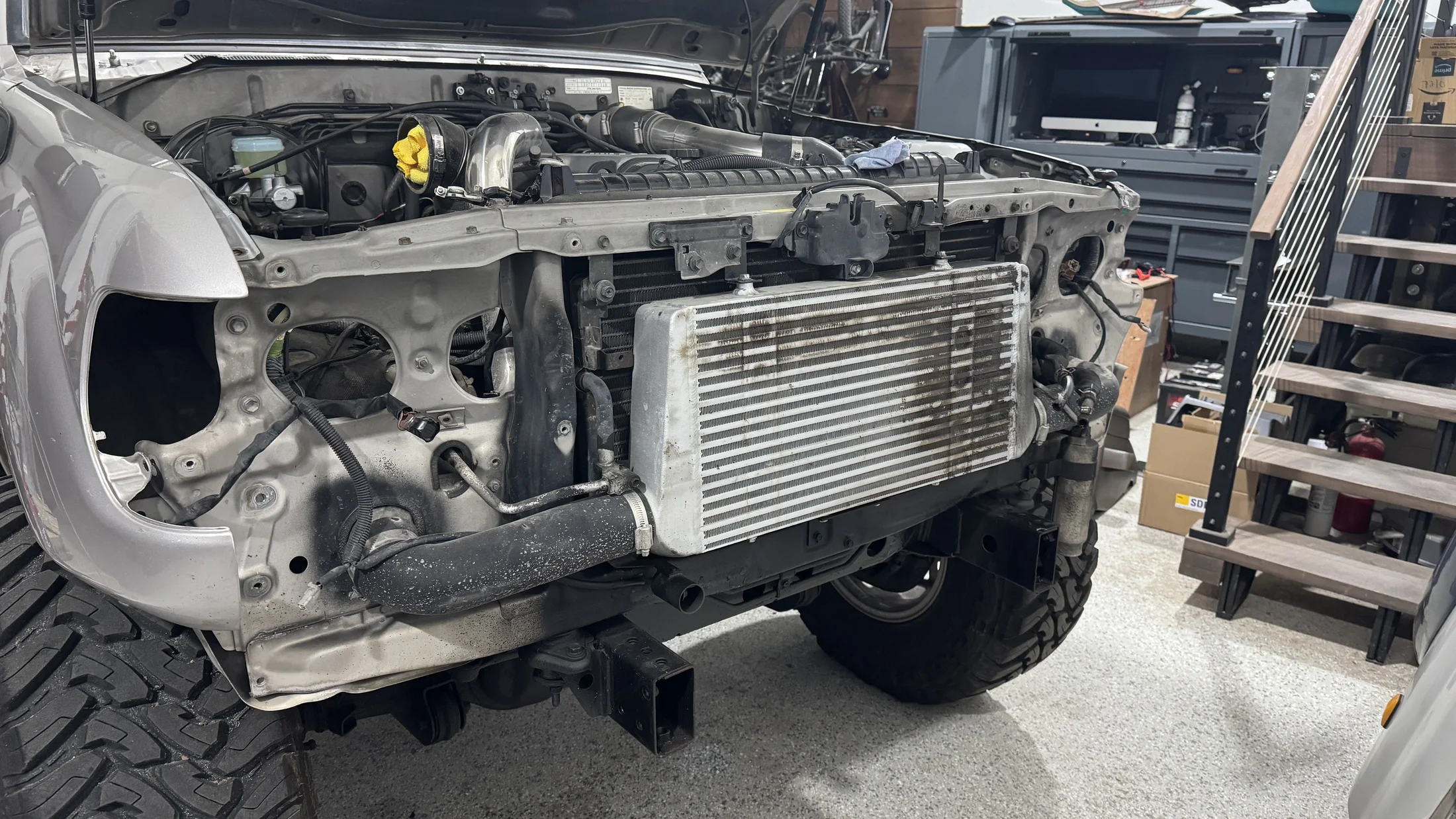

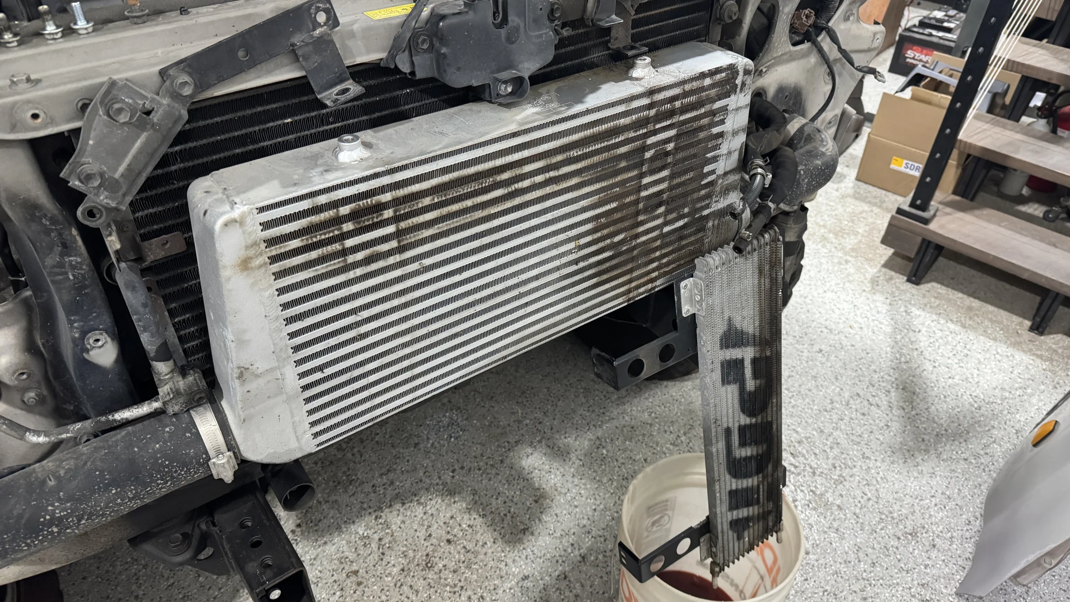

One of my trans cooler lines was leaky so the IC is covered in a mix of atf and dirt. Need to clean it up. Lots of atf leaking underneath too, from the cooler lines back to the transfer case. That's actually what got me thinking about a manual swap in the first place. As I started chasing the leaks I started thinking how nice it would be to simplify everything

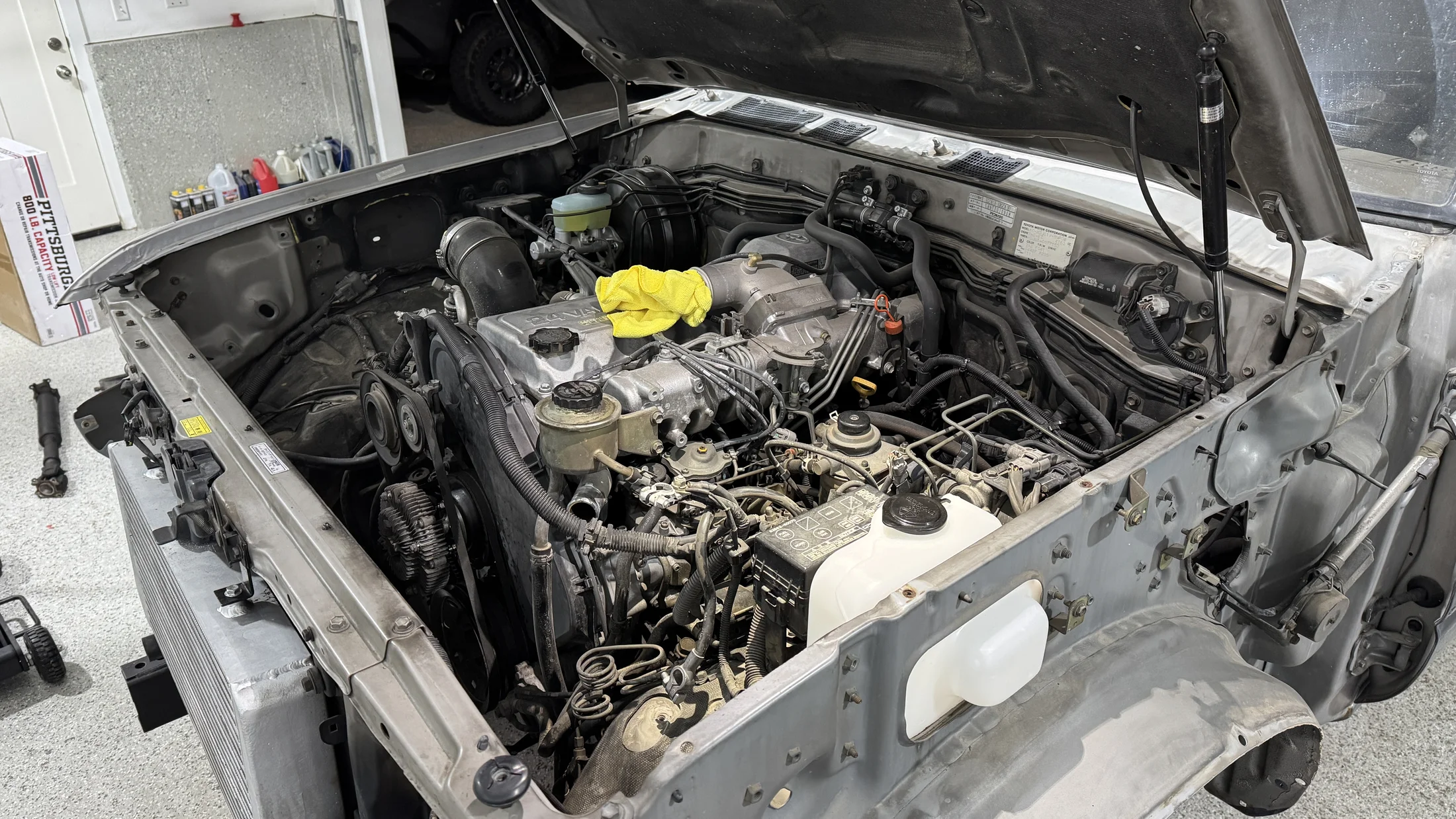

Removed driveshafts, radiator, and fan shroud. I'm going to knock out timing belt, water pump etc. while this is all torn apart.

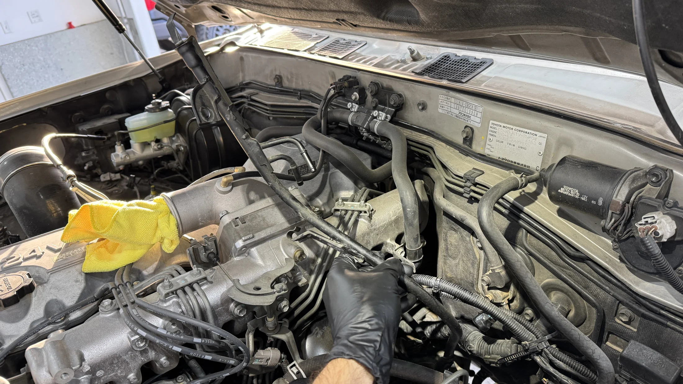

Removed kick down cable, oil cooler brackets and dipstick. Not much info about the dipstick in the FSM but it's very simple, unbolt it and remove the vacuum lines and it lifts right out - seals with an o ring.

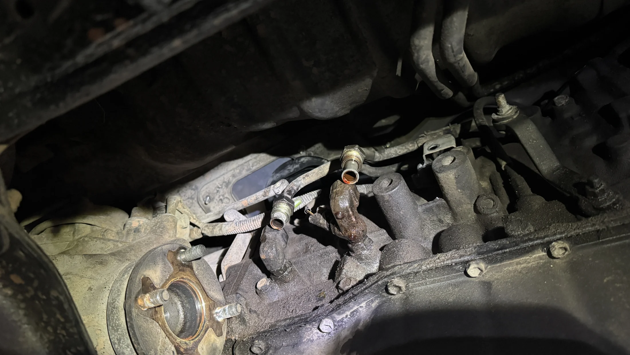

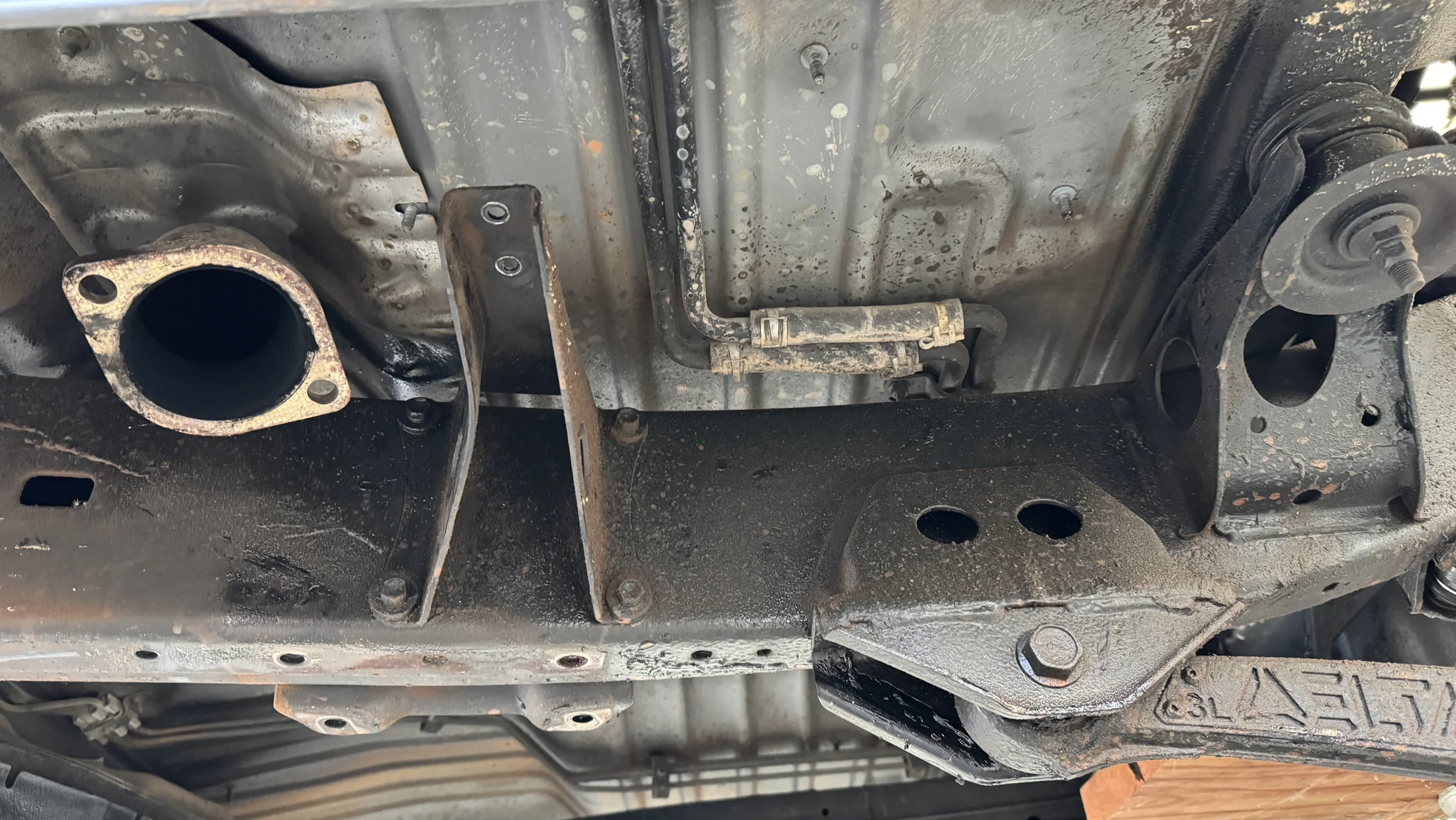

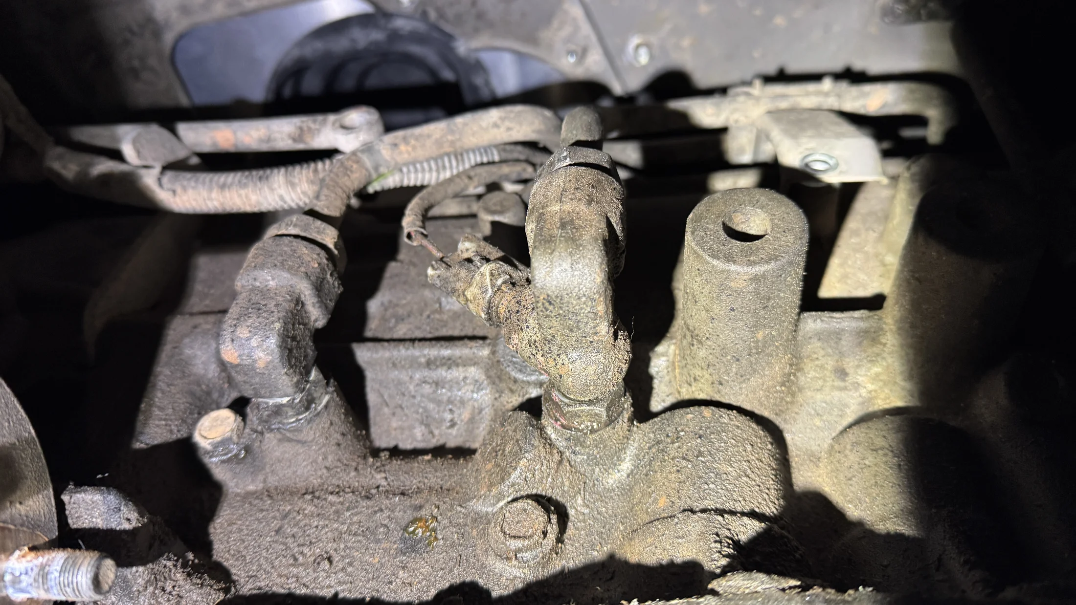

I'm held up where the oil cooler lines connect to the transmission. Anyone have any tips for disconnecting these? Hard to get a wrench up there. I'd rather not cut the lines

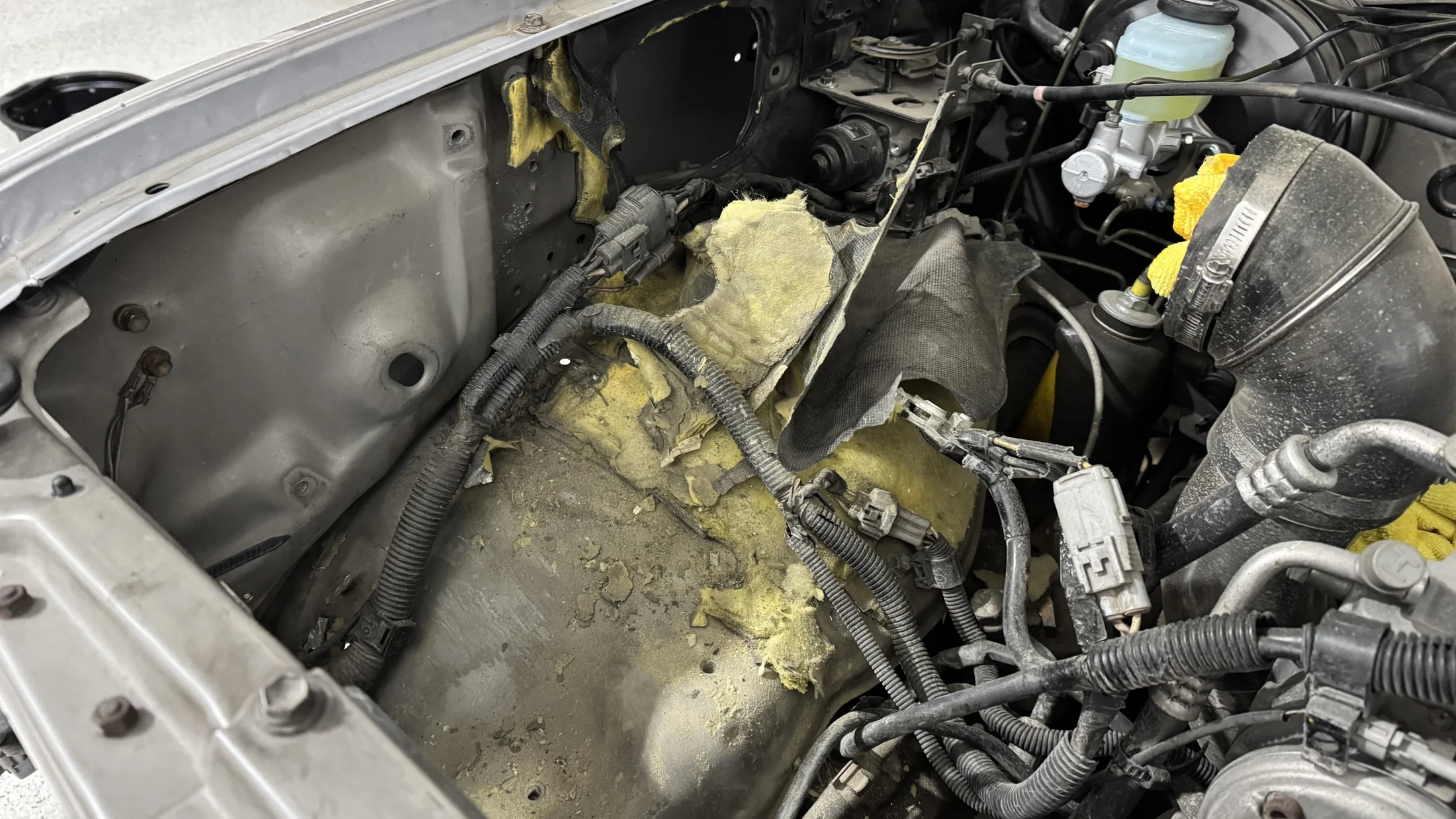

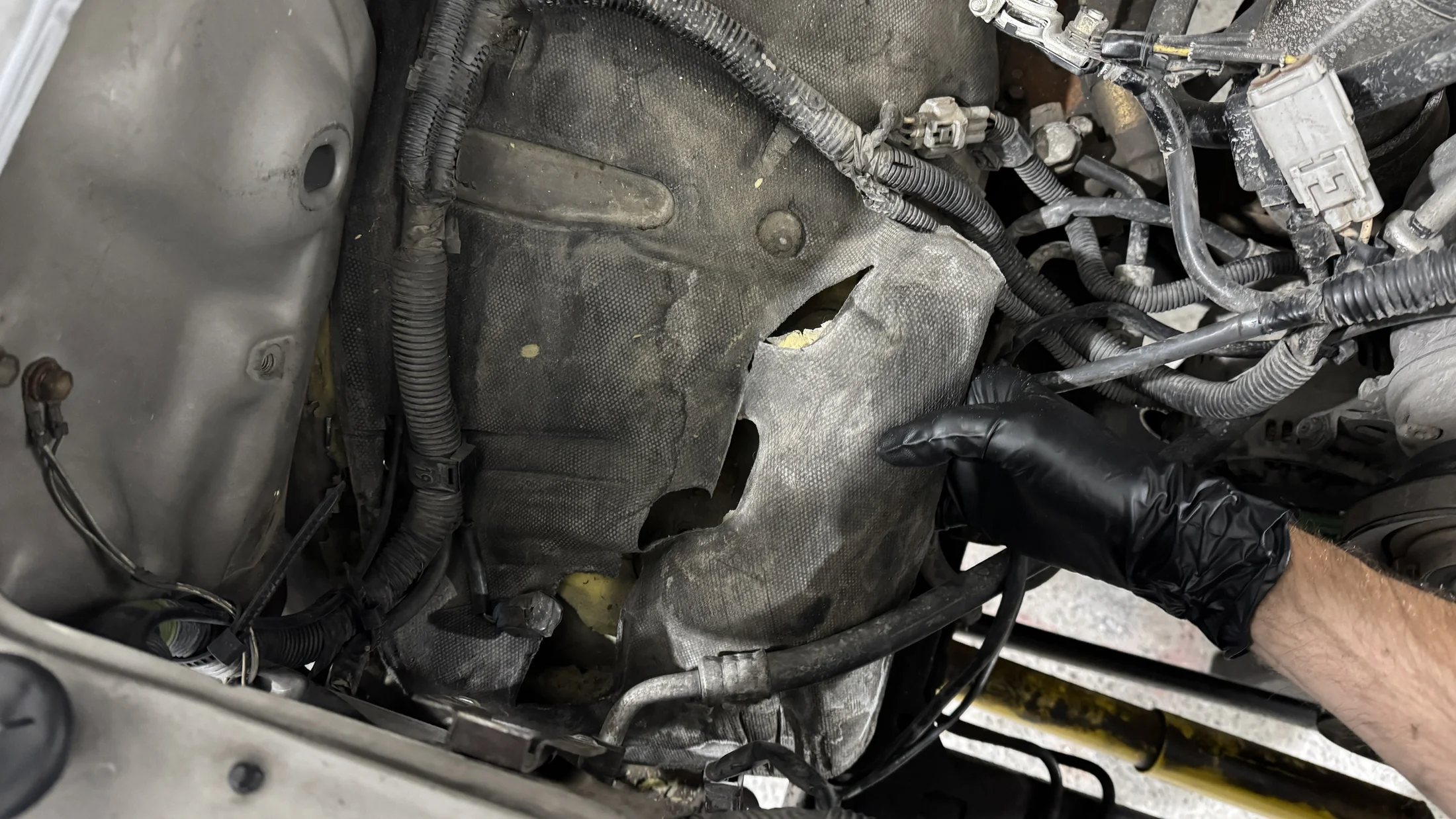

My fender well insulation has been looking sad. Tried to lift it a little and it just started crumbling....
hopefully Japan wasn't using asbestos in 1997...

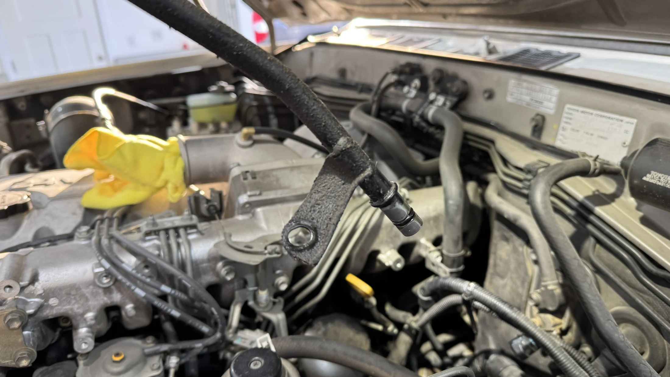

Have you tried a “crows foot”?
Just ordered a set this morning. Gonna try that next
I often used those when I turned wrenches on fighter engines. Many tight spaces. The crows feet work, but suck to use at the same time. Good luck, I know you’ll get it.
That's rad. I've been slowly adding tools to my collection every time I run into a snag. Works well if you don't have to daily the truck and it can be down long enough for a HF run or Amazon Prime. I'm getting to the point where I have a decent set of tools, though I have about 20 different brands in the tool chest

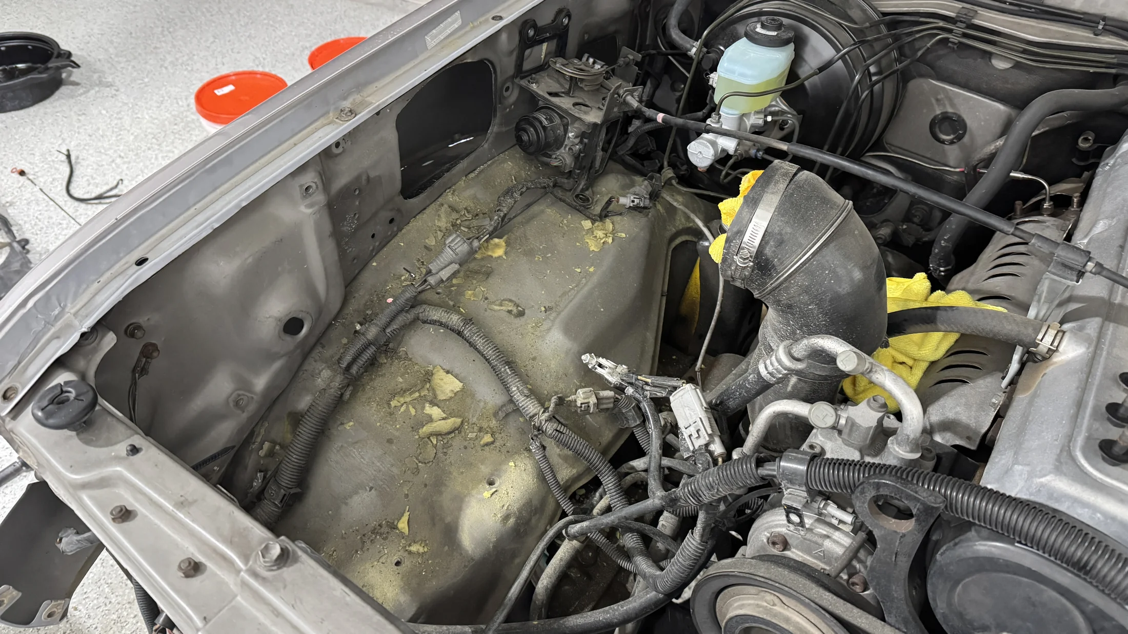

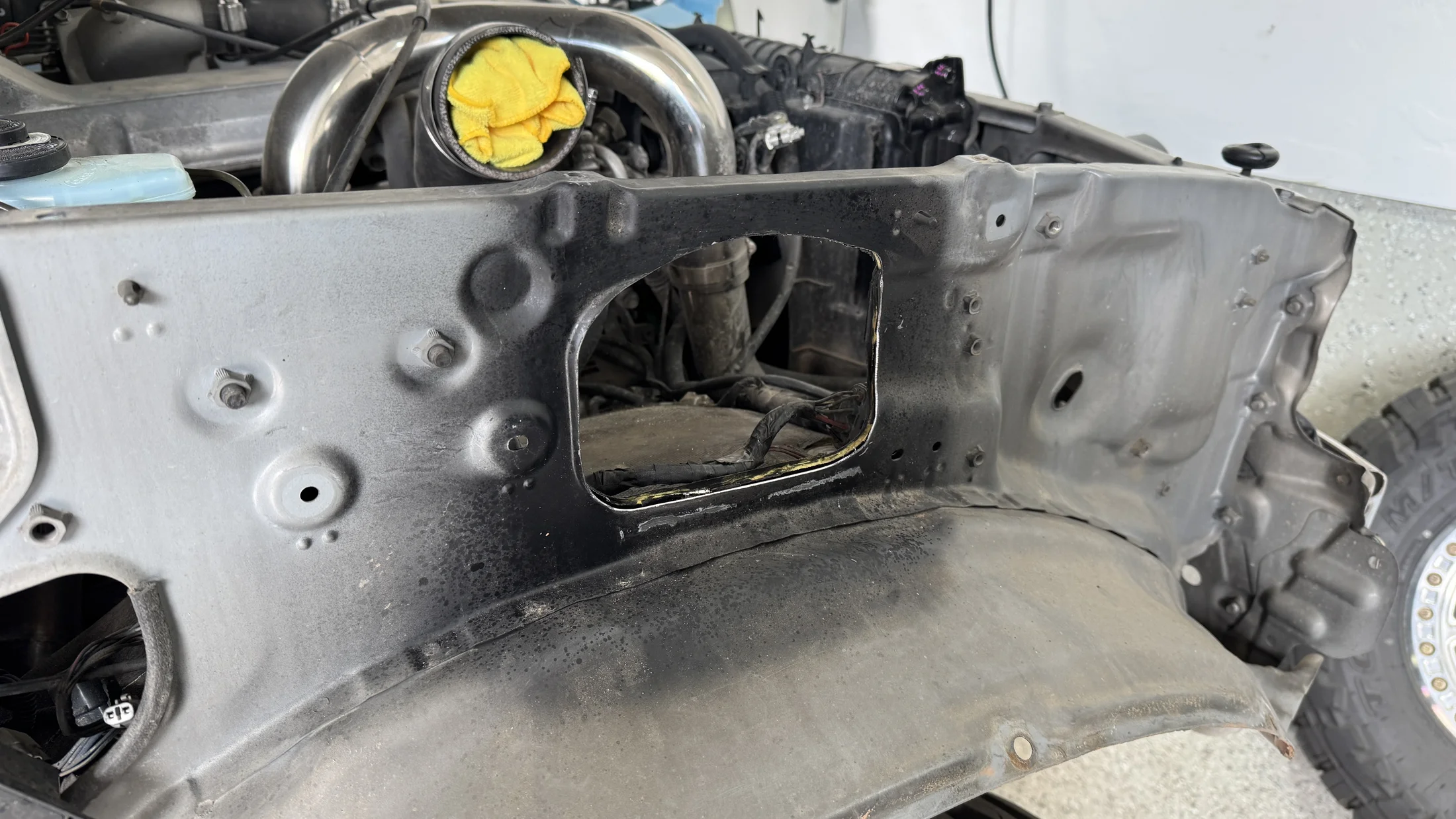

Fender well cleaned up nicely after removing the insulation.

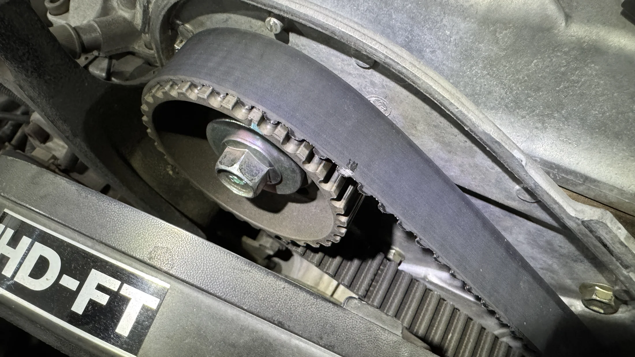

Timing belt looks great. According to the Japanese sticker it was last replaced 6 years and about 65K kms ago.

Crow's foot + breaker bar did the trick on the oil cooler lines but it took some force

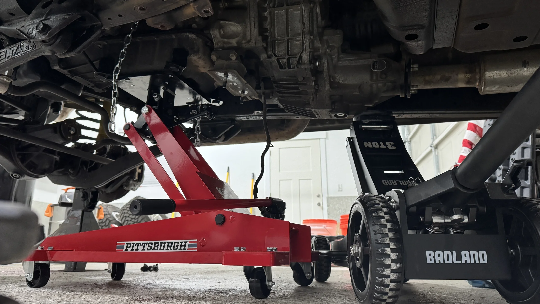

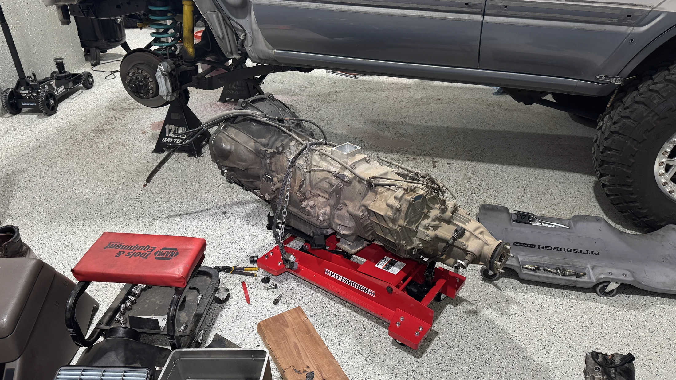

Removed the torque converter bolts, unplugged all connectors, removed transmission crossmember, and dropped the transmission to reach the bellhousing bolts
All the bolts were easy to reach. Even the top two weren't that bad going through the shift console in the cab, with a couple extensions.
I was following the the RM184E FSM which didn't mention dropping the swaybar but RM451U did. Had to do that at the last minute when the swaybar was holding things up. Came down without too much drama

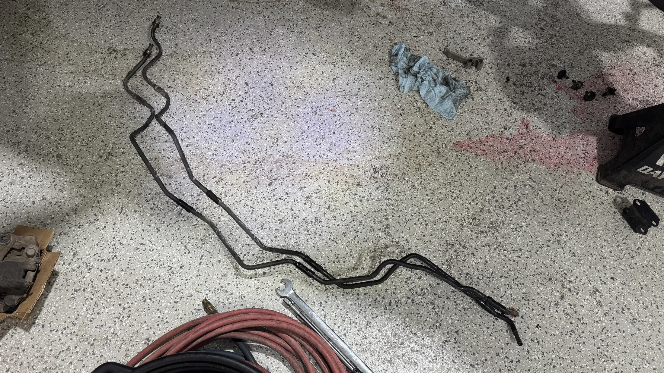

I was able to snake the oil cooler lines out too

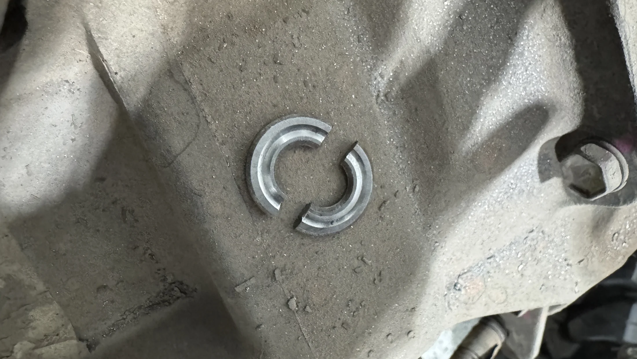

Mystery piece fell out of the auto transmission as I was moving it. Looks like a ring/spacer with a groove around it. Snapped in half - any ideas?

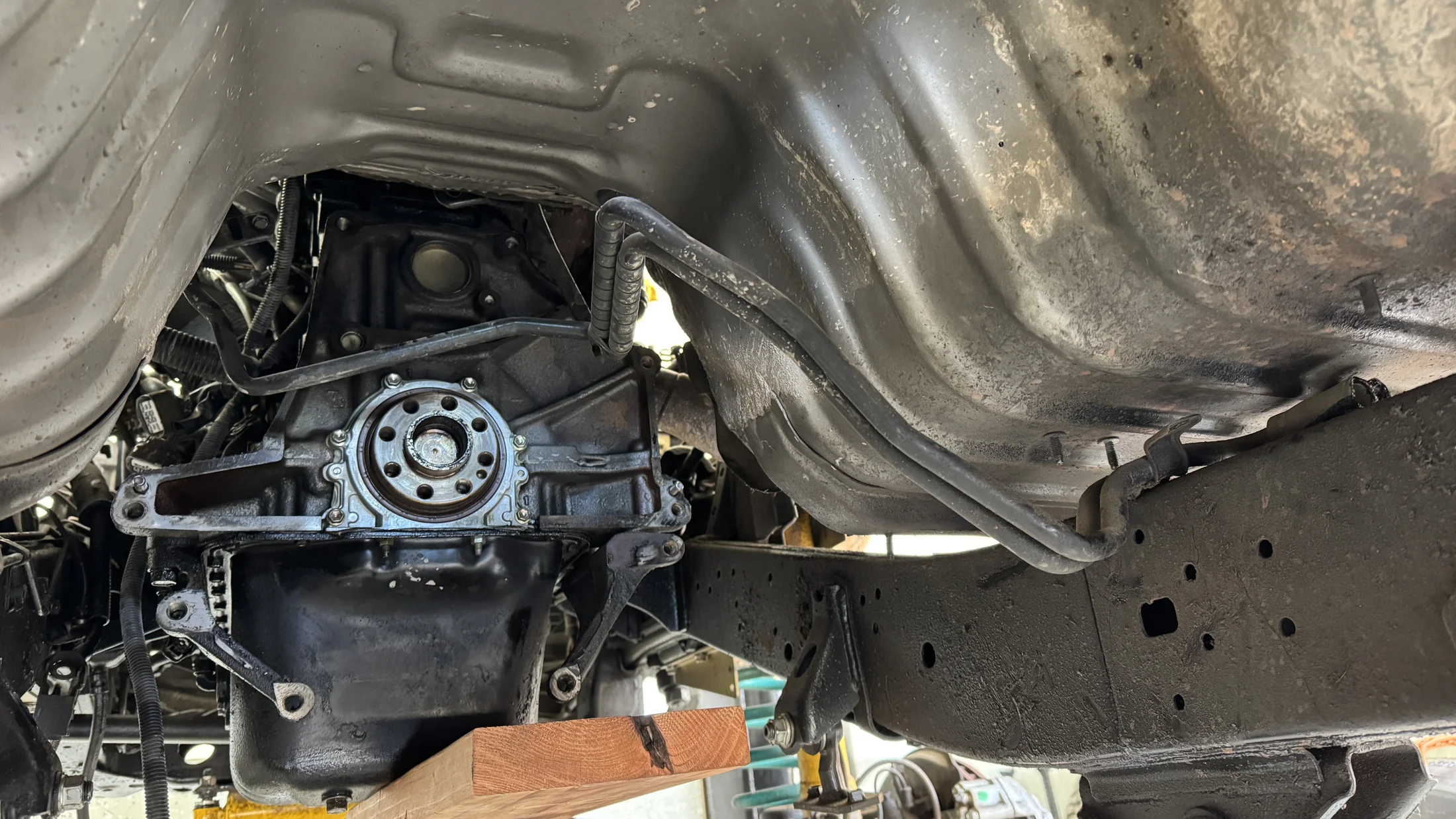

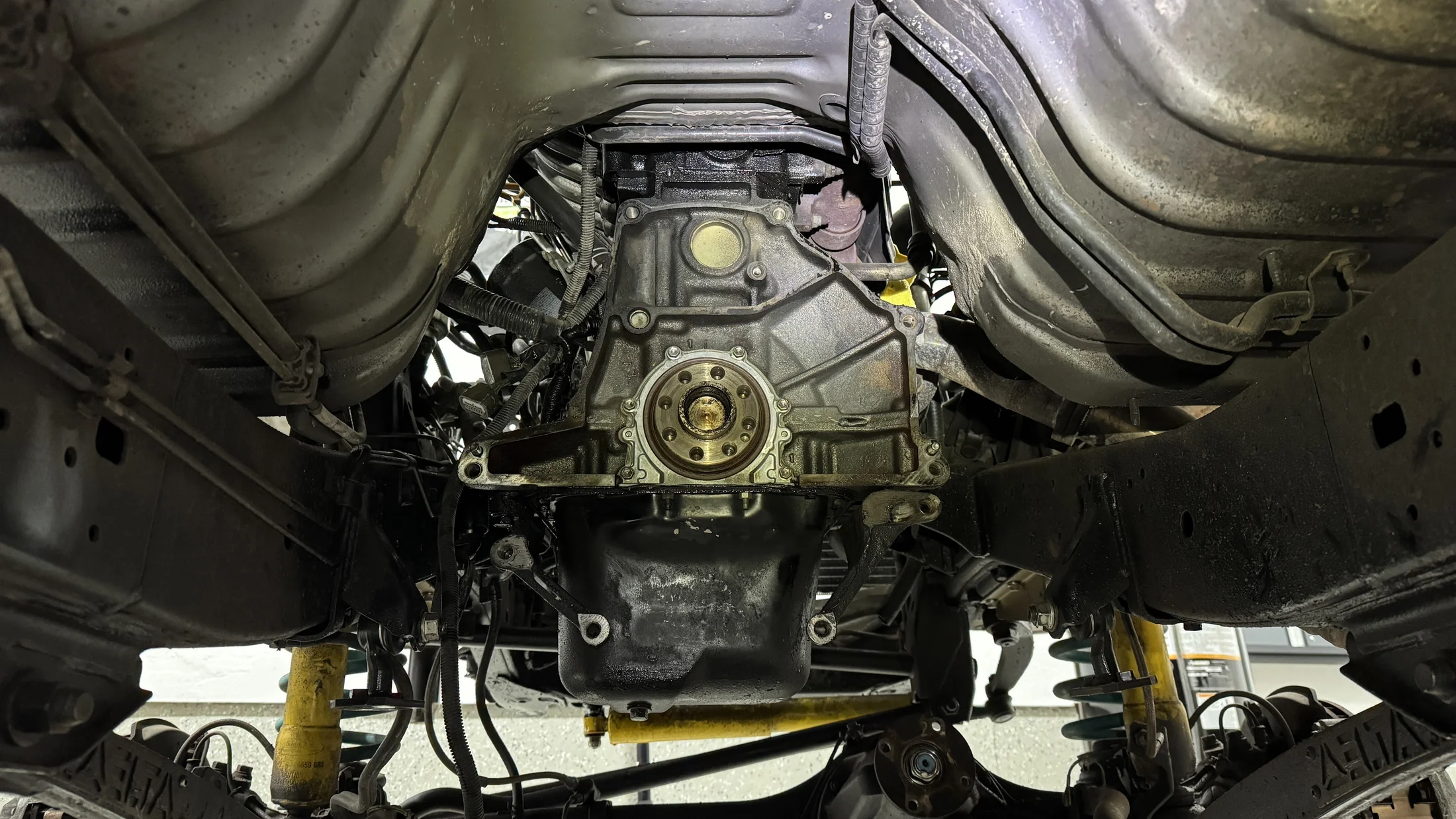

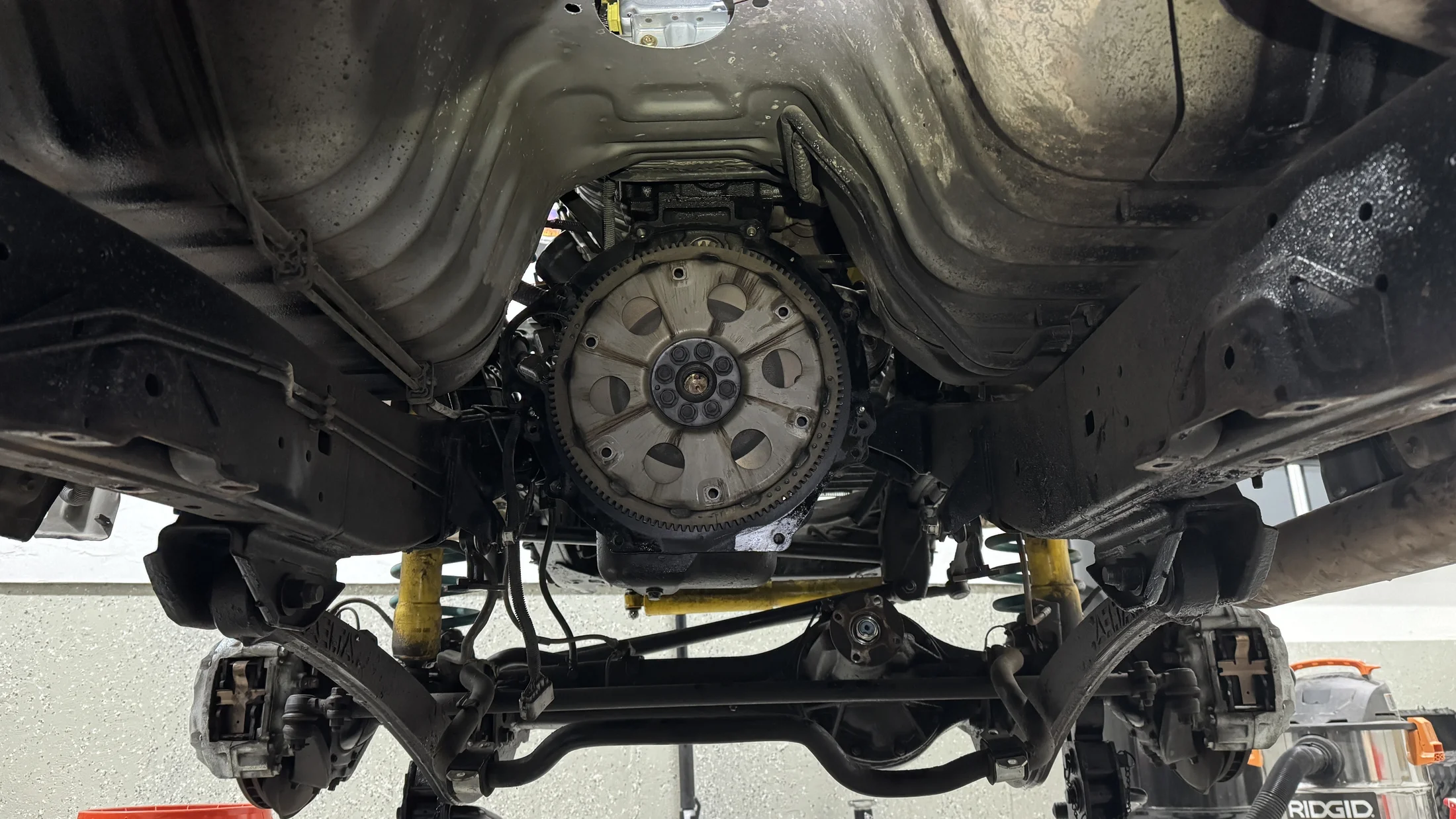

Removed the auto flexplate, flywheel and rear end plate. Rear main seal looks fine but I'll replace it.

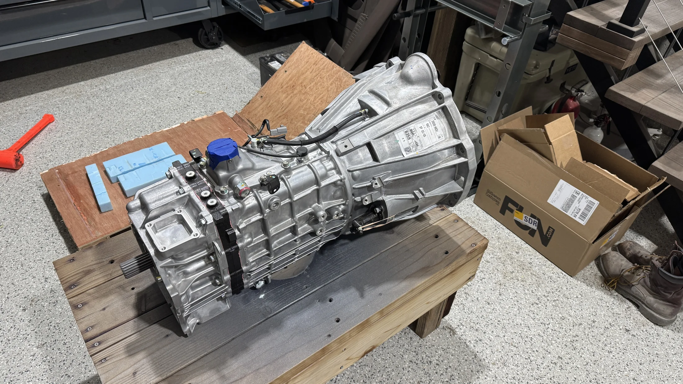

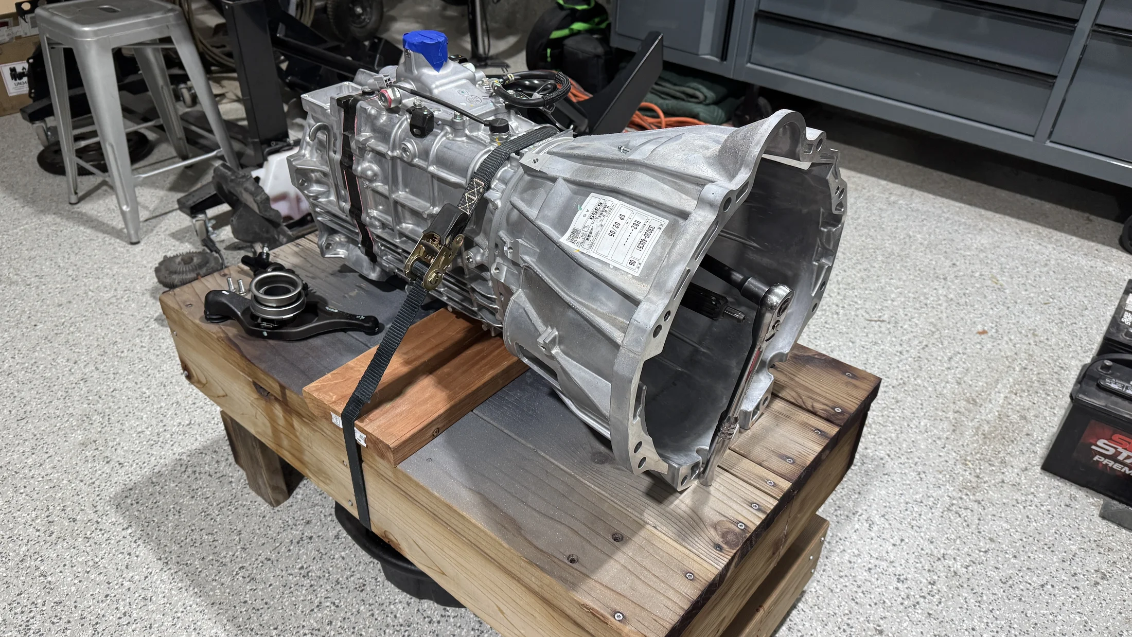

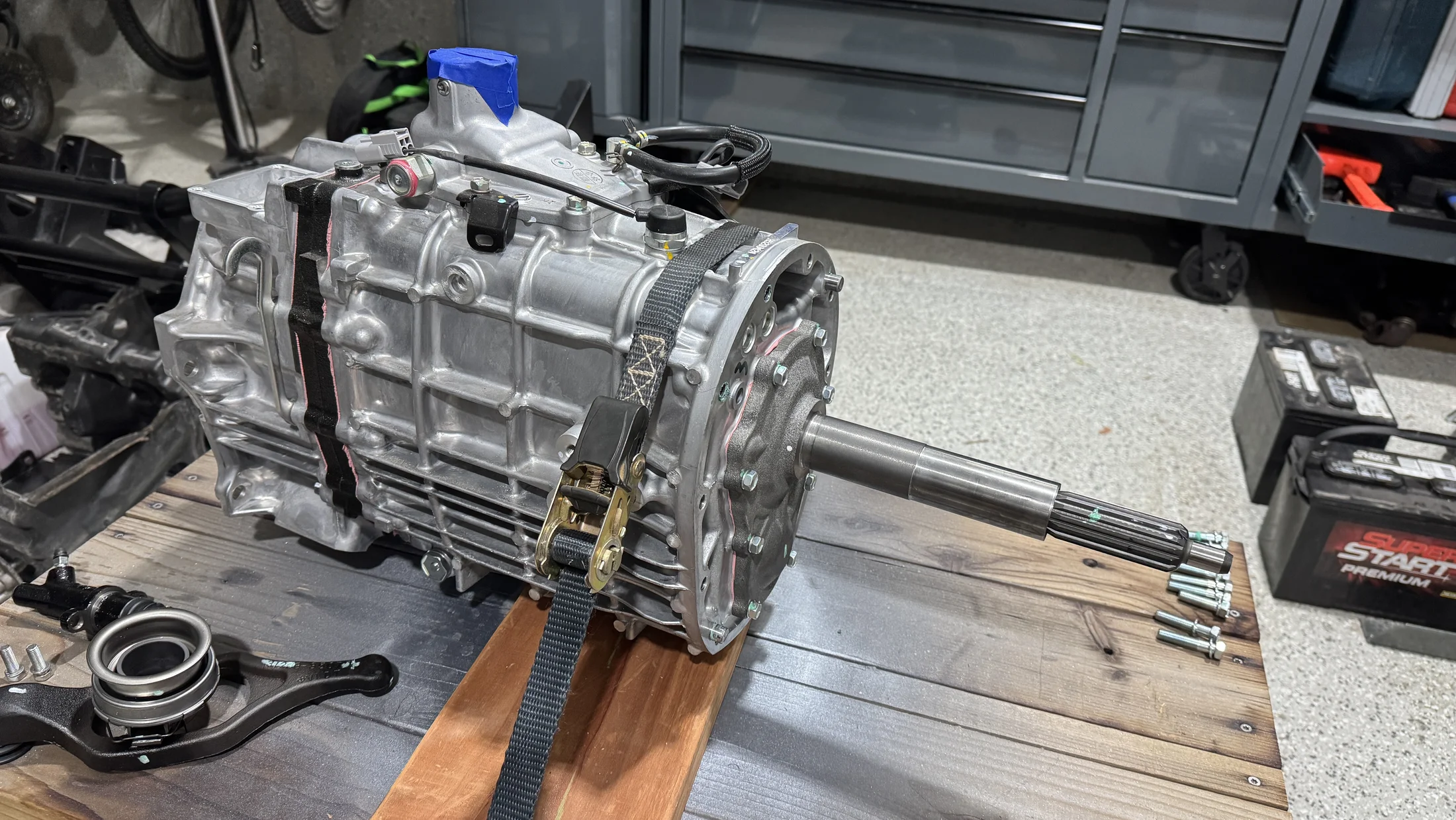

Pulled the H152 out of its shipping box and got it up on a little table my boys and I made a while ago out of scrap wood for fun. Works great for this.
Drained the small amount of oil it comes with from the factory:
Pulled off the slave cylinder and clutch fork, then strapped it down to remove the bell housing.
Next up, opening the case and swapping the input shaft/bearing retainer.

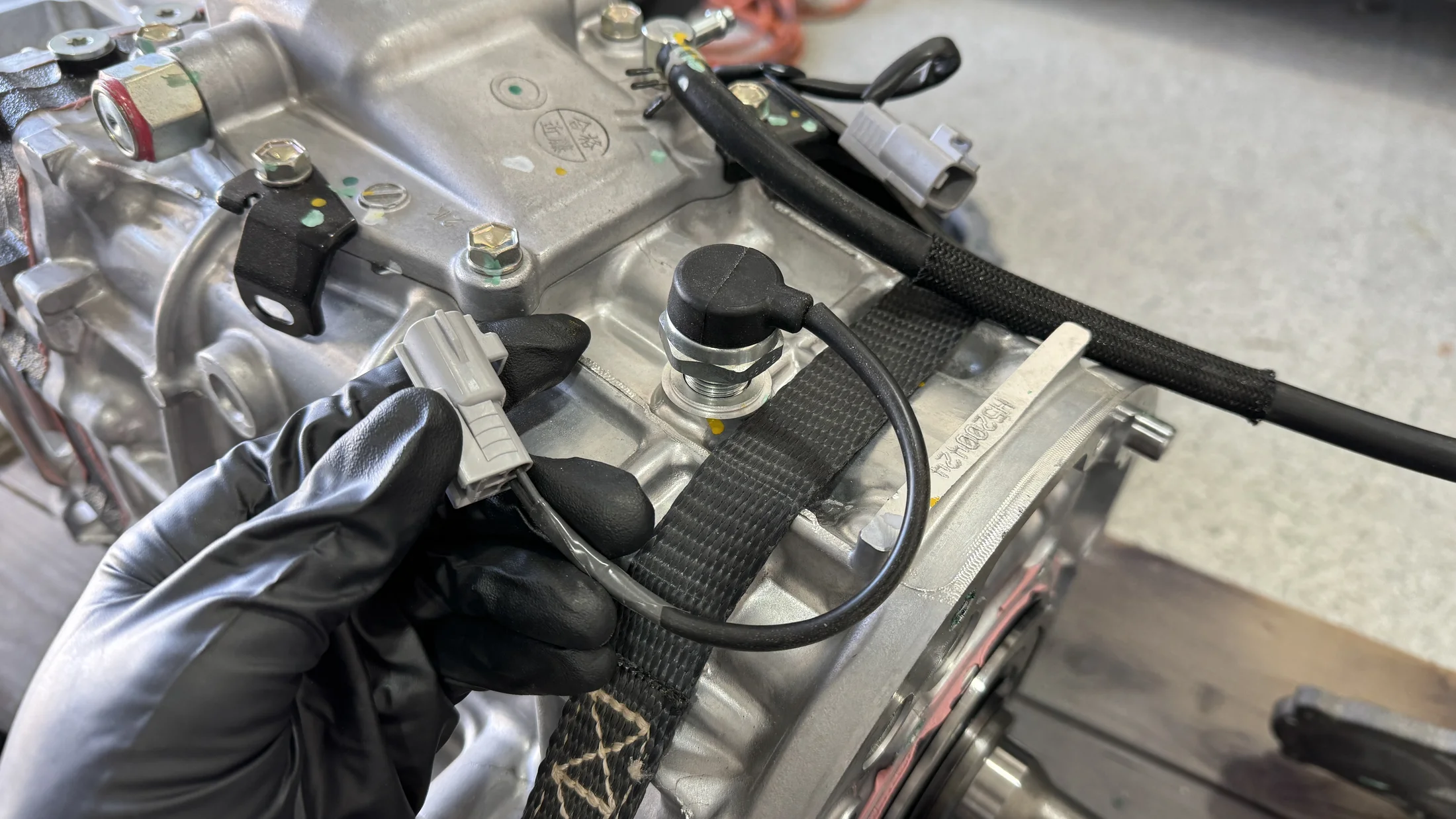

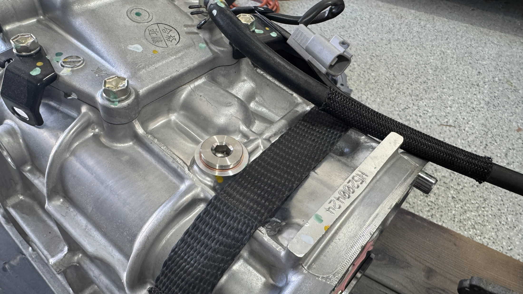

There are two sensors on the transmission. The one on the side is for reverse lights but the one on the top isn't used in an 80 Series. It's for cruisers with the 1VD-FTV - it senses when the transmission is in first and reduces power accordingly - guess there's a little too much power/torque.
I talked to @bottombracket a while back and got some tips from him - first is to cap off that top sensor with one of these:

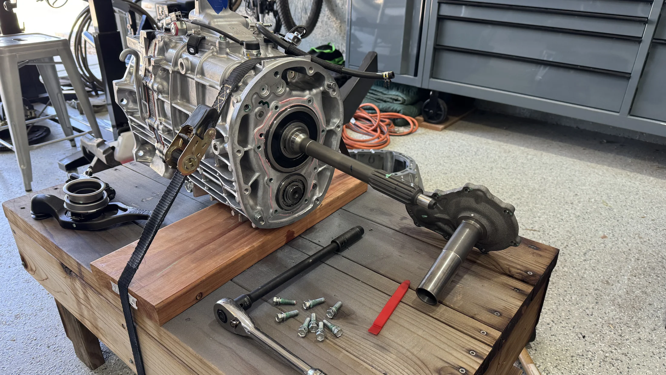

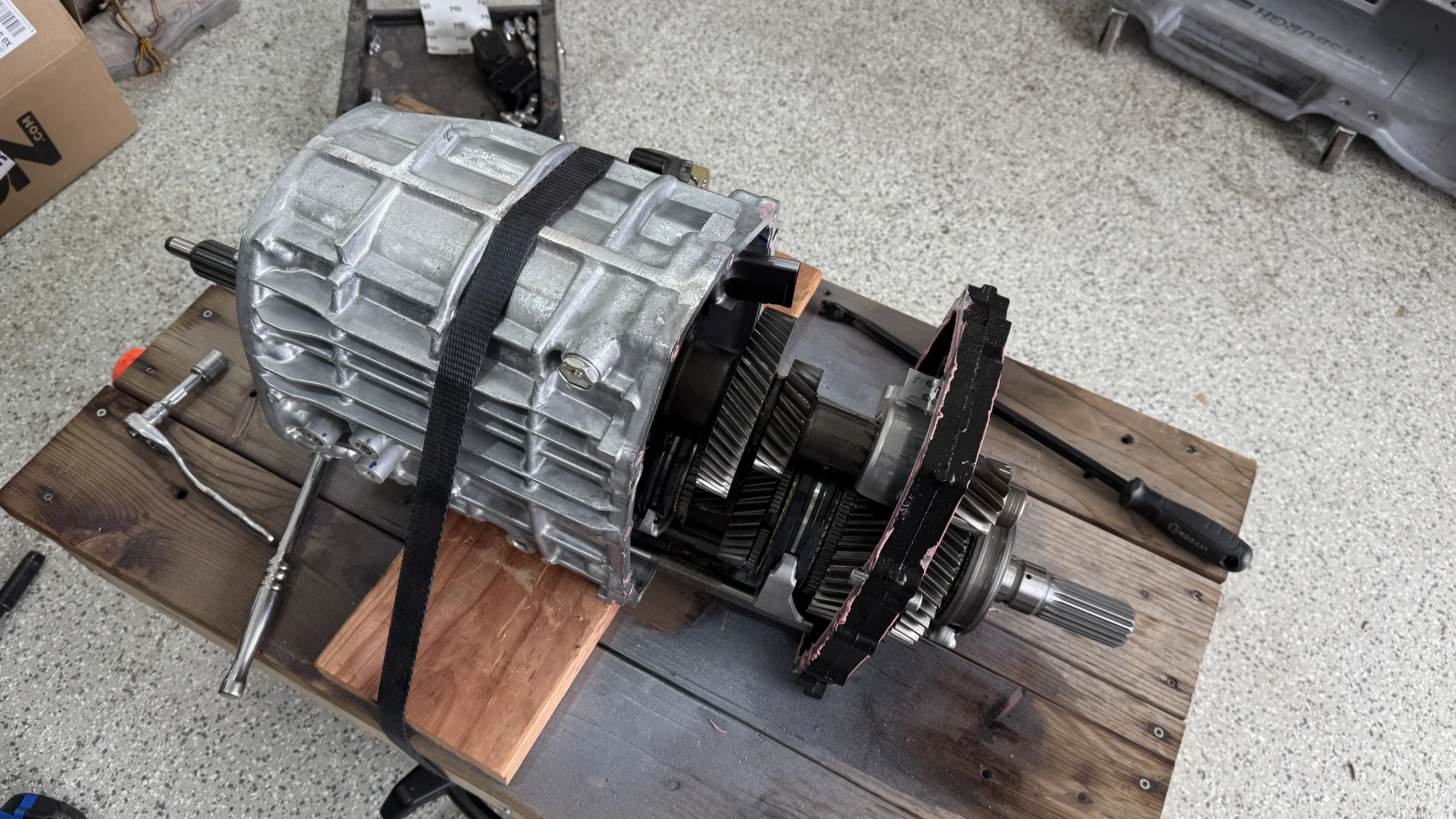

Basically followed the FSM for all this. Took of the rear transfer adapter, then removed the shifter housing and shifter, which is held on with a roll pin.
Little dead blow action and some careful prying and the case comes apart

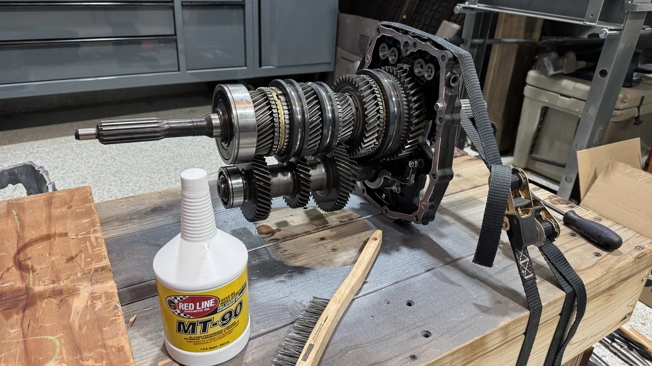

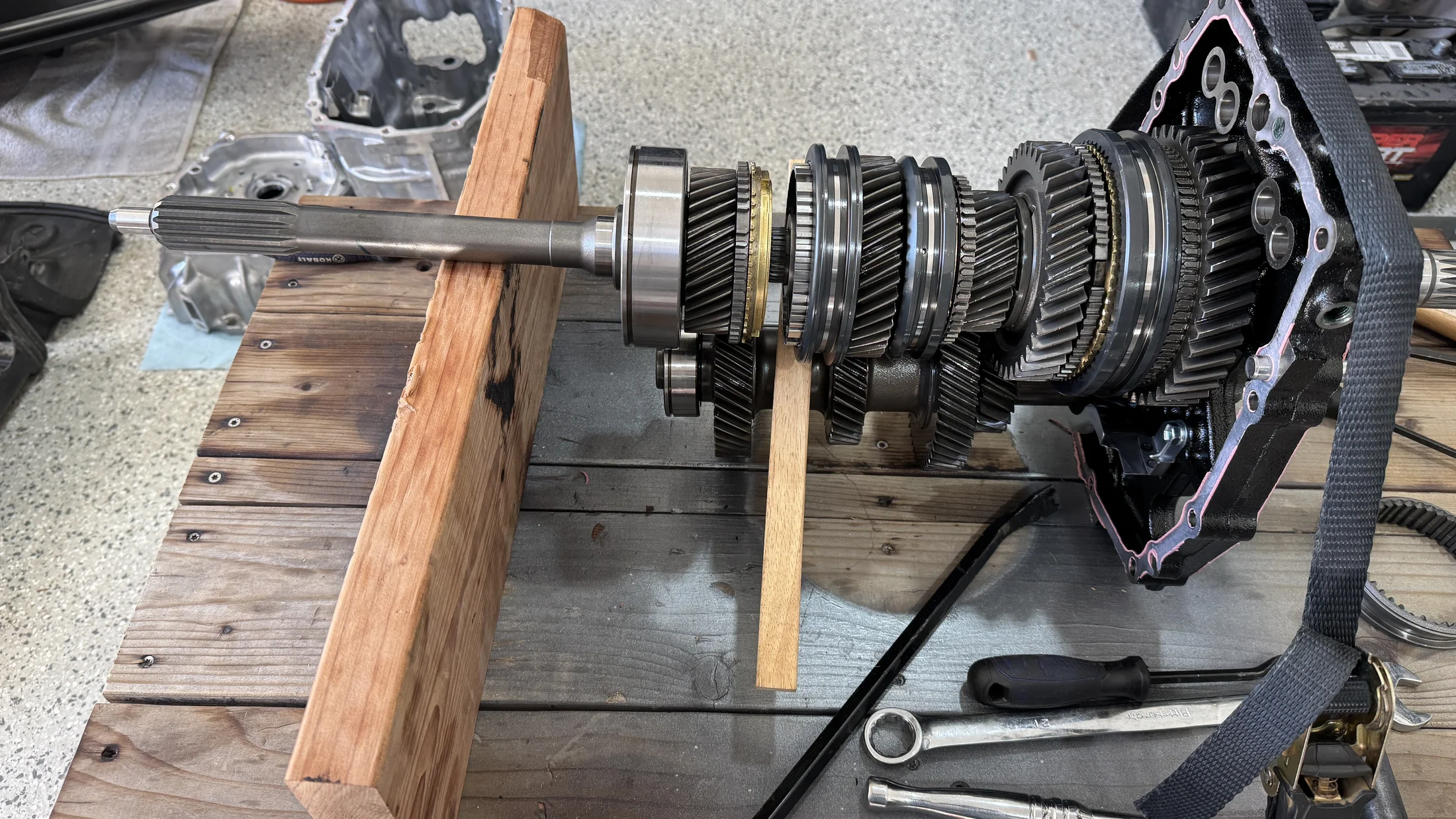

FSM calls for putting the assembly in a vice but this worked just as well to strap it down.

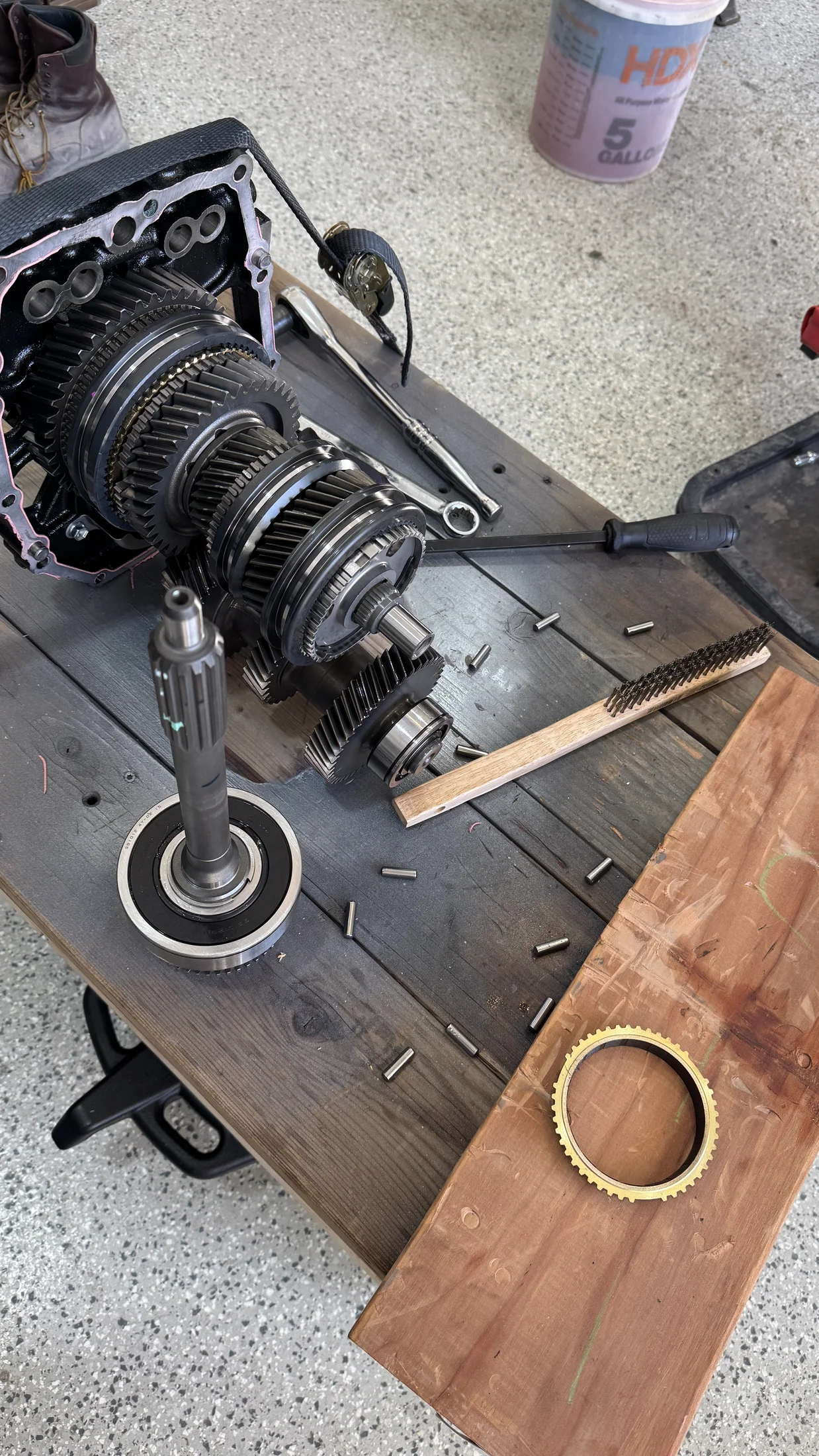

Instead of completely dismantling everything a la FSM to remove the input shaft, you can use a wedge to pry the two shafts apart just enough to pull the input shaft
EDIT: Maybe don't do this.. keeping reading
Watch out for the 12 roller bearings that pop out:

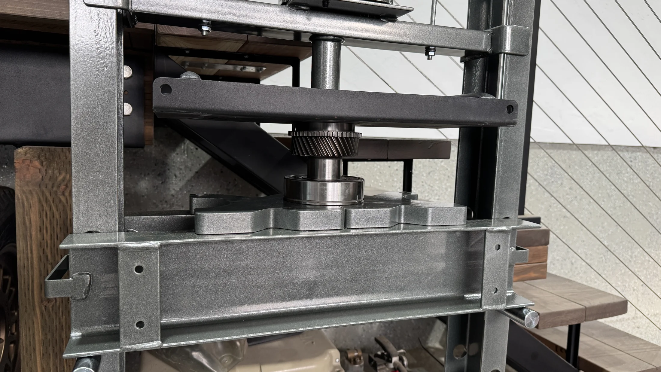

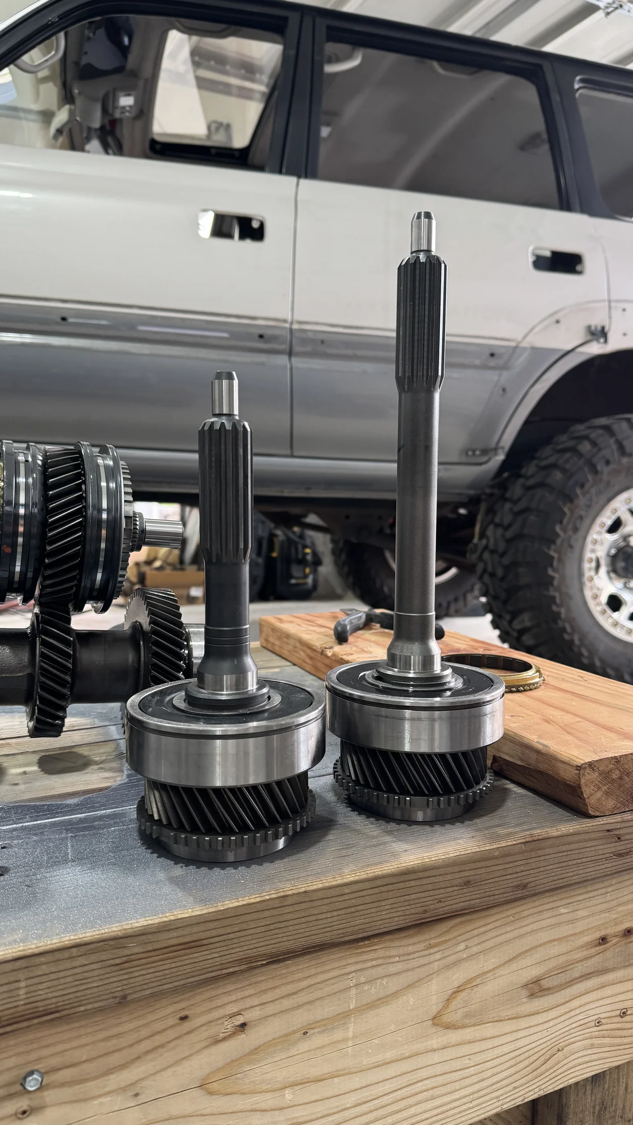

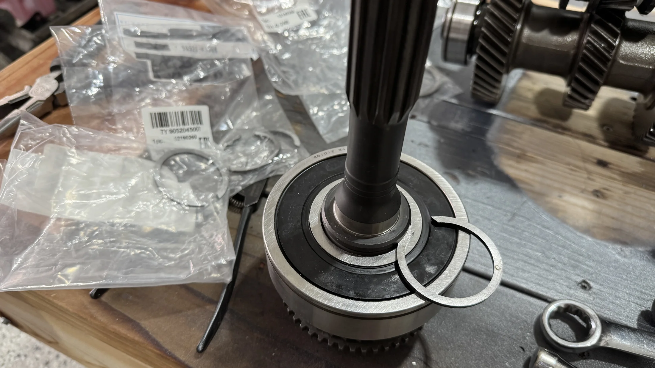

I bought a new bearing to press onto the 1HD input shaft:
1HD on the left, 1VD on the right

FSM has you try 6 snap rings to find the one with "minimal axial play." I ended up right in the middle of the range.

Held the roller pins in place with grease, and lubricated the synchro generously with gear oil - apparently these can get stuck easily. I read that it's listed as a step in the latest 70 Series FSM, but it's not in the 80 Series FSM.
Used the wedge and slid the new input shaft on.

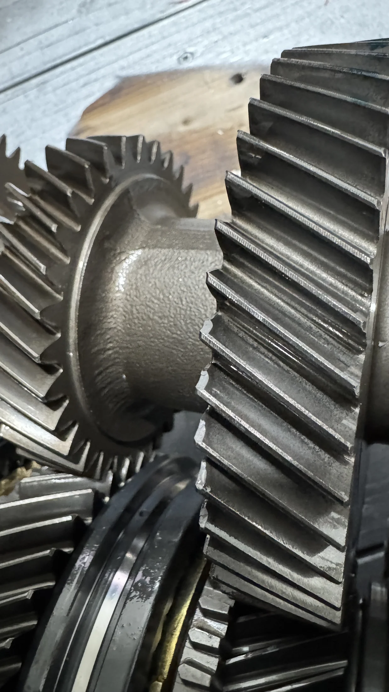

Bad news, I'm gonna retract my endorsement of the "wedge" method. I know several other guys have done it no problem but on closer inspection, I chipped a bunch of teeth on the largest gear on the counter shaft.
I was very careful as I disassembled everything so the only thing I can figure is that when wedging the two shafts apart, the edges of those teeth hit the synchro on the main shaft and chipped.
My input shaft was stuck on there pretty good, which would explain how I chipped teeth all around the gear. I had to try a few times with some wiggles and turns.
I'm just going to order a new countershaft and stick to the FSM next time. Talked to Dave and they're on Obon holiday til Monday. Might set me back a little but I want to do this right the first time and I have plenty of other stuff to work on in the mean time.

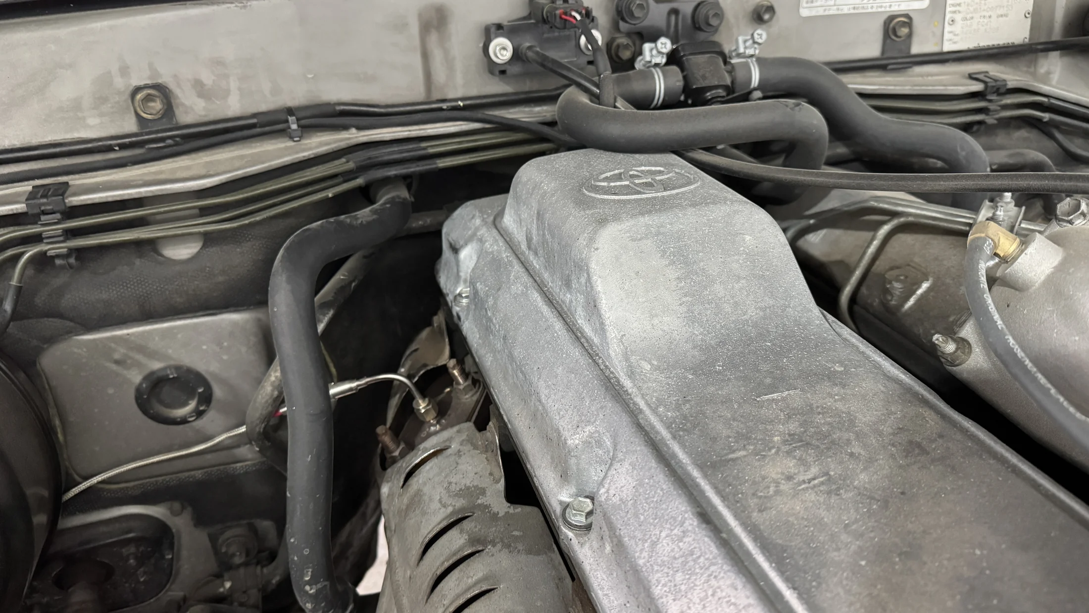

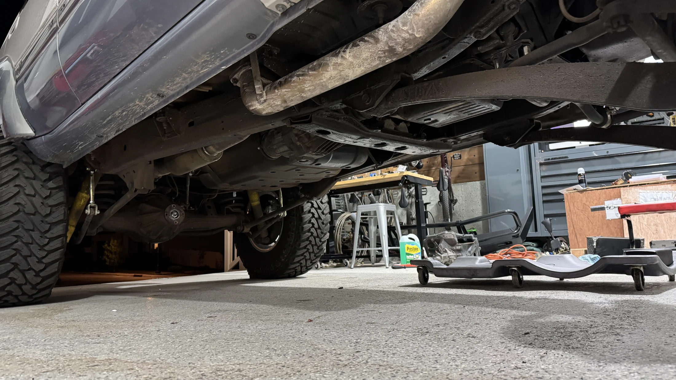

Good time to remove the rear heater coolant lines. I deleted the rear heater a couple years ago.
Removed the front section of exhaust and heat shields to get to the lines underneath:
Jacked the engine up a little so it was tipping toward the front to give me just enough clearance to get a wrench on the upper mounts for the heater lines:
And I was able to pull the hoses down through the tunnel area.
I know it's not something most people would notice but it's nice to not have those disconnected lines hanging out on the firewall.

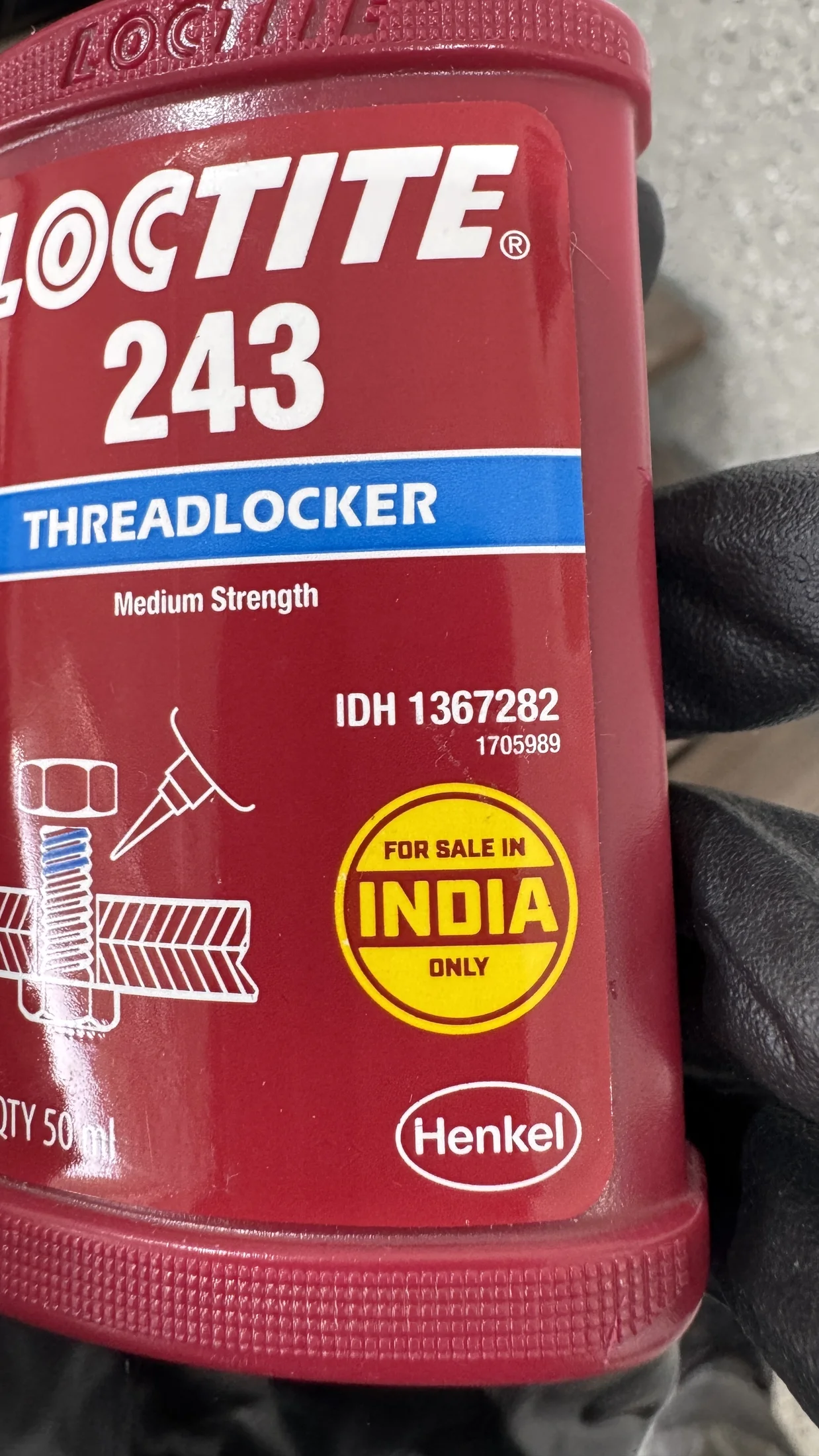

Amazon delivered some bootleg high strength loctite today. I ordered 242 and got this
