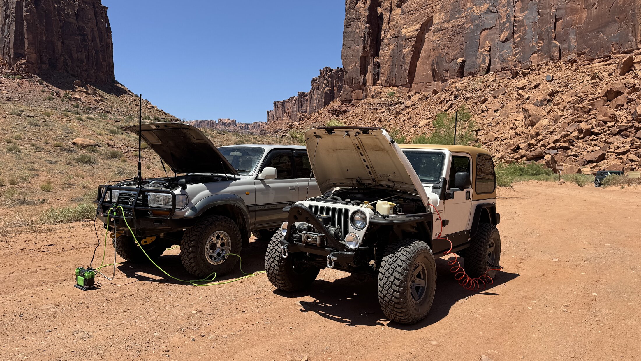

Tried out my new Morrflate setup for the first time. Pretty great. It's not too much of a hassle to pop the hood and connect it. Hardwired would be nice but I also don't have any room in the engine bay. Maybe a QPM in the future.
Anyway then you hook up the hose to all 4 tires, select your pressure and go. It took 6 min 30s total to fill up all 4 tires from 10 psi to 35 psi.

Nice, you'll love it. Way better than walking around and crouching by each tire for 5 minutes

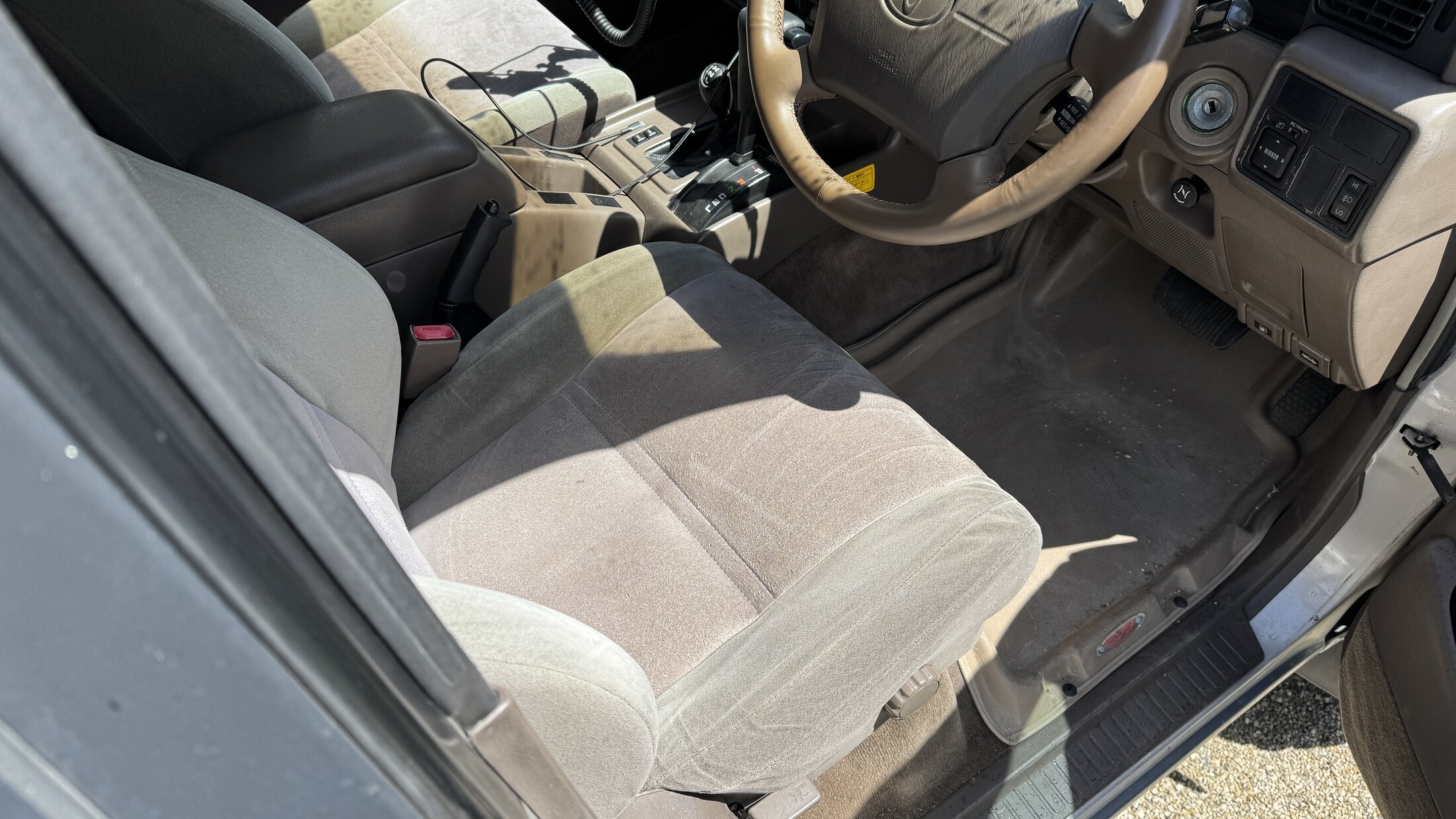

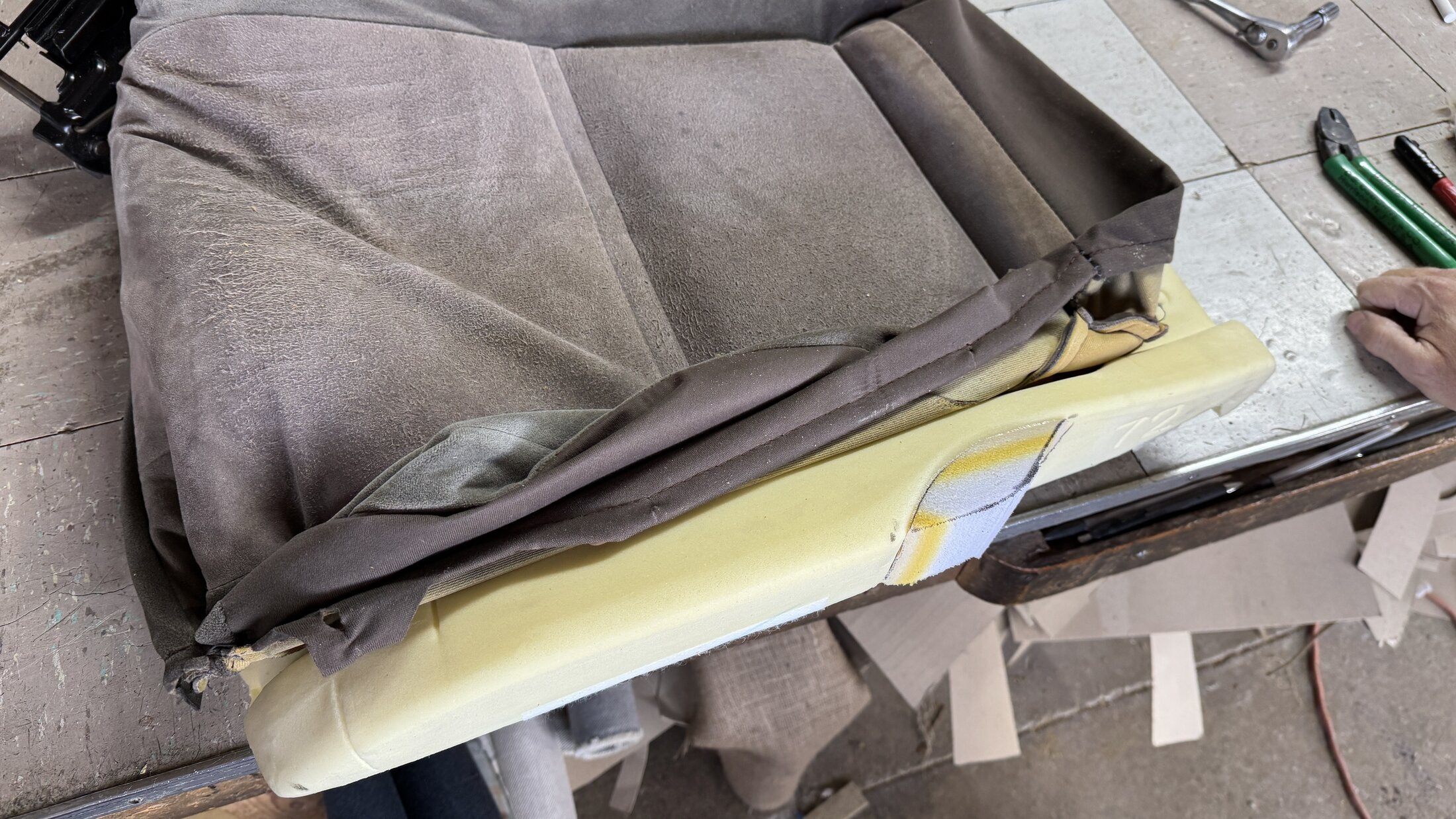

My driver's seat has been ok for the last couple years but on this last trip, I started feeling real uncomfortable after 4-5 hours of driving.
I wanted to buy some Scheel Manns but they've been hit hard with inflation and/or tarriffs. I swear they were like $1800/ea when I was last shopping (granted that was several years ago.) and now one seat is $2600 plus accessories and shipping. A little out of my budget for now so I decided to refurbish what I have.
You can see the lower cushion was collapsed from getting in and out. Also they were crumbling and leaving foam dandruff all over

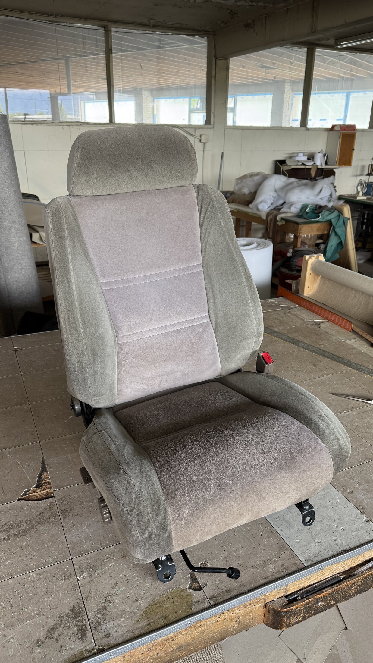

I bought the only lower foam I could find - there were two options but one was discontinued so 71511-60130 it is.

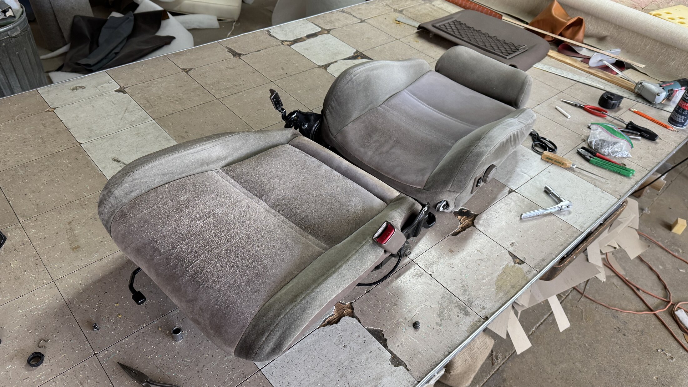

Easy-ish process if you're familiar with upholstery. Dismantled the lower seat/sliders and pulled the pad. Removed the hog rings and took the cover off.

Installation was a little tricky because I feel like this foam isn't the same as the JDM foam. Pretty sure this is the foam for the standard leather seats in US cruisers. We made it work though, just had to add foam in one spot on the inside edge:

Also I probably should have added a little bit of foam to the inside of the bolsters. But once we pulled it tight and clipped it in with hog rings it turned out pretty good.

Big improvement. Lot more comfortable now. Just need to break out the fabric cleaner and do a deep clean on the seats.
These are great seats and I shouldn't need to buy Scheel Manns or Recaros for a few years...

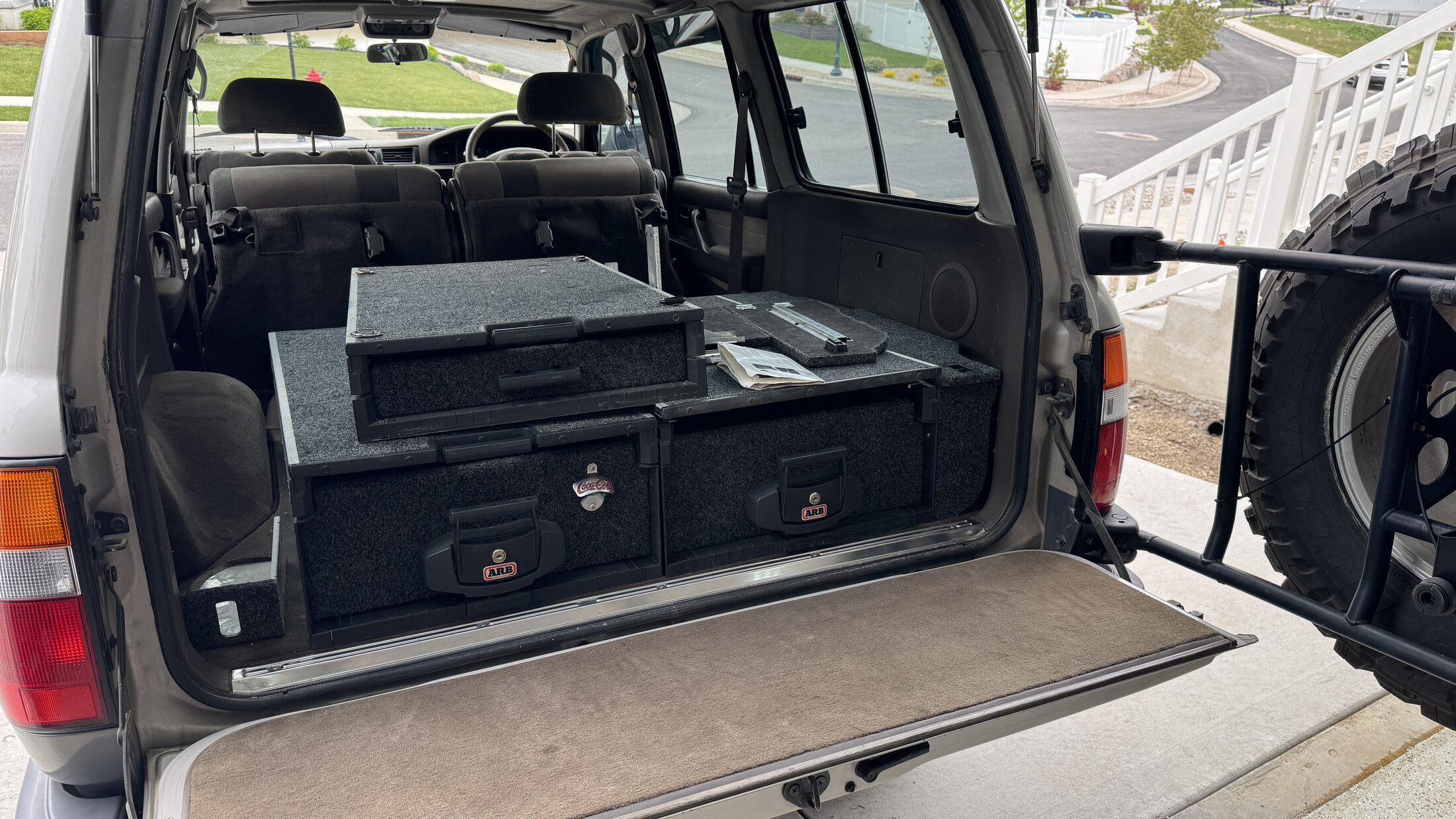

Was doing my daily check of the local classifieds to see if there were any land cruiser parts - these ARB drawers out of a 100 Series got posted at a great price so I snagged em. Just need to buy 80 Series wings and some hardware. They cleaned up nicely and look good as new even though they're about 8 years old.

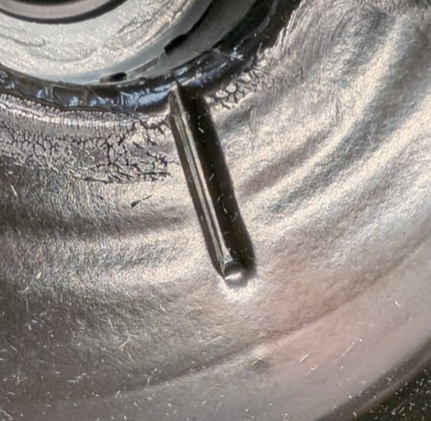

The timing turned out to be fortunate because as I pulled up my carpet to figure out mounting locations, I realized my carpet was wet underneath. Found a little water in the jack compartment - looks like my louvers started leaking when I washed it yesterday. Carpet is drying out now and I'll replace the louvers soon.
The main thing I need to figure out now is how to mount these drawers. This cruiser didn't come with 3rd row seats so I don't have the bolts or reinforced areas that you would normally mount to. I'm thinking about doing it like you do with roll cages and drilling through the floor and adding reinforcement plates.
the lack of a third row has kept me from installing a spare tire inside as i have no desire for swingouts.

Tried to get the drawers installed before a Moab trip but didn't make it. It'll be a longer term project. I need to get some hardware and L-track for tie downs.
