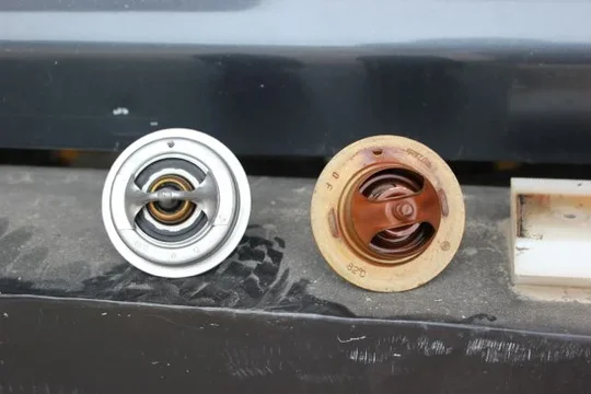

Now, here's the 82 degree C Thermostat that I removed, and the new 88 degree C Thermostat I installed. It's cold this time of year, so the extra heat really, really feels good. But I'll probably clean the 82 degree C thermostat out with CLR and water for storage, just so that we have a "hot weather" thermostat to put in if the need ever arises.

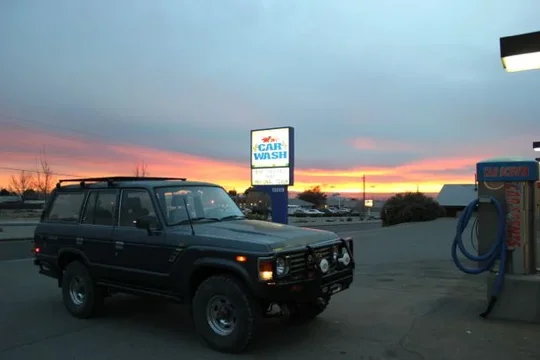

After all of that, we took it into town to go to a car wash to hose it down real well. While we were there, we got to see a beautiful New Mexico sunset. So I took a picture of it.
