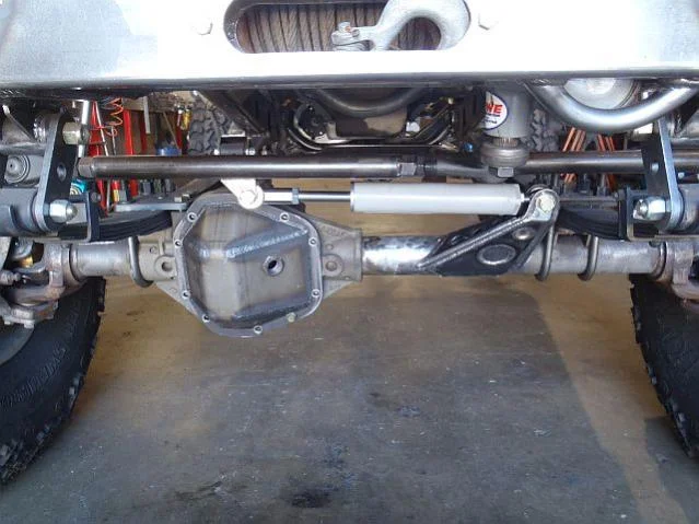

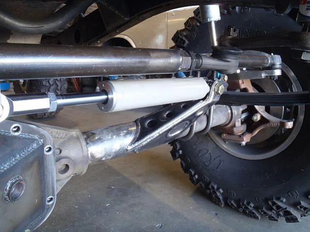

You need a 10" ram if you're going behind the axle using stock steering. And the Trail Gear kit will not work. You need the mount I posted or fab your own.
Didn't mr jits use an 8" ram behind the axle?

Anywho, it's easy to measure. But measure exactly where you plan on attaching the ram to the tierod. The measurements will change depending on where you place the reference point
Yeah he did but if you measure the steering travel it is 5" one way and 5" the other.

An 8" ram was perfect in my application with 38" tires. I think that unless you shim it, a ten inch ram could cause issues
I found the 10" to be a bit long as well. The 1.5 x 9" From West Texas off road is the perfect length for the stock behind the axle tie rod. IMHO
I've had a 10" on mine for years and can attest it's a bit too much when doing rapid steering adjustments. It is also a 10x2 so it's a little large in diameter also. I've been meaning to go to an 8x1.5 for while, but it currently resides at the bottom of the expenditure list.
