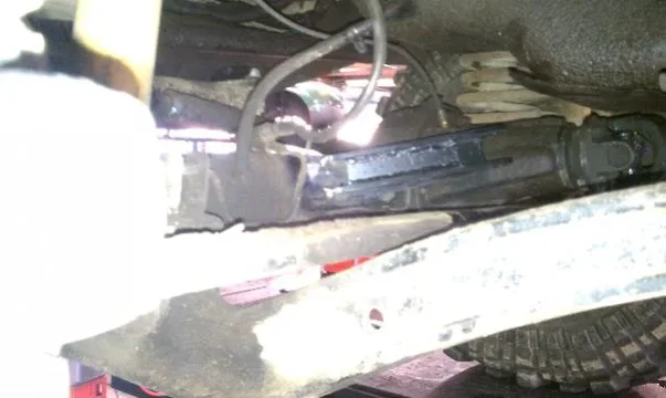

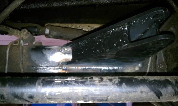

Welded up the mount for the ram today. I still need to plumb the box, but should have it all wrapped up in a week or two.
I see you used the same mount as me. Nice.

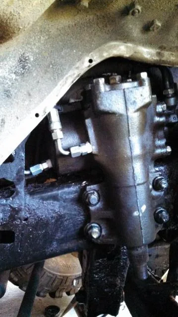

Finally wrapping up the assist tonight. A huge thanks to tonsofun for his help. The marlin board write up made things very straight forward. For those doing this: it is very simple, but a lot of work. Be prepared to dig in and get dirty.
That's great. How well is it working? Did you add a cooler? Are you using ATF?
Pics and video would be great.
Looks nice. Why do you think you need a smaller ram?
Yeah it looks fine.
I see you tapped the end of the box instead of on the top. I thought there would be no room.
Yeah looks great and you have the full flow 90's.
Did you get all the air out?
