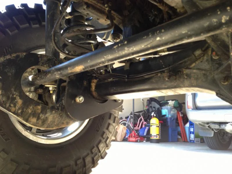

Now that I've seen the close confines, perplexed at how to go about implementing.
High steer won't work with the tie rod behind the axle, on mine. To raise above the previously depicted arm runs directly into the side of the DC joint.
Unsure if moving the tie rod up front with relay is worthy of a street driven pig, coupled with precarious real estate it'd be mounted in.
I do not believe that Heim's that I've seen in the kits are best utilized in steering applications, at least not for on a rig that's expected to be quite, see highway speeds. (Could be sold on a UCAish 1-1 1/4" uniball, housed like I have on FJC, but do not wish to reinvent the wheel, because I ain't smart enough ), and have to maintain some OEish form, since I've shot my mouth off about.

At this point, would like to know if proceeding further, with the intent of maintaining all the existing components as they're currently positioned (save knuckle studs) is the best course, cause it sure seems my only.
It is the best way and certainly the easiest and most cost effective. With your current radius arms you might have packaging difficulties that others might not for a hydraulic assist, but I am sure it isn't something that a competent shop couldn't look at and let you know what could be done. With your wheeling style having the ram behind the axle would probably be the best course of action. ;)

Even with this hunk of chit surrounding the tie rod?
I don't know the ramifications, but have been pondering welding a mount on the top of the axle to attach the upper arm mount to, doing away with the L shaped bracket.
Would buy an 1" between tie rod and housing.
I think you need to buy the ram you intend to use so you have a visual for the fitment. I can't tell from the photo, but I think you could fit the ram in the same location I'm looking at, but you may not be able to upgrade your relay rod at the same time (which I think you should do).
That's MAF Beef-tastic relay and tie rod.
More necessary?
Nope, I think you're set.
I really think you should just pick up a ram and start mocking things up. It's definitely a tight fit behind the axle, but I also think that that space is going to provide a lot of protection to the ram.
