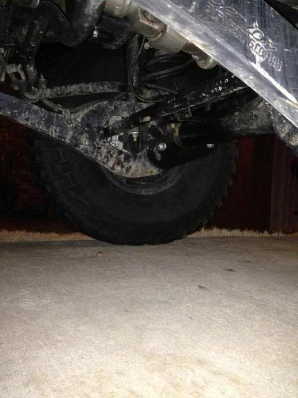

If, a high steer kit is needed, I'll go that route. I think that there will be enough room if I'm attaching the ram in the rear (which also counters the forces in the front as LT pointed out), that I'll be able to do the install without interfering with anything. It may take some creativity in fabbing up a mount, but I'll deal with that as I'm planning.
Please do, and good to hear from you! I'd love to see what you come up with. What I have in mind is going to be very simple and straight forward. No high steer arms or anything crazy.
Good to hear from you too! Sounds like we might have the same plan. I've already made and installed some heavy .250" wall steering links, and next will be the ram mount and R&P. I'll keep you updated as this comes along.

The tie rod remaining in the OE location, not relocated to the top of the knuckle, right?
Guess I never considered this as an option, and reason for confusion. Apologies.
Yup! You got it now. Stock arms and tie rod location behind the axle. No worries, glad the idea clicked for you.
Matt

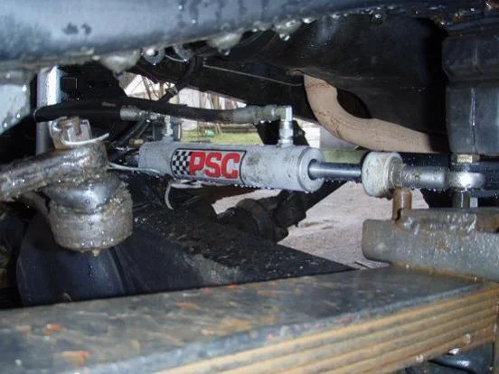

LT said:
Imagine the mount I posted up earlier attached the tie rod behind the axle
Look at post #22&23
Post 22 relocated, if I'm not mistaking.
Post 23
Not seeing how the angle isn't an issue, but won't clear the arms.
Unless I'm missing the point.

Still don't see how it'll work.
To be remotely close to parallel with the tie rod puts the ram mounted some distance from the axle.
Am I missing something?
Is the angle depicted in post 23 not an issue?
Using heims allows for a few degrees of deflection up and down, and if your angle from the tie-rod is severe, you set up your mounts to adjust for that. Also, would need to have a long enough ram to adjust for the extra throw.
All that aside, I think the ram will be almost parallel to the rod in the back. None of the above should be an issue.
Look at your post #12 on this thread. Imagine that mount behind the axle, same principle just mounted differently in the picture that I was referencing.
