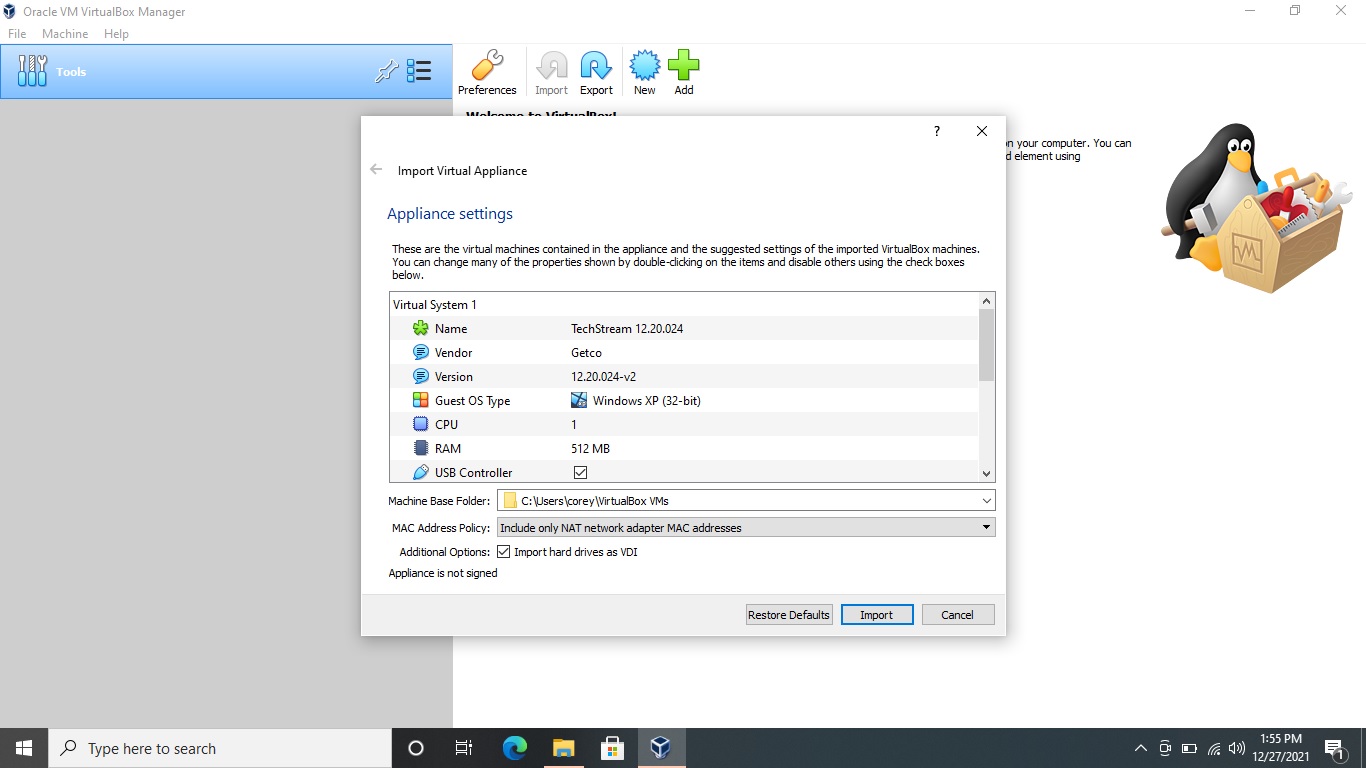

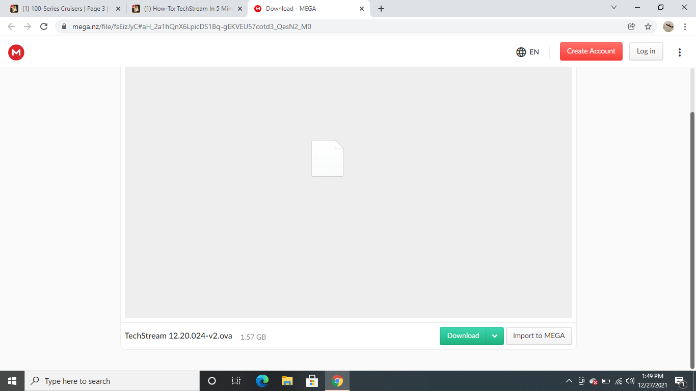

Afternoon and Merry Christmas, attached is a pic of the link page to which your directed to download the Techstream. Does it appear to be the correct version? When I concluded the download the information page said the software was for XP and was 32bit? Is this correct? Thanks
I must be doing something wrong. This is as far as I can get.
