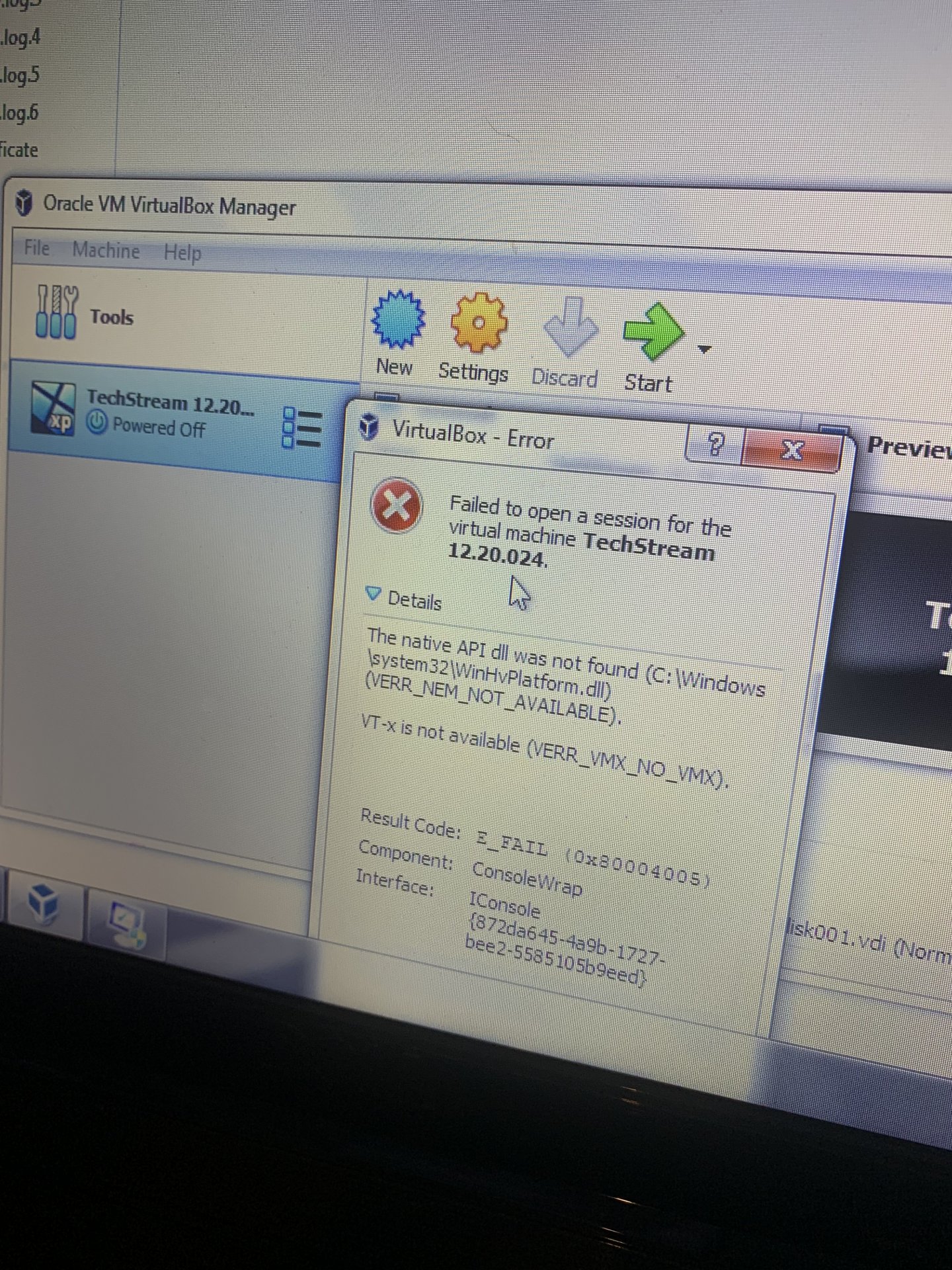

I’m having an epic failure of a time trying to get this to work. I have followed the steps in the original post exactly. TS won’t boot up in the VB and gives me an error code immediately. I tried on my old MacBook Pro. Then booted up my Dell laptop. Did the exact steps and still nothing. It looks to almost boot up but then gives me this error. Can anyone help me and explain what I’m doing wrong or how to get this to work? Thank you!
