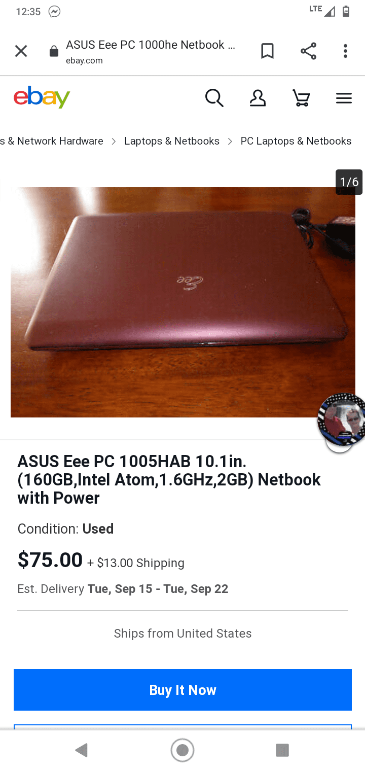

FYI - I had an old eee PC 1000HE from like 2008 and it had XP. I was able to get the cable and Techstream added and working with no issues. They are a cool cheap mini 10 inch laptops with a long battery life. If you hit F9 on startup it goes to a ghost restore to factory settings with no windows key needed. (Ghost is a exact copy of the way it was after install.) So if you got one used on eBay you could factory restore and have a cheap clean <$100 GXOR computer. The battery is awesome also vs the 2 hrs my 15 inch has. I plan to take it on trips. After getting T-boned in the front fender in a parking lot at <5mph the crawl control stopped working and I had to do a zero point calibration. What if you hit something off-road like a deep rut. I'm assuming you may need a ZPC in some cases. Anyway just thought it was interesting. Here is the cable that works w XP on the EEE or virtual box w XP and it was next day prime so the price was $10 more than most, but the software was flawless.

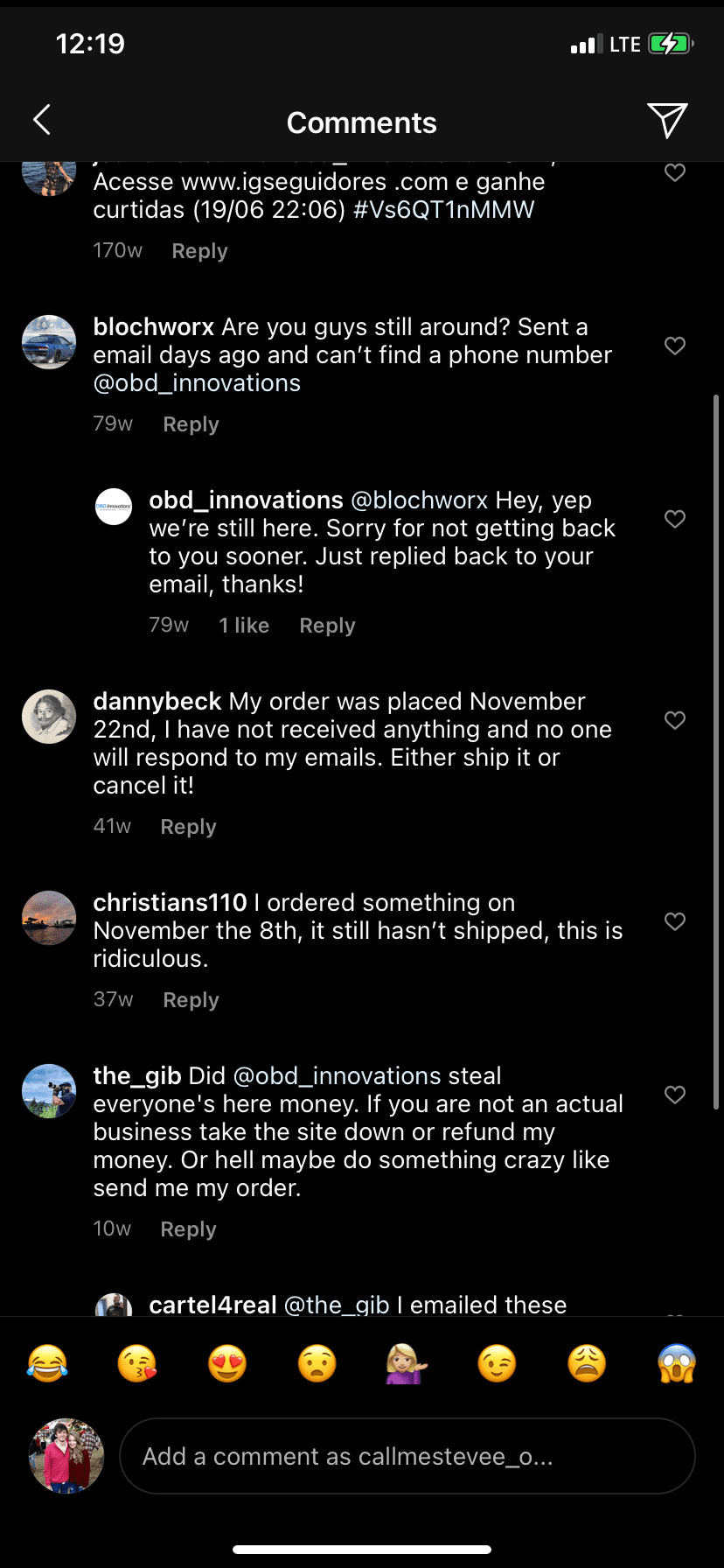

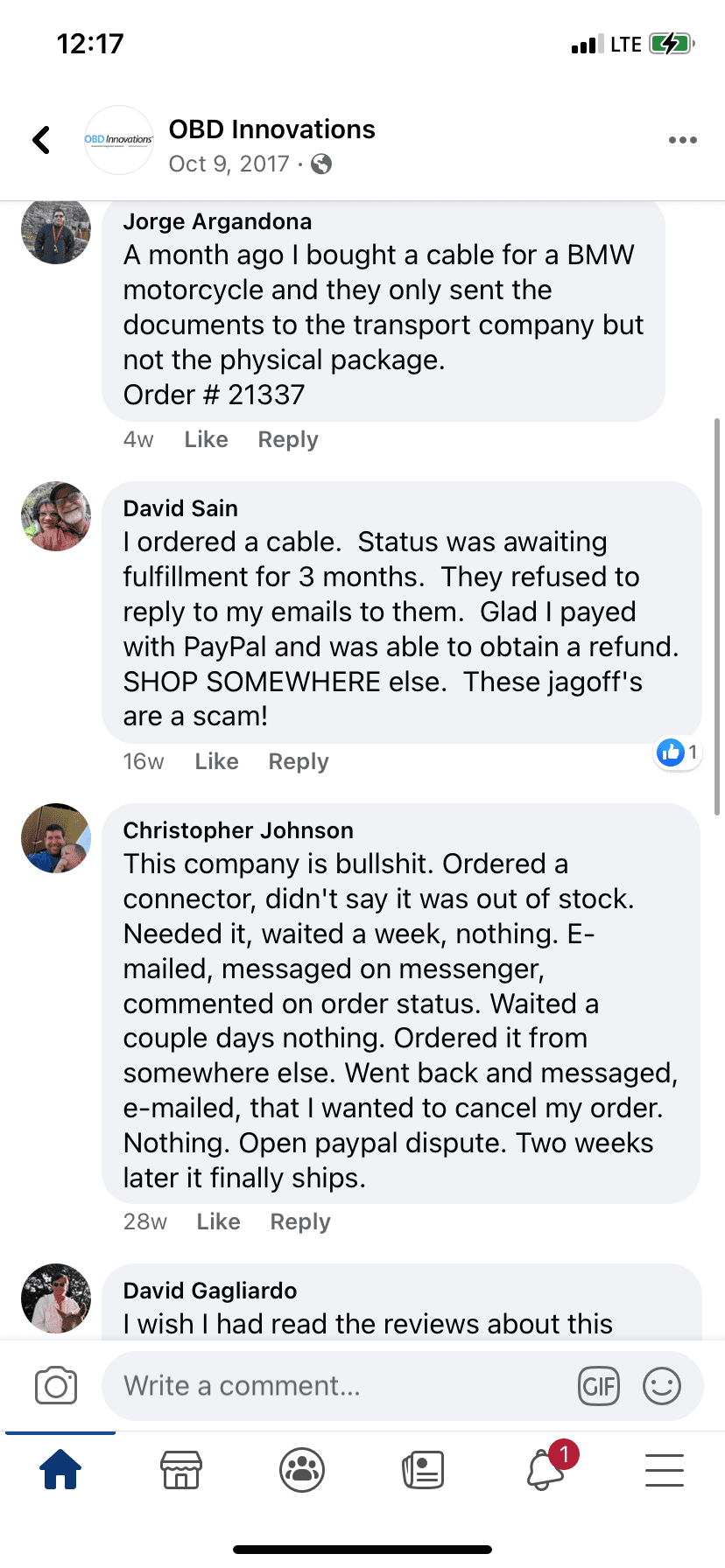

Fair warning: I was going to order a software & cable kit from OBDInnovations but they seemed to be out of stock on a lot of them for our Toyota’s. After checking a few of their social media profiles it appears as though they’ve gone downhill. A lot of negative reviews and people reporting unfulfilled orders. Just be conscience of this before placing an order with them. These are from their most recent Facebook & Instagram posts (which are from 2017...)

@Stewfish i just got an asus Eee PC 900HA similar to that one and it came installed with XP service pack 3. are there new links?
the virtual box downloads but wont install correctly.
the Techstream says I need to use their 32 bit meg app to download techstream, then goes on to say the 32 bit mega app only works for win 7.
what browser are u using?
any suggestions? i followed the links on page 1 of this thread.
