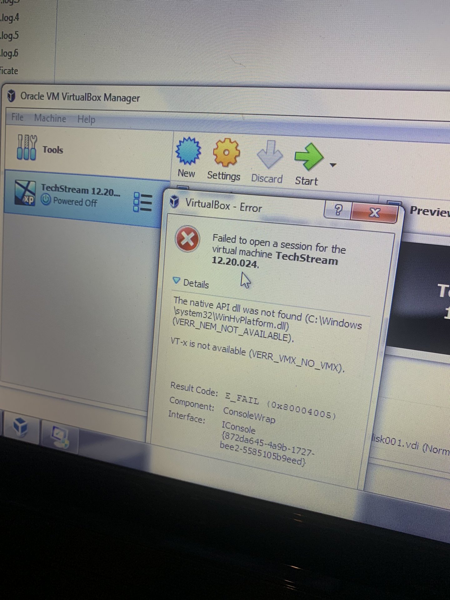

I’m having an epic failure of a time trying to get this to work. I have followed the steps in the original post exactly. TS won’t boot up in the VB and gives me an error code immediately. I tried on my old MacBook Pro. Then booted up my Dell laptop. Did the exact steps and still nothing. It looks to almost boot up but then gives me this error. Can anyone help me and explain what I’m doing wrong or how to get this to work? Thank you!

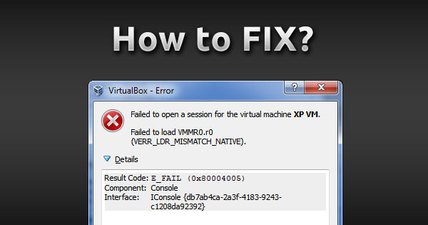

"If your 0x80004005 error in VirtualBox includes VT-x and/or AMD-v terms within the error description, this solution will help you fixing your version of VirtualBox.
In order to work, every virtual machine software needs CPU virtualization feature. Enter your BIOS settings (keep pressing DEL key after turning on your PC) and seek for this feature among settings.
For INTEL based systems, virtualization feature is called VT-x, while AMD uses term AMD-v."

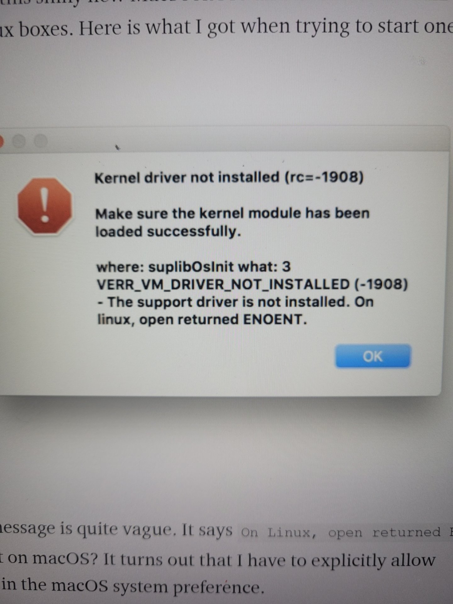

Anyone figured out how to get this to work on a mac running Big Sur? I keep getting a kernel error and I've tried everything that Google says to no avail
Yeah, I've got it running on a '14 MacBook Air that's on Big Sur. Post a pic of the kernel error.
It's this
When I check some things listed online I get some errors that "incompatible architecture" binary is for x86_64 but needed arch arm64e
It's this
I had the same issue when I updated to Big Sur. Have you tried my troubleshooting in post #744? Specifically starting with a reboot?
I've rebooted about 50 times, uninstalled and reinstalled multiple times, disabled kernel consent...nothing works
I started getting this error that the architecture was incompatible, and read a post that Virtual Box wont work if you have the M1 chip...and virtualbox's user manual says "intel hardware is required"

Thank you for the help, unfortunately it looks like my laptop does not support VT. I cannot find it in bios. Should I try something else in the article?
Also in VB settings, it gives me errors for VT since I assume my system does not support it. It will not let me apply the settings when I choose to deselect VT
