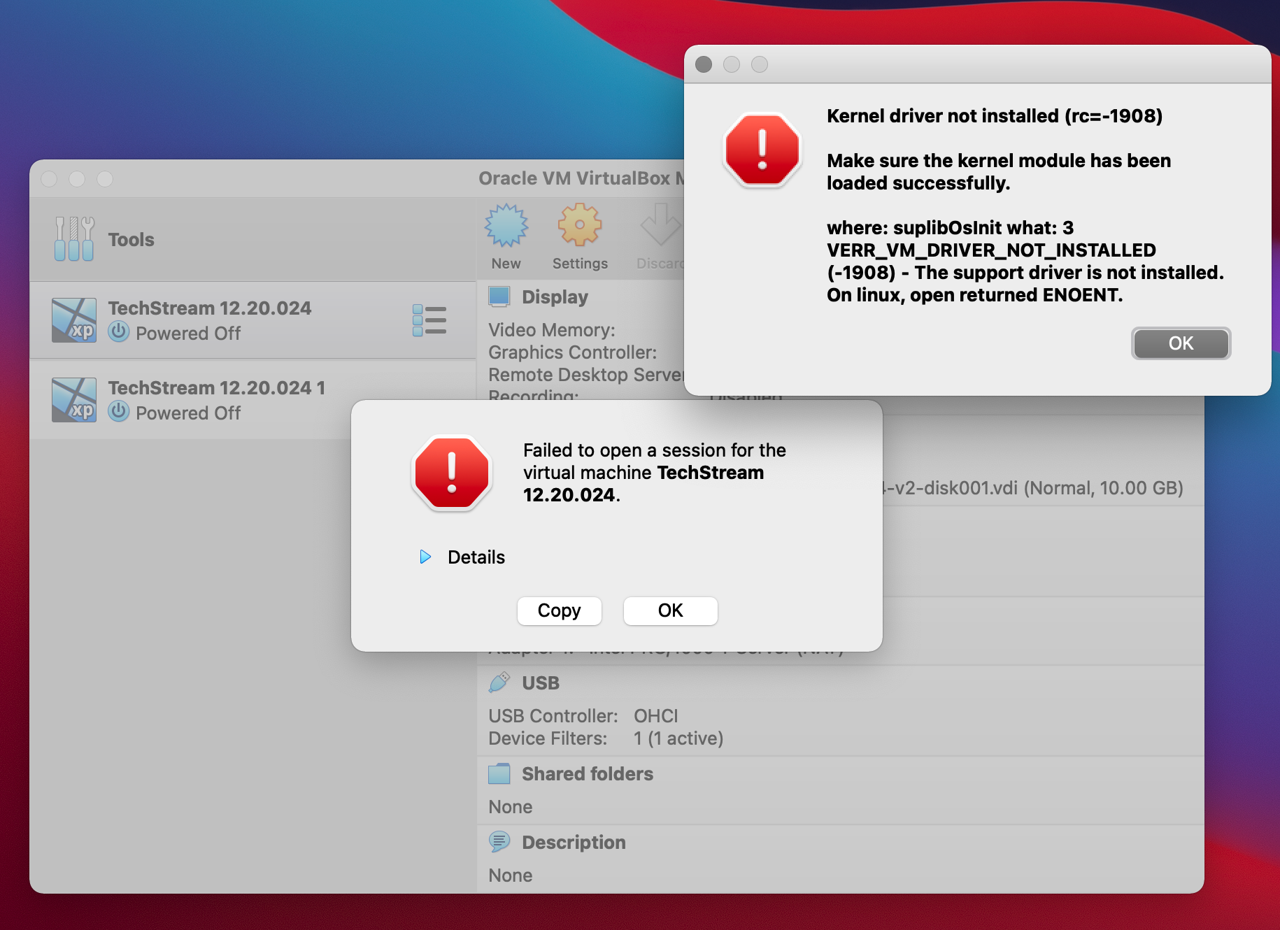

These are the errors I am getting when I try to open techstream. I am running Big Sur and virtualbox verson 6.1.22
Try a reboot first.
Otherwise, this is likely a permissions issue. You'll have to go into your "Security & Privacy" settings, under "System Preferences" and give VirtualBox explicit permission to run. There should be a little ribbon at the bottom of the first screen in "Security & Privacy" when you open it up, but if there's not then you'll have to reinstall VirtualBox, attempt to run it, and then go look for what I just described and click "Allow". If you reinstalled and have already given full permissions, reboot to install the required kexts.
I gave the permission and rebooted, a few more permissions prompts, and boom its working. Sweet.
