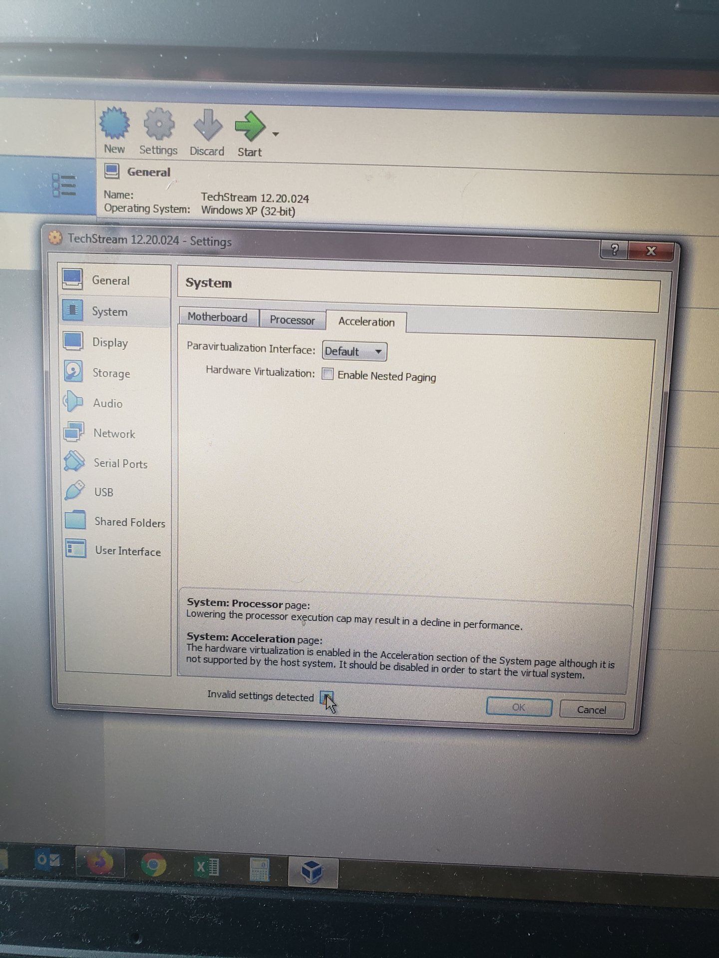

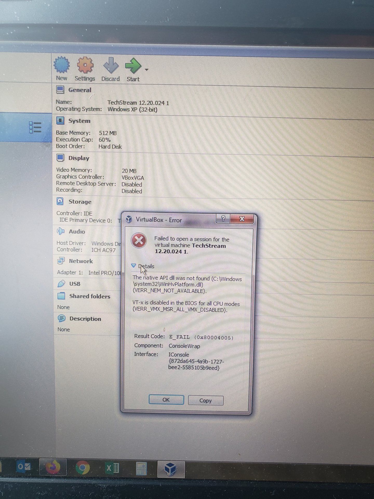

Hello I'm trying to install techstream but the virtual box keeps giving me a error. I try to run tech stream and gives me a error.
Then in system it asks me to turn off hardware virtulaziation which I do but it doesn't let me save my changes. I've reinstall many times . Same thing keeps happening.
Hey, I'm not sure if you figured out the issue but I wanted to follow up in case someone else has the same problem. You'll need to go into your bios to change this setting (google your computer manufacturer and how to enter the bios).
The setting for mine was under "System Configuration" and called Virtualization Technology which I had to change from <Disabled> to <Enabled> and then I was able to Techstream as I had previously.
