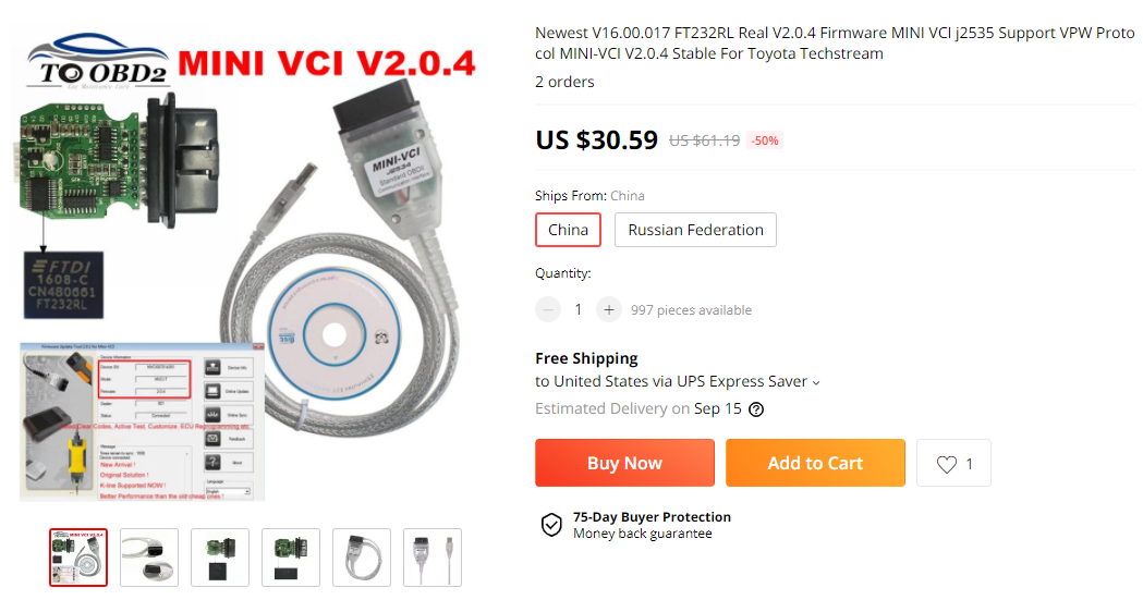

Here's what I found. MINI-VCI V2.0.4 j2534 for $30. Should be good. if its not 2.0.4 then raise a red flag and aliexpress should refund the money. But for the money I am sure it will be 2.0.4 version cable. No company wants the sell a wrong cable and lose money on it.
Is it wiser when ordering from China to buy the more expensive cable or is it a toss-up of what you will get no matter what you pay? I normally follow the "you get what you pay for" motto- but I have no idea about Ali-Express.
@MarkTR You can pay double...but I have had good experience from Aliexpress and they are reliable. If you do not get the 2.0.4 version cable you can raise a case and you will get your money back. The only thing about Aliexpress is the shipment time.
