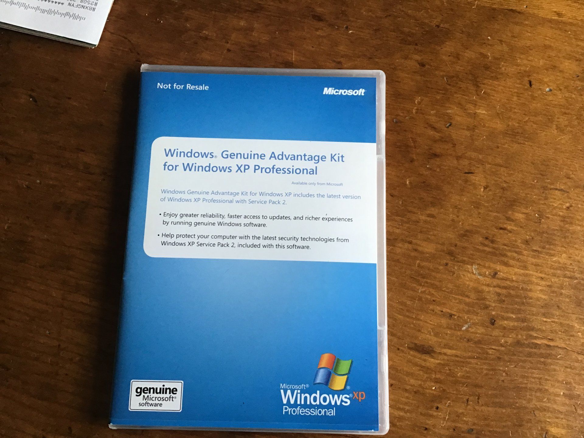

One of the threads on this was asking for Windows xp. Cleaning out the basement and found this! Key and everything. PM me whoever it was that mentioned it.
