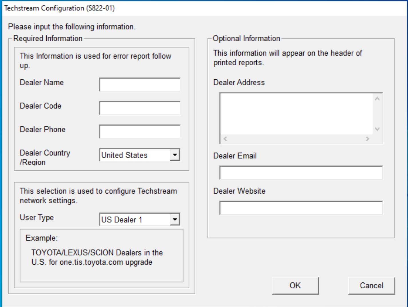

Ok, so I've got TechStream running on Windows 10 on VirtualBox on a Mac OS. No small task. But I can't see how to get around this window. I must be approaching this problem from the wrong direction.
Think you can just enter regular information in there... It is only sent if you attempt to use the internal update link.
