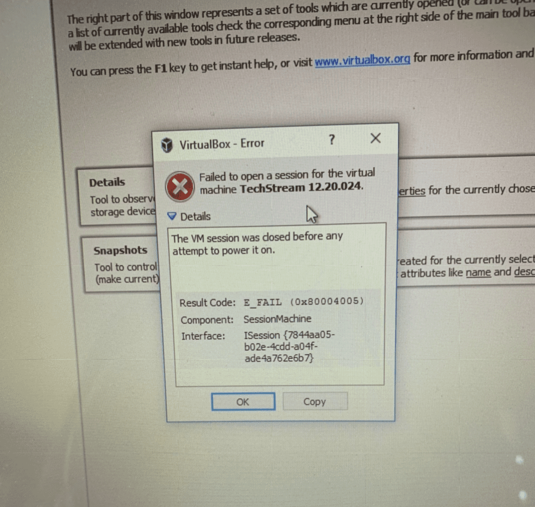

I uninstalled the driver and was going to start over, then got the following:

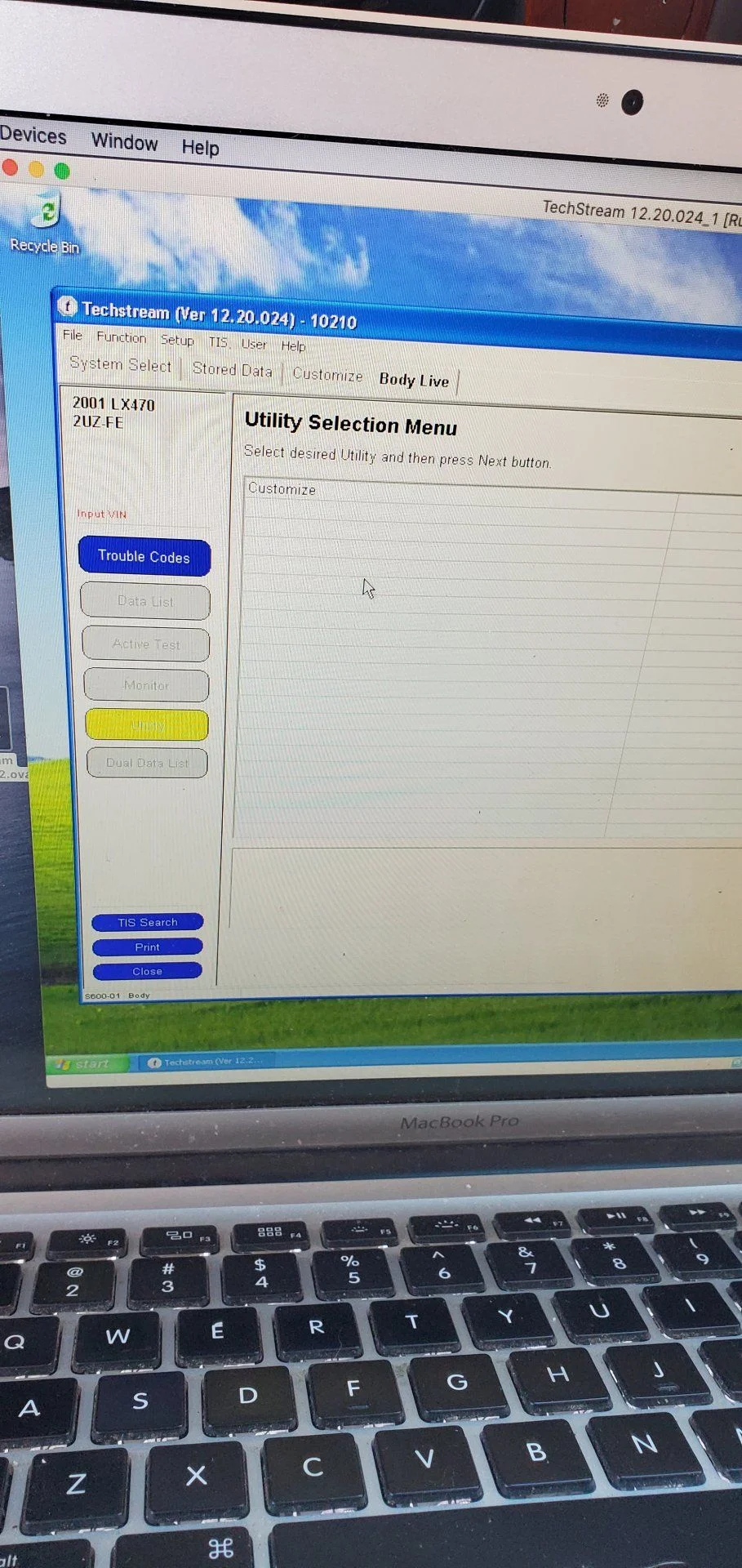

Here is a photo of what I'm seeing. Don't seem to have any options. Looking under the immobilizer section it appears I am able to program new transponders, but not what I'm needing to do. Any ideas? As a side note the cable firmware update tool in VB shows my cable is version 1.4.1, not sure if that matters but it won't let me upgrade anything anyway.
I also installed TS on my parents windows 10 machine using the stuff that came with my cable to see if I could get it to work. Everything seems to install properly. Its TS version 15, but it won't connect to the vehicle.

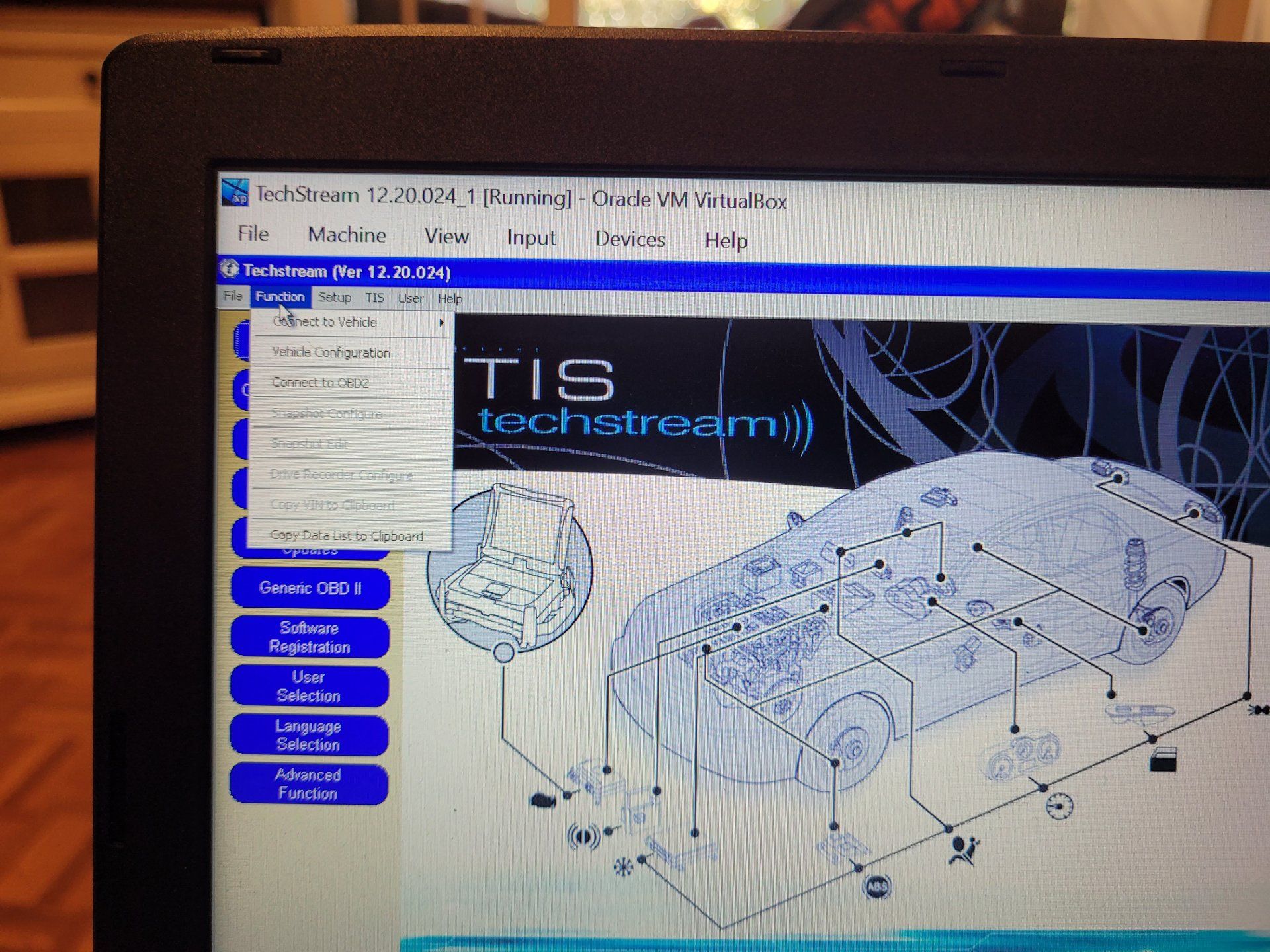

You may need to have it connect to the OBD2 first then it will allow connection by selecting connect to vehicle. Look under the Function tab then select to OBD2. Once it connects there you can go back to the main screen and select connect to vehicle. This has worked for me when getting the can not connect to vim message.
I just got it to work on the windows computer, I had to change the VIM settings to my cable instead if the TIS one. But even with the other computer I still don't have any options under body to program the wireless remotes. Connects to vehicle fine otherwise, although some other options may be missing as I don't know what all I should have available but its connecting to the different ECUs.

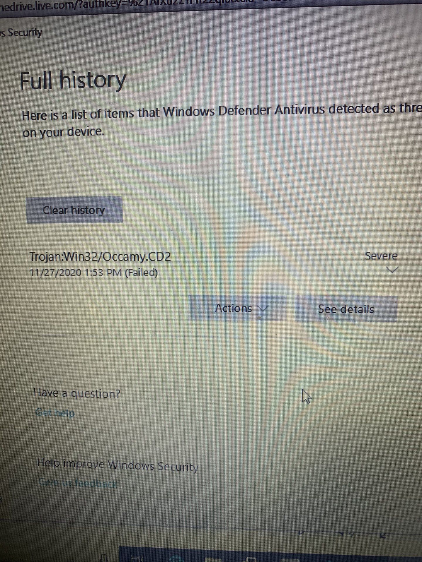

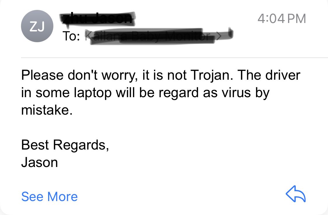

Anyone tried to install a driver with a virus? I just got my cable in today and my computers virus scanner picked up a virus.
What file is infected or fails
I've only ever used V12 on my 460... there have been deprecated options on that model for things like key programming on newer versions... VM in this thread is older but here are other versions for download as well
Thanks for this link, I downloaded the oldest version they had there, 10 something, and I still don't have the option to program the remote fob. Not sure where to go from here, maybe a different firmware version for the cable?
The file containing the drives. In the instruction, one of the steps was to disable firewall. I skipped that step on accident and when I tried installing the file containing the drivers, the virus scanner deleted the file when it detected the Trojan.
Ok. Try it the proper way next time and if it fails on an individual file, post up which one (like a .inf file, not a .cab file or similar)
If it fails again on an individual file (like an .inf) rather than a composite file (like a .zip or .cab), just post up the filename. Folks can try and get you the correct file (like me, if you are installing the same version I have).
