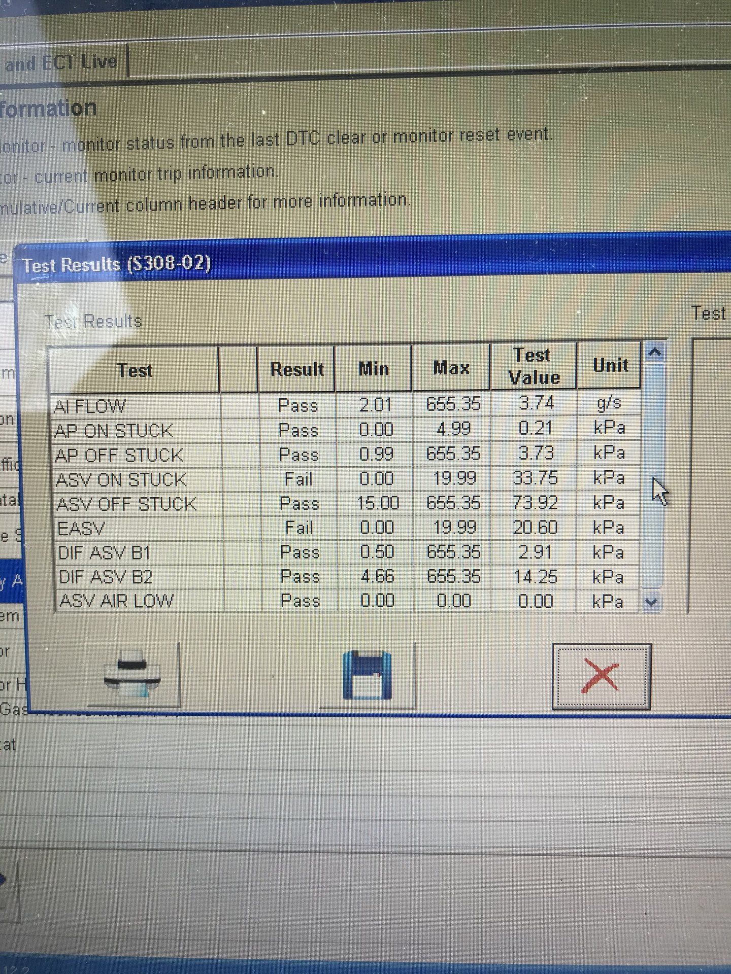

Thanks to this thread and the OP, i got a check engine/ limp mode and was able to diagnose/clear it in 5min. Secondary air 06/07 issue

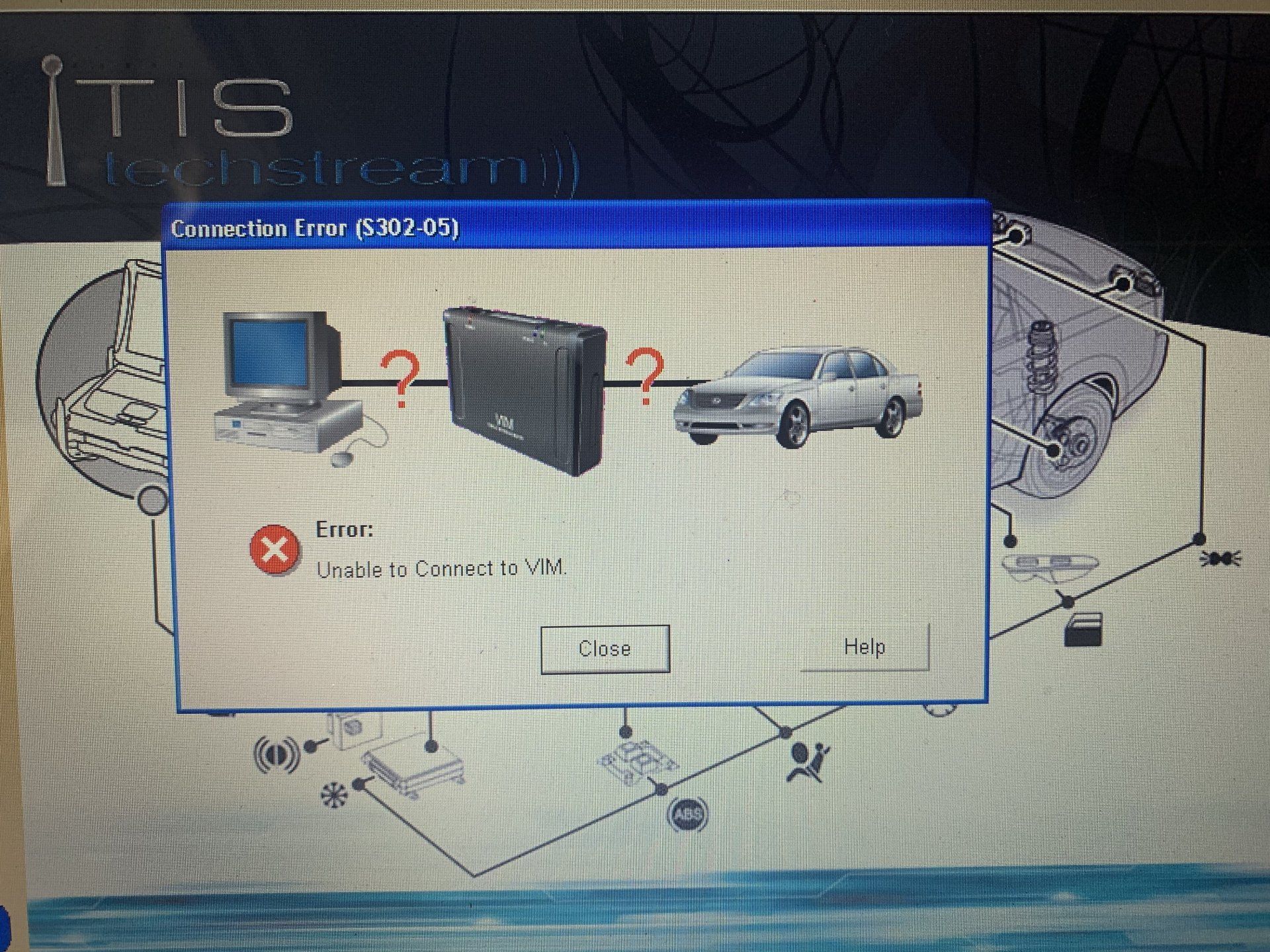

got the virtual box to work and Techstream to come up, but then
UNABLE TO CONNECT TO VIM.
Here is the connection I am using;
Any thoughts or ideas please????
your VB needs to recognize the usb cable you plugin before it can connect to TIS. this error screen happens to me if i click into techstream too quickly before hearing the audible usb connected ding - lower right hand side flashing usb device - or checking the connection with the MVCI Firmware Update tool.. make sure the usb connection is good before starting TIS in VB

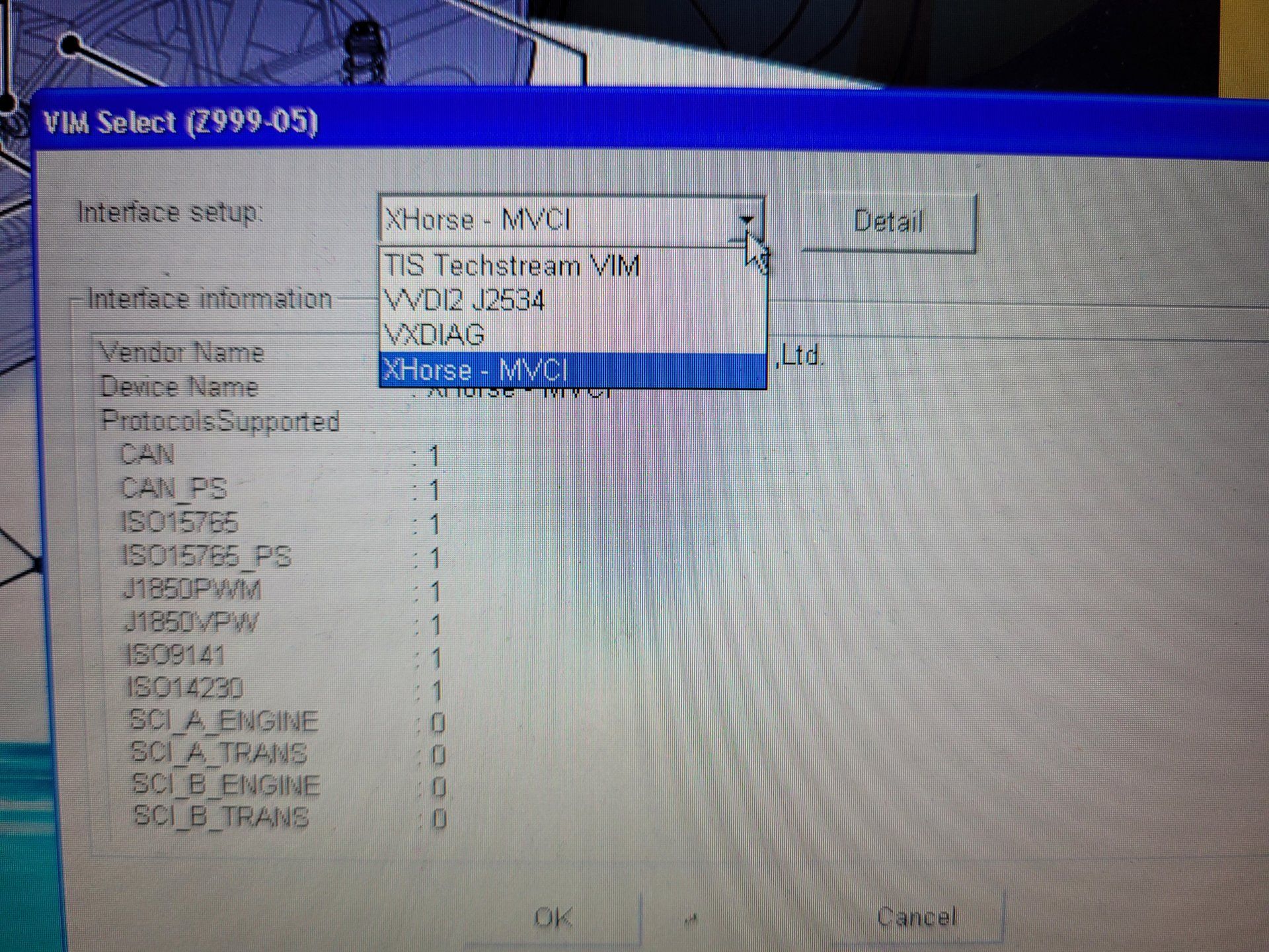

You may try opening techstream on virtual box. Then select setup. Then select VIM select. Then in the scroll down select xhorse-mvci. Mine was set wrong after doing the techstream in 5 minutes vb download. Good luck
