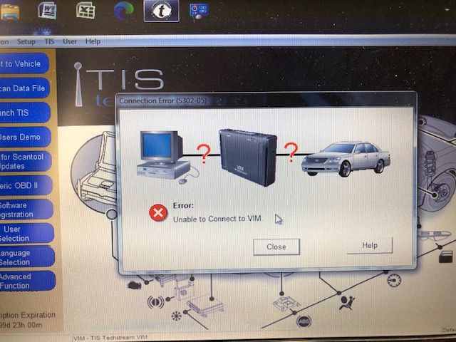

Hey everyone, just tried getting my Techstream to work, but got basically nowhere.
This is the cable I got on Amazon - Amazon product ASIN B087CZDF4HI downloaded and registered successfully Techstream version 15.00.026
Laptop is a HP with Windows 7 Pro @ 32bits.
When I tried connecting it to my 2003 LX470 (Connect to Vehicle bubble up top) I got the following screens:
Do I need to be connected to the internet for this to work? I also tried with an internet connection, but got the same screen.
Afterwards, I get this screen:
I am stumped right now. I hope it's not the cable as I live where Amazon doesn't deliver so, getting another cable is going to be a difficult.
Thanks for any help.

I get this same error...
But I think that 15.x version is too new for Win 7.
If you read the Amazon description carefully, it tells you the exact version of Techstream you need to use. V14.30.023
You also need to install the included patches, and there *may* be a driver needed (included on the CD) for the cable and laptop to talk properly.
For sure you'll want to completely uninstall your V15 of Techstream, reboot, and start over with the software installation.
V14.30.023
That's the version I have.

OK, so, I uninstalled the V15 of Techstream and loaded up the V14... that came in the CD and with the cable.
Yes! Got it working!! Thank you all for your posts. They have been very helpful.
