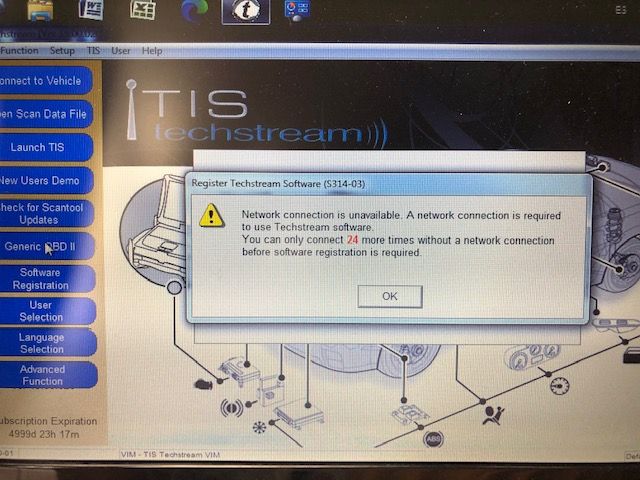

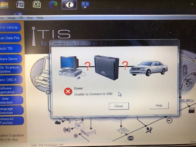

Hey everyone, just tried getting my Techstream to work, but got basically nowhere.
This is the cable I got on Amazon - Amazon product ASIN B087CZDF4HI downloaded and registered successfully Techstream version 15.00.026
Laptop is a HP with Windows 7 Pro @ 32bits.
When I tried connecting it to my 2003 LX470 (Connect to Vehicle bubble up top) I got the following screens:
Do I need to be connected to the internet for this to work? I also tried with an internet connection, but got the same screen.
Afterwards, I get this screen:
I am stumped right now. I hope it's not the cable as I live where Amazon doesn't deliver so, getting another cable is going to be a difficult.
Thanks for any help.

For all of you who are getting this error... unplugged the USB cable, wait a couple seconds and plug it back it in. The virtual machine /windows should recognize the adapter/usb and install drivers for it. it will then work. I had the same issues but finally figured it out and works great.

8n the bottom right is a USB symbol, right click and click the cable and it will work. Mine never auto connected
