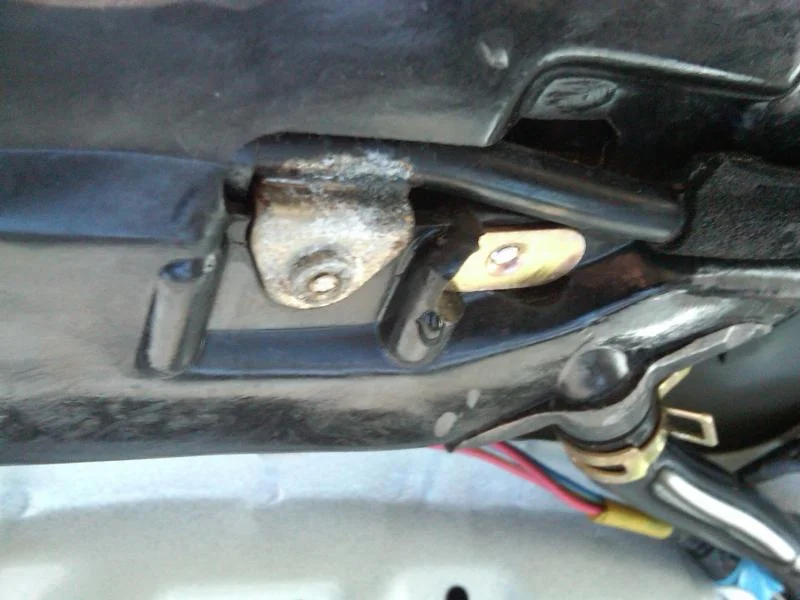

I originally removed the whole sunroof assembly to weld up the holes left after removing my stock roof rack. Upon removal of the headliner I noticed water stains on the backside of it & assumed that they were from previous downpours with the drains clogged. Well after unclogging and cleaning the whole assembly and reinstalling, it is leaking from the front corners, adjacent to the triangular backing plates that show corrosion. (see pics below).
Do any of you who have removed this seem to recall a rubber seal or gasket between the track rails and housing body? If so, that may explain my leak.
No, I don't believe so. It has been a while though. Check the FSM.
Also check the adjustment of your glass. If you pulled the sunroof and did not readjust the glass you could have a leak there. See the FSM for adjustment criteria.
