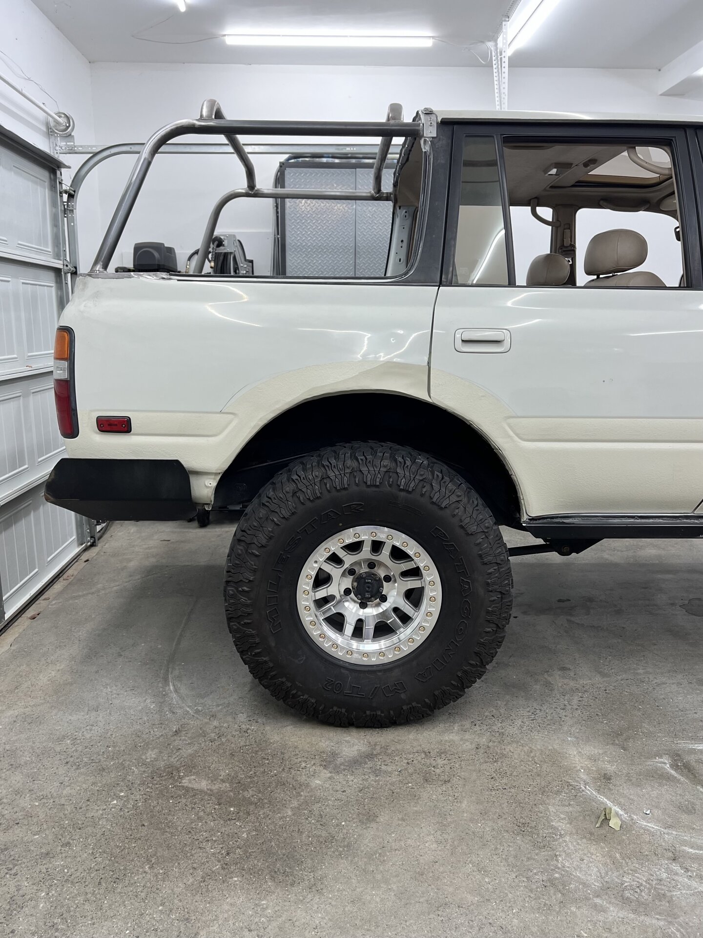

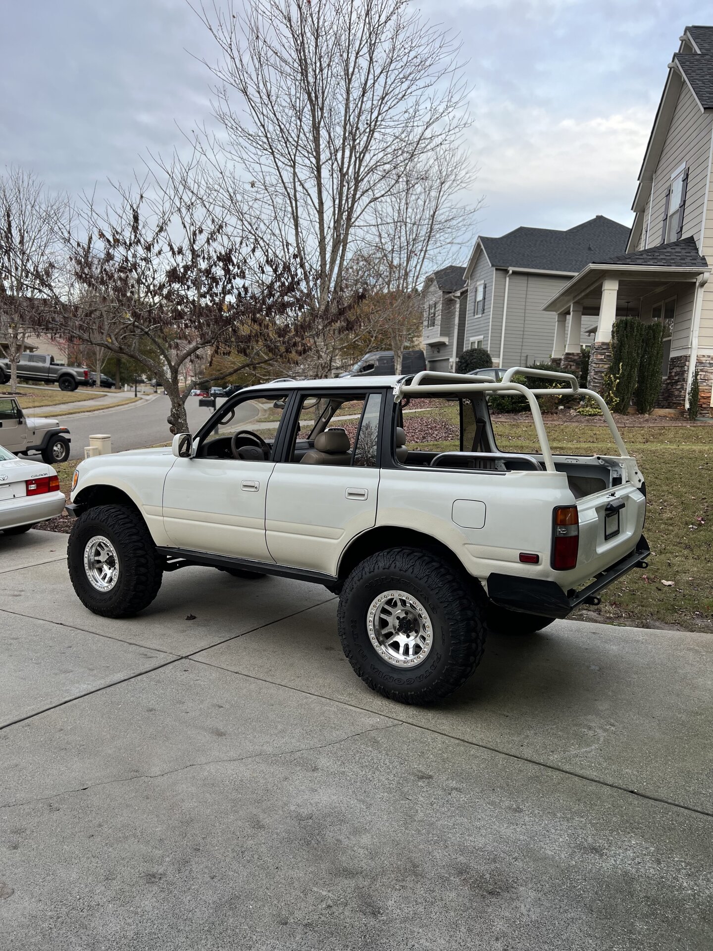

TYpically people will chop an 80 to lose the upper rear corners of the body so the truck will fit better on tight trails. Adding the tube work kinda negates that if that was the purpose for the chop. But the tube work will deal with banging on trees/rocks better than quarter glass and the D pillar. that's neither here nor there, and I like the style and where the build is going. Fun build and really cool that it's with/for your son.

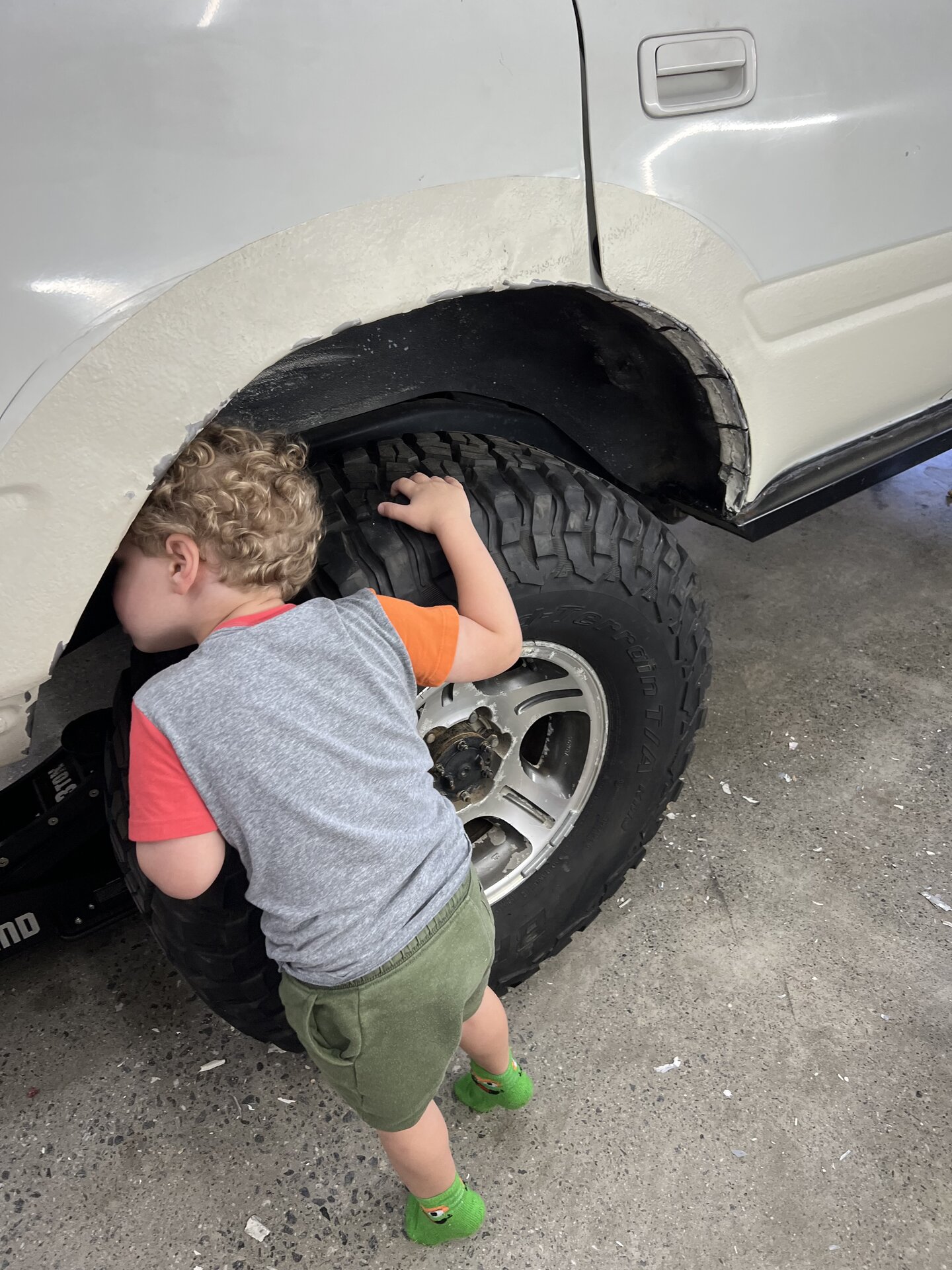

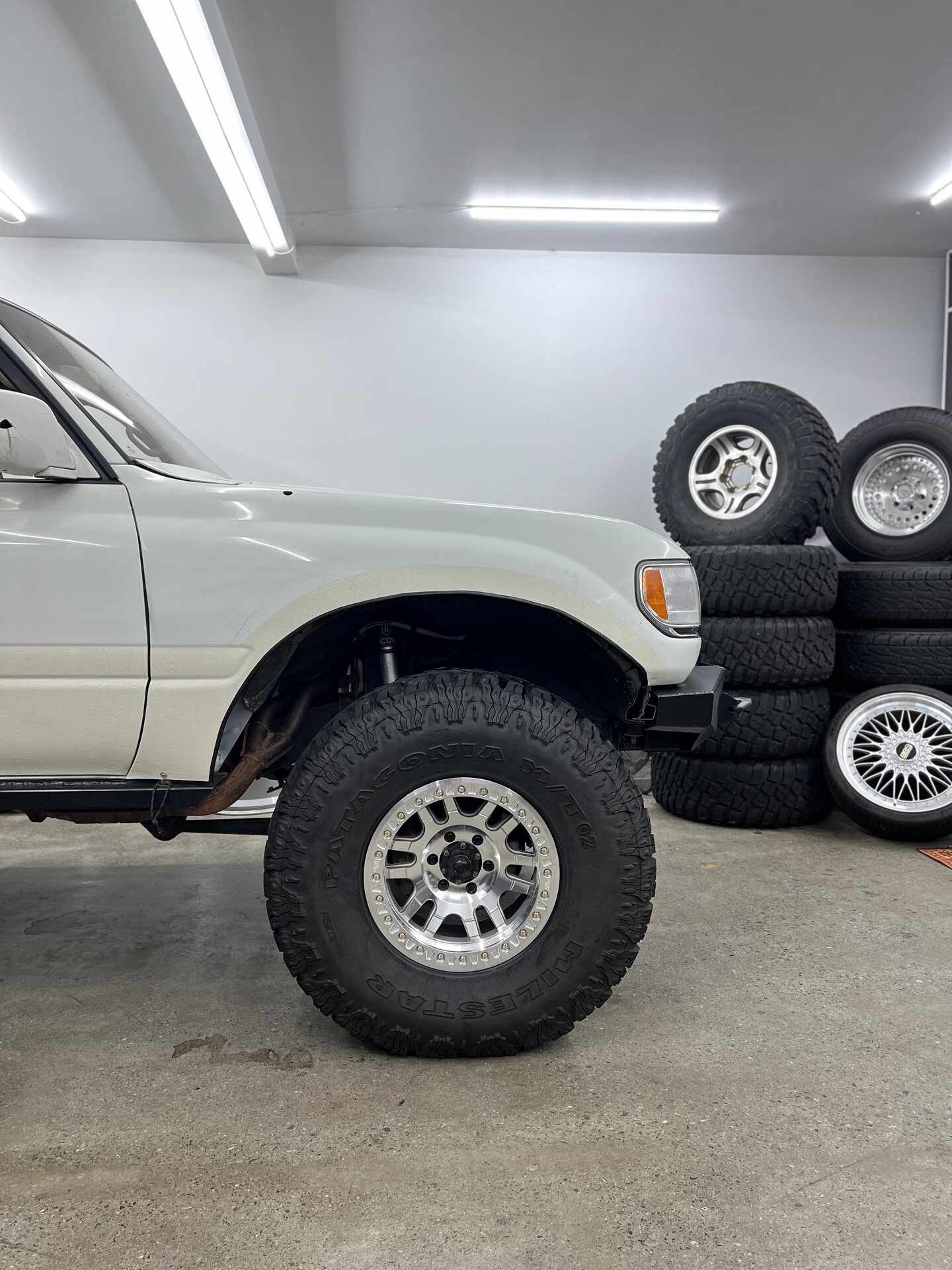

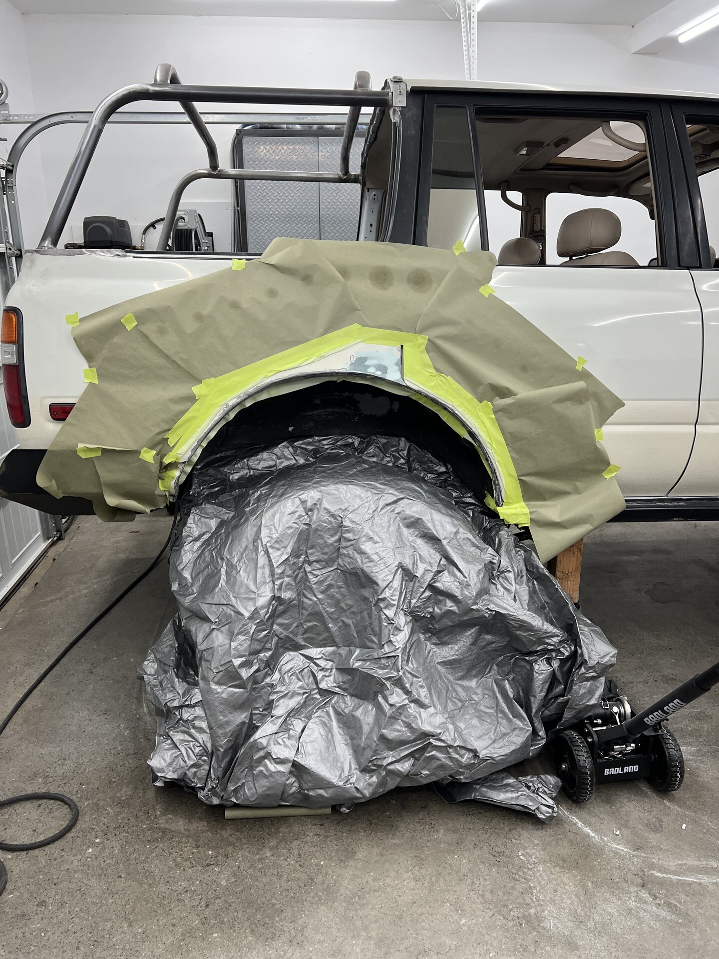

Front clearancing complete. Definitely lose some structure in the fenders with them cut but they're likely to take some damage so not too stressed about it.

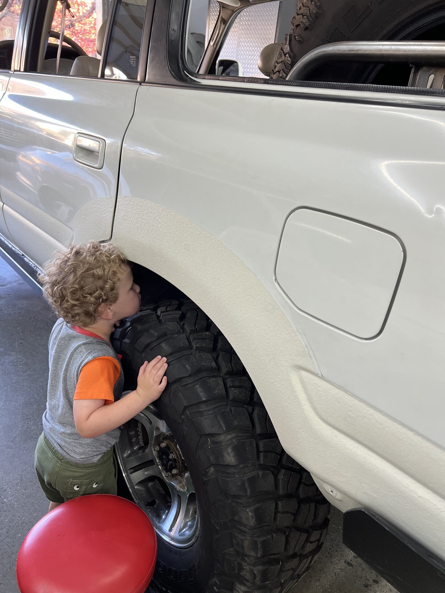

Now for the rears...
"Dad, I think we need more room"
That's better
It's not gonna win any car shows but it will work, and that's the goal.
I agree that we'll lose some of the advantage of the chop for clearance but I wanted to base for a soft top and hated the idea of a fastback style. I honestly would have 100% preferred a not chopped truck to start with but the price point and existing mods on this one made it an easier decision.

Previous owner put the jeep windshield channel on. I'm going to try and incorporate to the eventual soft top build. Cross bars are the same height but slightly higher than the roof line. Wanted the ability to throw kayak or paddle boards up there and have them clear the roof.
Will likely use a local boat upholstery shop to do something custom. Goal is Softopper style with roll up sides and back sections.
You might look into Sunbrella. I have a good amount of experience using it on boats and if taken care of it holds up really well to the elements and is generally waterproof. The downside is it'll tear easier than a vinyl type material.

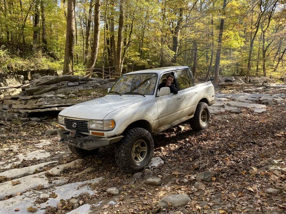

Are you going to wheel it
yeah, need some real dents to hide my sledgehammer work
Honestly other then knuckle studs and maybe a birf here or there you probably won't break anything if you are mostly sticking to GA/TN/NC southeast trials and not loading it down with tons of overlanding gear. Hundreds of similar 80's getting absolutely beat on year after year. It usually wet enough to not matter that much.
this ain't no overlander 🙃
Don’t spend a ton of money on it, come to GSMTR in June with that attitude and I promise you will have a blast

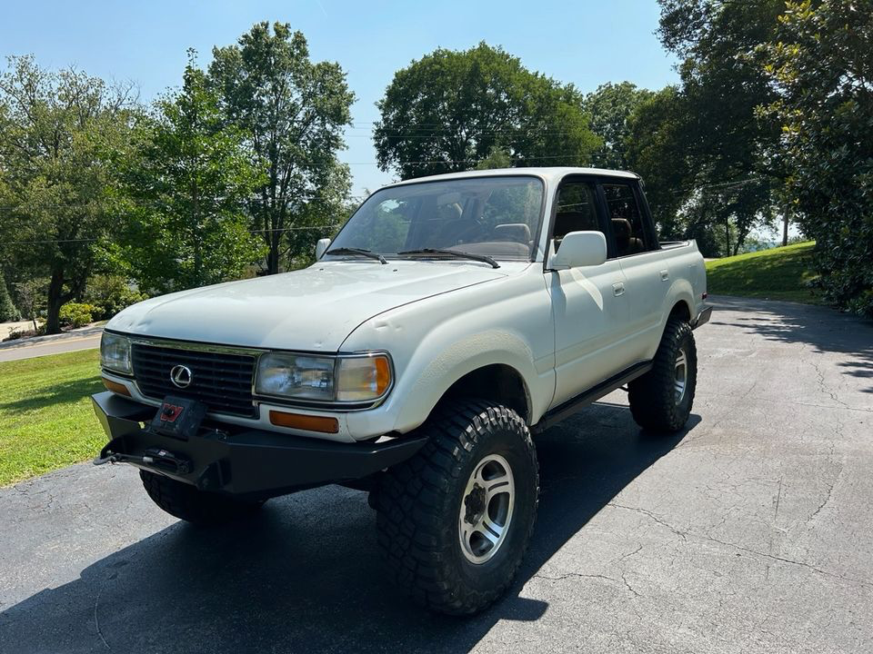

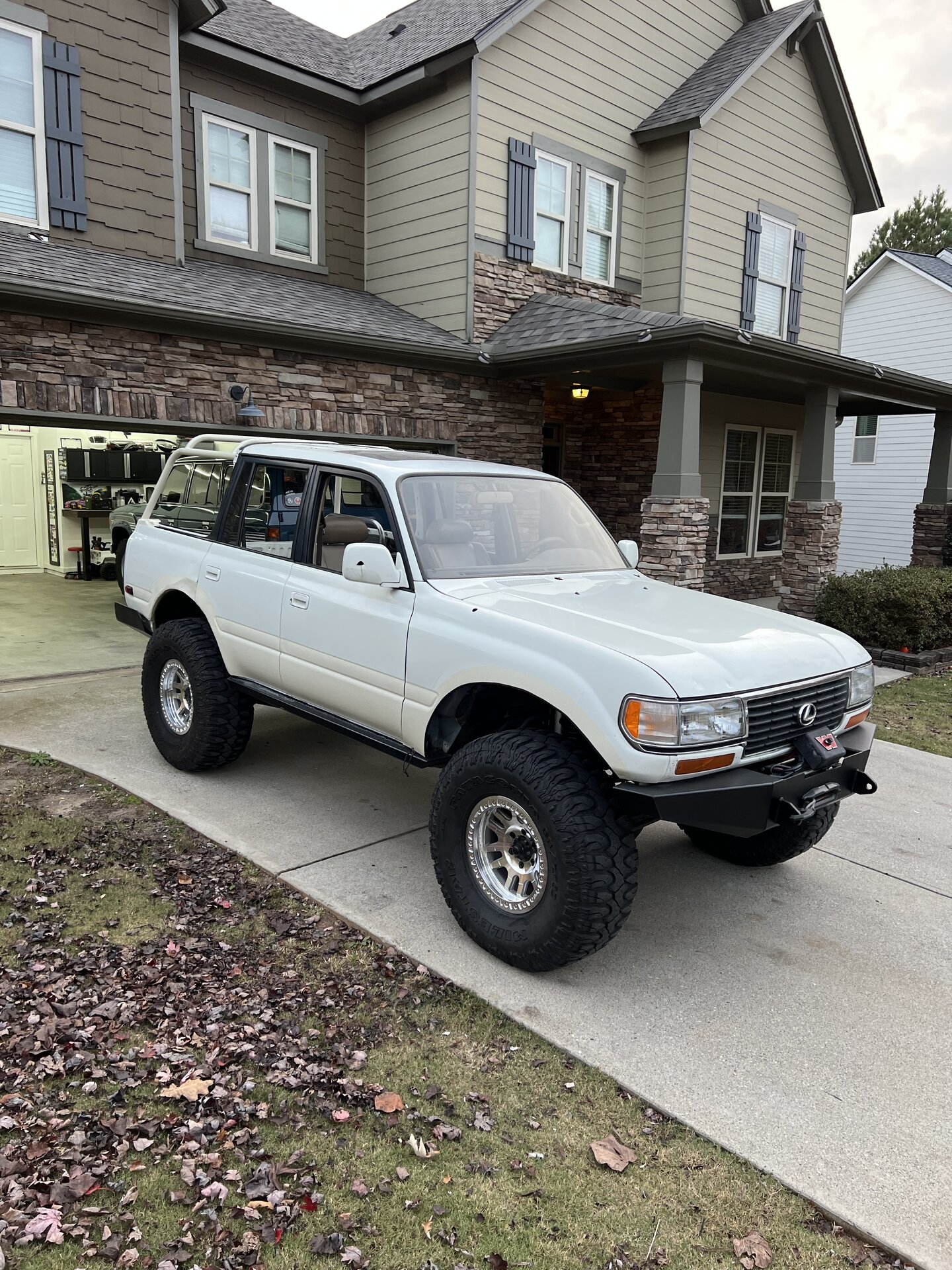

My 3 year old told me he wanted us to "drive on bigger rocks" and I've never been more proud. So we got to work looking for a candidate and it didn't take long to find a fine specimen on Facebook marketplace. We loaded up for Nashville and brought home our new 97 LX450. He has now affectionally named it the Lexus Land Cruiser with no roof on...

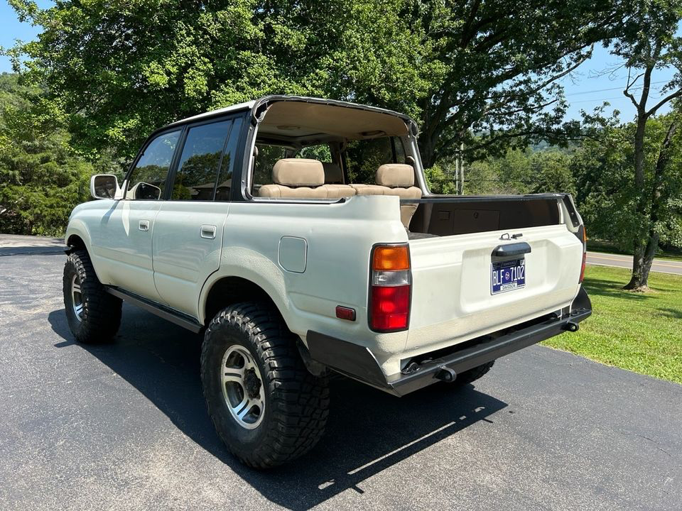

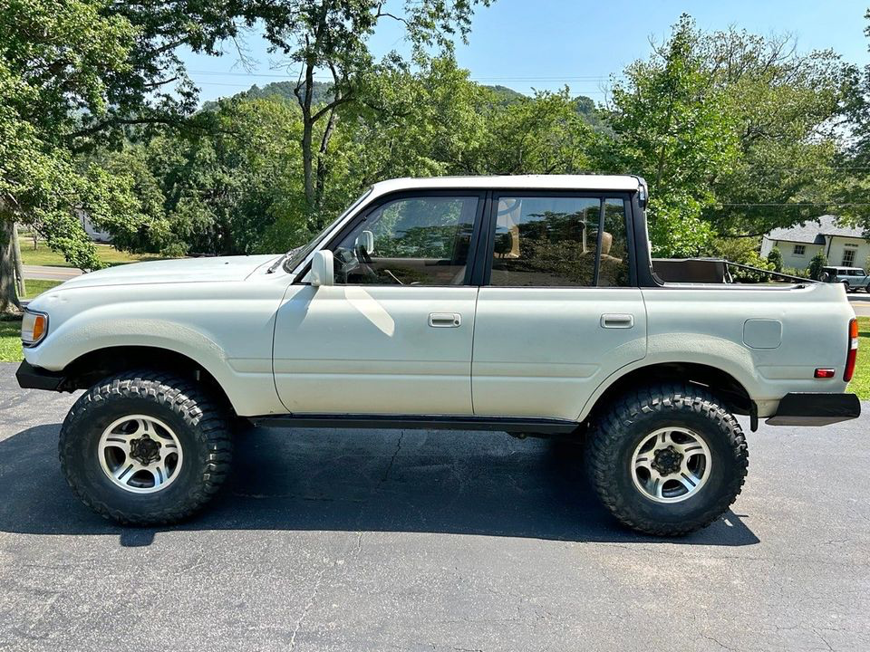

Technically @Jeeper was the one to start the "ruining" but it won't be the last time this thing sees a cut off wheel or sledge hammer... In true legend fashion, Roger cut off the rear roof section section and rockers (in favor of boatsides). He also added factory lockers, front and rear bumpers, Warn M8000, suspension and 35s and deleted the flares. A great base for a build. Thanks again Roger!
***trigger alert*** this was a 1 owner, 180k mile, rust free southern truck that lived most of its life on a country club. sorry. ***/trigger alert***

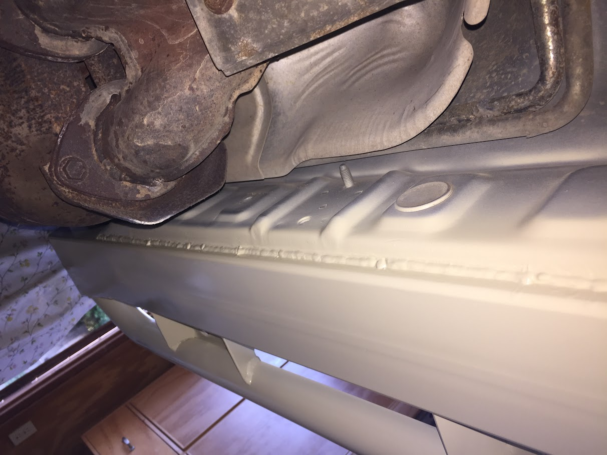

Those rock slider are a game changer on a 80 ;) ask me how I know !!
Ok. 🤔
Color me intrigued.
Alot going on there ... care to expand? Admit I've never heard of such a mod.
Do they legitimately work?
Can they uphold half the weight of the vehicle while say, lodged upon a rock? Such as a slider - attached to the frame - would do?
I ask because finding sliders for a '93 is quite the covfefee (kerfuffle) due to the cats.
They definitely work and hold up, I did mine in 2015 and it's a dedicated crawler/trail rig
