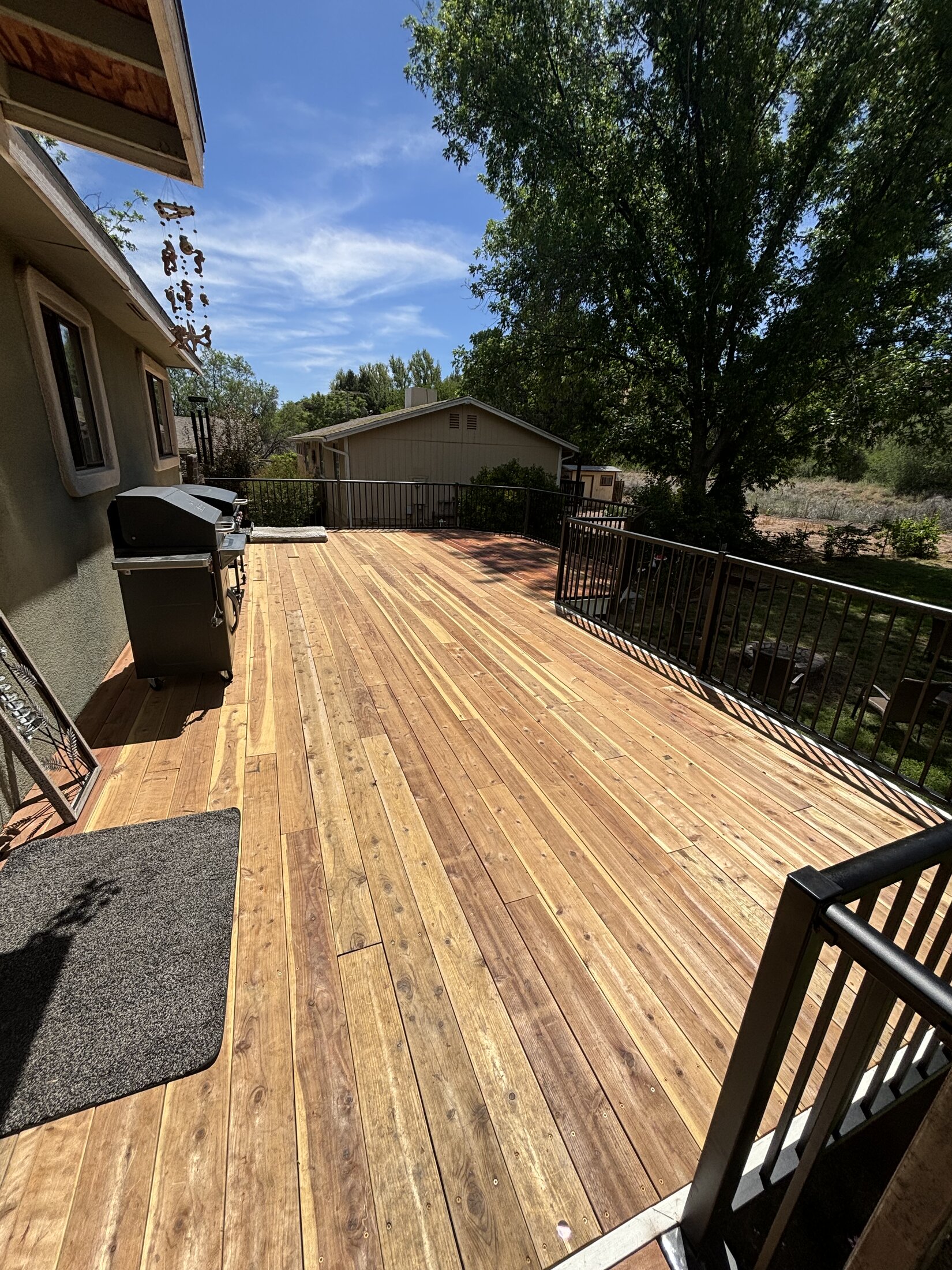

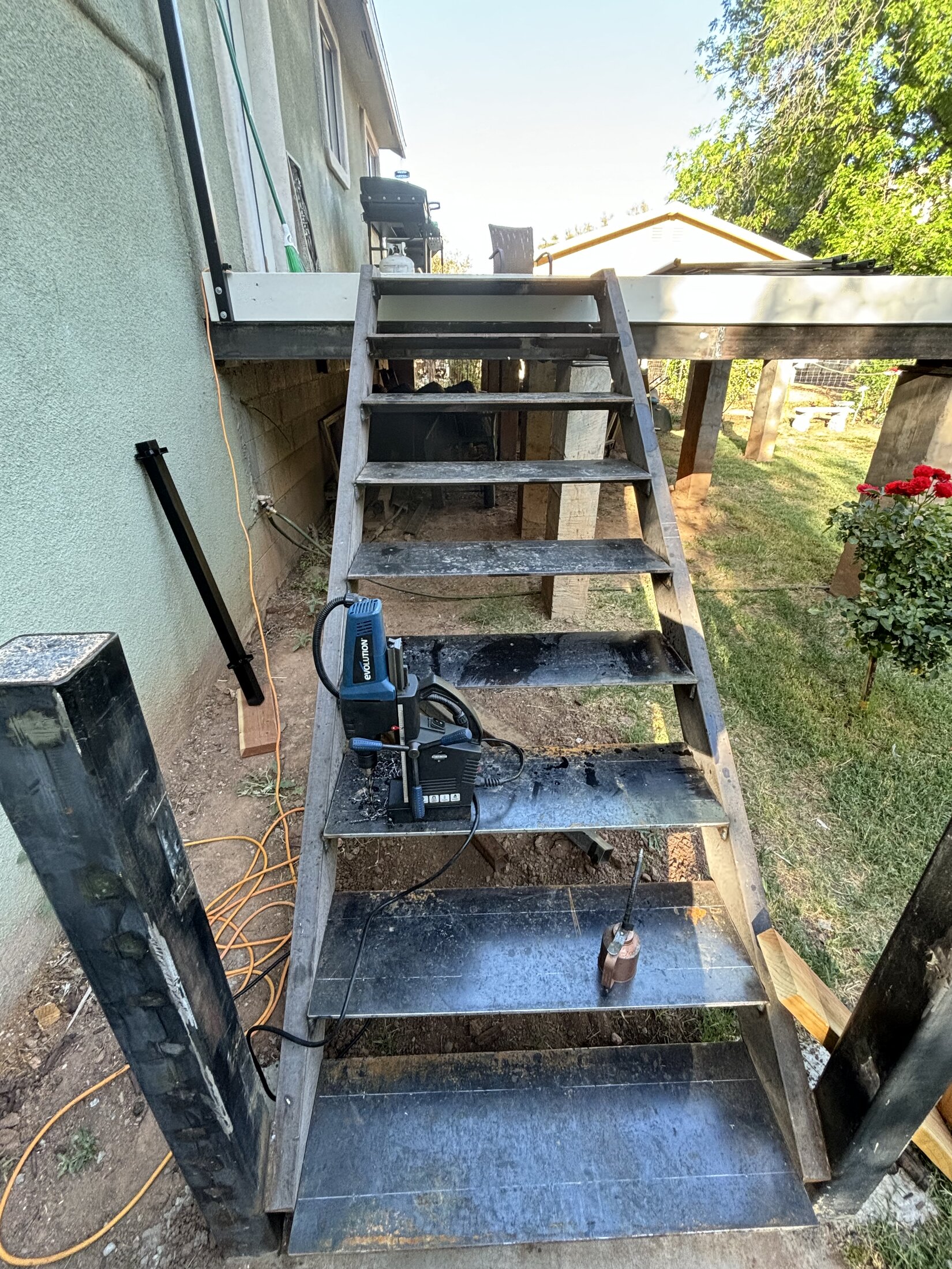

Set the last section of handrail at 2pm on Saturday (the day and time the graduation party was set to begin). Still have some small detail work to finish, but it’s complete. Too bad I don’t have any “before” pics for comparison.
Should be good to go to get on with Cruiser crafting.
I’m satisfied the most with how the stairs turned out. 6” channel stringers with 3/8” plate steps with 2” x 1/4” angle strong-backs covered with redwood 2x6’s held down with 3/8” carriage bolts. Solid👍🏼

Nice job...and just in time. I've always found adrenaline to be a great motivator.
