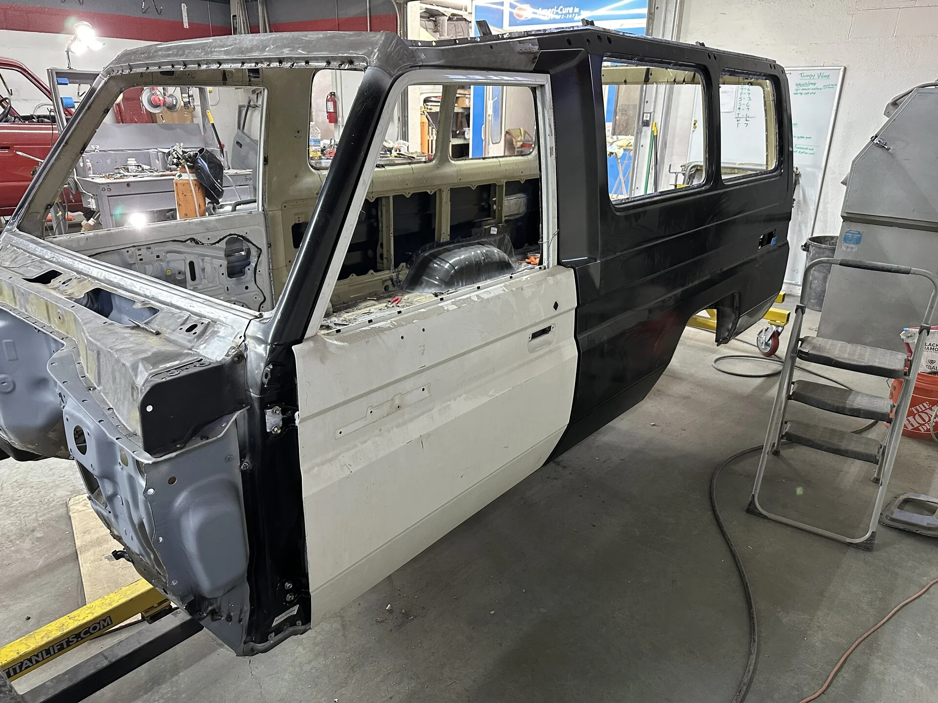

Super amazing restoration like I said to @ofer bruhis this is not for the faint heart 🤓

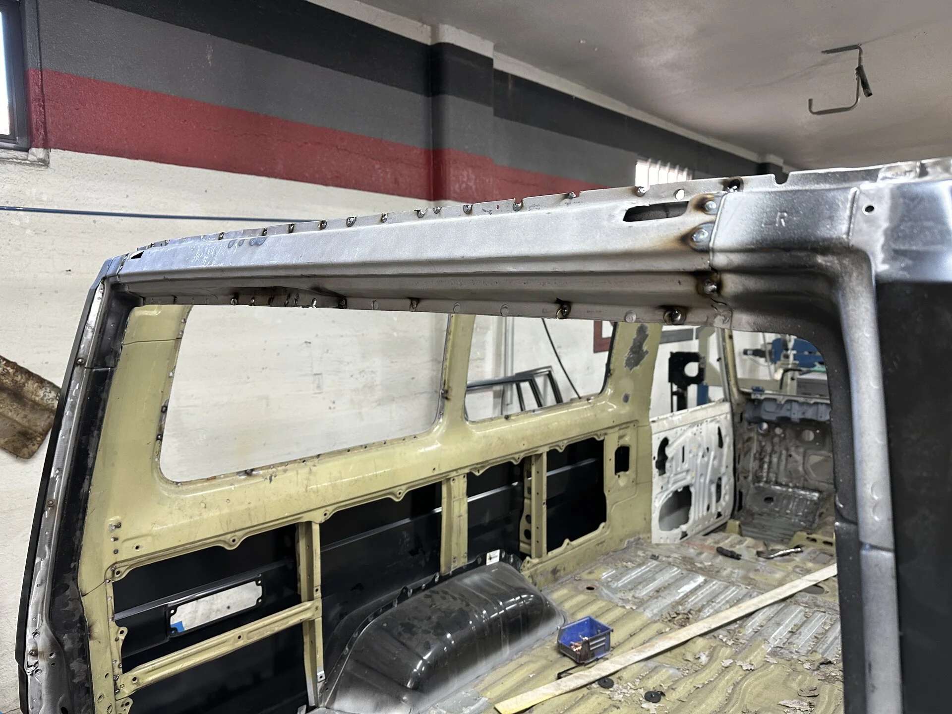

Before I forget on the top of the quarter panels there some rivnut for the Alucab to sit but since everything is open now you can definitely weld some solide ancrage to the roof braket to bolt to instead of rivnut ? I hate rivnut lol 😂
Looks great Kelly. Can’t wait to put it on the frame that is anxiously waiting for it.

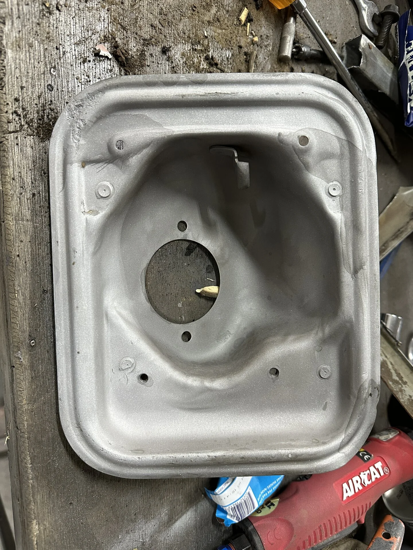

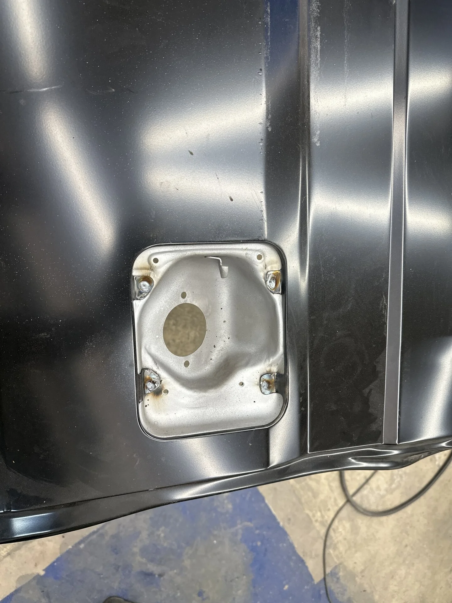

Man if I knew you needed a new gas door sheet metal, I had a spare new OEM here at the shop. I would’ve sent it to you.
Thanks Onur!!!

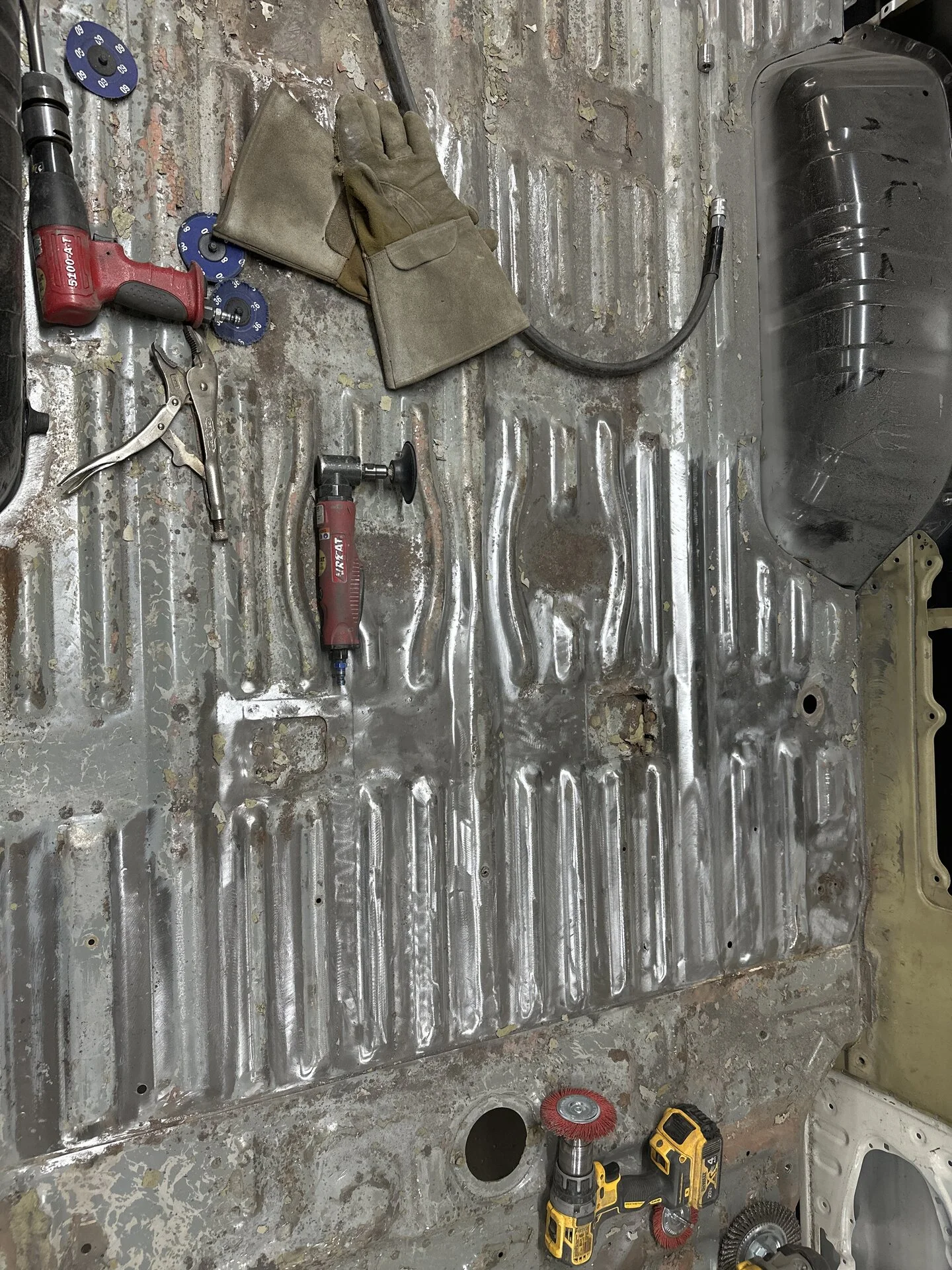

Still here tonight at 8:30. Been chipping the double coating off the floor with an air hammer. Everything else I tried doesn’t work. Took a few hours sitting with headphones on. I’m going to try and wheel some of this final coating off before I leave.
Would dry ice be appropriate for assisting in removal?
In the rally car world when we are building a new shell, we buy some dry ice and apply it directly to the sound deadener...it weakens the coating, then you can just bang it with a hammer and clean up all the pieces with a shop vac.

That’s good advice and thank you. This coating was a combo of some gummy orange stuff and then tan (color matched) liner rolled on top of the orange stuff. The dry ice technique might have worked, but it was the entire floor. Any wheel I used, just heated up the orange coating and turned it into a goo that just spread around. The liner was hard on top though, so when I chip at it, both coatings pop off. Now that it’s all off, I’m removing the rust pits and factory coating that’s on the metal. It was just too time consuming so I will sand blast in the morning. Thanks!
