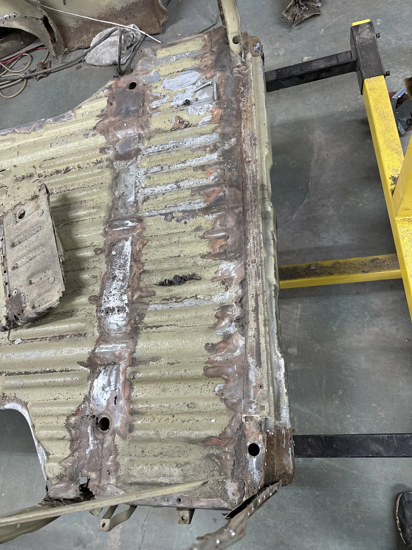

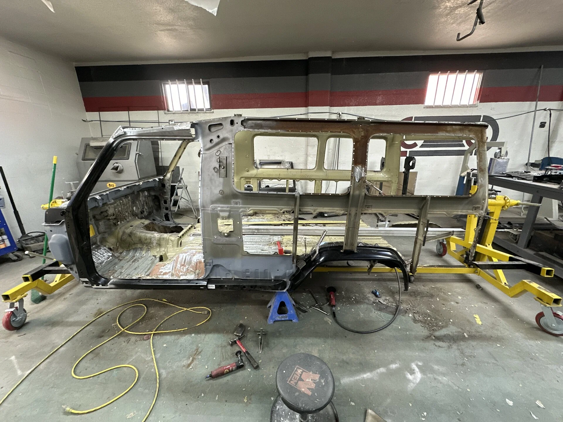

Looks a little ugly, but once its cleaned up and coated, it will look nice. Now with this all back together, we can move forward.
Nice work!!!

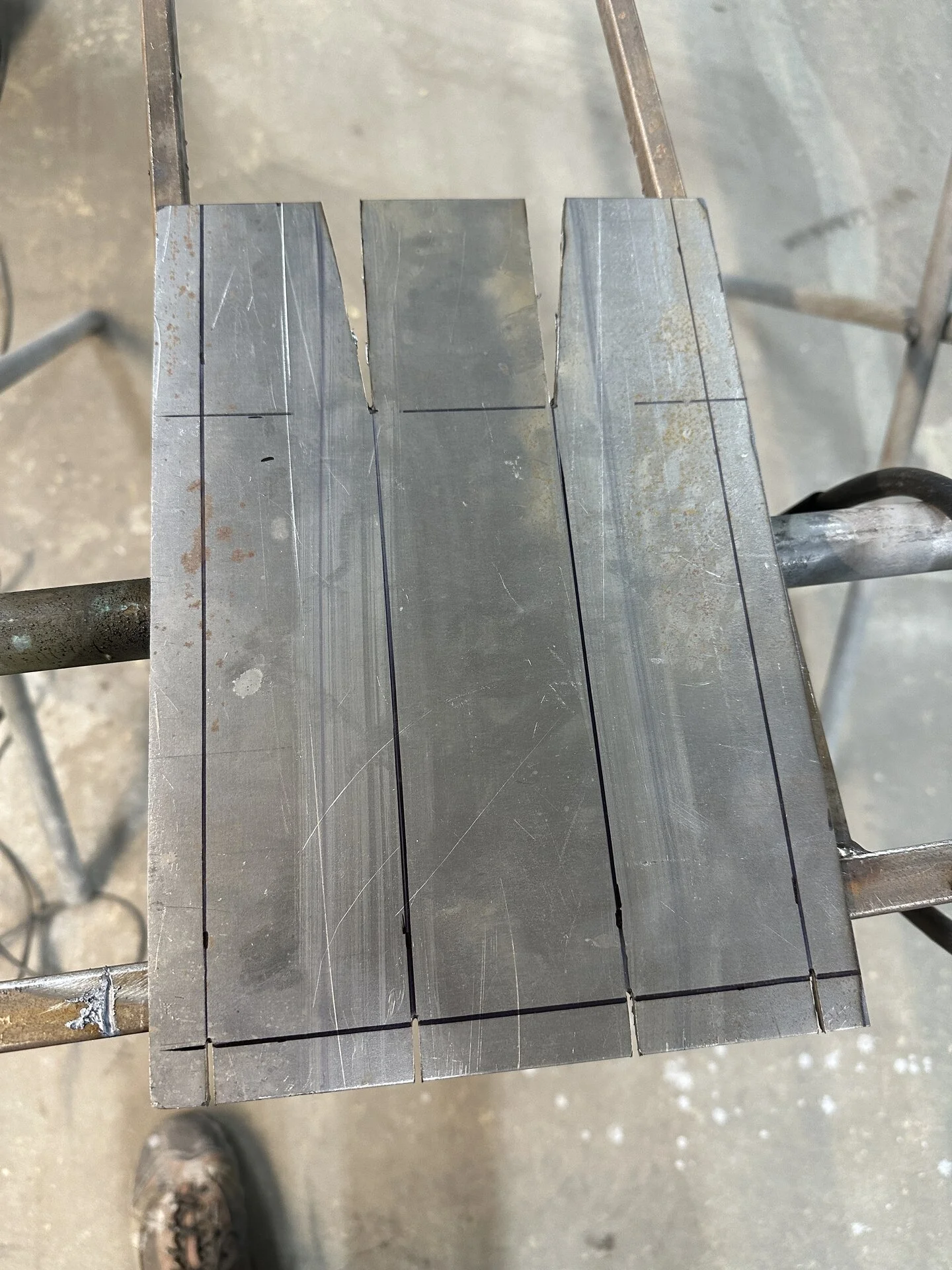

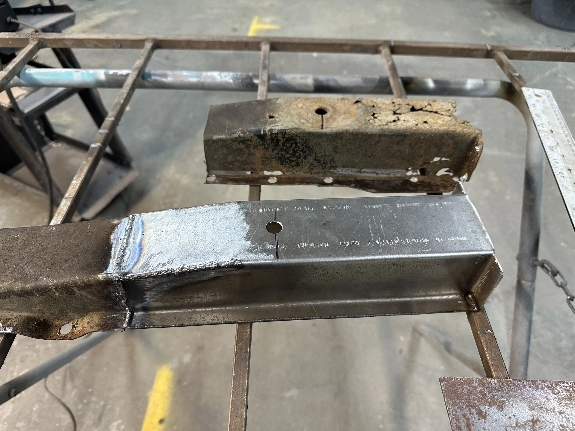

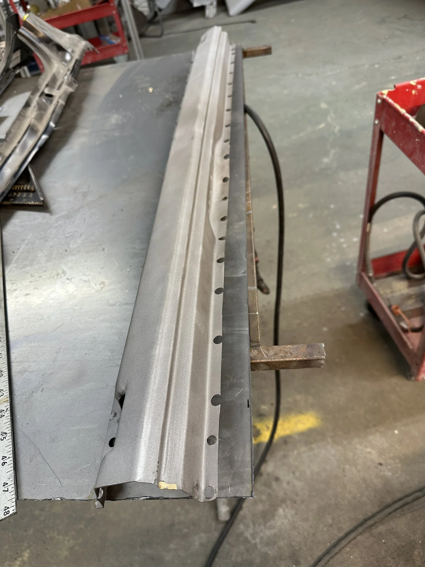

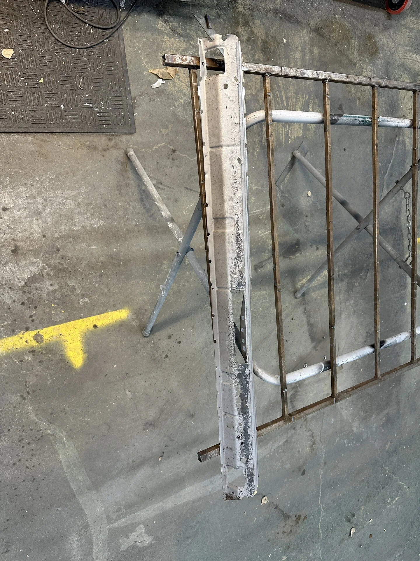

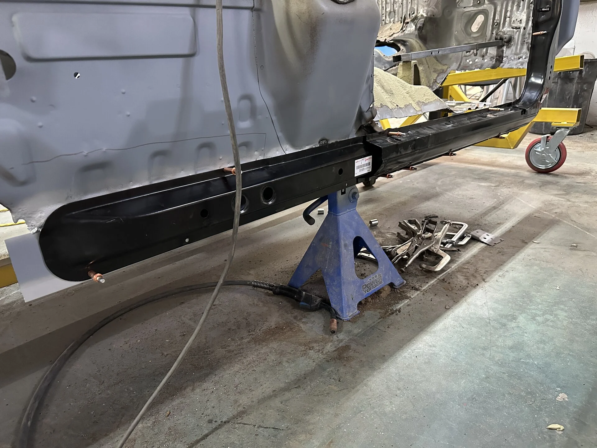

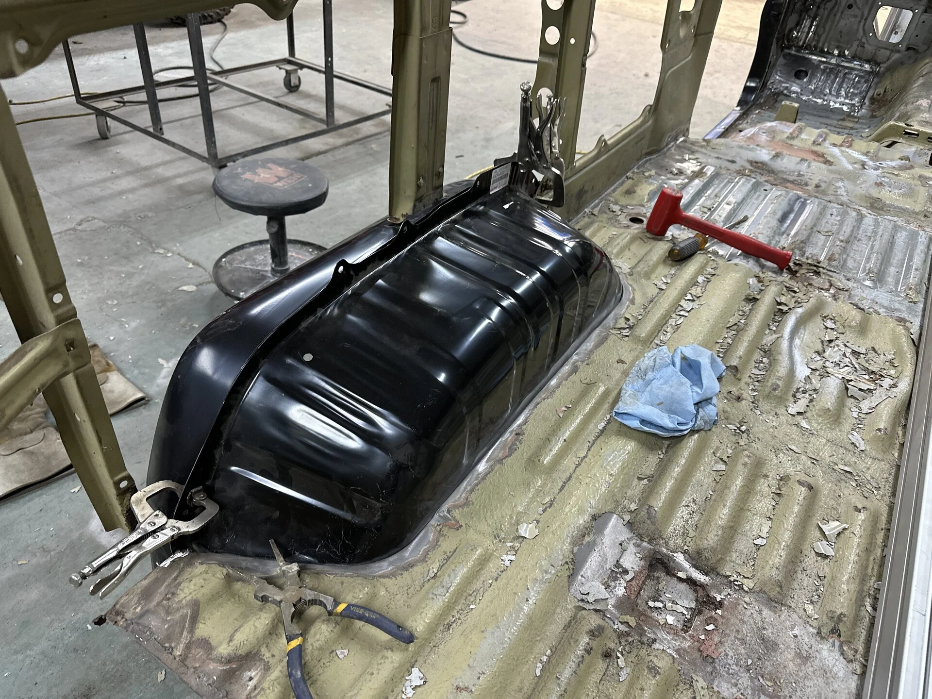

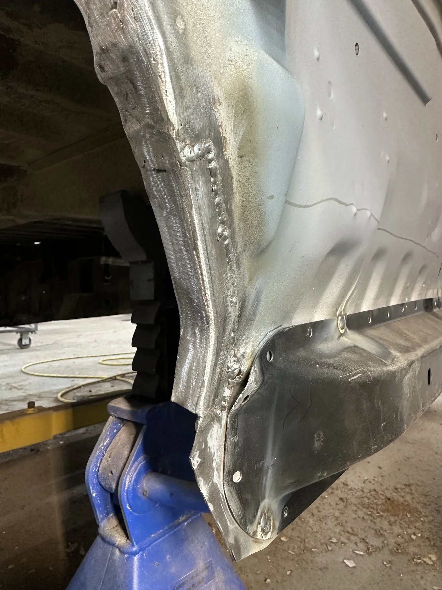

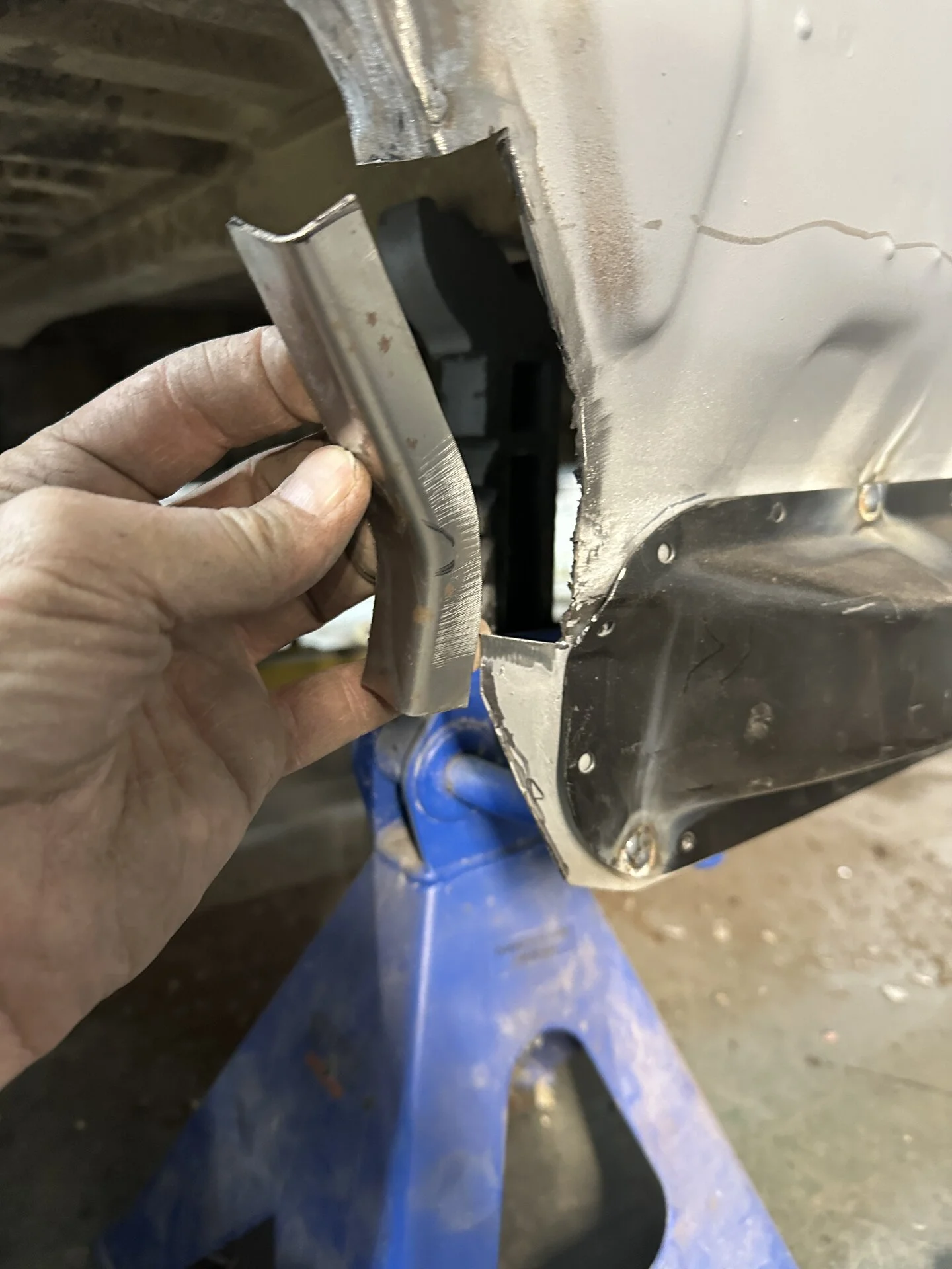

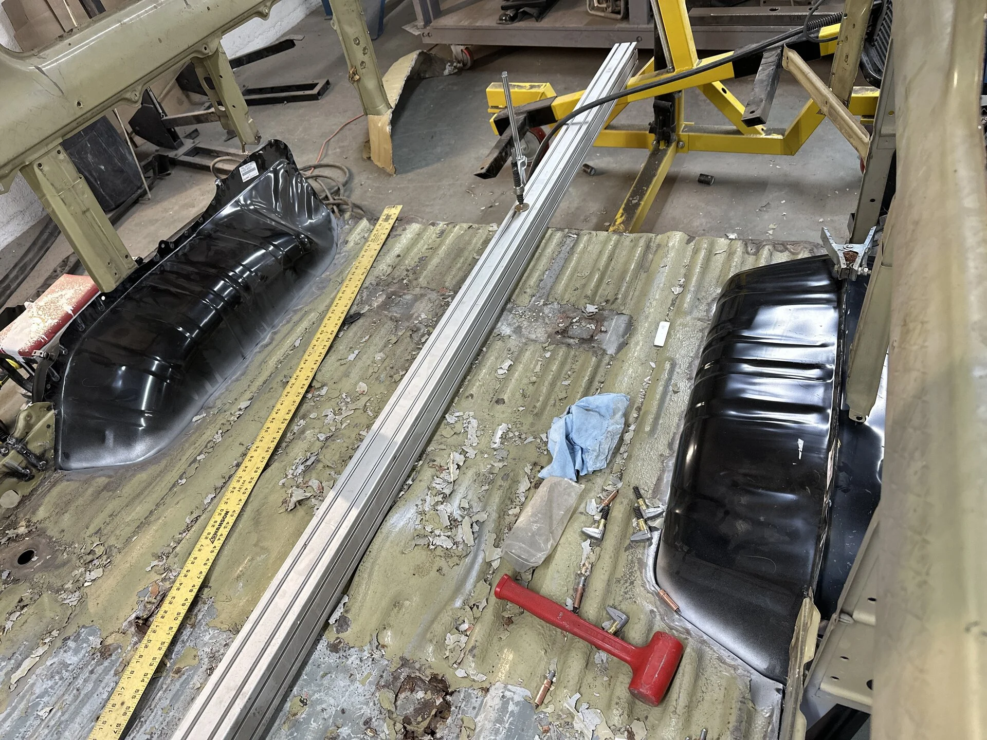

Rear inner fenders are tacked on now also, and that step really strengthened the body, as it was a flimsy mess for a while there. There was one patch (in photos below) needed before the inners
could be installed. We had to remove it from the rotisserie for a week because there was no longer anywhere to attach it.
