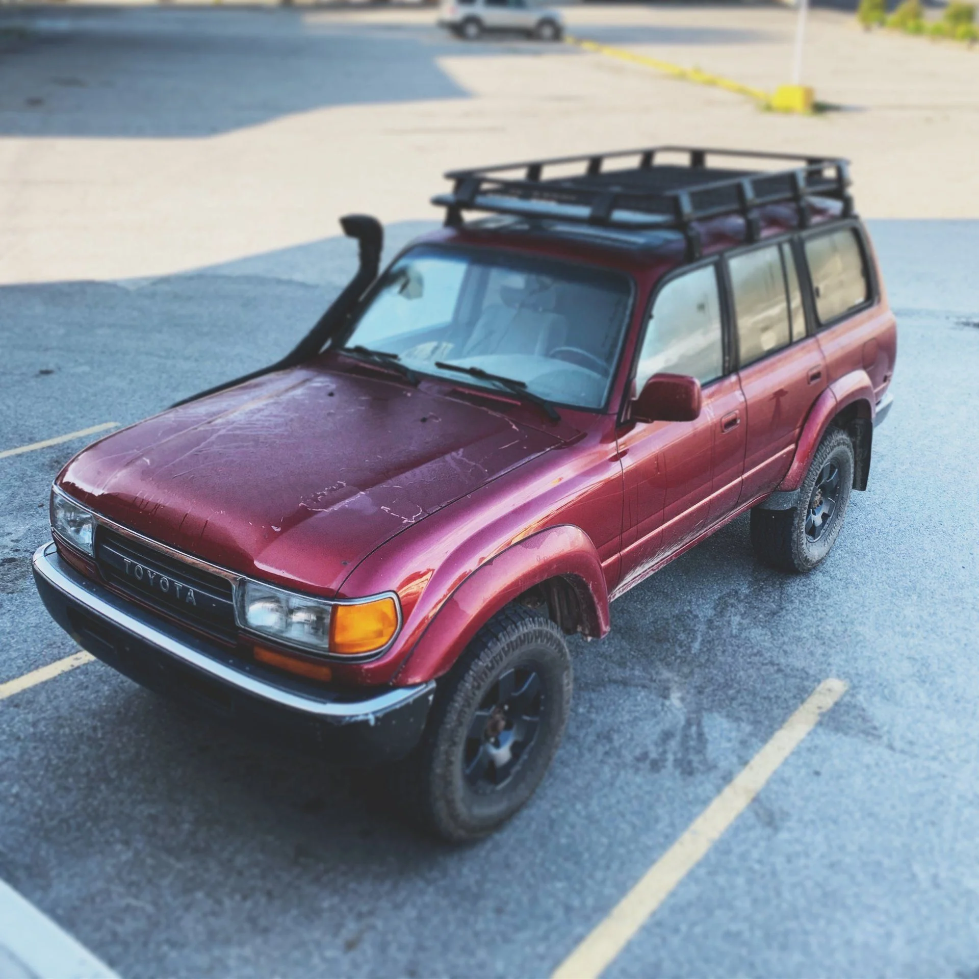

A bit harder to tell by the angle of the pics, but if those are 33" tires, you're already at least 3" lifted. And if you want 35's with decent articulation you're after a 4"+ lift minimum (with spacers or otherwise) and all the pros/cons that go with getting that amount of lift to work satisfactorily. Which is where the "How much do you want to spend?" question comes in to play.

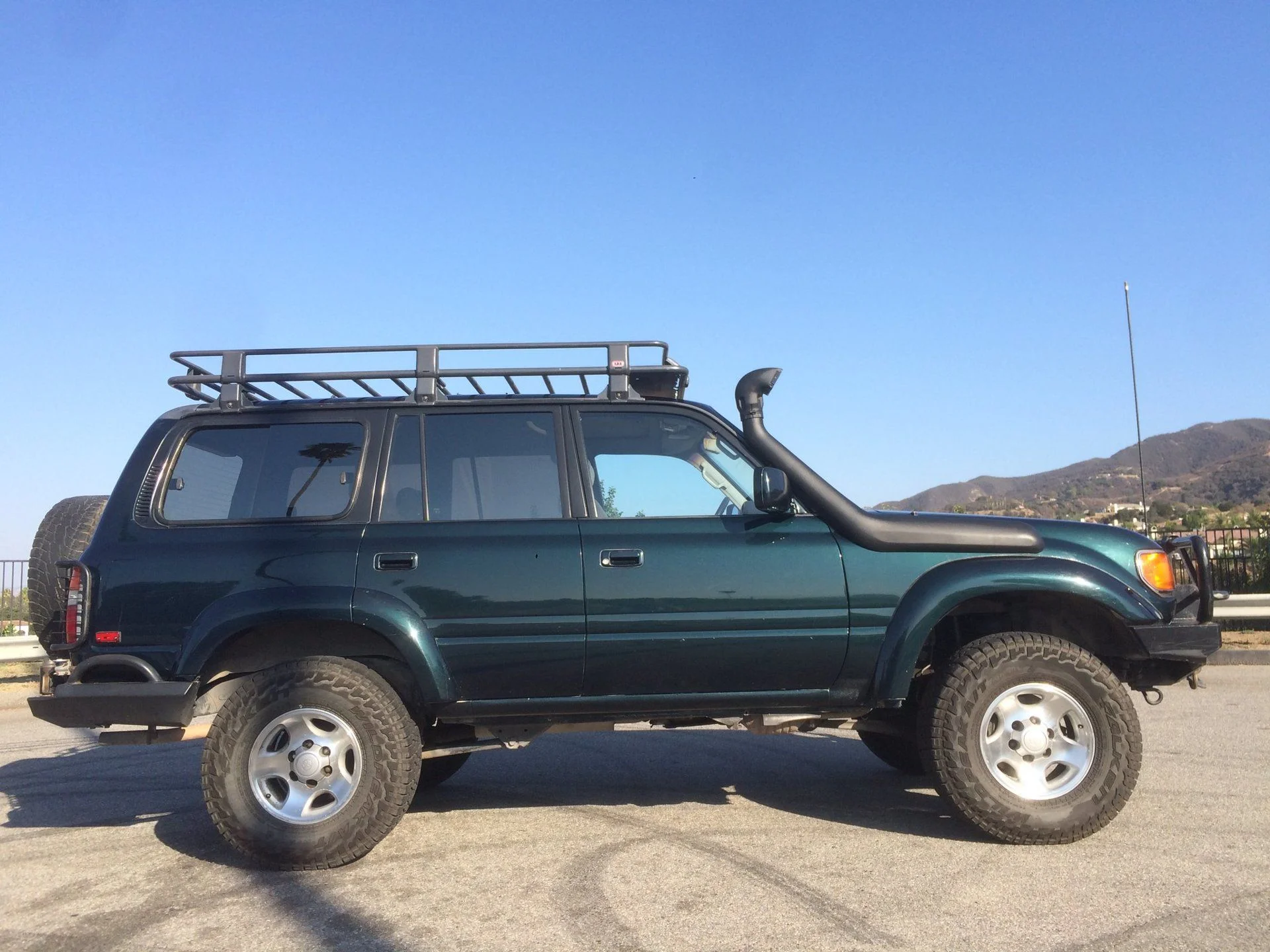

My old 80 had arb front bumper with winch, arb roof rack and slee rear bumper. i had it on ome med's with front trim packer from Manafre. So yeah i agree with everyone to keep 'em on and then armor it up to see where it sits.
OLD RIG with ome med's and manafre spacers up front.
Current rig is also on OME med's with a trim packer up front. not as much weight bolted on this time around but still looks good. i guess my point being the ome meds have a pretty good rate to handle stockish or armored

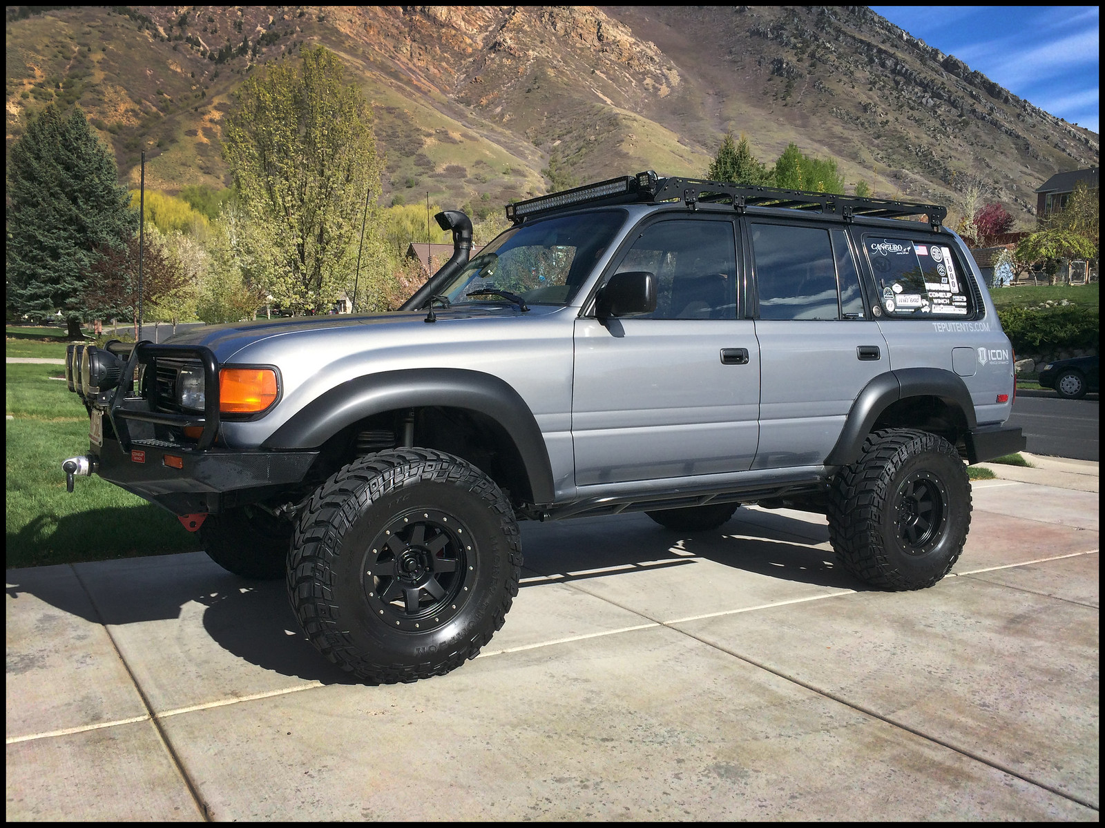

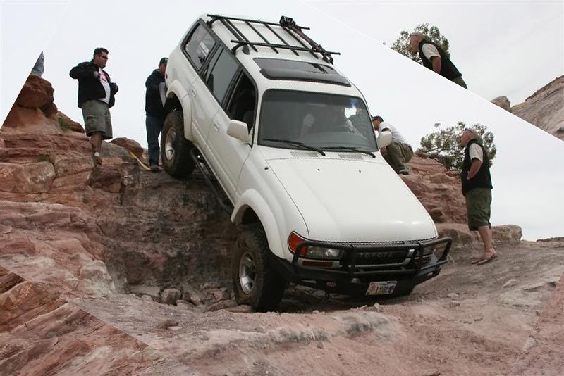

uh.... no. My old 80 with 35's on a 3" lift with no other mods to "make them fit" or to "make them work really well". Oh and this one is unlocked. Must be a useless rig. ;)
whiteKnuckle by Adam Tolman, on Flickr
256 by Adam Tolman, on Flickr

3" lift on my current 80 with 35's and no other mods needed for the tires to fit and work.

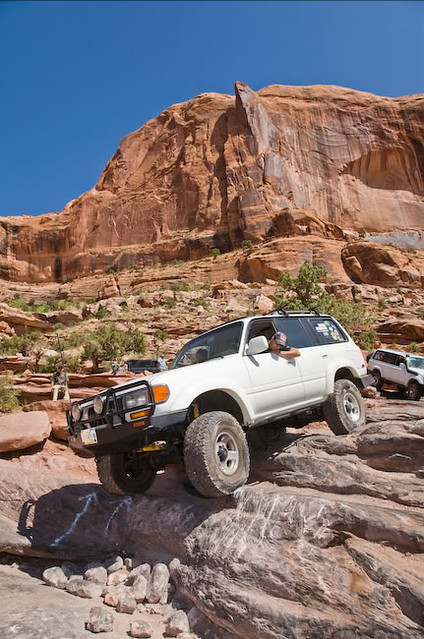

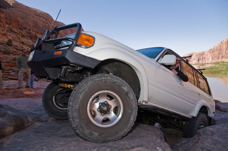

Tell me more about all the needed X, Y and Z parts to make 35's work on 3" of lift. Was a pretty easy bolt on for me.
IMG_0630 by Adam Tolman, on Flickr
Just busting your balls. But it really isn't difficult to run 35's with minimal lift and still have it work very well. In fact, I'm running 37's on a 3" lift with only minor trimming (still have the flares on) and 1" additional bumpstop. I have some other mods as well but none of them are "necessary" for the tires to fit and work.
