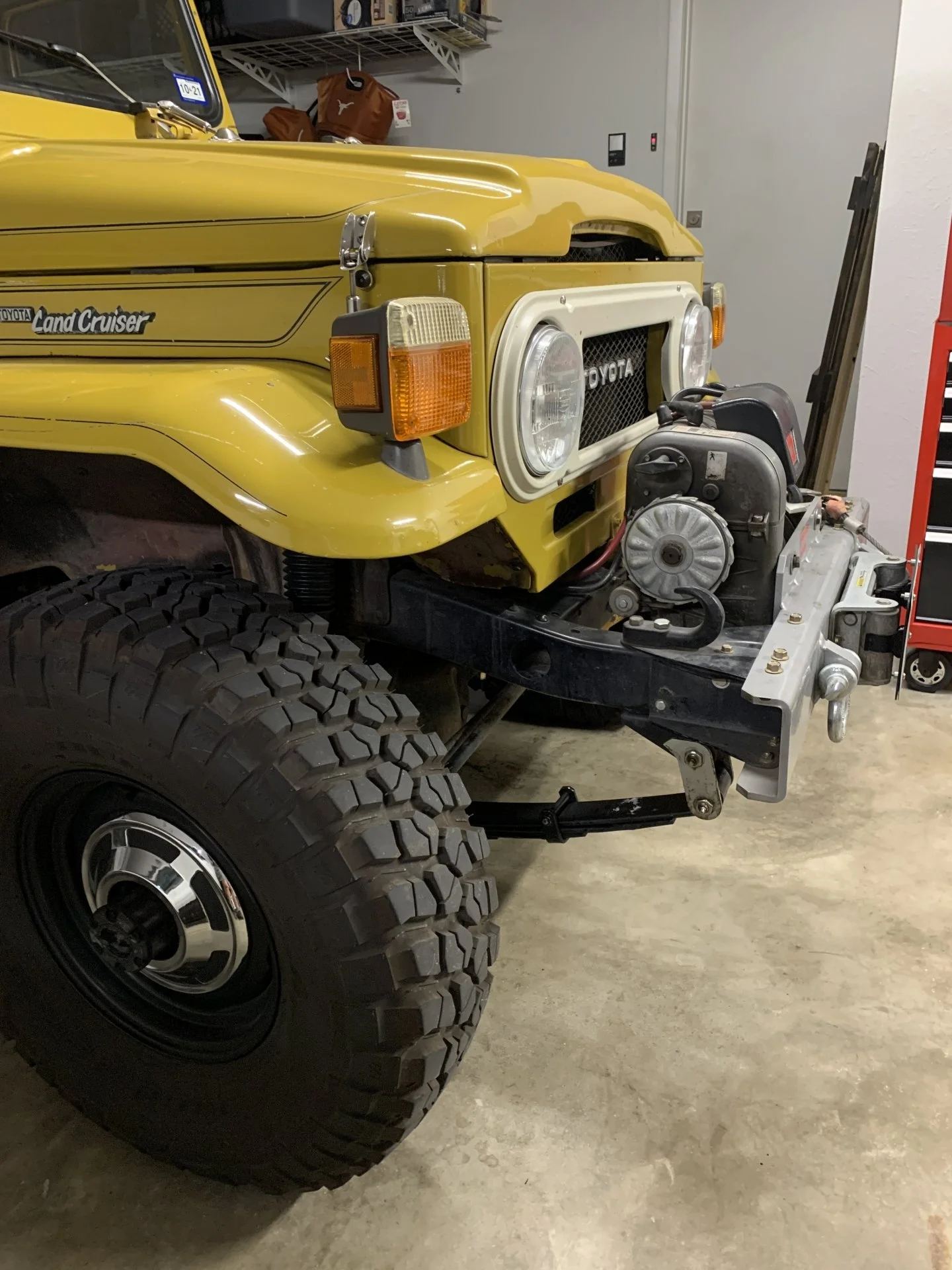

No bueno, here’s my front after the Skyjackers. My axle came forward about 3/4” and the shackles now rake forward, the result is a more supple ride and better flex.
as the shackles are supposed to be. im still waiting to/see what this perfect 90 degree angle is, because if it is the shackle being nearly straight up and down, that's a pretty clear indication that the springs are cut too short, or are over arched for their cut length.
