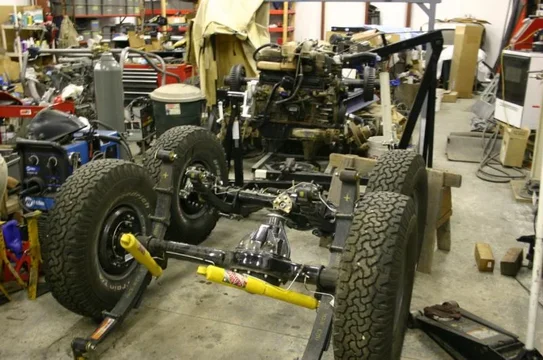

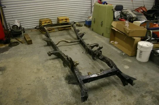

Job number 1: remove engine/transmission from the chassis. Then mount the engine into the engine stand (BTW--the rotating Omega stand is AWESOME, how did we live without it?)).
The axles separated from the frame...
And the frame devoid of all hardware sitting on the floor.

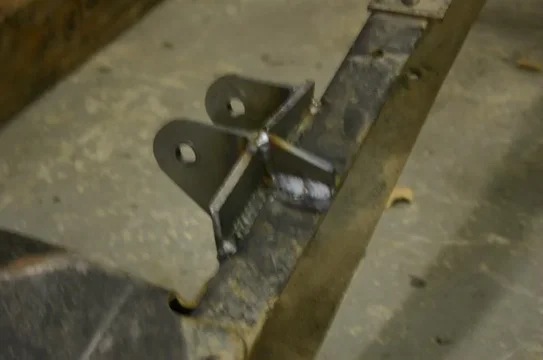

I added some gussets to the frame tie ins for the roll cage. Sorry for the blurry picture.
Then we turned the frame upside down, and I finished the welds for the 60 PS conversion, the cage tie ins, and the transmission crossmember. (why can't all my welds turn out this well?)

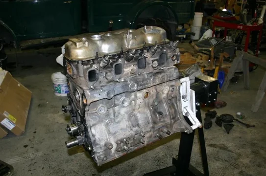

Then I turned my attention to the engine. I basically took a bunch of pictures and stripped it down to the block for painting.

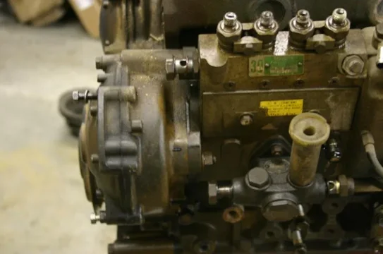

Second: there was another thread asking about flipping the oil filter on the 3B. Here's why you can't.

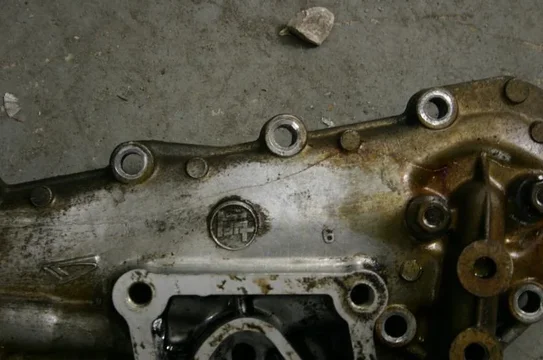

The oil cooler has a crack in it. How big of a deal is this? It doesn't appear to leak, and it will be coated, so I'm not TOO worried about it, but it's still a crack that I don't like. I see it on the inside of the cooler housing too, so it's more than just a casting error.
And just some generic pictures of it being disassembled... (including the match marks for the IP)

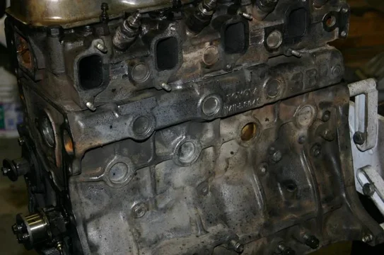

Are you gonna replace the rest of your freeze plugs with brass?
Haven't decided. It'll probably depend on the freeze plugs being included in our rebuild kit or not. I don't see any leakage in any of them, or evidence of it in the past. The second to last one on the left side that you see was pulled to install a block heater. The block heater was removed for paint.
Dan
Although not an issue now, i highly recommend that you consider it. I had 2 rot out on me before. not with that particular engine though. Its not funnest thing to do while still in the rig. All depends on how long you are planning on keeping it too.
fifth glow plug? take a pic from above and show me the hole.
it would take a few applicaitons of seafoam and or auto tranny fluid to clean that engine up, pretty bad
flipping the oil filter works well but get the proper housing instead.
cracked oil cooler, if you are concerned then replace it. me, if it isn't flexing or leaking then leave it alone but i would want to see it in person before making a recommendation from 20,000 km away.

I got a core 3B from a BJ42 that had its oil cooler housing split open while out on the road. Bled out the engine and before the guy realized it was a problem it started to knock. Probably uncommon but I'd inspect the housing really close in deciding to run it or not.

As with frost plugs / freeze plugs , seeing it has a block heater , Im leaning towards someone use coolant / antifreeze that should have a clean internal cooling system, if you see lots of internal rust , and the rad came out with brown water, then I would have a real close look at the plugs. Problem the plugs are also in the Cyl head machining jackets , and there's the real crappy ones to replace. There also much thinner in material. They are a separate part #'s from any kit I've seen. I have replaced a few of mine only.
Your Oil cooler cover looks cracked from a freeze , and I would replace it. the gasket for it is available , but from that cover to the cooler member itself i used Teflon covered metal gaskets , turbo shops have them as large drain gaskets. Those were NLA.

Yeah, I'm going to dye penetrant test the oil cooler housing, but I suspect I'll need to find a new one. Somehow I suspect that'll be kind of hard to find just a oil cooler from someone parting one out (PM me if you have one--to anyone reading).
I'm not thinking of touching the crank or pistons (maybe I should?), but I definitely want to de-gunk everything. I pulled the freeze plug to put in the block heater, and the engine was shipped by itself, so I have no idea how the original radiator looked. That said, when I ran it (and had it up to temperature a few times--with a radiator flush in there to help clean it out) I got an awful lot of nasty rusty stuff out. Almost muddy in parts of it. So I think I'll get to work finding a freeze plug set (or rather, checking to see if we have them in the rebuild kit we bought from Radd), just to be safe. (well, also because new freeze plugs look AWESOME installed in a freshly painted engine--but that's just simple mechanical bling).
