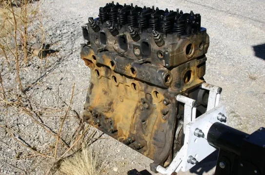

Got the engine cleaned up. Then I pulled all the freeze plugs and did what I could to clean out the cooling passages. All of the "rust" you see is what came out. That metal was CLEAN before I started that.
In the end though, I think I got all the rusty sludge out, and there was definitely some pitting on the back of some of the old plugs. Pretty glad we decided to pull them right now.
Once that was done, I got to clean the block again.
I can't rave enough about the geared rotating engine stand. SO much easier to clean the engine up--especially making sure that all the gunk drains out after I've put cleaner inside those passages again.

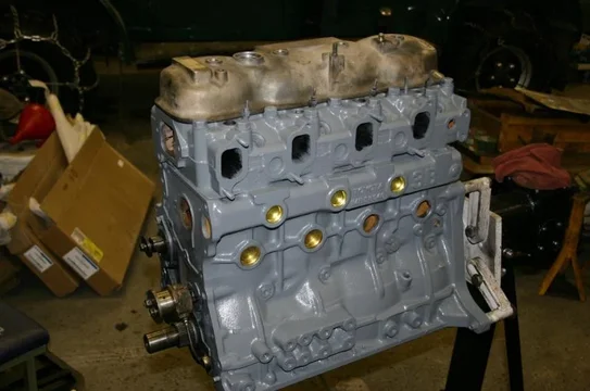

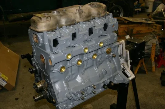

I got the engine clean enough that it was flash rusting when I ran back to the house for some supplies. Obviously that won't do, so....
Then once it had dried in the sun for a while...
Yeah, that's sexy.
That said, I'm having a problem matching some of the freeze plugs. I measured a 55mm one, two 50mm, some 27mm plugs, and some 25mm plugs. I couldn't find 55mm or 27mm plugs at all, and the 50mm and 25mm plugs are REALLY close, but just a touch too small. Are these actually SAE plugs instead?
I'll be at American Toyota tomorrow, so does anyone have the part numbers for the freeze plugs? You can see the ones I don't have--because all of the ones I do have are installed and looking good in the pictures above.
Last question: block heater in the last hole, or second to last hole? They are both easy to do right now, so I'm just debating which one is better. I'm guessing right behind the starter is better, because it'll overall put some heat into the starter itself, but just checking for other peoples' opinions.

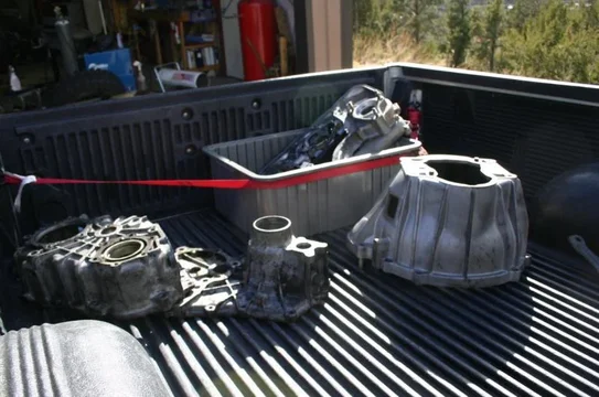

A bunch of parts are going to town to get cleaned. Since I'll be waiting on an oil cooler cover, we'd just as soon send these out to get seriously cleaned. It would take Dad or I about a week to get this stuff clean enough for our tastes.

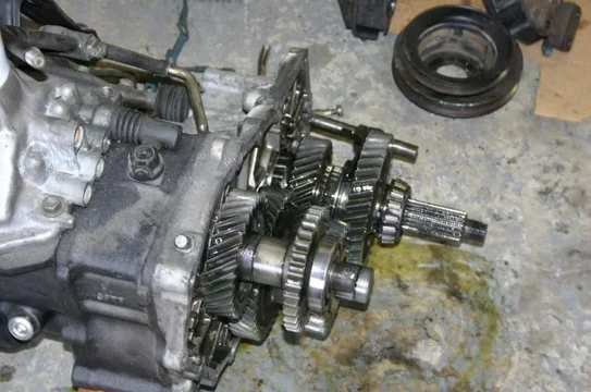

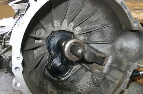

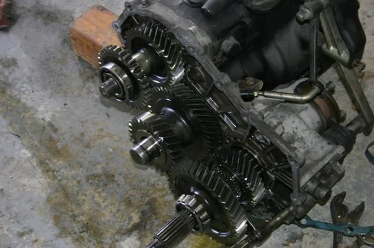

But pulling the T-case brings up a question.
In the 5th gear section it looks like there is one tooth missing. Is this normal? I don't see evidence of it having broken, but it's clearly missing.

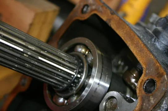

Also, the bearing back there has some rust on it. Obviously something was sitting for a while to do that. I'll replace that bearing either way, but if this one is rusty, should we assume the others are too? We weren't going to touch the transmission, as it looks to have been recently worked on by someone who took the care to repaint it, but the rust on the bearing has me a little worried that the input bearing might also have some rust/pitting and a consequent short life.
no tooth missing
good time to heat and bend that shifting fork for full engagement, this helps prevent the notorious 5th gear pop-out later in life.
looking good.
no tooth missing
looking good.
Good to know. It looked like it was supposed to be that way, but I figured I'd better ask anyhow....

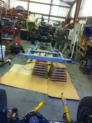

Just talked to Dad on the phone. He's off to town to drop off the bits for cleaning, pick up the rebuilt starter/alternator, the new lines for the turbo, and....

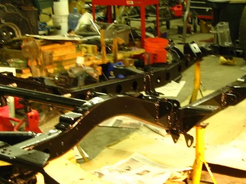

The now blasted frame.
Chances are, he'll have that frame painted in a couple days, and might even get the axles back under it before I get back to work on the truck.
EDIT--Mom just sent me some pictures...
Dan

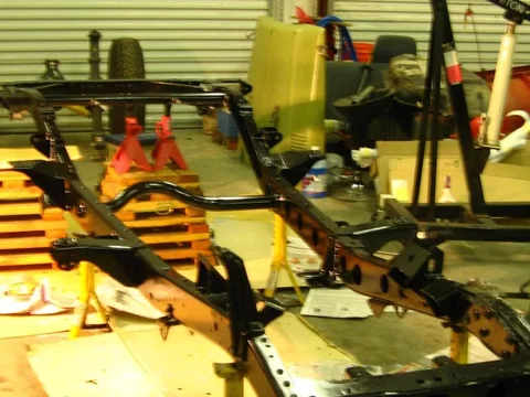

More photos from Dad...
Bam! The frame is in POR15. That's all the frame is getting. We've used plain POR15 on some other frames, and we're pretty happy with it as a final finish.
