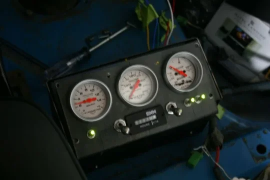

Then I cut the holes out for the gauges themselves...
And because the holes were there I was obviously obligated to put the gauges themselves into the panel...
I then started on the box that hold this fancy pants panel. Our of 16GA, I bent a 3 sided box (slightly angled from front to back). Added to this I bent some tabs and spot welded them onto the three sided box to act as the flange for the panel to mount. You'll notice that in this picture that the cuts are ugly, which isn't just because they'll be under a panel--I just eyeballed the first set of cuts...
Here it is sitting in the truck...
You'll notice that it's almost flat. It is real easy to see them from the driver's seat this way. The only downside I can think of is that they'll probably collect dirt at that angle. Meh.

i like your panel build, outside the box and looking good. i hope it clears the shifter when in reverse...
It looks a lot closer than it is. In reverse I can sloppily take my hand off the shifter and still not hit it. I'm guessing that moving the whole drivetrain forward that couple of inches is again looking to be a good idea I had. ;) Shoot, I was looking at it and actually thought about making some cupholders to mount on the front face of the gauge pod (underneath the shift lever) but then I thought: why? If I want cupholders I'll buy an 80 or something. Haven't missed having them on this truck in the past, so why start now?
Dan
cupholders are so "mall queen"
Funny, we were talking about it today, and Dad wants a cupholder. So, I guess I'll figure out how to fab up a single cupholder on the front side of the gauge pod. I can see his point, it would be nice to not have to worry about spilling your coffee (or hot chocolate) every time you go around a corner.

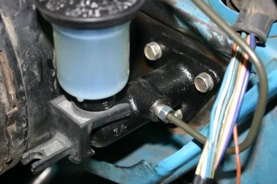

Well, got a lot more wiring done today. Mostly I tied the gauge pod into the truck's harness. That means that all I have to do is pop in some fuses, hook the truck's harness up to the battery and they should be working....
Also, a good bag of goodies arrived at American Toyota today.
A new brake master cylinder...
A new clutch master cylinder. Indeed it works beautifully. Took less than a minute to bleed and now we've got a working clutch!
We also installed the Marlin universal pinion flange on the front axle (and replaced the pinion seal with the HD Marlin unit). Of course, once that was done we realized that the Marlin universal pinion flange doesn't have the FJ-60 pattern on it. So I get to remove that (and probably better buy a new nut too, since we staked this one) and call Kurt tomorrow to get some Land Cruiser patterned flanges on the way. Either way, they look pretty spiffy...
