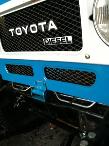

First things first: I had to put the sweet "Diesel" badge on it (you all know where it came from--go buy one or two already!). I just made a little 16GA backing plate, which I will weld to the grill mesh once I'm really happy with the placement. The left side of the diesel emblem on my '76 HJ-45 is aligned with the left side of the second T in Toyota. I don't know if it's different on the 79+ trucks with the square bezel.
Anyone got any clear pictures of the "correct" spot for it?

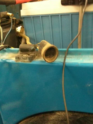

Yesterday I finished stripping the wiring harness down to the wires. Easy enough job. Of course when I pulled the 2F and Harness I labelled ALMOST all of the connections. There are a few that I left there because "there was only one way to hook them up" and I figured I'd post them up here before I went ahead and identified them through the FSM.

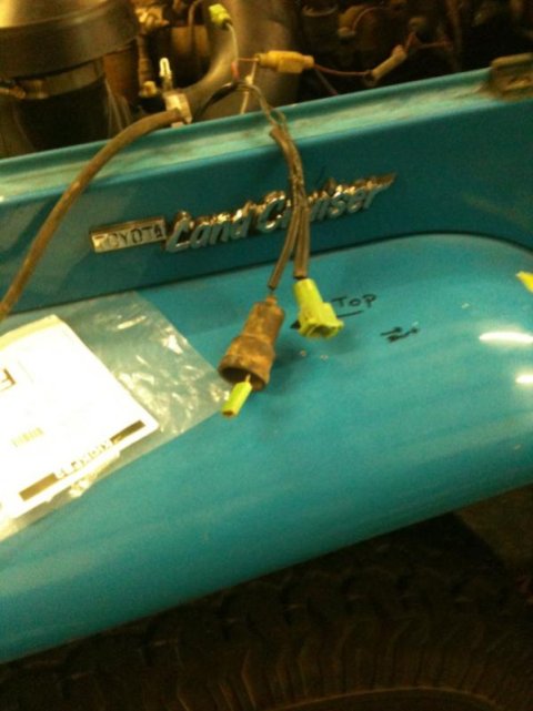

On the right fender:

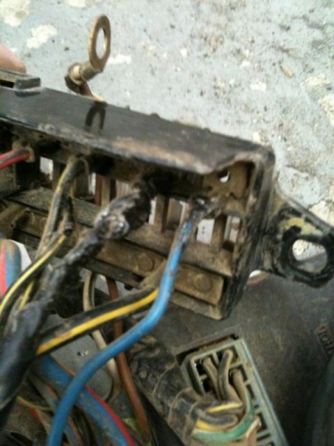

And on the right side, right by the heater:
I am 99% sure that these go to some sort of silly gas emissions stuff, so it will probably be removed, but before I go tracing the wires out and digging through the FSM I figured I'd see if anyone here recognized them.
Anyone?

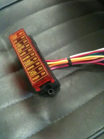

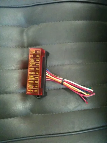

And here's the new fuse box that will replace the original under the dash (and an identical one is mounted to the right apron in the engine bay).
Pretty simple, it's got fairly heavy wires, and it's got two inputs. One of each will be always hot, and under the dash the other will be IGN switched, while the one in the engine bay will be the ACC switched bus.
I am thinking that I will try to use the labels that are printed on it now where I can, but where I can't I'll probably just scrape those off and use a marker or something. Either way: not a big deal. But I do like to make all of that stuff look as finished as possible.

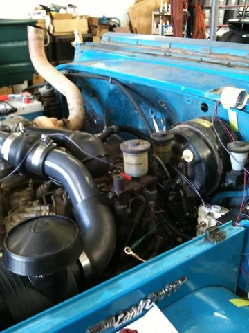

exhaust through the hood, originality at its best!!
:lol:
I'm not going to lie: I'm going to drive it like that for a while. :hillbilly:
Probably just around the neighborhood, but maybe even into town to get the exhaust made. I just got lucky that the exhaust used a flange to hold it into position, so I just rotated it up so that it wouldn't be exhausting into the engine bay.
I'm more and more happy with that Donaldson air filter in there, even if the fit is a bit tight. At least we won't have to worry about the engine getting clean air--ever really.

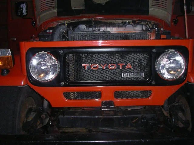

Diesel emblem placement
Not sure if anyone answered this yet. (Pic is old as the bezel is now white) Nice build!!
I'm still NA in my 3B. Turbo some day!
Thanks for that pic! I got the "correct" placement wrong then. I lined it up like it lines up on my '76 HJ-45 (which has the rounded bezel). I don't know if I'll leave it where it sits (too far to center, by about a third of the width of the "T"), or if I'll get motivated to change it...

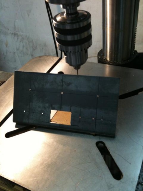

I decided to finally get off my lazy bum and get to fabricating that gauge pod in the center of the truck I've been talking about for 6 months now.
First step was to cut out a plate of 16GA steel, and then I drilled pilot holes for all the switches, the gauges, and I drilled four corner holes and cut out the center for the hour meter...

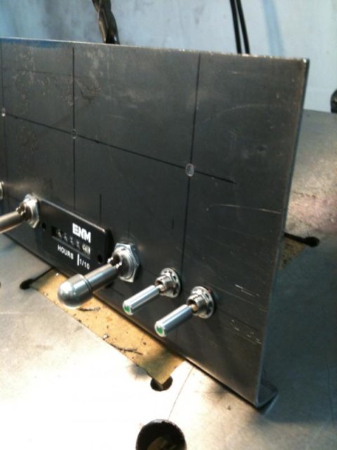

Then I decided to put the switches and the hour meter into the plate just to make sure I like how they fit. I do like it!
And a closer view of the switches. The big toggle switches are locking heavy duty switches (they lock in either position, you pull "up" on the toggle to move over the gate) which will control the air system (both power to the compressor and to the lockers), and the other will switch the fuel heater on and off (the Racor fuel heater has a built in thermostat, so it could safely just be wired to be on with the key, but I like having it switched myself...). Both of those switches are powered off of the ACC position with the key, so they will be powered any time the truck is running, and they can also be activated without turning the key all the way to ON. It's just the easiest way for me to wire the truck...
The smaller toggle switches are just simple SPST toggle switches for the lockers, and for auxiliary lights. But they are special--they are metal, and they have an LED inside the toggle to indicate when the switch is on. It's easy to find toggles with LEDs in the switch, but the only all metal switches like that I found were from McMaster-Carr.
