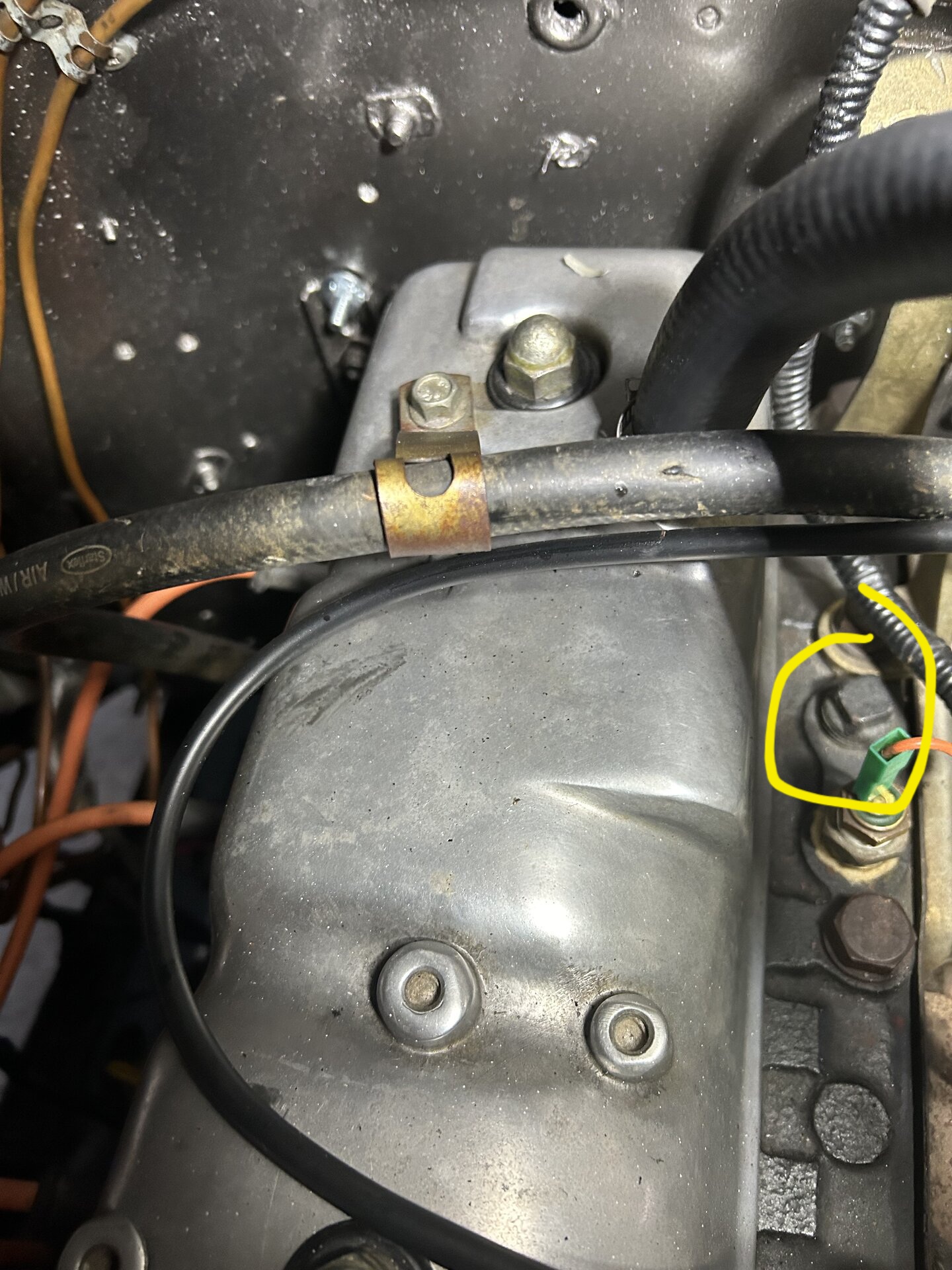

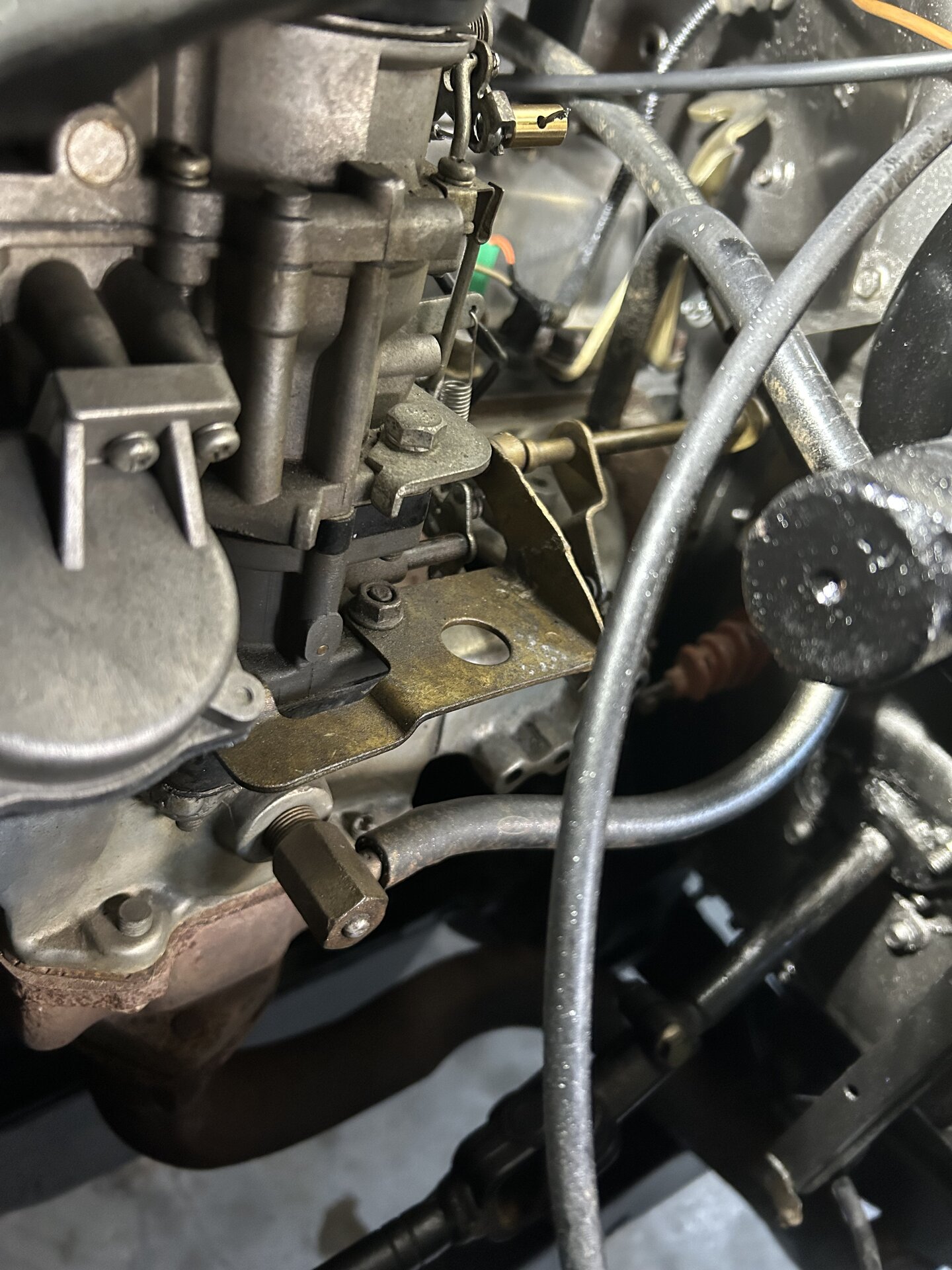

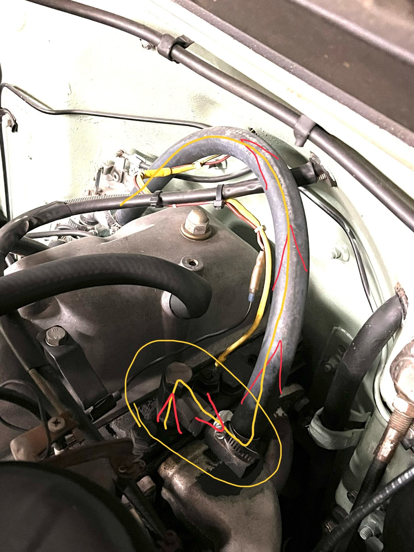

Thank you for the quick reply! In the image below, would that be the one in the red? If so, it currently routes under the carb, so if I reroute that to the heater, do I need to figure out some kind of “T” connection to keep it feeding under the carb?
Apologies if I’m way off with this- this is my first job with coolant system outside of a flush, so my questions may be super dumb!
Neither one of those.
There should be another port near that temperature sensor closer to the valve cover.

But yes, the head should have a heater plug/port by the coolant temp sender.
You still need recirculation line off the lower rad hose as well.

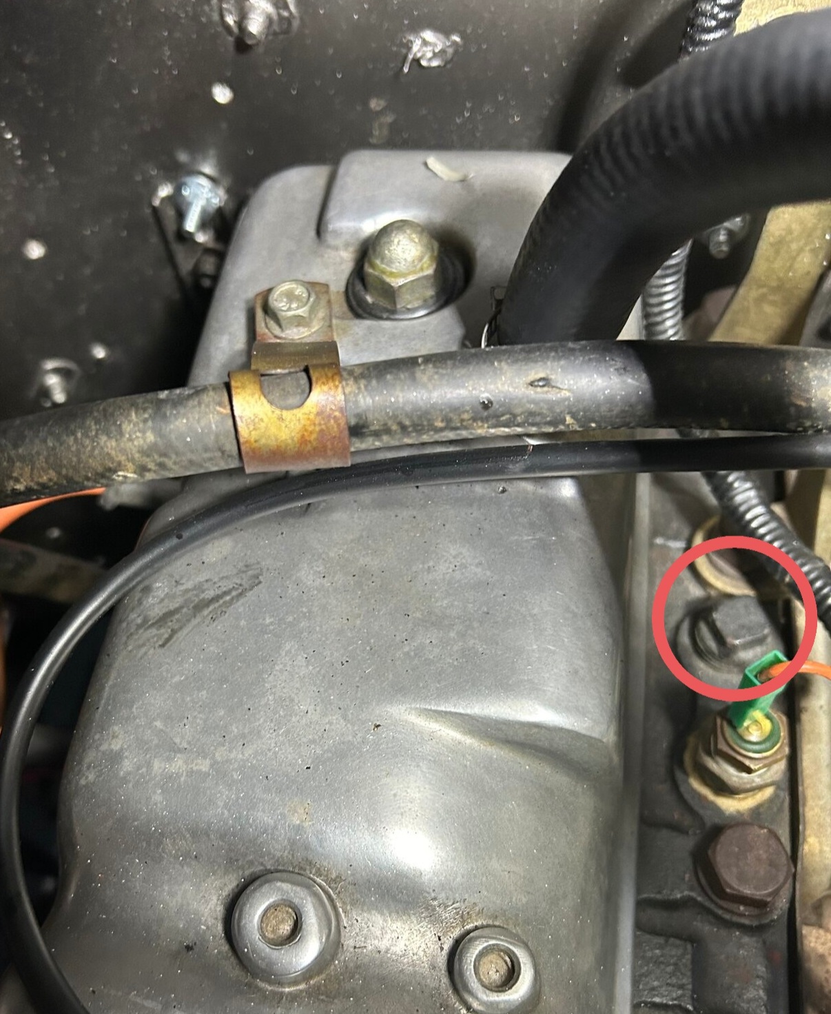

Ok- thank you for that, now I don’t feel as dumb! So: I think the one you’re talking about is currently plugged, but circled in red, right? It’s the next port closer to the firewall from the (temp?) sensor. I have also shaded a yellow (port?) closer to the front of the car, but I’m guessing that’s not it.
If it’s the red one: I guess my next step is to order the port itself to connect it to my heater hose.

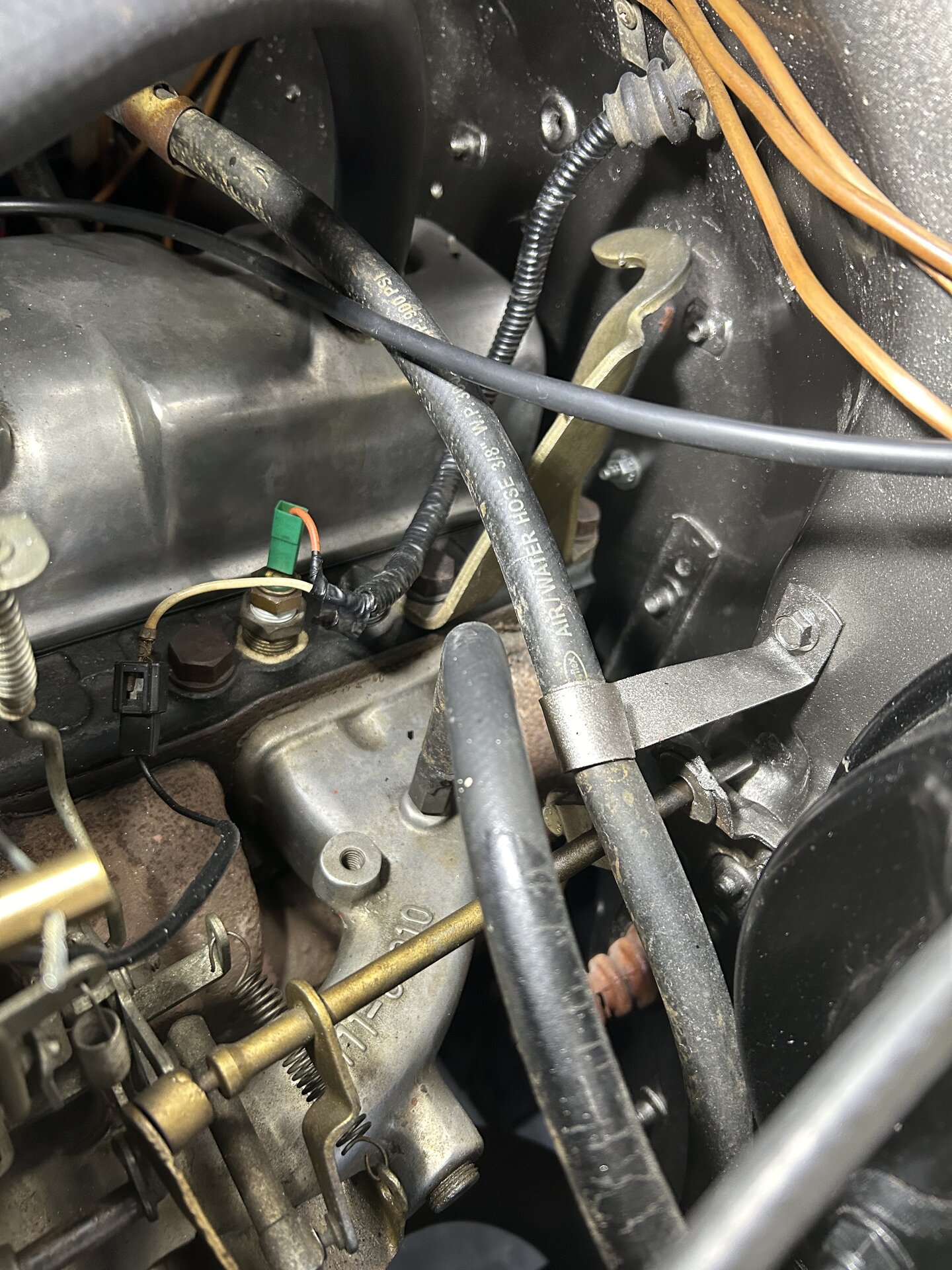

Ok- then I’m stumped again! I have taken 3 pictures of every angle of that section of the engine compartment- can someone please identify which port im looking for?
Or: can someone snap a picture of their heater port and share back?

Yellow circled port
Temperature sender is what is next to it.

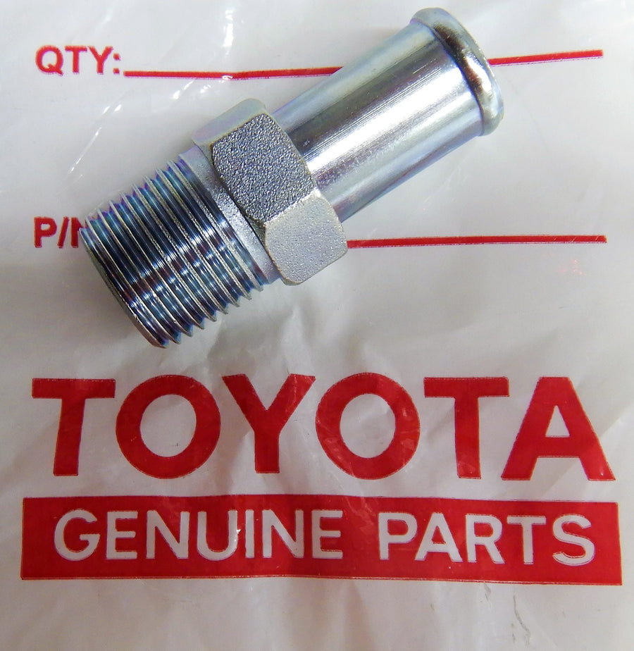

I circled the plug in red. There are fittings that will screw into the head to connect your heater hose to.
Post up more pics of your engine bay (and whole 40) and we can point out other things to fix.
I noticed your ported vacuum on the carb isn't connected or plugged. If it's a vacuum advance distributor, you should hook that up.

I’d recommend getting an original brass pipe for the coolant line that runs along the bottom of the side-cover. You’ll also need the valve that mounts inside the firewall and plumbing & grommet to go through the firewall.

Awesome- thank you!!!! As soon as I get the heater taken care of I’ll take you up on that! quick follow up: do you happen to have a part number for what you pictured? Or can I just go to my Toyota dealer and ask for it?
My vintage air system has a heater control valve integrated(that looks like it shuts off flow when I don’t need it) so I’m not looking for the old school one manual solution, just the port exactly as you have pictured!!

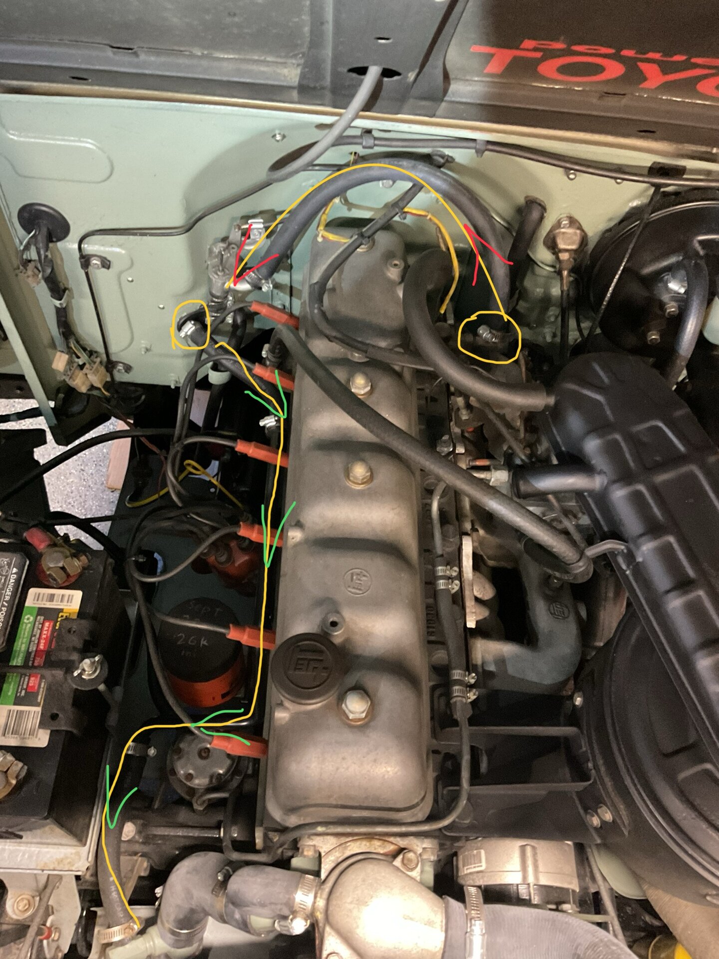

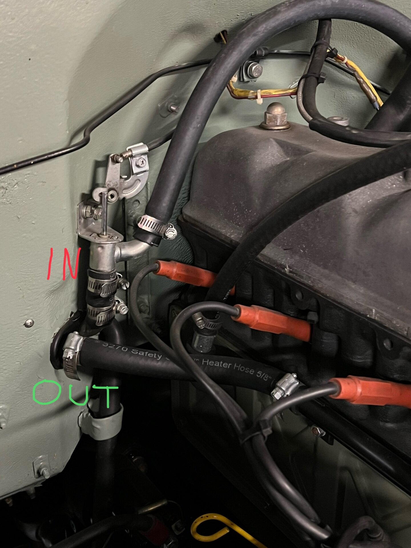

The hoses you are illustrating in your post are not coolant hoses, though they are marked as such. It appears those are being used for engine manifold vacuum and crankcase vapor.

$19.88 list at the dealer.
Now might also be a good time to familiarize yourself with the pipe threads commonly found on Toyota vehicles. They are not interchangeable with the pipe threads found on many parts at your local hardware store or even auto parts store. Toyota uses BSPT (British Standard Pipe Thread). This is important to know because some of the threads are close to matching NPT (National Pipe Thread) but are just enough off so that if you were to incorrectly use the wrong fitting you may get cross threaded and ruin your threads. ;)

Not to split hairs but I think these arrows are backward. I’m pretty sure the flow from radiator comes into the engine/water pump from the lower hose and returns through thermostat housing. In that case, the heater hose on the bottom radiator hose is the feed for heater core and the shutoff valve with hose to head is the return. Shutting the valve still stops flow in either case and as far as hose hookup, still the same so doesn’t really matter.
