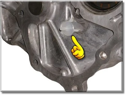

You guys probably already have this, but just in case, some notes from Cool Cruisers:
H55F - 5 Speed Transmission - Toyota
Also a pic of the oil doohickey.
Knowing nothing about this, I see that in the link that Dan provided, Cool Cruisers notes a tap and plug for transmission fluid flow. Does this affect your install with the toybox? If it does, it seems like this could also be related to your fluid being pumped everywhere.
Nice to hear from you Dan but using the toy box makes that useless. I might try to glue it on just for fun thought
D'oh!
Now I see where the doohickey is supposed to go on the front side of the TCase.

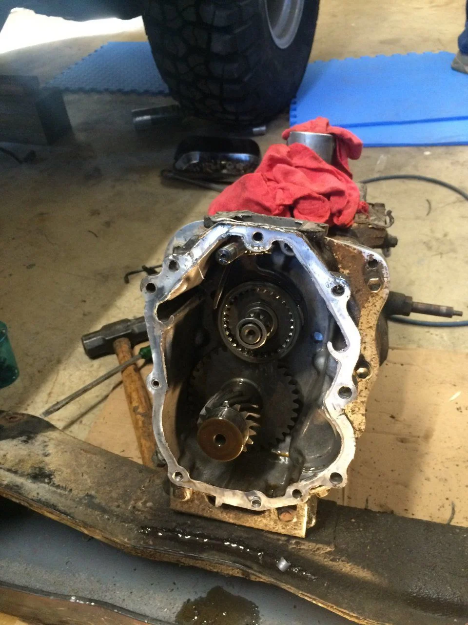

Everyone involved check your phones or cameras and see if you have a pick of the adapter plates taken apart.

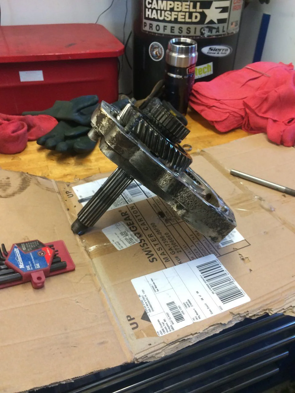

Thes are all I got of the toybox.

nobody panic but i found the numbers on the trans side adapter and......................i have the right one:bang: This is good news, the bad news is i still have to figure out why 5th gear is screaming at me. Back to the collar , spacer thing not being tight and maybe moved on us. Funny Cam can almost fix it from Cali and i dont even know what parts i have
What do you guys know about this shim kit ? Is it for the output shaft of the trans , for the split case , or one for each ? I don't have one of these yet but pretty sure I could get one if needed
I think it may be the 5th gear shift fork rubbing on the lock collar because I don't think we put the spacer on between the fifth gear and the lock collar.
Hey Stump, i think there is a better chance that we put it in the right place but it has moved. it did not have an issue for the first three hundred miles. If it was not installed correctly it would have been an issue from the beginning. I just hope once we get it out of there we can tell what is wrong and that nothing is damaged beyond repair
