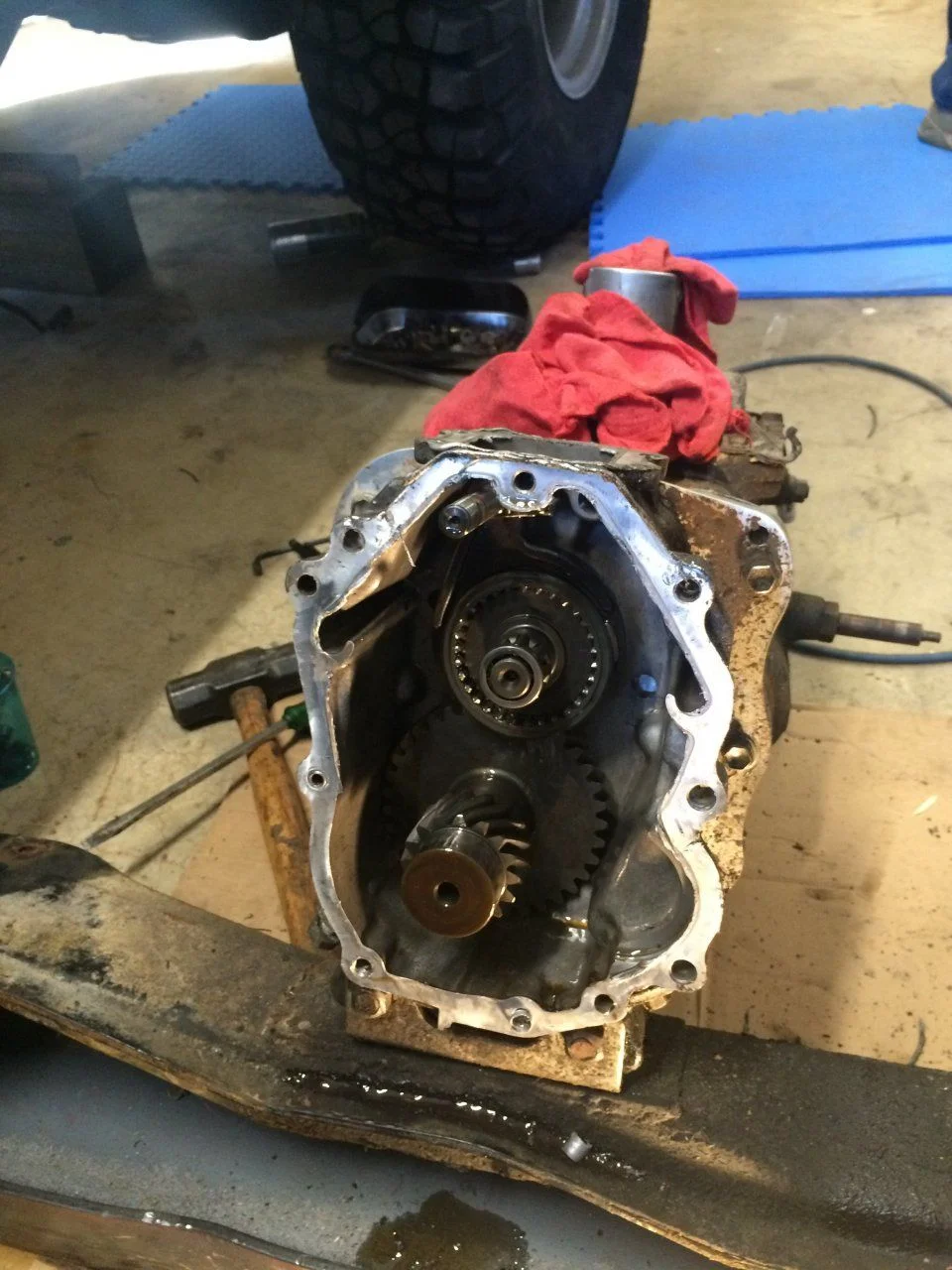

Installing a H55 in a FJ62 with @Stumpalama, @TRFCSUX,@Tikicruiser , and @Jakes40
Steve cried a little when we cut his Shaft!!
We had a good team. everyone took a job and worked well together. I think it only took about 10 minutes to get the assembly back in the truck. Steve's nephew is a good wrench.
