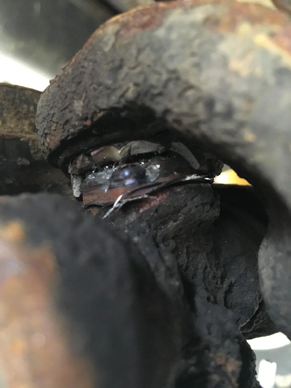

Here is the pic.
That will do it!!
We should have checked them. But was in a hurry to get it buttoned up.
Those are probably the original u-joints. ProTip: Pull the caps on your new replacements and grease up the needle bearings real good so they stay in place while the caps are off. Don't rely on the miniscule amount of crap grease that ships with them to hold those needle bearings in place. It's really no fun when one falls out of place, and you break it installing the new cap.
