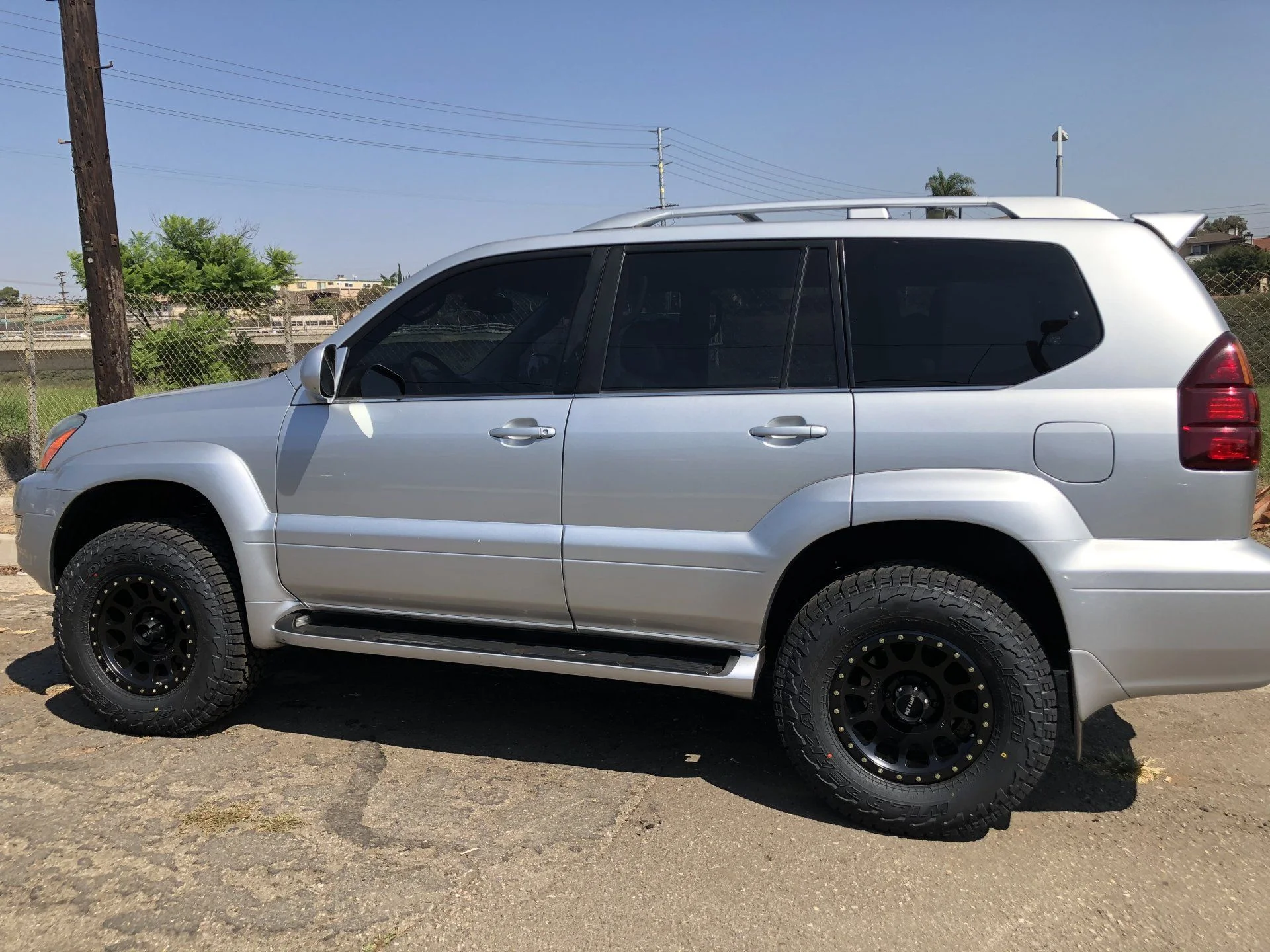

That looks great.
Did you change the rear shocks when you replaced the fronts with Dobinsons? I'm looking to do the same with tricking the bags to start. Wasn't sure if the stock shocks and the new shocks would match on their compression and rebound rate.
I didn’t change the rears at all besides tricking the airbags. The ride is much better than it was with the stock fronts. I’ll be converting the rears to springs soon; have variable rate Dobinsons (c59-675v) sitting in the garage
I plan to do the exact same, but probably going with OME. Thanks for the feedback.

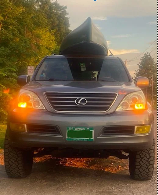

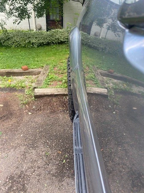

Do you have a pic from the front showing how much these stick out from the fenders? Looking at getting the same tires and just curious I cant find a pic anywhere
The tires are essentially the same width as stock so the poke is from the wheel offset

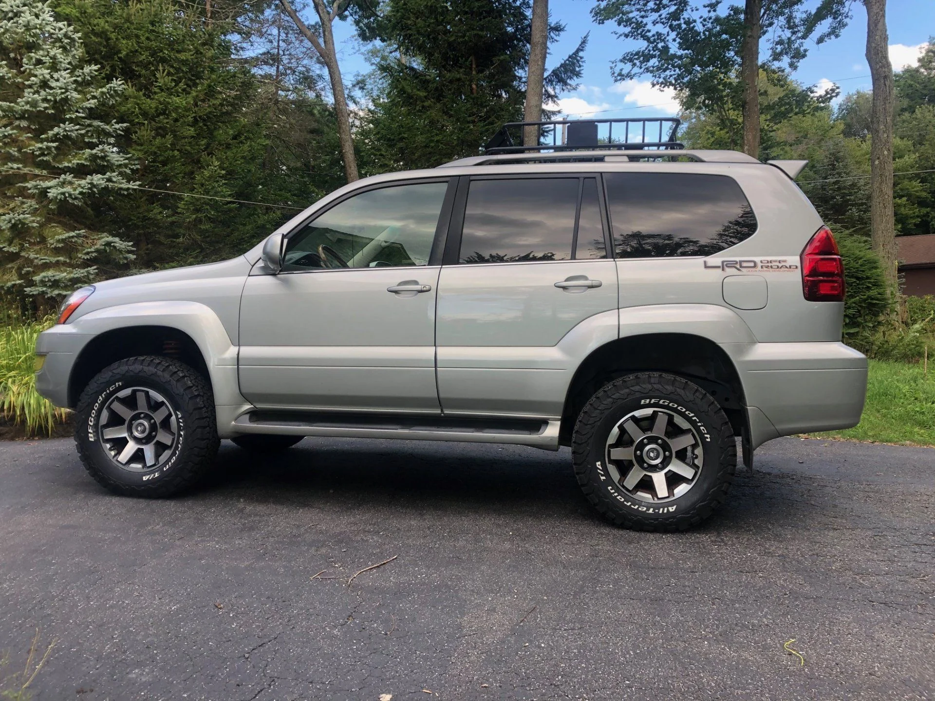

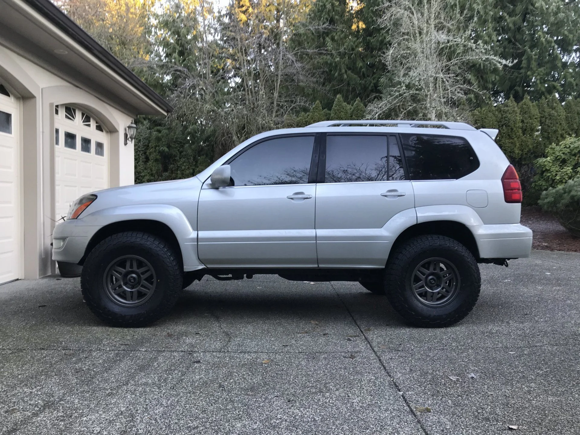

Wheels: OEM Toyota 4Runner Trail 17's
Tires: BFG KO2 LT265/70/17 (31's)
Spacers: Not on truck but I have 1.25" spacers I may add.
Lift: Ironman4x4 America Full Suspension 2" lift
Mods: Cosmetic and Utility Mods Only. i.e. Roof Attic, Rooftop Basket, Depo Sport Headlights and upgraded bulbs.

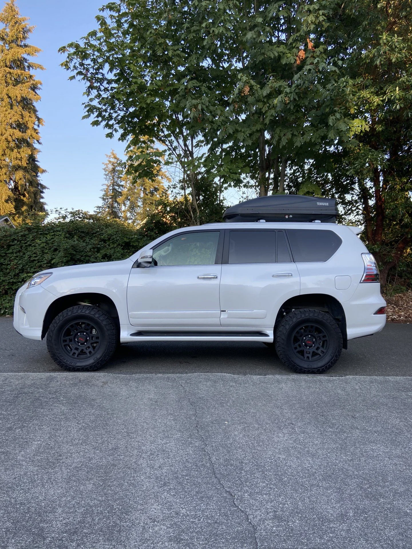

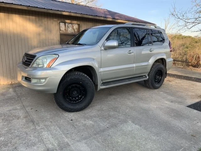

Wheels: OEM TRD Pro wheels
Tires: 275/70r17 General Grabber ATX (32.2”)
Lift: Ironman stage 2 kit
I had to trim the front inner fender due to rubbing at full lock when backing up. I’m thinking about running 255/80 or 285/70 for my next set but don’t know if I want to do the body chop.
On the OEM TRD pro wheels? Is there a certain offset or size we are looking for? Going to call the dealership but not sure what size to tell them
The wheels to my knowledge only come in one size and offset off the trd pro 4runner. 17x7
Yep, only one size. 17"x7" +4mm offset. Don't be fooled by Chinese knockoffs on Ebay.

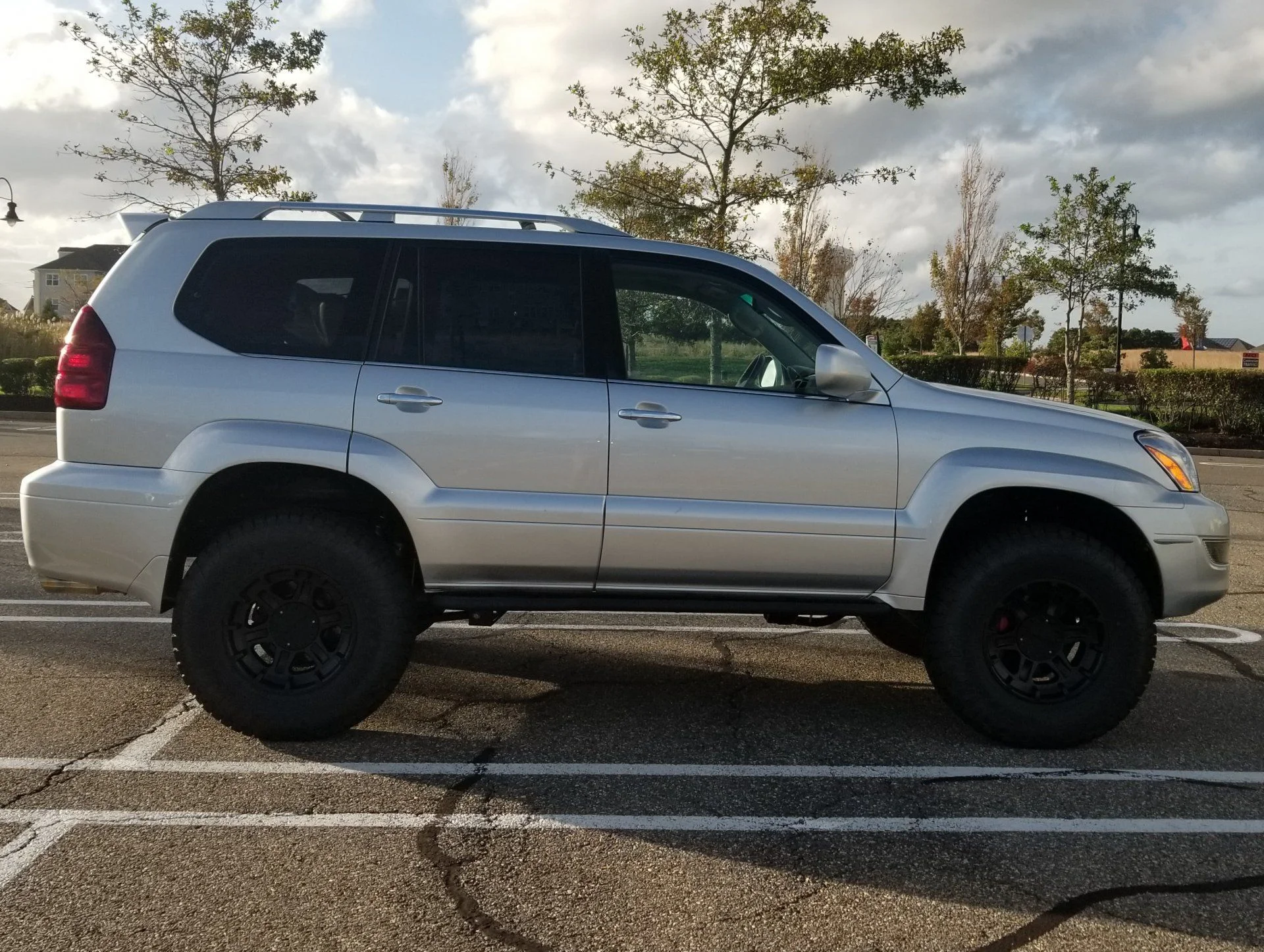

Milestar Patagonia 285/70/17
Dobinsons 2.5 Lift/shocks
Freedom Offroad UCAs
1.25" hubcentric spacers
SSO coil conversion
View attachment 2071473View attachment 2071474
SSO coil conversion
nice setup there Kvman. I'm looking to do the similar as yours and I see your in southern orange county, did you do this yourself or used a shop? If you used a shop, do you mind sharing that info? thanks Kvman.

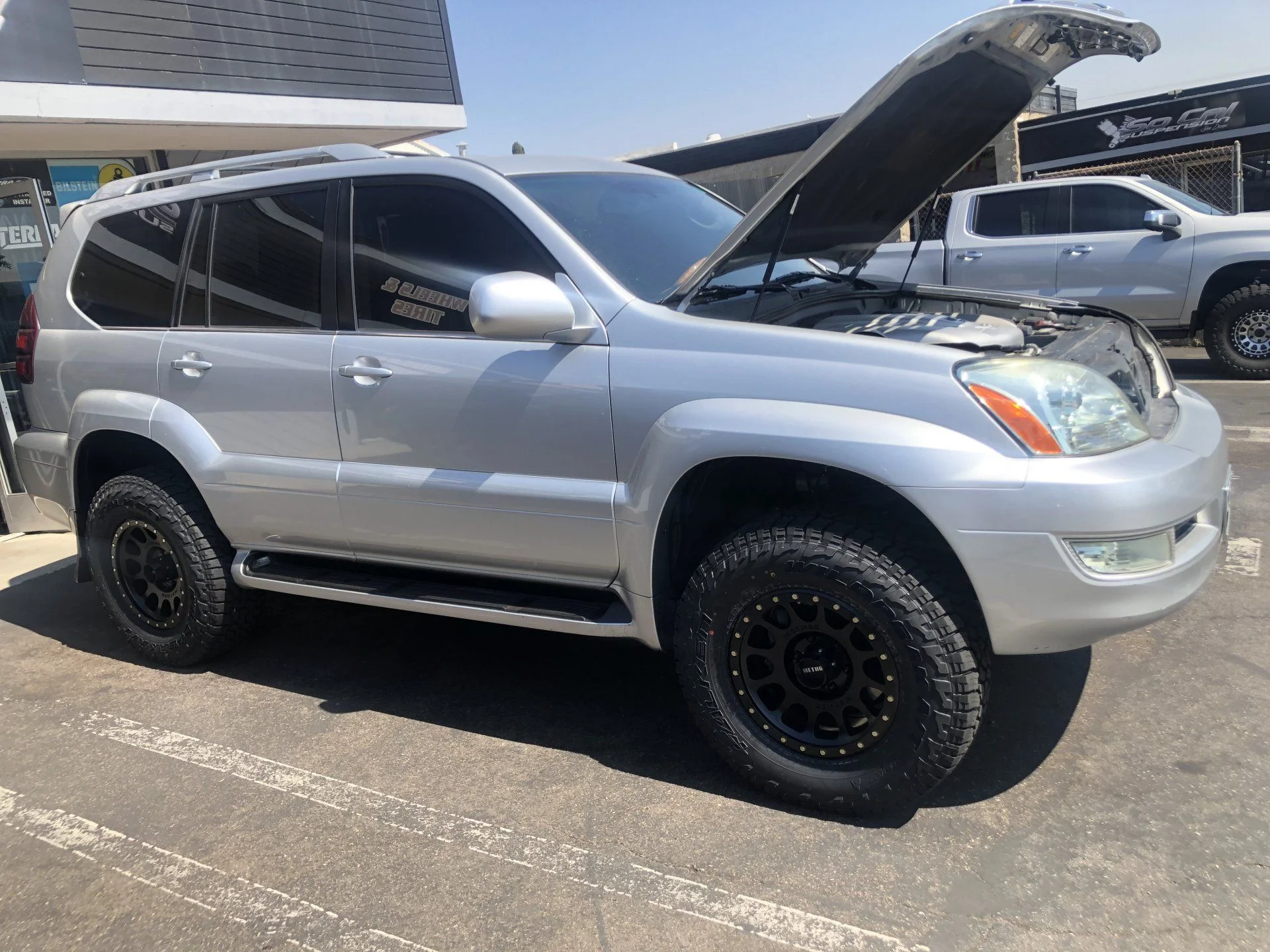

Wheels: Black Rhino Arsenal
Tires: Falken Wildpeak at3 285/70/1
Lift: Toytec 3
Trimmed front fenders
Still have things to add on!!
Looking to get a set of Rhino Arsenal's on mine!! According to their fitment guide for the Lexus GX470 you need the 17x9.5 with +12 offset. But the only other Lexus GX470 I've found with these Rhino Wheels on them were the -18 offset version of the same wheel! ( 2008 Lexus GX470 Black Rhino Arsenal Toytec Lifts Suspension Lift 3" | Custom Offsets )
I don't want to start a thread unnecessarily but don't want to drop $1000+ on wheels I can't return until I'm sure. Can anyone provide any insight please! Thanks!
