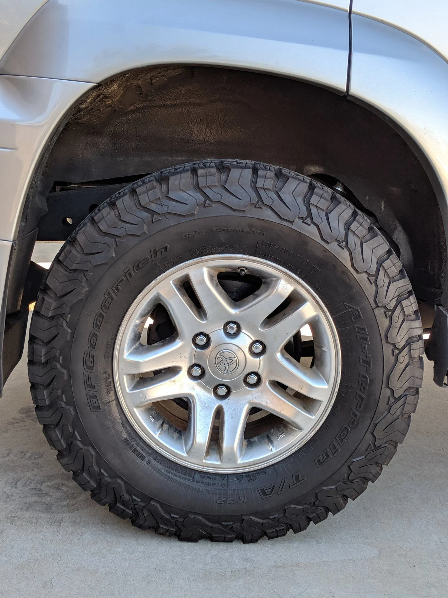

Those that are partially deflating their oversized spare to fit factory location.
How are you keeping the tpms from activating a warning light?

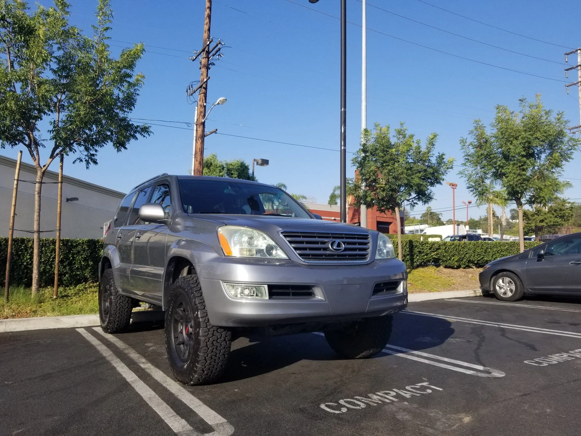

only deflated enough to fit it, mine didn't need to go so low to set the light off. I fit a 255/80 under a non-KDSS none tow package truck.

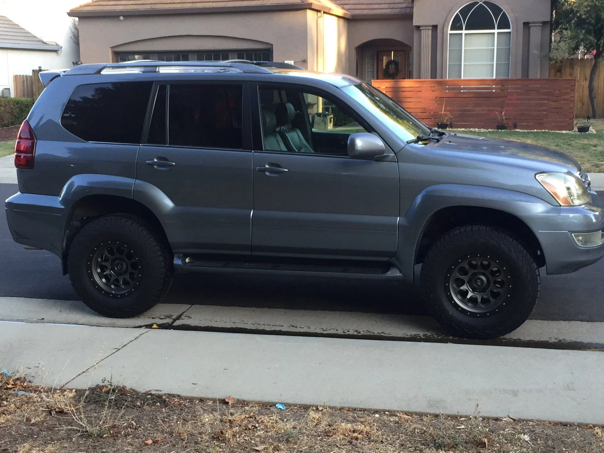

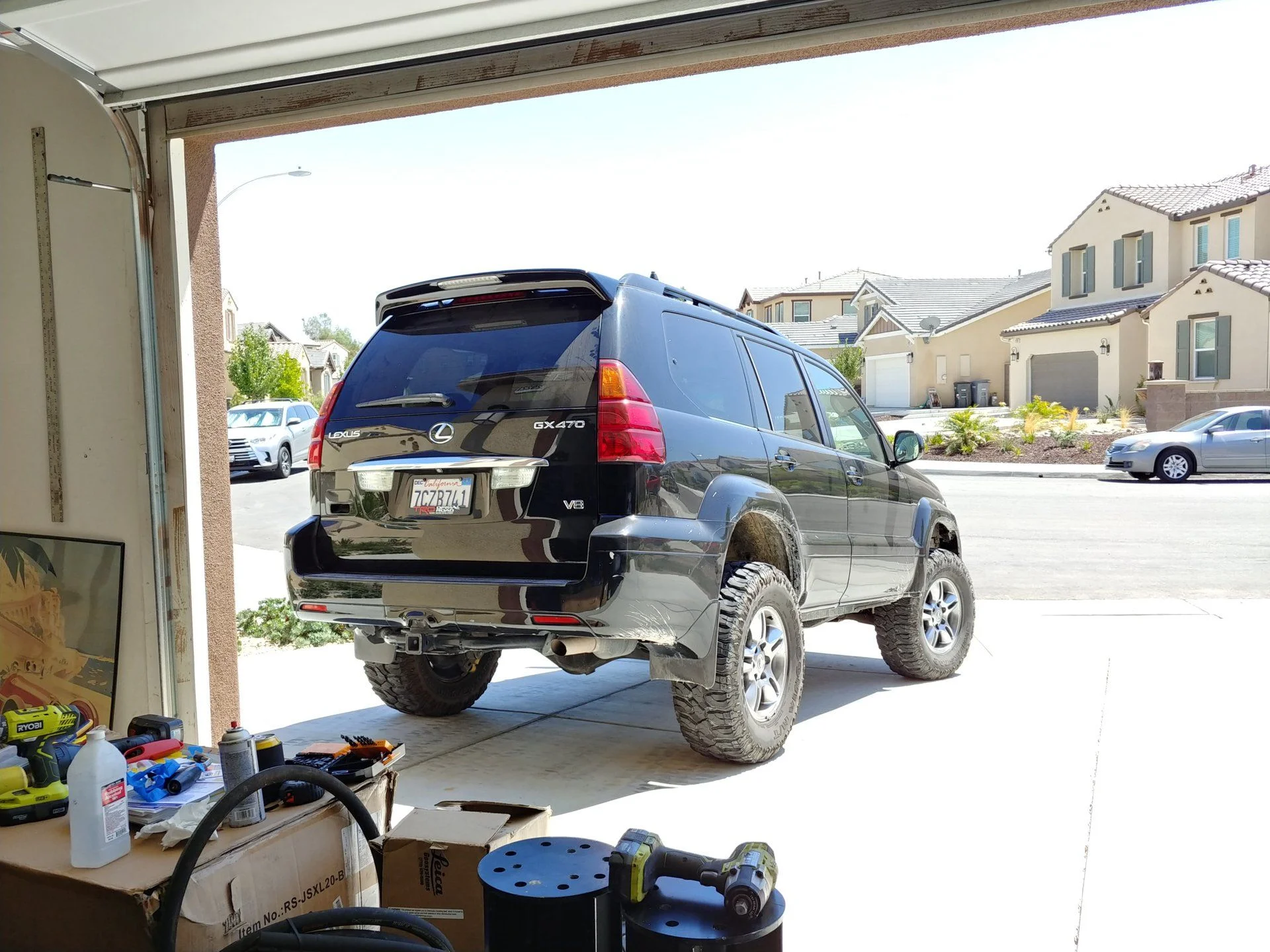

I run 255/80R17, 0 offset wheel with 2" lift. I only have 10-15 mm clearance to the pinch weld when turning. This tire are 22 mm larger scrub radius. So need to cut pinch weld and BMC for sure.

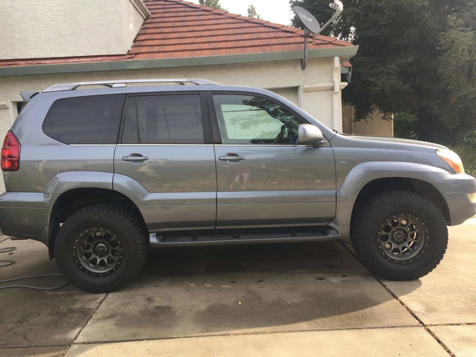

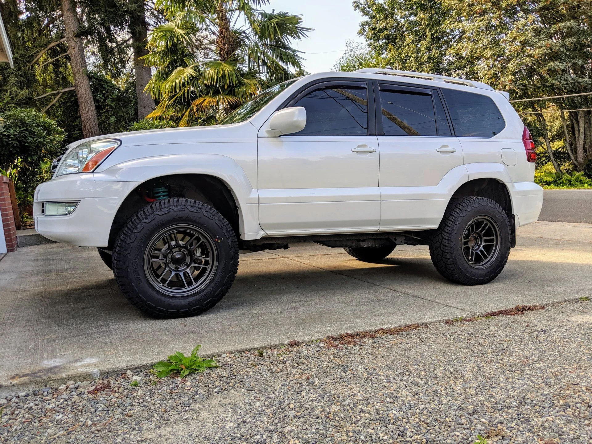

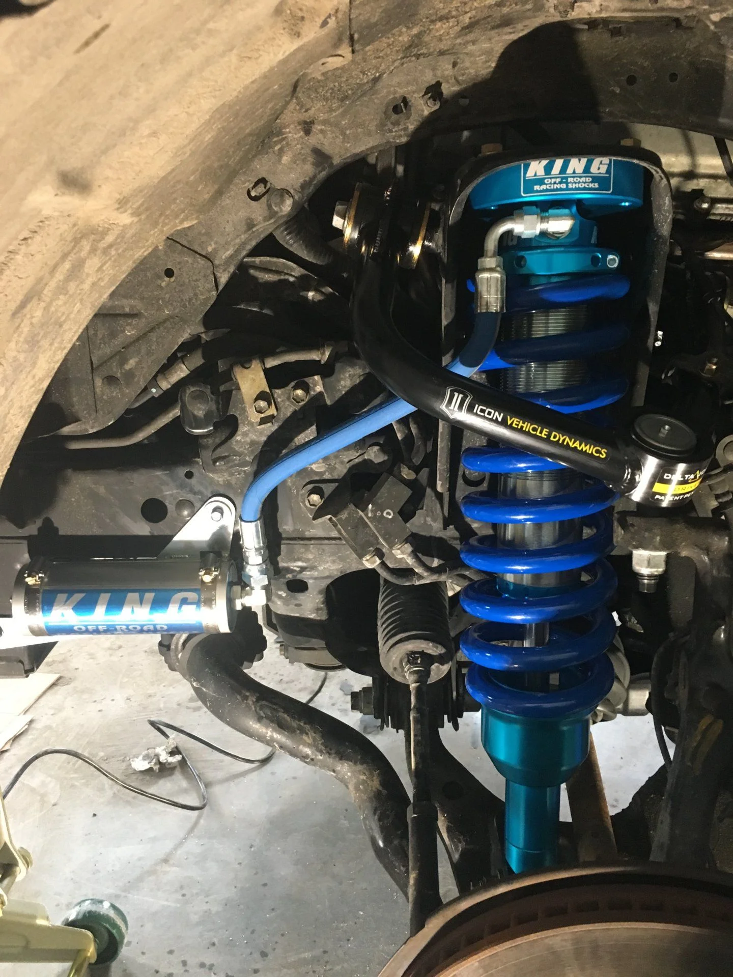

Suspension

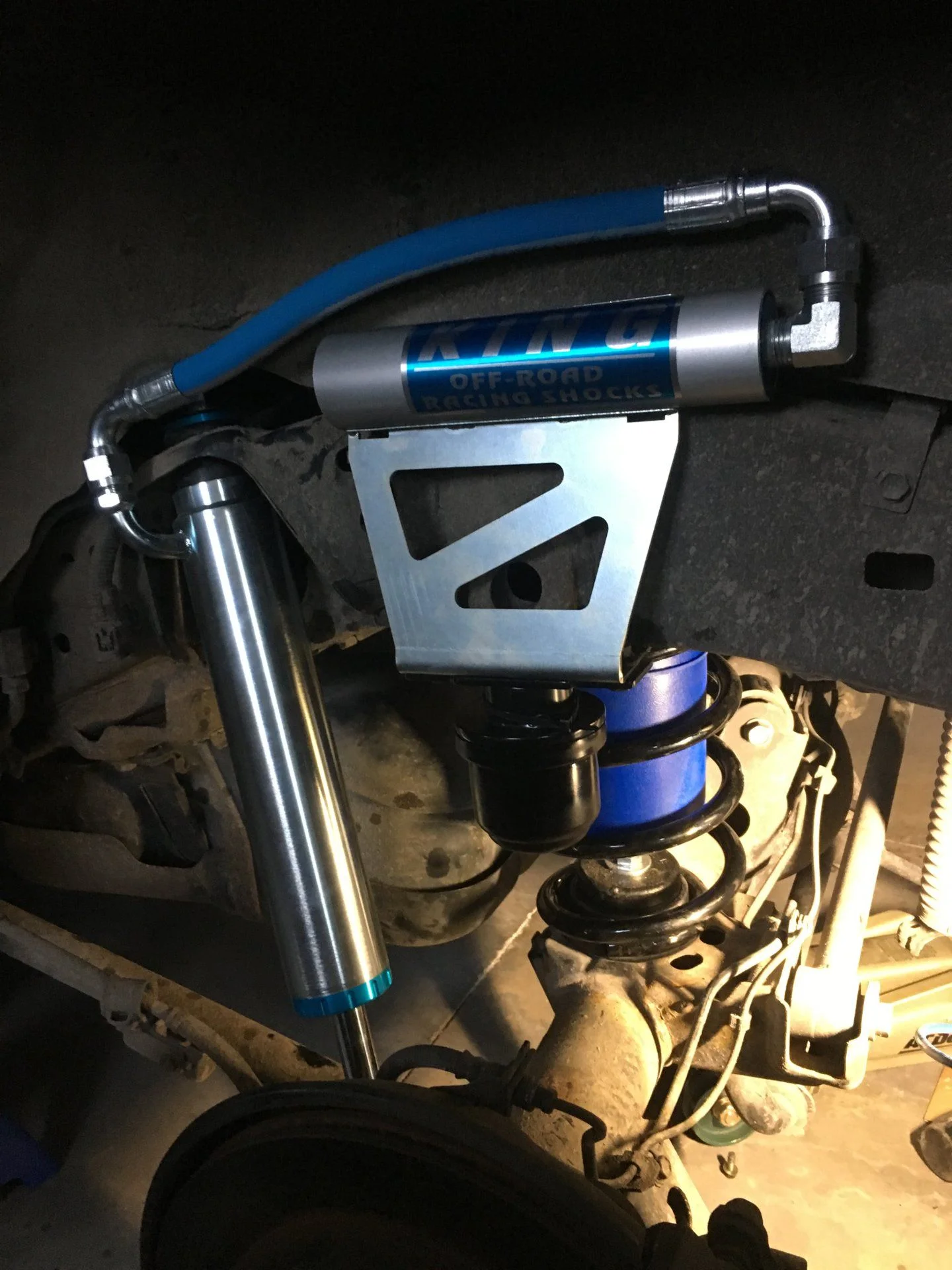

King Ext. travel front coilovers 700lbs springs
King 2.5” rear shocks
Icon Delta joint UCA's
Icon 2” Rear coils
Metal Tech rear coil conversion kit
Firestone airbags
Wheelers superbump bumpstops
Wheels
Method MR701 17x8.5 0 offset
Tires
Cooper AT3 XLT 285/75r17

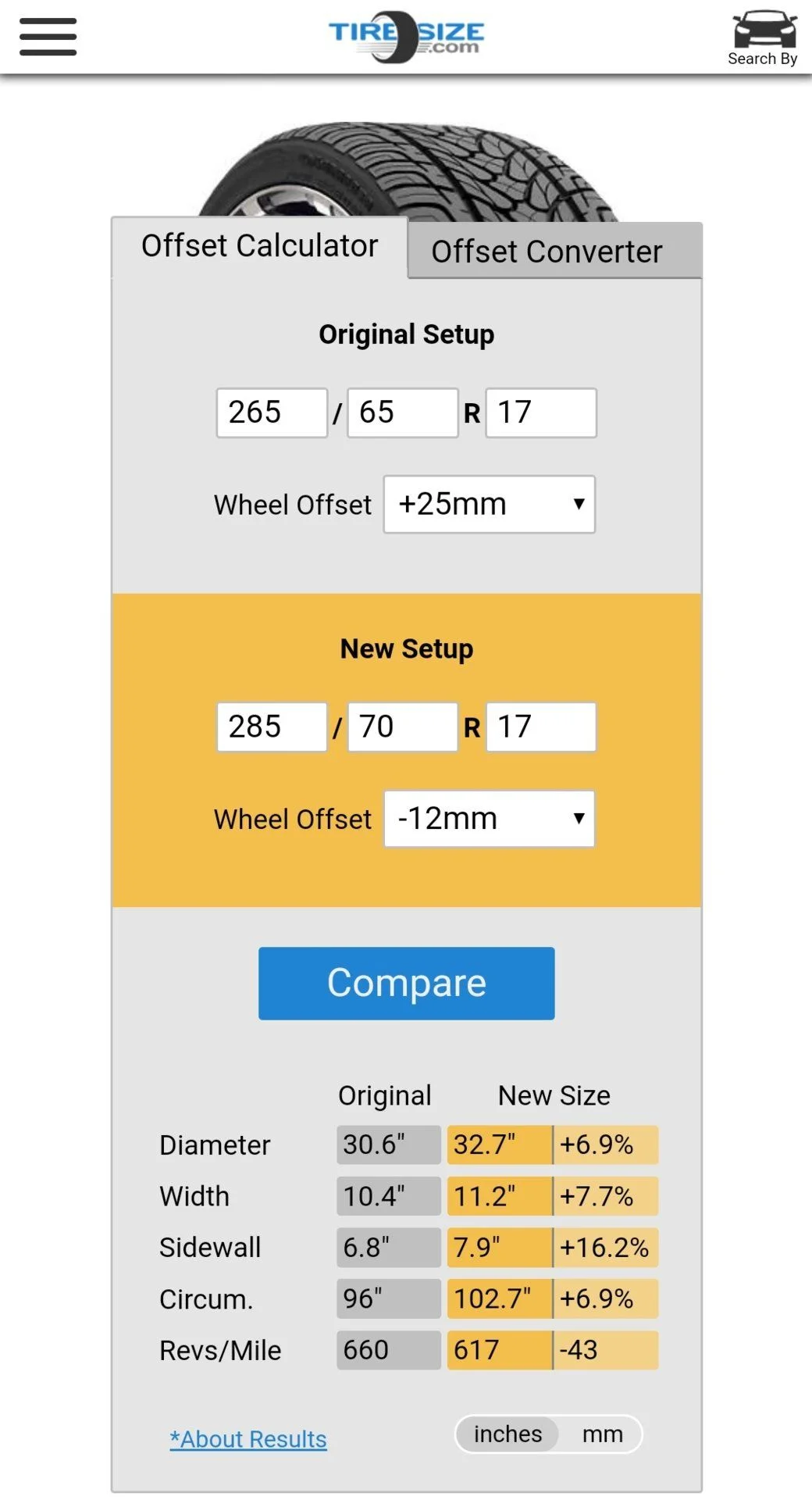

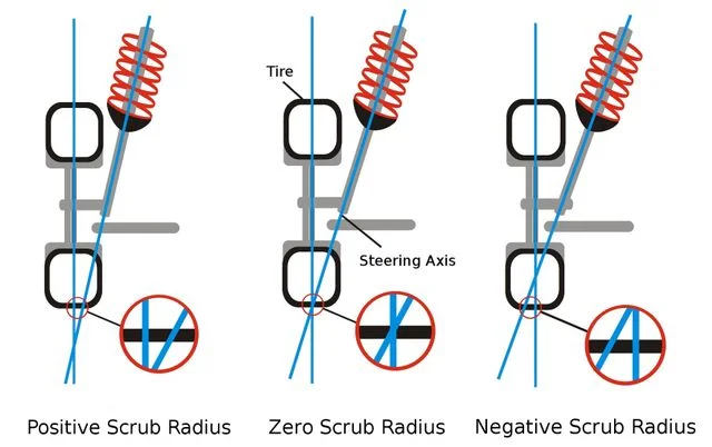

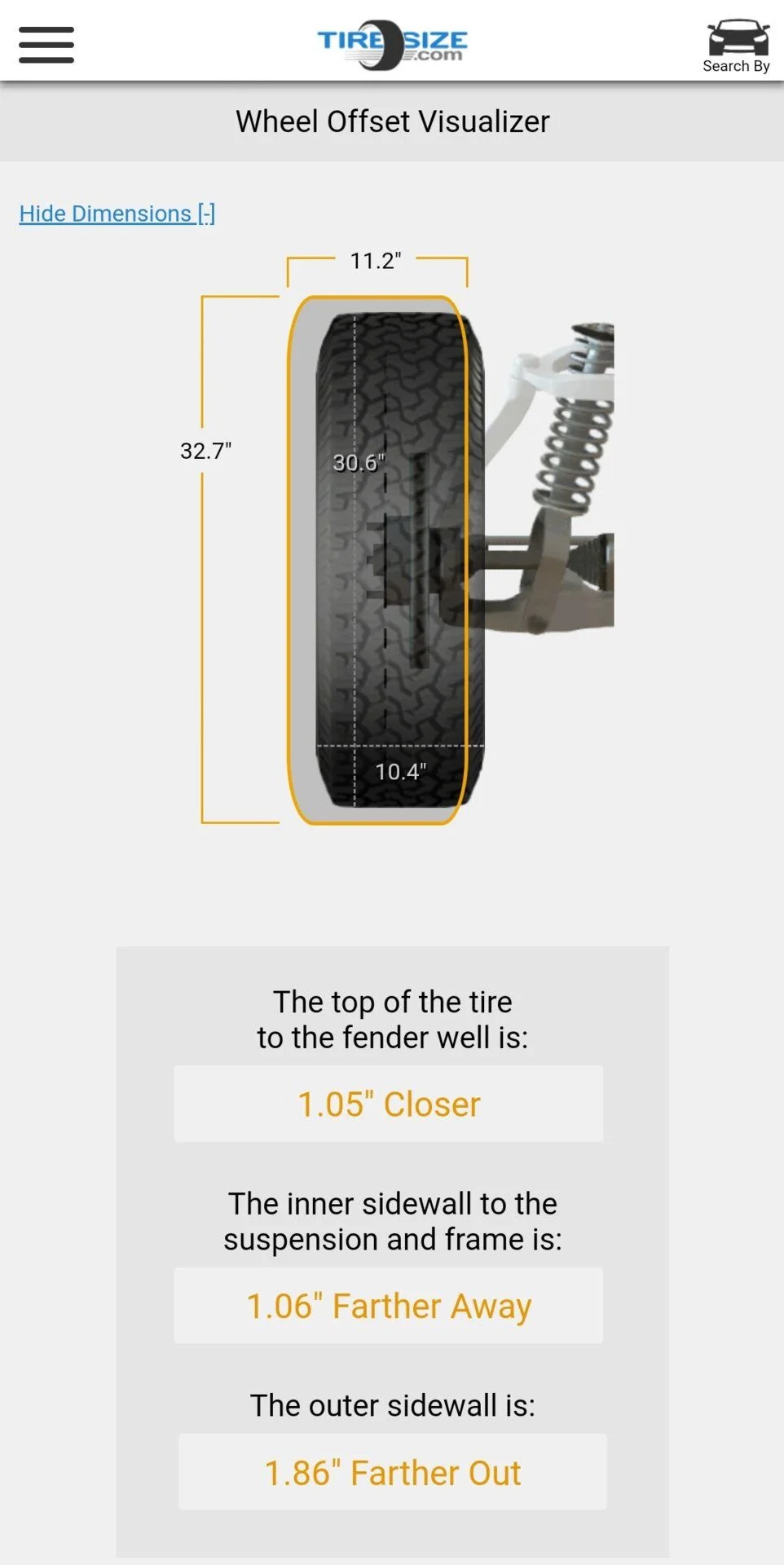

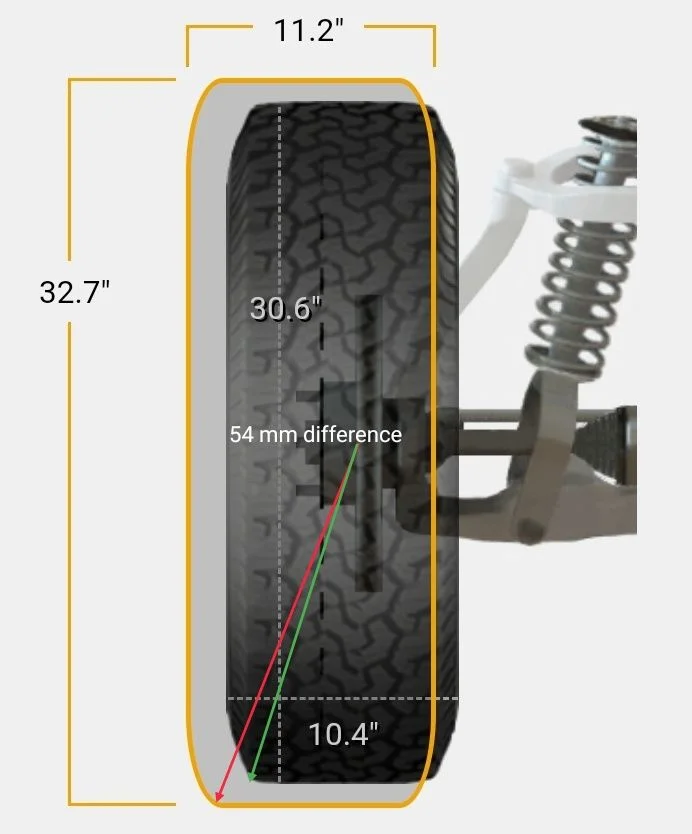

Do you mind educating me on scrub radius?
The scrub radius is the distance in front view between the king pin axis and the center of the contact patch of the wheel, where both would theoretically touch the road. The kingpin axis is the line between the upper and lower ball joints of the hub.
Without getting too technical the biggest difference for 4X4 vehicle is how bigger tire and wheel offset impact vehicle fitment.
For example comparing stock tire to popular 285/70R17 with popular - 12mm offset result it 54 mm more scrub radius compared to stock.
Awesome man, thank you, and what a great calculator at tiresize.com, I'll be sure to use it

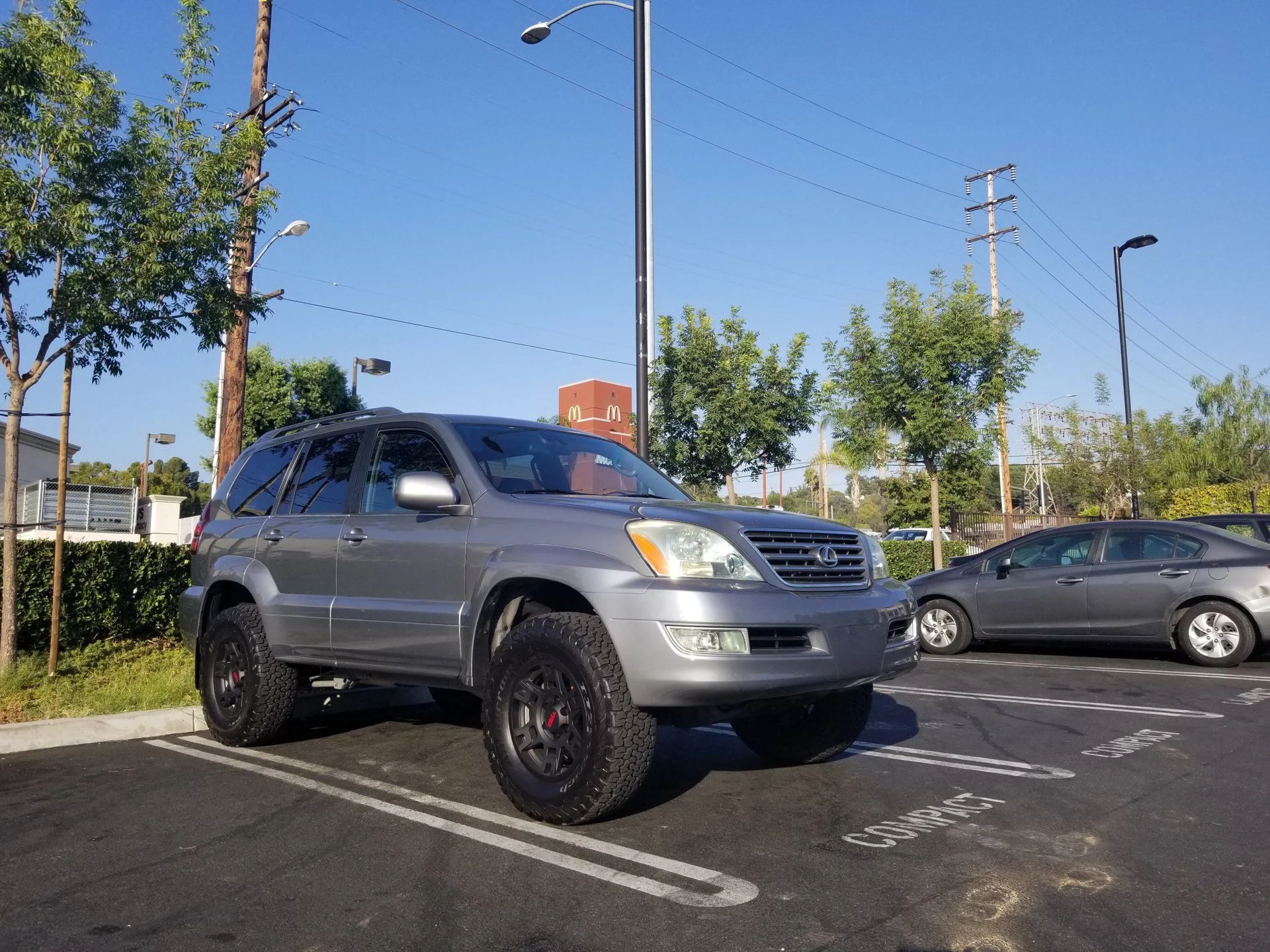

Rather than create a new thread, figured I’d post here for some help.
I found a used set of Method wheels and not sure if they’ll fit. The seller had them on a Silverado but they look like GX470 specs:
  • Wheel Size: 17x8.5
  • Bolt Pattern: 6 on 5.5
  • Offset: 0
  • Backspace: 4.75
I’m planning on running them with 265/70/17 AT tires on stock suspension.
Will I have any issues? Thanks in advance.
  • Offset: 0
  • Backspace: 4.75

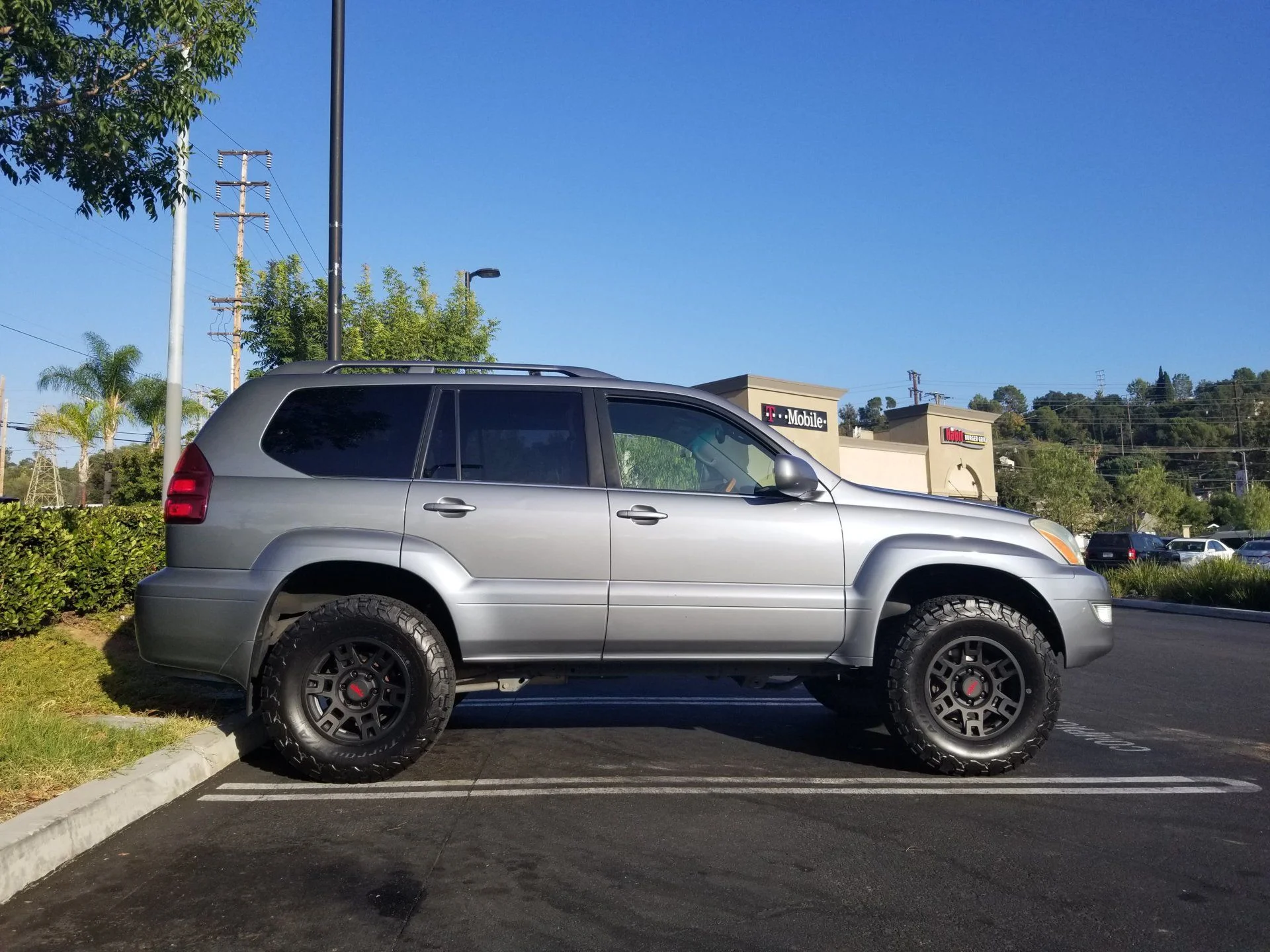

Didn’t know silverados had the same lug pattern as the GX. They are the same as my method wheels with 285/75r17 tires.

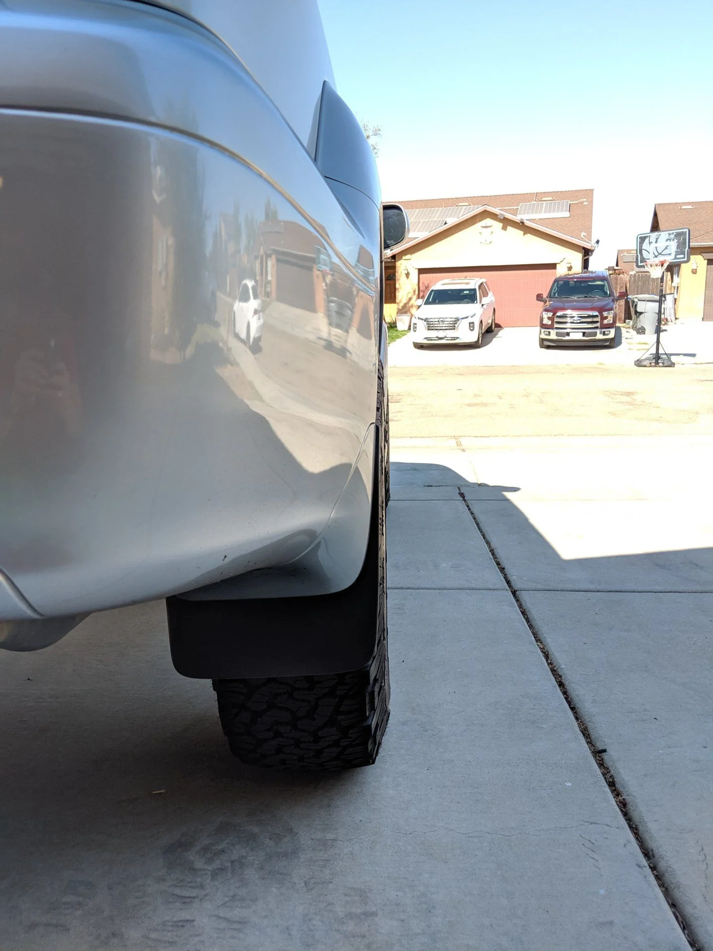

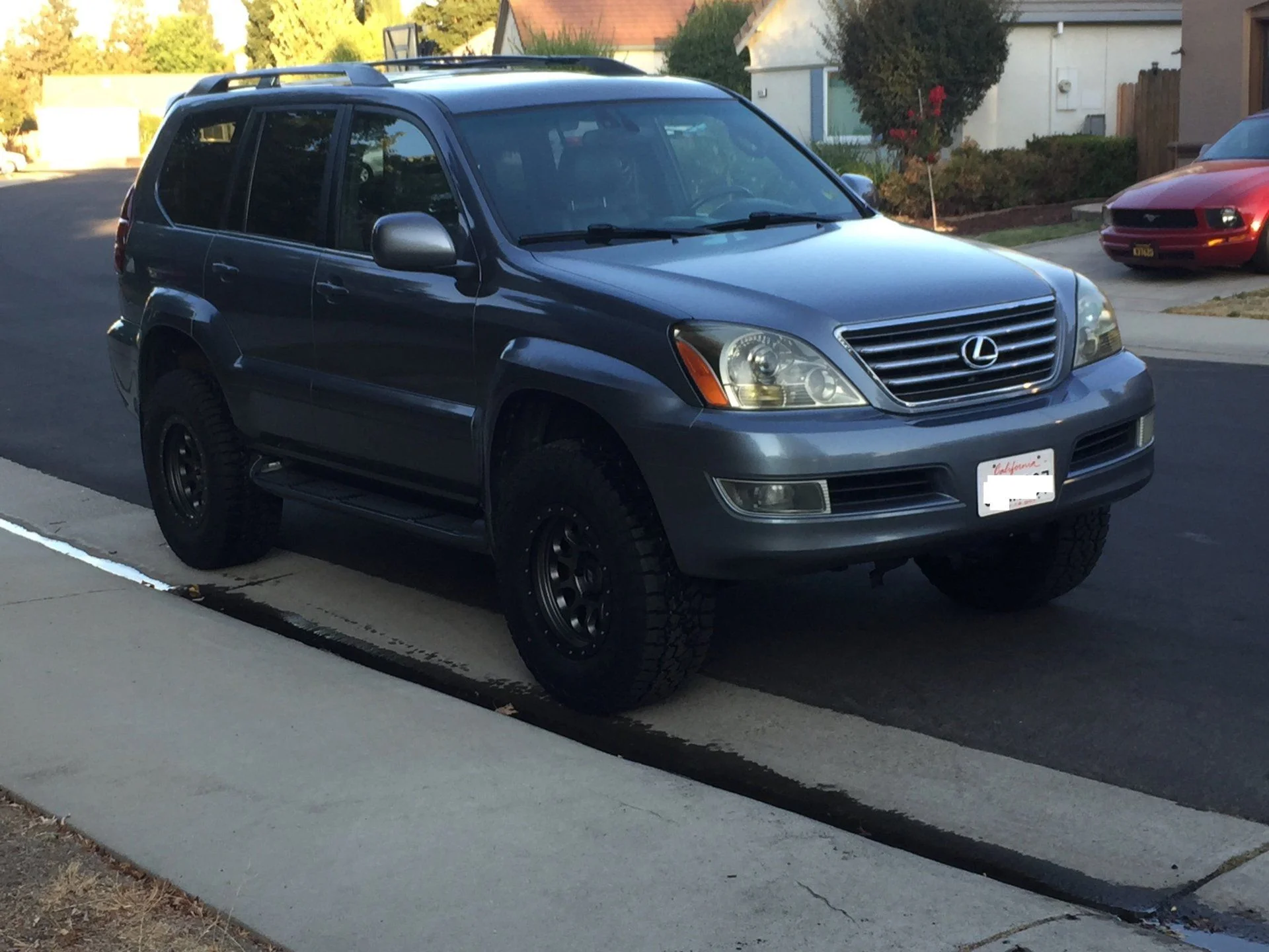

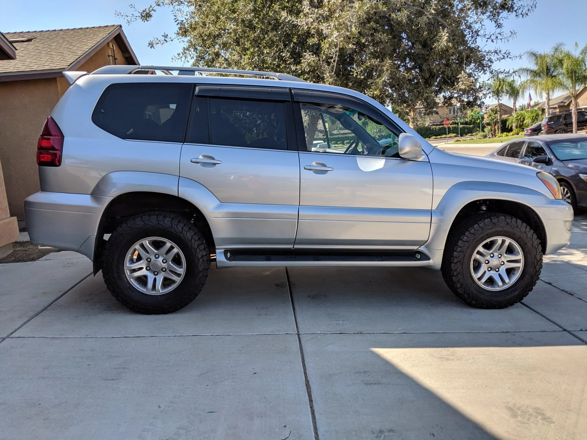

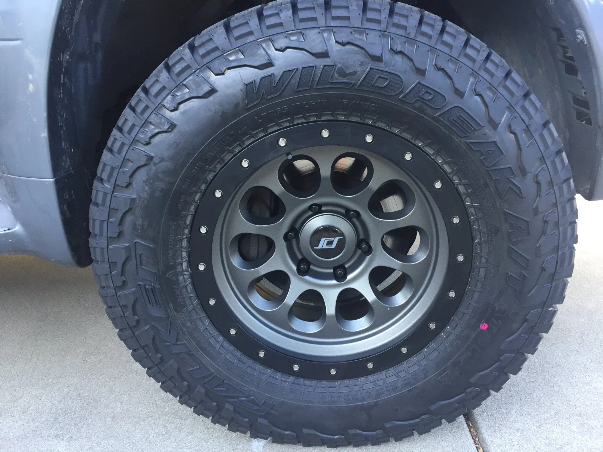

Wheels: SCS Ray 10's 17x8.5 -10mm Matte Gunmetal
Tires: LT285-70-17 C load
Spacers: None
Lift: Dobinson's 2.5" medium springs with comfort valved rear shocks.
Other Mods: SPC UCA's set to position B.
There was substantial rubbing. I had to move fender liner forward and cut where factory running boards meets body mount. I'm going to use a heat gun on the liner towards the back of the front wheels due to the fact that it rubs in reverse. Most importantly, BMC will be done this weekend. It rubs a good amount before full lock.
Lifetime alignment from Firestone.
Specs -
Camber:
FL -0.5
FR -0.7
Caster:
FL +3.5
FR +3.9
Toe:
FL +.05
FR +.08
