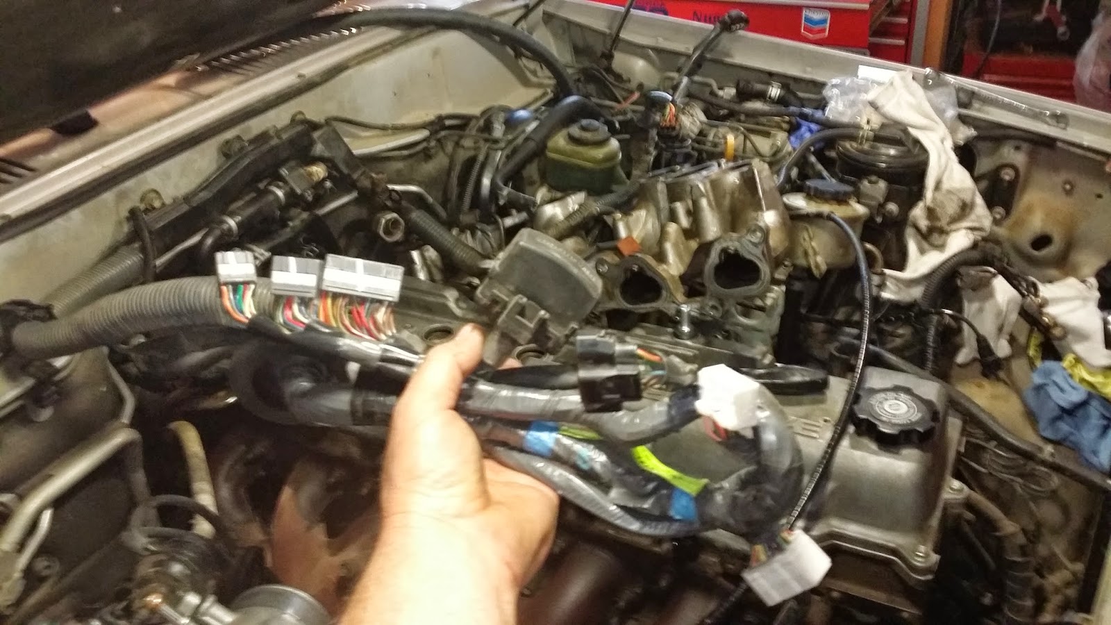

I just made the decision to reroute the wiring harness out side the lower intake manifold so i can take it out & clean it. I don't know if this was a good idea anymore??? I'm pretty committed now. Oh well...

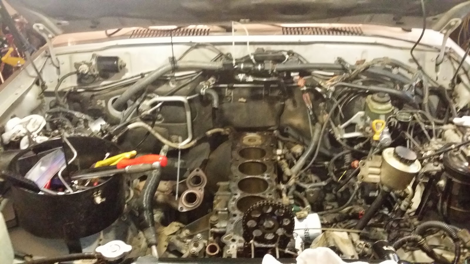

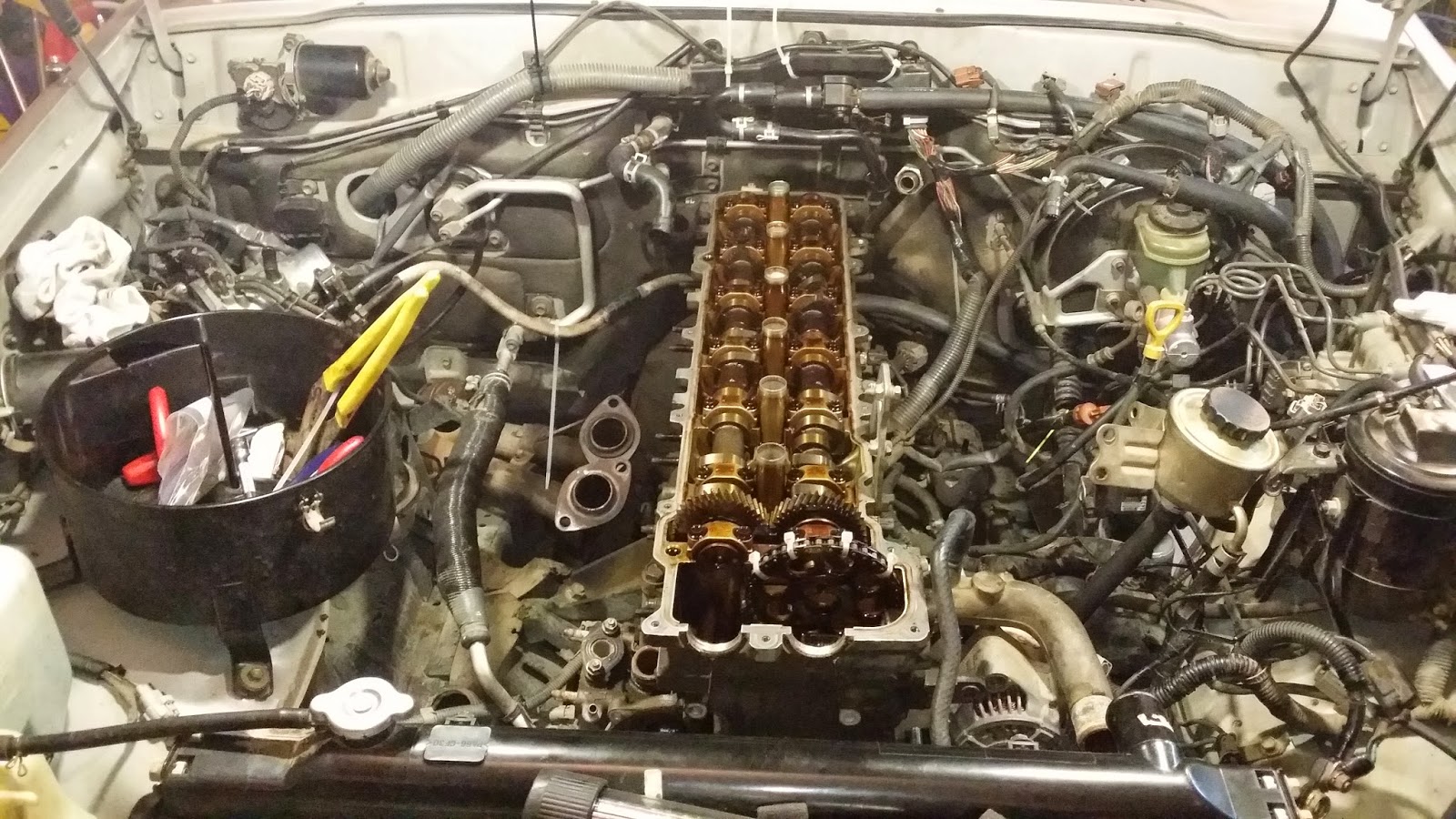

Last night at about 1am my wife & I lifted the head off of the LX What a milestone... here is a few pics... I will be posting up more pictures later. More details to come on putting it back together, to be honest I have been extremely overwhelmed with this tear down.
nice build, sub'd, lots of work tearing that engine apart, been there and done that so let me know if you have questions, you are going to end up being very happy when it all goes back together. My truck purrs after the HG job, etc.

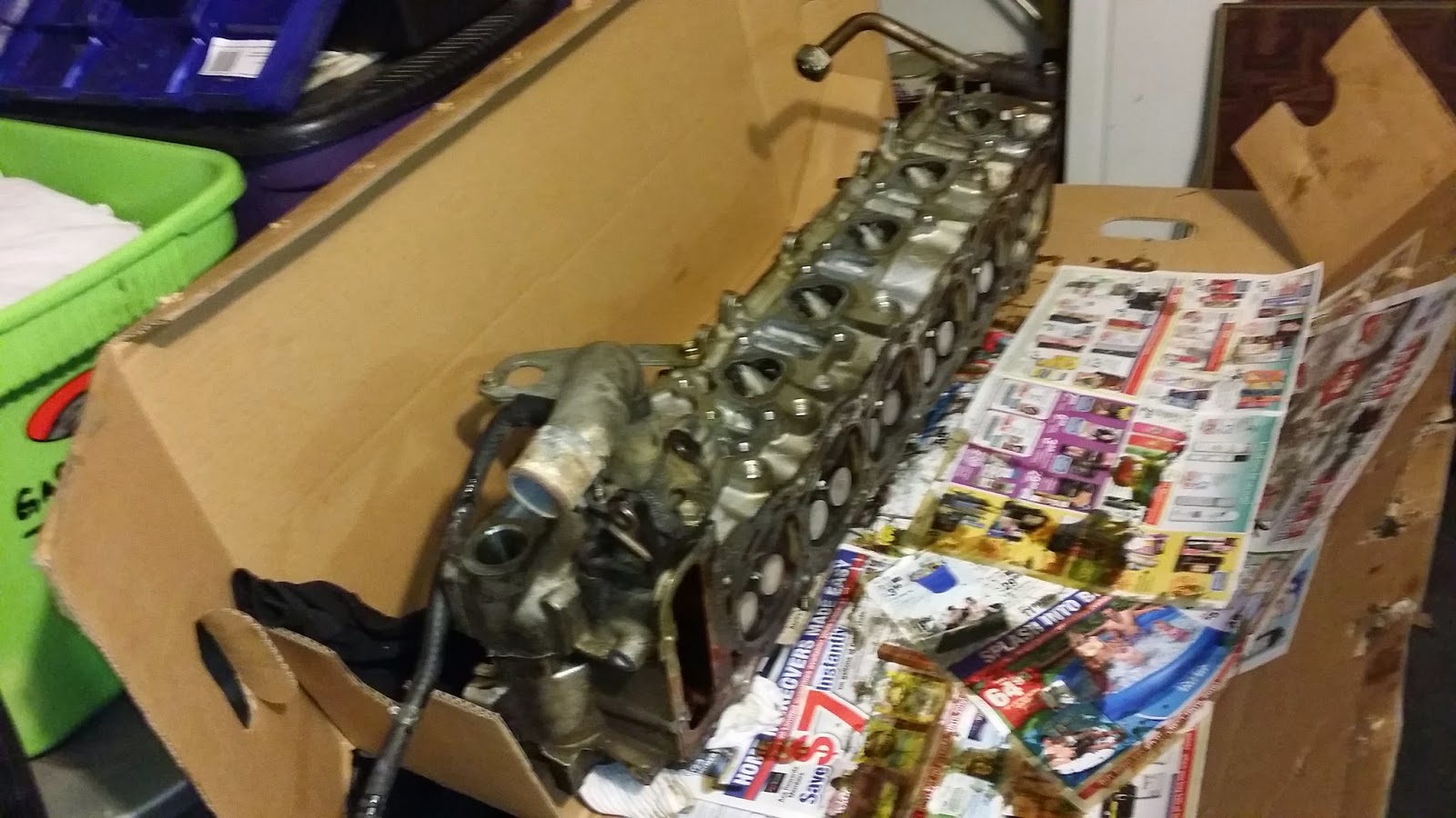

Pulling off the head of the LX450.
Pulling off the head of the LX has been a grueling adventure so far. I want to stay positive here, but it has not been fun at all. All I can say is Lord willing this thing will be good for another 100K after the while I'm here stuff is replaced. ie new water pump, belts, hoses etc.
Here is some pics of what I got so far. I will be giving a better detail as it goes back together. Stay tuned...

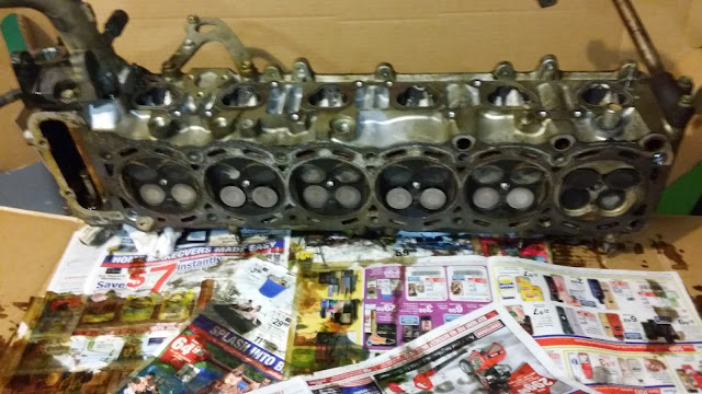

Here is a sequence of the tear down...

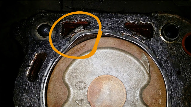

Oops there it is a text book #6 water jacket failer.

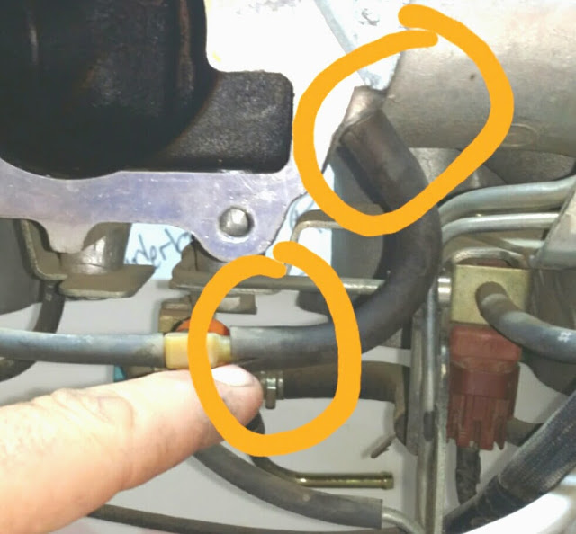

I have found a dry cracked vacuum hose that might be part of my P0401 restricted EGR problem.

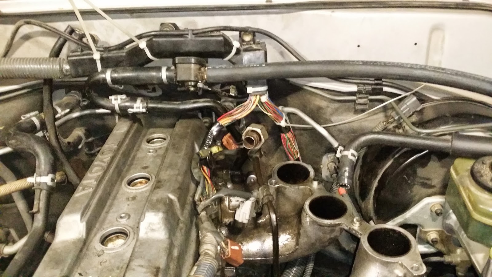

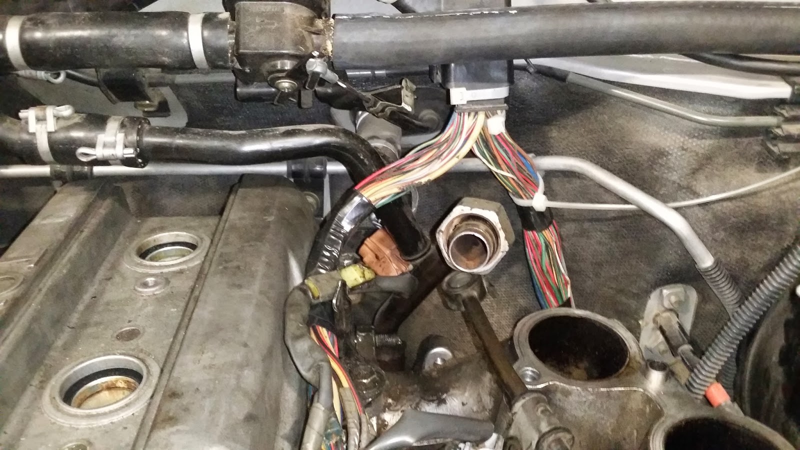

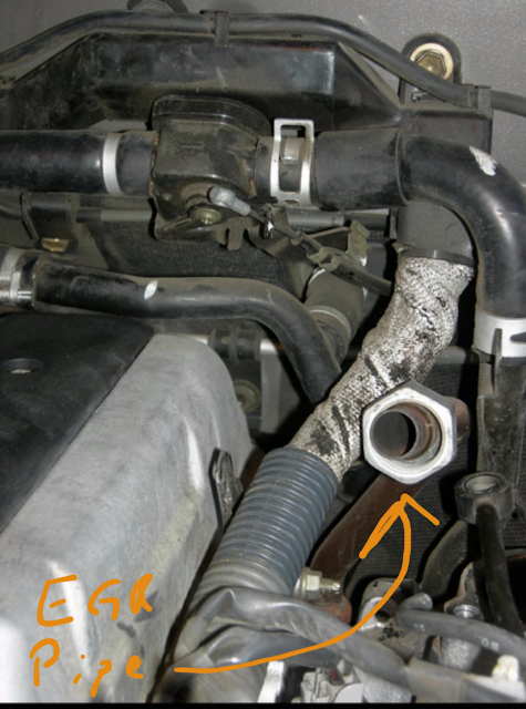

I made the crazy decision to start a wiring harness reroute to be able to remove the lower intake off & get the wire away from the hot EGR pipe.
I don't have a pic of a before but here is one from another rig so you can see why I moved the wiring.
That's all for now...
for the EGR pipe you can just rewrap the harness with some heat sleeving, I got some from summit racing that worked really well, no need to modify the routing of the harness. I did however find it usefull to remove the engine portion of the harness per the FSM although it was a pain.
Yes Sir that is my plan is to rewrap in heat shield & aluminum tape & bypass the PHH around the brake booster. It gets hot out here in the Central Valley of CA. Another reason I moving the wires behind the intake is I'm entertaining the idea of installing the head back in with the intake already install all together. Has anyone ever tried this? It was such a pain to get to all those underside bolts. Putting them back in would even be more difficult. Just thinking out loud here... maybe it might work???
I really reccomend just following the fsm, that worked for me. The bolts on the intake are not too hard if you use a little wobbler and some very long extensions from the bottom of the truck. I use a little blue masking tape in the socket and wrapped around the wobbler to keep things intact in order to get the bolt of nut started.

The head was checked out by the machine shop & came back with a clean bill of health. It was jet washed & found to be straight. It only needed to be decked .008" to clean it up.
