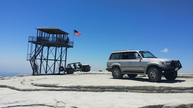

Bald Mountain Family trip.
The 1st family camping trip has been a success. We made to the mountain & back down. The Cruisers performed well & did the job it was asked to do. I'm really happy with it. With the 4:10 gears & 315s as was expected it had a tall gear feel... I had to give it a bit more gas to climb over obstacles. It has been 18 years since I was last on this mountain... It looked different, more tore up & rutted out from what I remember. Having the lockers made it a dreamy ride. It hardly even spun a tire.
I asked my girls when we got back if all those hours spent in the garage working on the Lx was worth get to go camping. The answer was a definite "YES!!!"
I will post up more pics later... I'm having phone issues.
I did a short video to show the tower & lake...
Here is V Rock... (I was corrected by ToyotaDon its BumperBuster) the video is not impressive, but the Lx does flex very well... the OME medium springs are a bit sloshy... they have a right, left sway. I did have the Rancho shocks set on 3 of 9 though, maybe I could set them a bit firmer???

Here is V Rock... it's not very impressive, but the Lx does flex very well... the OME medium springs are a bit sloshy... they have a right, left sway. I did have the Rancho shocks set on 3 of 9 though, maybe I could set them a bit firmer???
fyi, I have owned those rancho shocks before, IMO I did not like them, I kept them on the highest firmest setting as anything else was sloshy like you mentioned. If I were you I would set them to firmest and then adjust from there. HTH
