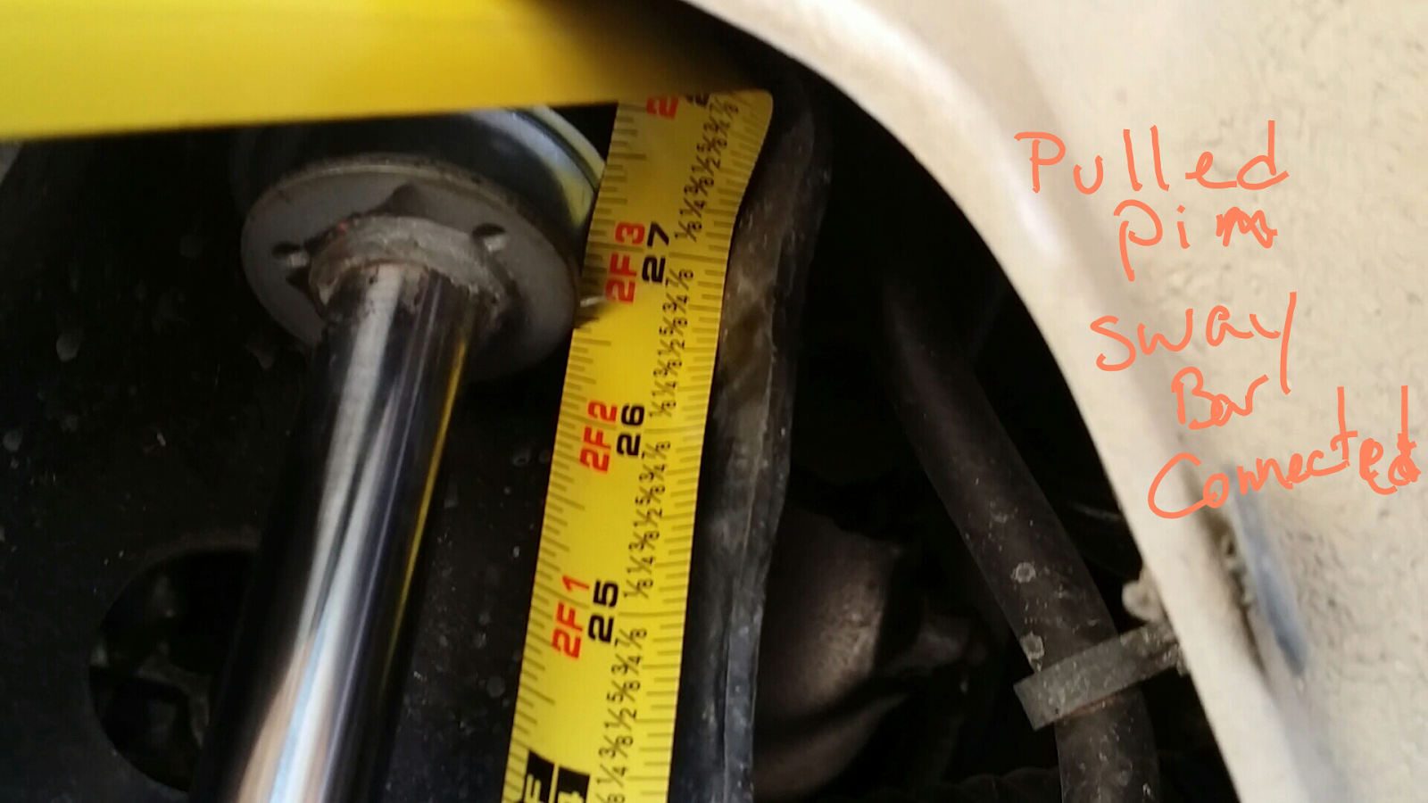

Passenger side hitch pin pulled
I pull the front passenger side arm bolt with sway bar connected. It did not have the extreme drop that was like the drivers side which was the result I was after, the less drop was most likely due to the front panhard bar. The front end did feel more free. The negitive was it was into the passenger side tie rod. The drop out measurements was 27".
That is only a .5" more drop from it all connected this is measured at the shocks.
Once the coils start releasing there is nothing left to push the axle down. I also belive as far as the tie rod, the caster bushings & arms might have different results with bind if you play with maybe lowering the aft part of the arms via something like the Man-a-fre caster brackets. Just a thought.
I'm pretty much done playing with swaybar & pin mods for now. Another thought is to raise the fenders via body lift to allow the more up travel that the disconnected mods have to offer.
Again, all these results are from a 3" OME 851+25mm/860 lift w/ 315s tires.

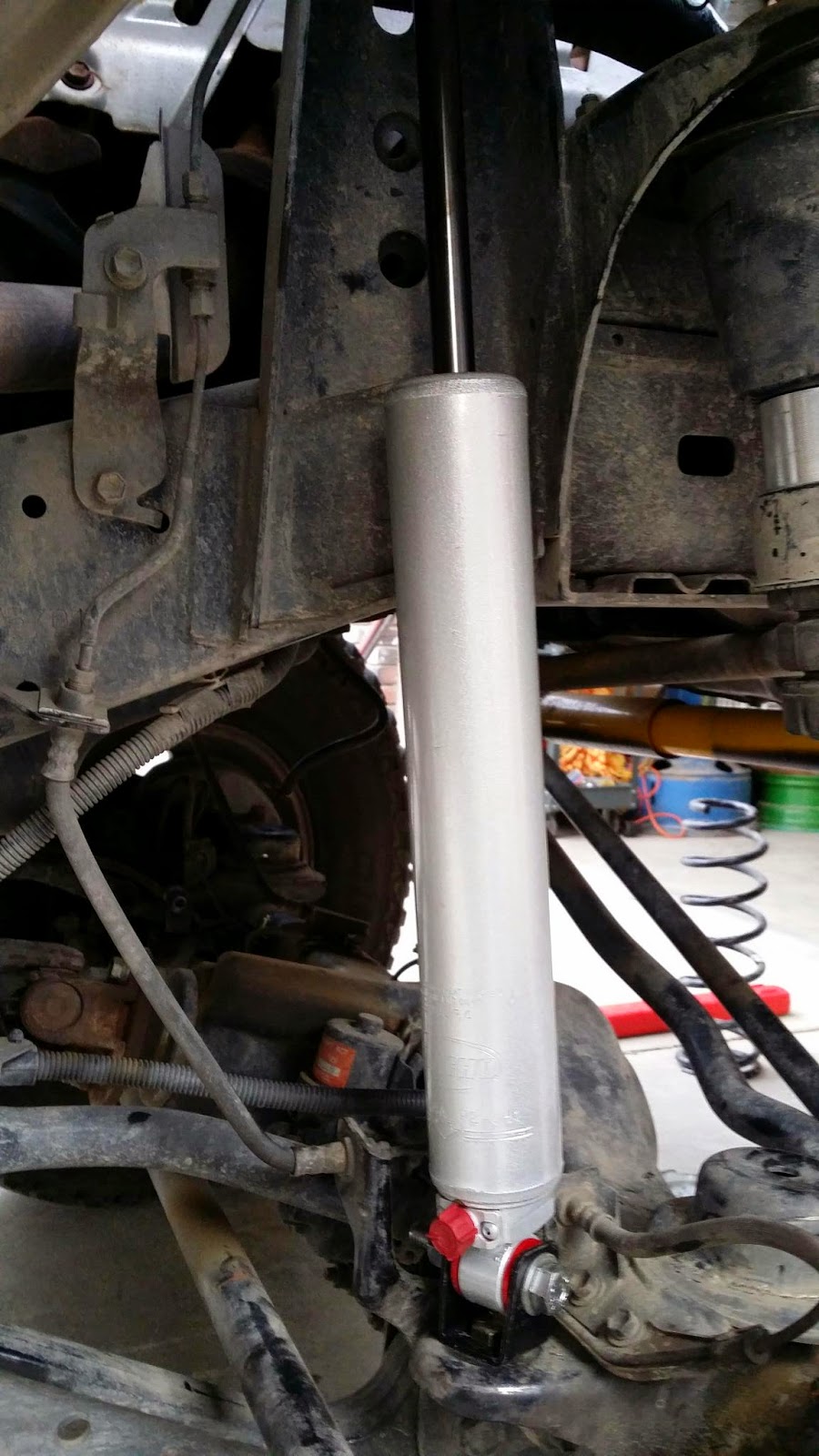

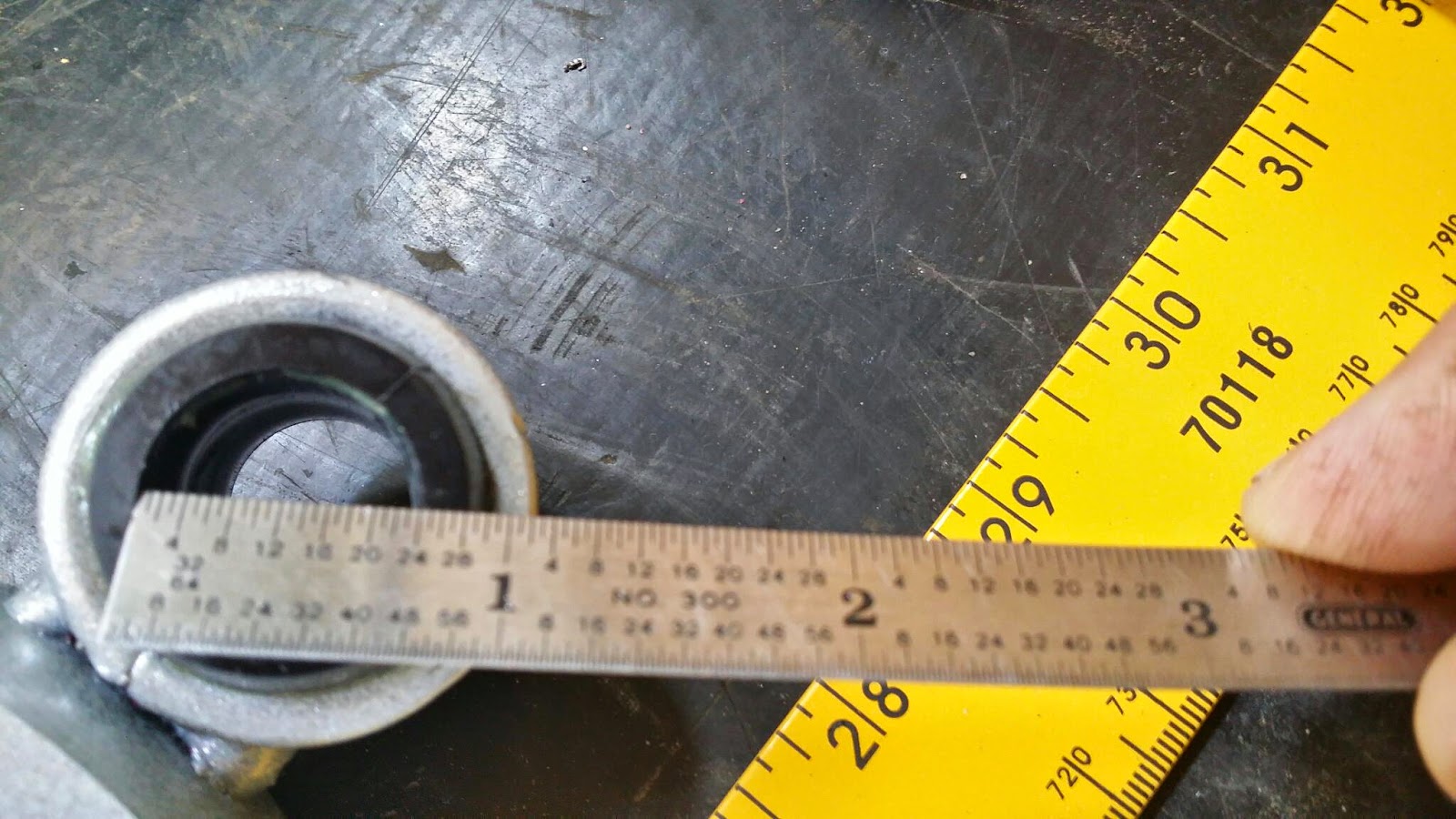

RS9000XL Rear 999234 install on my LX450
I sold the 265s tires so I was able to get another set of the Rancho RS9000XLs for the rear of my tight little ride. With the 16.5" to 27" measurements they fit perfect.
The only mod I had to do was change out the bottom bushing to a fatty size, 14/32" inside demention to be exact. They have a 4.5" up 6" down travel.
~~~~3-31-15 update~~~~
After testing the up travel my test zip tie on the shaft is pushed all the way up, so I will be installing a 1.25" bumpstop in the rear.

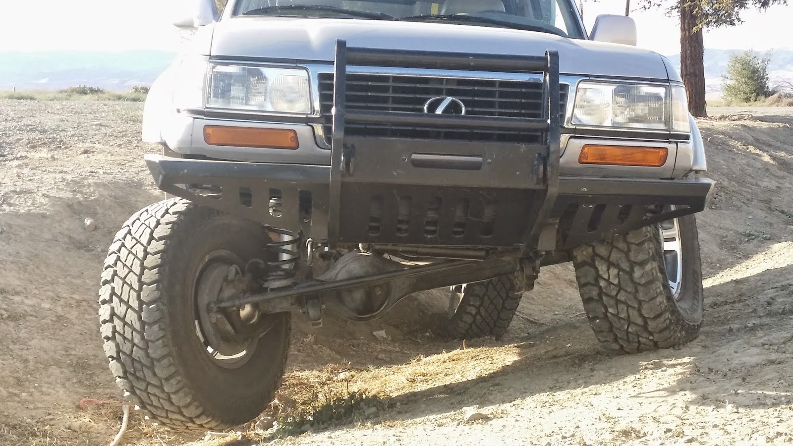

As of lately I have been trying to maximize & get the most of what my LX suspension can give me. Learning the capabilities & limitations of my suspension has been a huge learning curve for me. I have realized I really can't go to far "outside the box" on what works & has already been done by the many 80 owners that have been there & done that years before me. I now know that OME did a good job with the compressed & extended length of the "L" shock for the reason is the front suspension doesn't want to drop out much past the L shock ext. length of 26.5" measured at the shock. Anything more than that will start releasing coils & hitting tie rod to control arm on full flex.
I did try the sway bay & hitch pin mods & on my set up it started having problems around the 27" drop out mark.
This is with OME yellow CC bushings. Getting 11.3" of travel out of a shock that compresses to 15.25" is also a big deal. The only negative I have herd is they are very stiff... this is why I have stayed away from getting them. As far as the OME 2.5" coils, they flex very well to that certain point. The coil springs offer a ride that a leaf spring will never offer, but In my opinion the front suspension can't even compare to the leaf spring over full axle fj40 I use to have. It's a tradeoff, ride or flex.
At this time I am very happy with my LX450 & what it can do.
There are only a couple things I can do later to increase flexibility. One is to do a body lift & go back to the stock bumps stops, this would allow more room for up travel. The reason is the hitch pin & sway bar disconnected mods want to offer more up travel than down. A body lift will give the extra fender clearance needed for more front tuck.
The 1st pic here has a pulled hitch pin, sway bar connected & stock bump stops. See how the driver tire is stuffed more compared to the 2nd pic which has the 1.5" bump stops.2015-04-02 14.29.14.png
